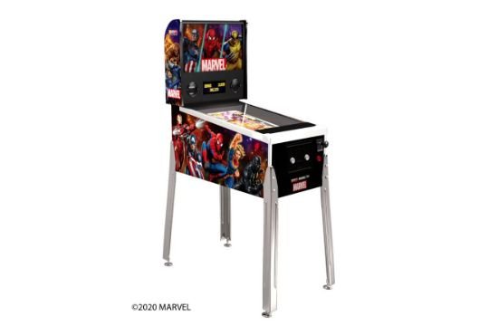

Any interest Zel? :-D
BFTW
BFTW
Details here
Zelandeth
Posts: 5328
Joined: 16 Nov 2014, 23:36
x 1607
Re: Zel's Fleet Blog - BX, Jag XJ-S, Sinclair C5, Mercedes 208D & 230TE, AC Model 70.
Unread post by Zelandeth »
It would have to be very cheap. Problem with the likes of that is that the hardware inside it is all proprietary. So you're tied very much to using what they give you, and the table packs are Not Cheap. Early ones are old enough now that you're getting into territory of the software images not being available if you have a drive failure or similar and need to reinstall things.
I might have taken a punt on it if I hadn't just built one though...probably a cheaper way into the hobby than mine! I will be curious to see what it goes for though. If it's less than a couple of hundred quid probably would be worth it anyway as a chassis for a smaller virtual table even if you gutted it of everything, as the cabinet is probably one of the most difficult parts. Assuming the display (which sounds like it's faulty) isn't an awkward size anyway.
