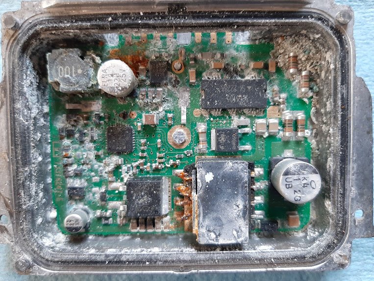

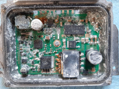

One has to be careful when soak-testing electronics..
Else this happens :shock:
Davies 'aquatic' HID Ballast

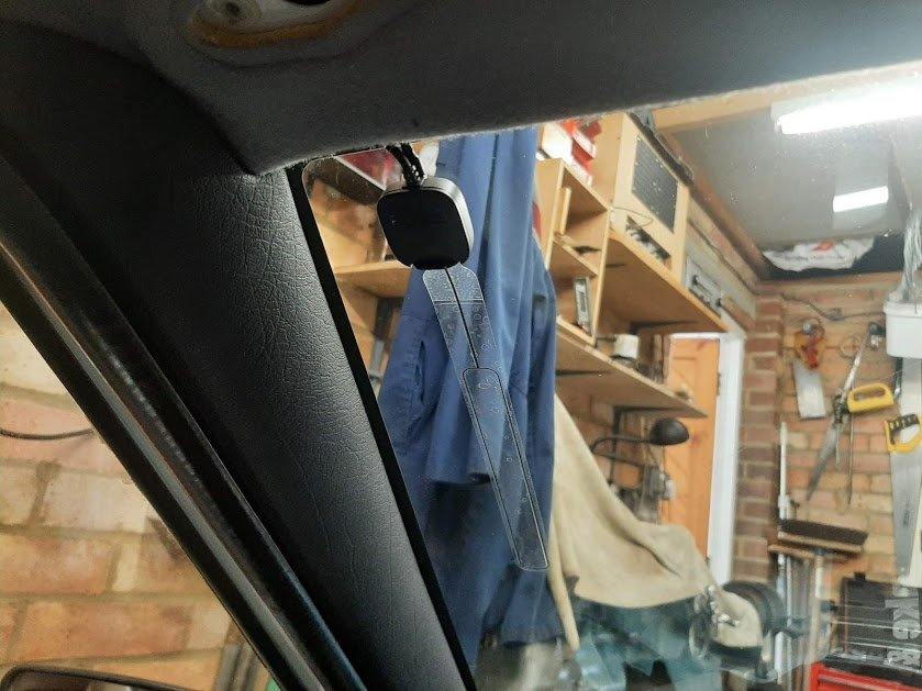

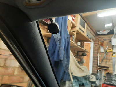

Todays little project: fit a DAB radio adaptor in Daffodil :)
First job was to install the aerial on the windscreen...
DAB 'film' aerial
DAB 'film' aerial
I pulled the A pillar trim off and hid the aerial cable behind it and hid it all the way to the head unit which resides rather neatly on the front wall of the centre console oddment tray...

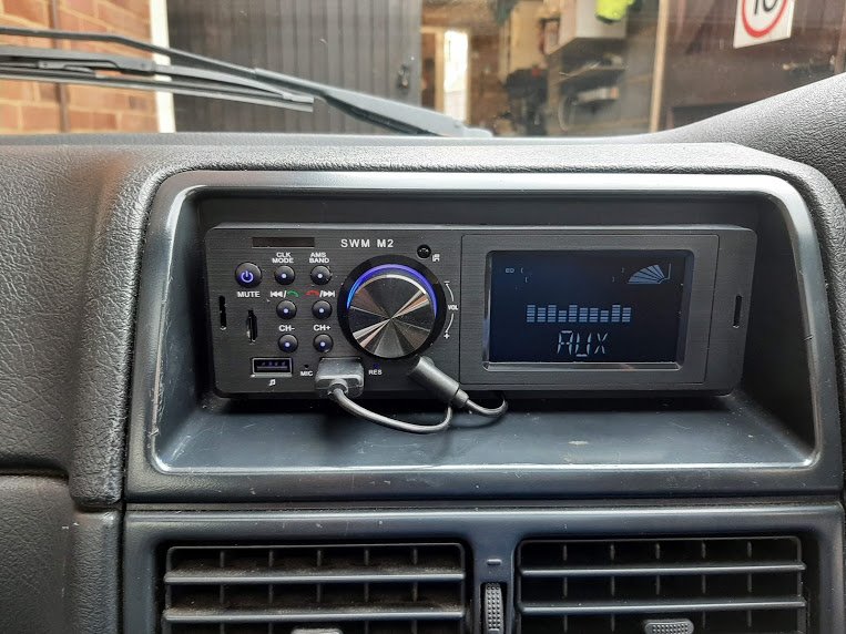

Pure Highway 2000 DAB

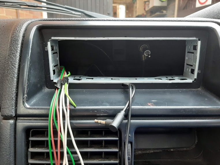

The power and audio output cables I fed up behind the radio head unit and after cutting a small slot, fed them under the head unit cradle...
Power and audio cables in their slot

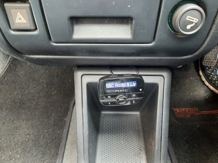

The radio head unit very conveniently has a USB socket to supply power to external devices that may be connected to it. Perfect for powering the DAB adaptor :)
It all works rather well and is about as neat as I think this sort of installation can be, given there is no aux-in socket or USB power on the rear of the head unit...
I know it's not in keeping with Daffodil's age but now I can listen to FM radio, DAB radio and stream Amazon music via Bluetooth :D
