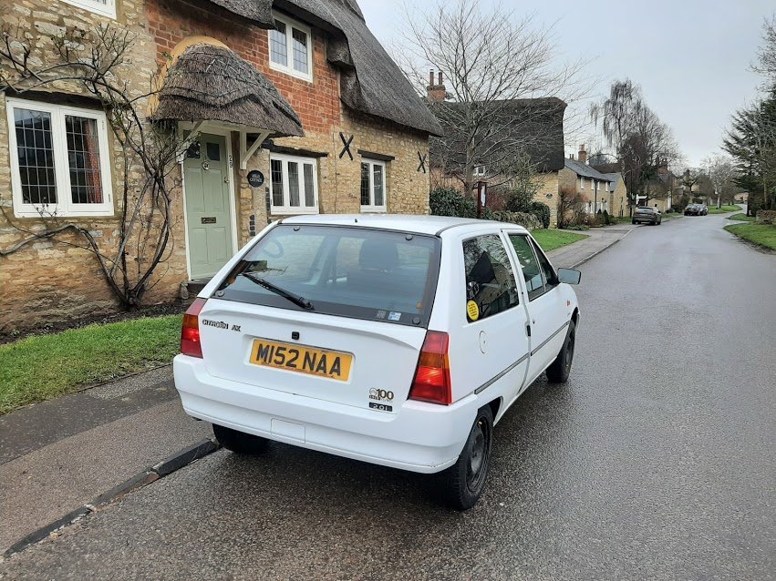

She's all done and MoT booked :)
Out and about...
Out and about...
I took her out for a leg-stretch and a shakedown earlier today... Gosh, does she drive well :D It's hard to believe she's only got 954cc under her bonnet... She feels like she has a lot more...
This little car give a massive amount of smiles per mile :D
She's a road-legal go-kart and huge fun! She just begs to be driven with enthusiasm :)
So different from Sally, Daffodil makes Sally feel very staid and ordinary with none of the sheer fizz you get driving Daffodil...
Sally is, in her defence, somewhat more refined than Daffodil...

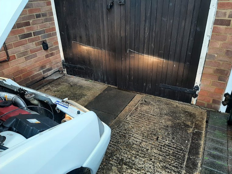

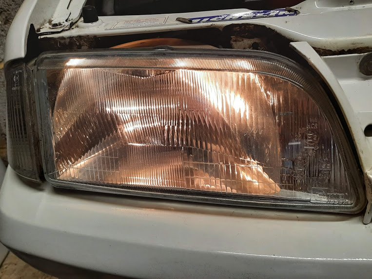

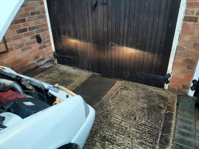

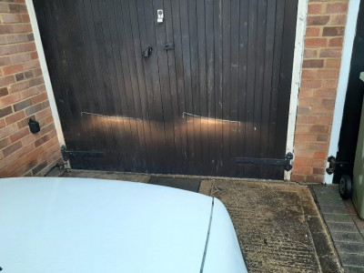

Daffodil's headlight aim needed setting as I noted they were a bit out when i went on my test drive earlier in the week.
As both the AX and Saxo headlight centres are near enough same height off the ground I could use Sally as a reference and placed her in a certain position on my drive and shone her lights at the garage doors... I marked the beam positions with chalk...
Sally's headlight aim...

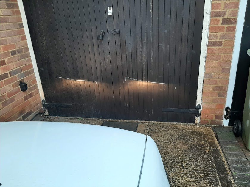

I then put Daffodil in exactly the same spot and adjusted hers to match Sally's :)
Daffodil now spot-on!

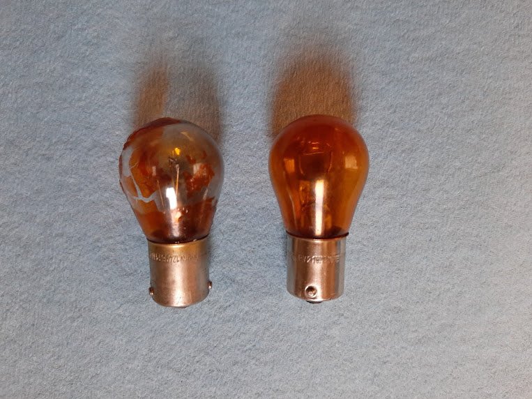

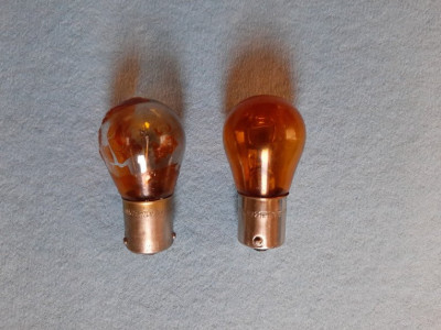

I then replaced her flaky amber indicator bulbs after sourcing spares from Amazon after finding one of my spares was duff... Amazon supplied 10 for the cost of barely a pair from our local factors!
Flaky!
Flaky!

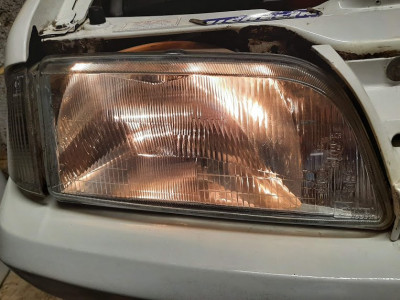

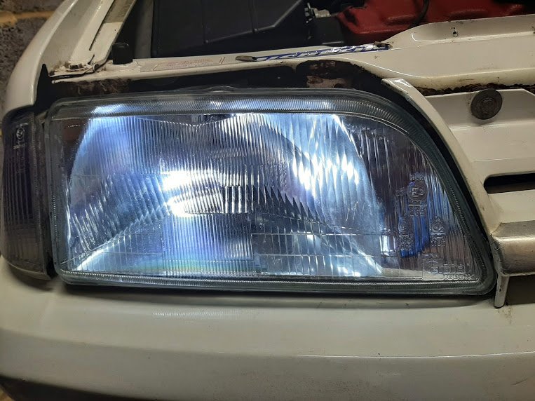

I also needed to stock up on sidelight/numberplate bulbs and from Amazon, 10 LED bulbs were way cheaper than filament ones so I tried some...
Filament sidelight...
LED sidelight...
LED sidelight...
What a difference! Tomorrow I'll see how well they light up the numberplate...

I put LEDs in the C5 sidelights, they were crap but legal, very blue. The original W5Ws lasted only a couple of weeks, the LEDs several years, still OK when I scrapped it.
I've seen a lot of LED number plate lights and most are dreadful - they can be blinding for anyone following, alternatively only light up a couple of characters on the plate. Lots of different ones to chose from and many are quite expensive - fifteen quid a go for some. I chucked a pair of cheap ones in my reversing lights. Far brighter but still rubbish due to the location of the reversing lamps rather than the bulbs. The rear foglights are more use.
Posts: 55013
x 8343
Re: Citrojim's AX, Saxo, Pixo, Running and Cycling Tales
myglaren wrote: 14 Jan 2021, 17:10 I've seen a lot of LED number plate lights and most are dreadful - they can be blinding for anyone following, alternatively only light up a couple of characters on the plate.
Steve, I've seen exactly the same and I'd consider it makes the car illegal as the plate is not properly lit and a lot of white light spills directly back which is definitely illegal... Certainly an MoT fail...
Hence why I'll test first...
They do seem to do the business as sidelights though...
Posts: 14298
x 3303
As far as I can see, LED bulbs are more like torches, as they generate a beam of light (OK, a wide beam, but still a beam) rather than a pool of light. That is why they work as sidelights (as they are pointing forwards) but not so well as number plate lights.
Posts: 55013
x 8343
Hell Razor5543 wrote: 14 Jan 2021, 17:21 As far as I can see, LED bulbs are more like torches, as they generate a beam of light (OK, a wide beam, but still a beam) rather than a pool of light. That is why they work as sidelights (as they are pointing forwards) but not so well as number plate lights.
James, looking at one running 'naked' I think you've nailed it ;)

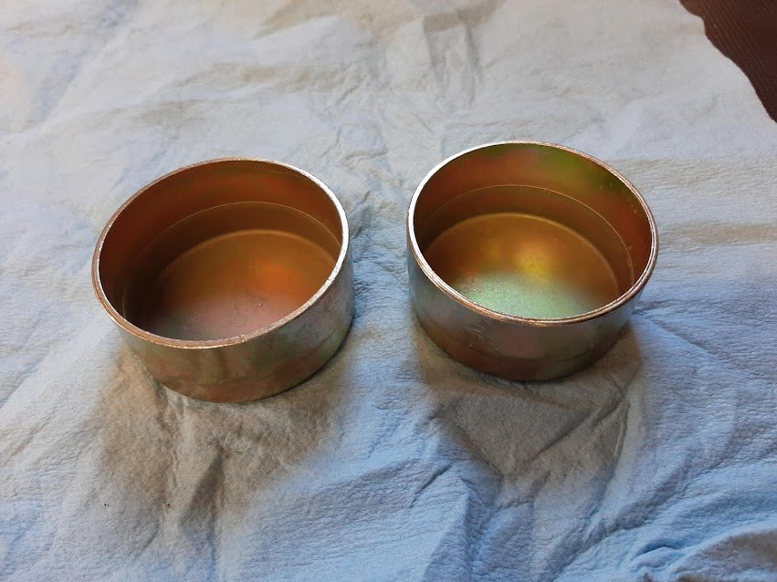

A nice little present for Daffodil arrived yesterday ;)
AX rear hub dust caps
One of the originals was missing and the other was badly deformed...
