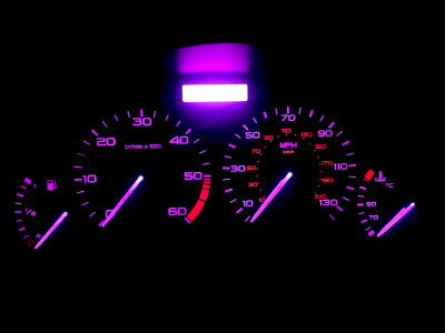

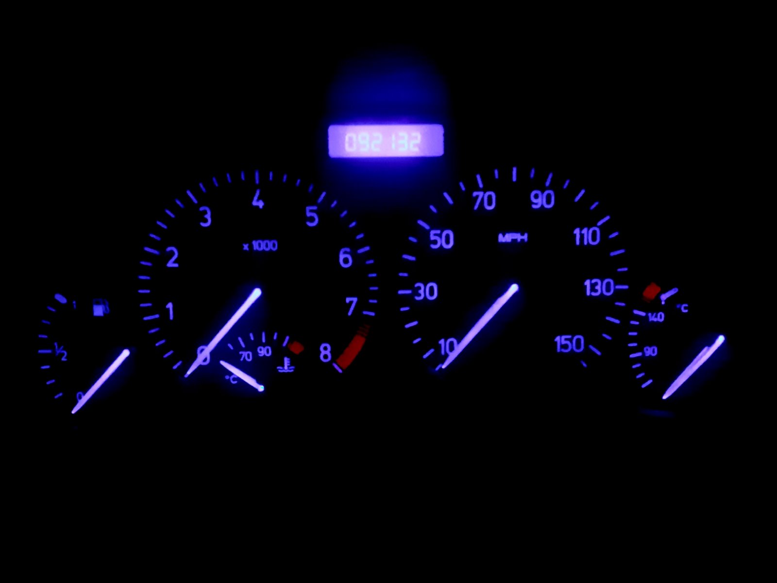

This afternoon's little project was replacing the dull orange LED's in the 206 instrument lighting with some nicer, more up-to-date colours. The 180 got the blue treatment to match the paintwork & Emma's Grey HDi received hot pink, I also reversed the polarising filter on the HDi's odometer too so the display is negative compared to normal. :D
This didn't take too long once I got into the swing of things, about 45mins per cluster, and the photos really don't do justice to the colour. It's much more vibrant in person & adds a neat twist to the OEM instrumentation. Now the next on the list is to convert the MFD to LED's as well and make the change to the radio and climate/heater/button lighting. Also have some purple SMD's for the '06 car. Speaking of which, yesterday was it's turn for some attention as the weather stayed dry enough to begin reassembly. So far have the inner arch and lamp recess welded back on & enough of the original quarter panel removed so that I've been able to hang the replacement panel loosely in place to keep the weather out. Hopefully one or two more good days on that will see it ready for action once more, can't keep a good car down & all that...

Am liking the blue LED's especially there, and will be curious to see pix of the welding if you get a chance. Any partic 'challenges' with it as yet? There's usually summat
