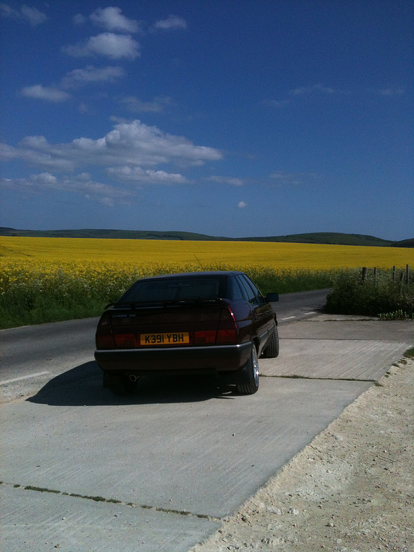

Not been around here for a while........again.
The XM has been behaving since returning to the road and i do wheel it out from time to time, when it comes out it tends to stay out for a few days as i do enjoy driving it, below is a photo of its most recent outing this week.
photo by Deanxm, on Flickr

Nice work Dean , the Xm is looking nice in the pic .
