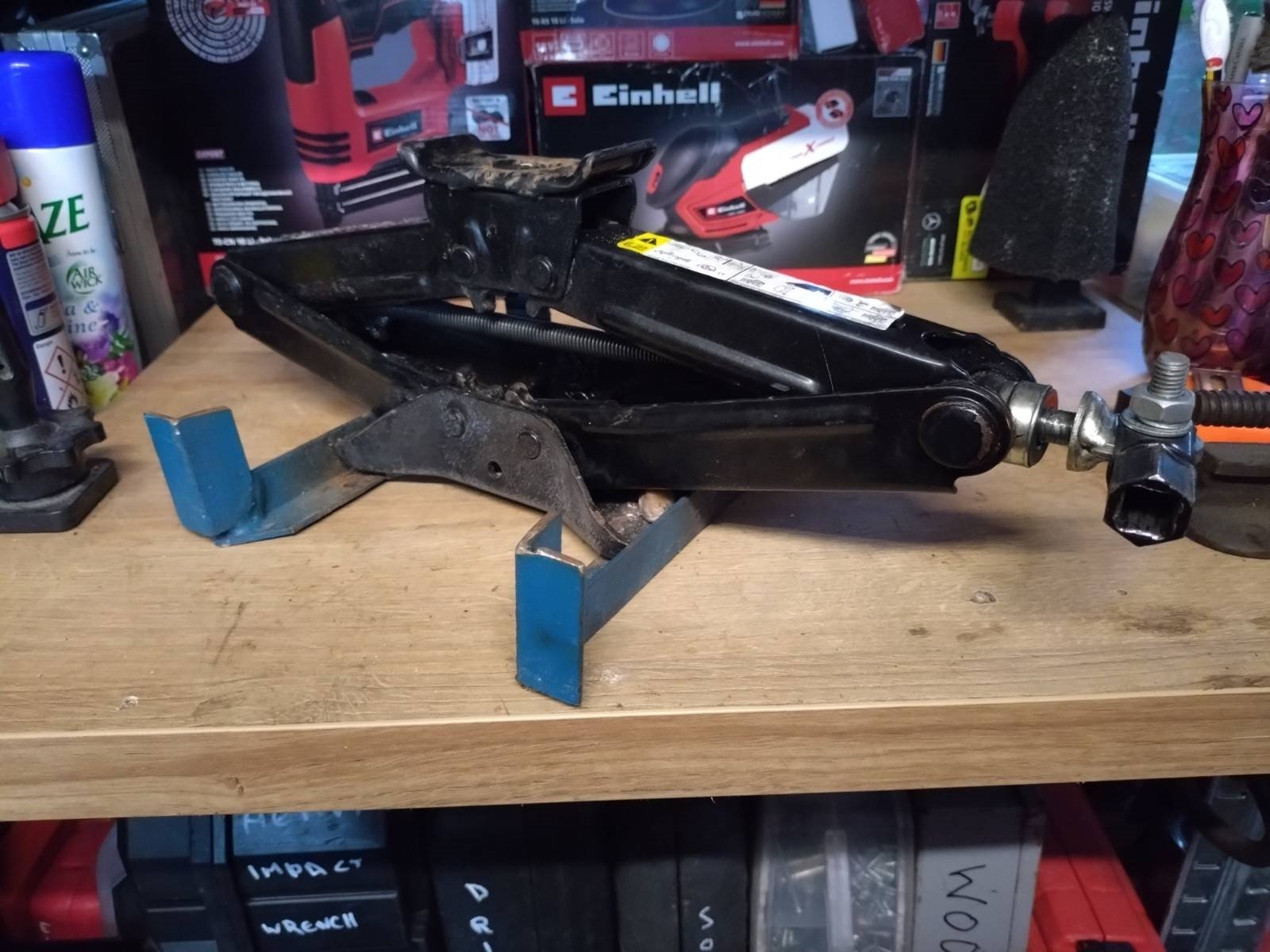

That looks a nifty device but still needs a fair amount of physical pumping which is the part I have eliminated with my modified Transit scissor jack. Picture to follow! :-D

I welded a couple of struts from an old ramp across the bottom to stabilise it and added a 1/2" square drive adapter and now I raise and lower it with the impact gun. Works brilliantly although I still use axle stands when necessary but it took away the 'hard' work aspect :-D
MTMO - electrojack!
MTMO - electrojack!

Quick you need to get your mark on that , that's a decent piece of kit indeed
