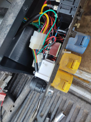

A different 'crank, no start', this one.
Whilst browsing the Bay of Plenty I came across a relatively local generator 'for parts, not working'. Worth a punt so I got bidding. £55 later and it's mine - a roughly 6kw Hyundai that all seems to be there. Key start (but no key) and all relatively sound.

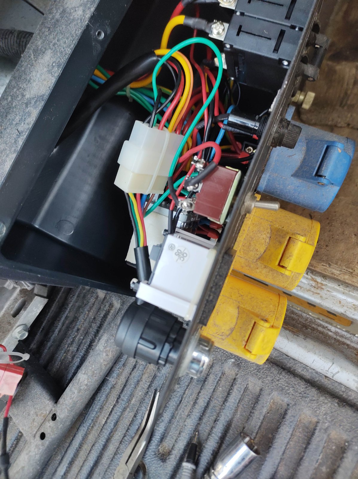

First up was to bypass the key start, so off came the control panel to get to the ignition switch and remove the wafers from the lock so it could be operated by a screwdriver !

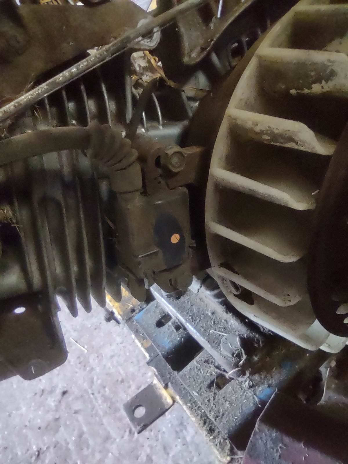

With the engine now able to be pulled over with the electrics on, some cursory checks showed a poor spark, and without even looking I knew the carb would need a quick overhaul as well.
Sure enough, the coil measured 'sub-optimal' and, as these engines are based on the venerable old Honda GX series, rather than order a Hyundai part I got a coil of finest Chineseum quality for a GX340 engine
Off came the carb for a quick clean and check - not surprisingly, the 'petrol' in the float bowl was the colour of Irn Bru, so a flush through with fresh petrol and clean out of the emulsion tube sorted that.

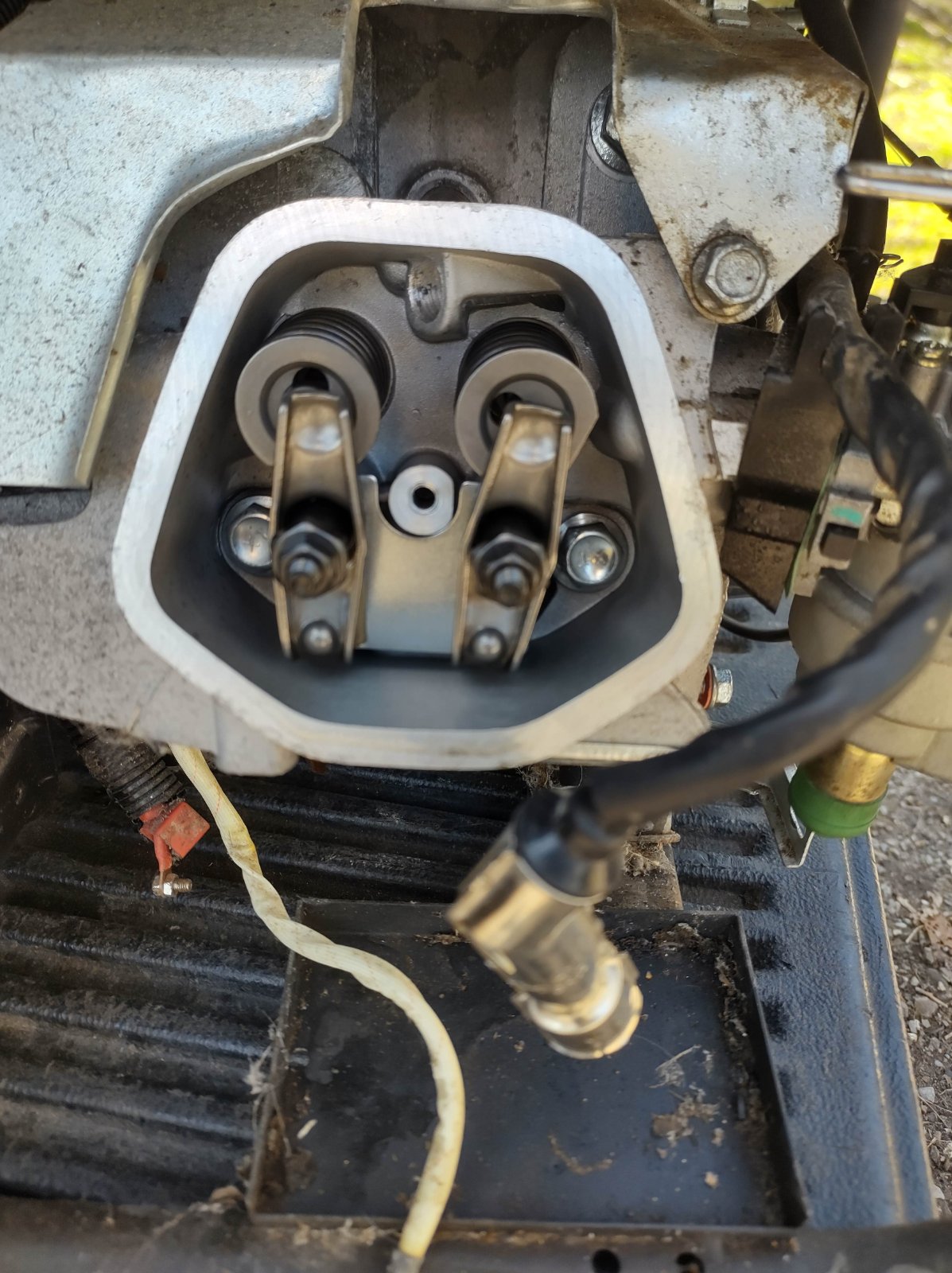

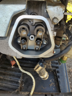

A quick check of the valve clearances showed them to be a tiny bit tight, but it also showed an impressively clean valve train.... I don't think this engine has done many miles
Put everything back together, connect up a battery, give it a sniff of 'start yer bastard', crank it over and..... off she goes with a light cloud of blue smoke which quickly cleared. Success
Once running the display panel came to life, this shows Volts, Hz, run time on this occasion, and total run time. She's only done 19 hours in total
Now the big question is..... what do I do with another generator in my collection ?

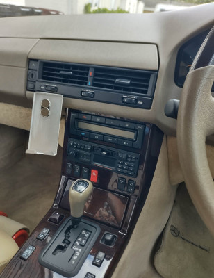

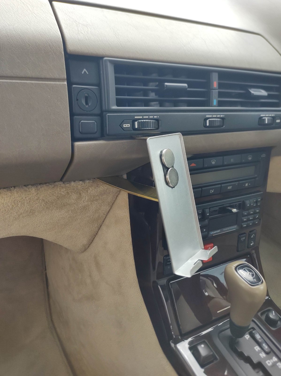

An item of latent usefulness.........

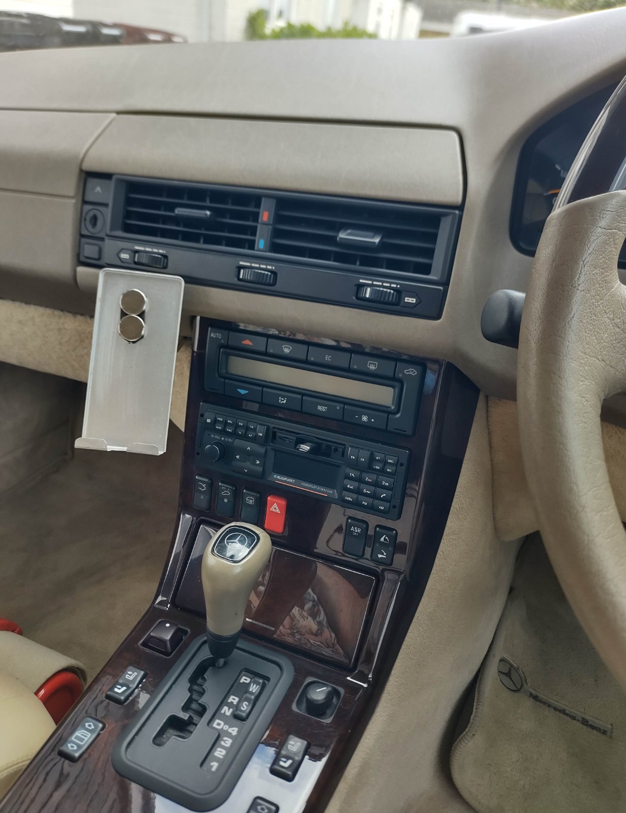

There being nowhere sensible to put a phone in Helga so you can view the satnav whilst driving, I thought it high time I bodged something together. I didn't want to drill any of the interior, and I don't think there was anywhere suitable to use adhesive pads, so I resorted to a bit of interior deconstruction to see what I could use
I determined that I could attach one end of a bracket to a hidden screw that's used to affix the passenger knee bolster to the dash, and as an upper mount I could hook my engineering miracle of a phone holder through the gap between the vent and the dash and secure it to a hidden edge of the dash - thus providing an upper and lower fixing point

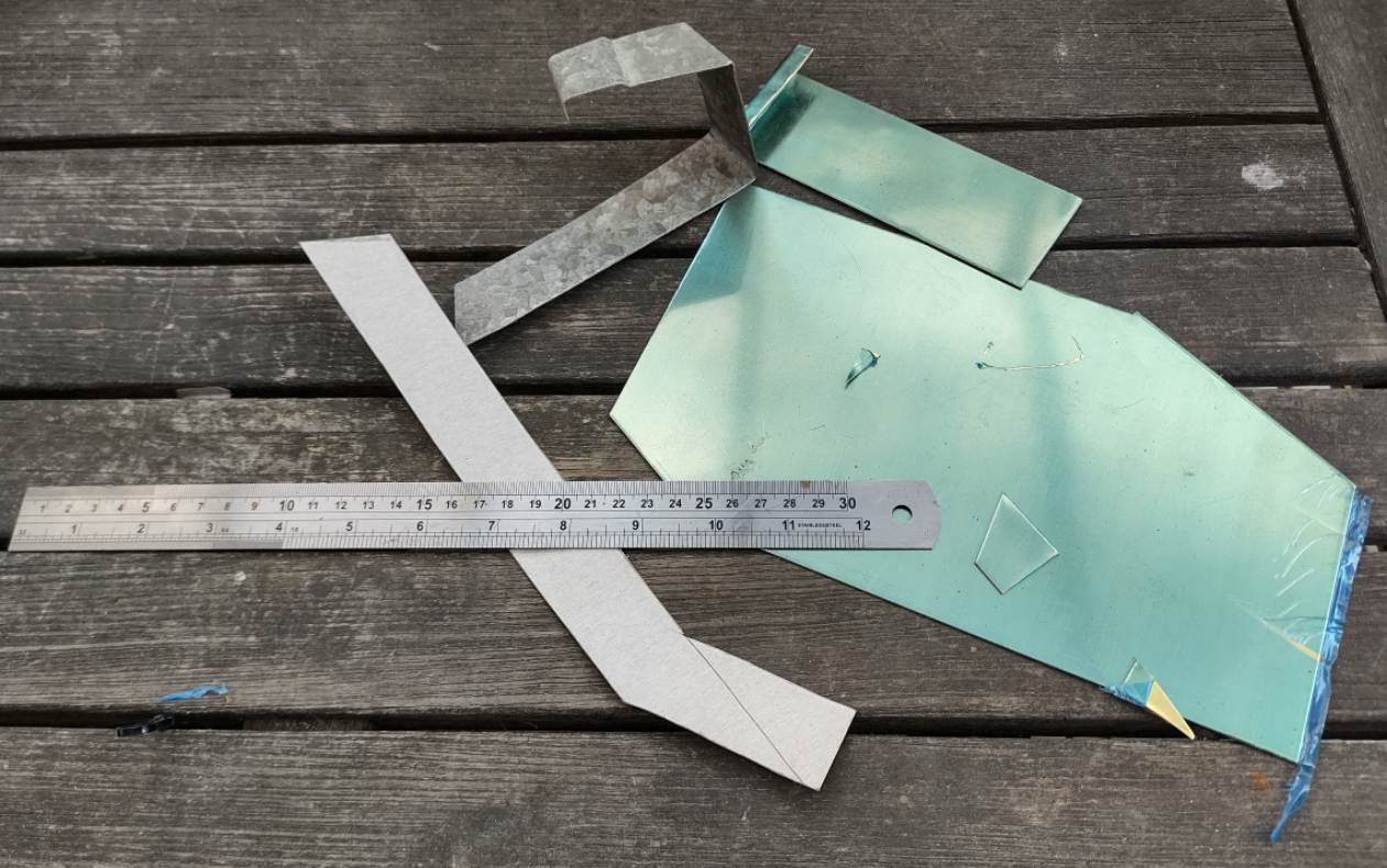

A bit of Cardboard Aided Design, followed by a bit of snippety-snip with the tin shears provided a proof of concept work of art. Possibly
There then followed some fettling and careful work with my metal guillotine and a bit of folding to come up with the awkward shaped mounting piece made out of brass. As for the actual holder that the phone rests on, well...... the aforementioned item of latent usefulness
It's the crumb tray from a recently deceased toaster
A little bit of fettling to bend the bottom round, attach some magnets (they had their own ideas of where they wanted to stick !
) stick it all together and viola
Not the slickest of designs, but better than any of the universal designed ones I looked at. It had to be fairly long as my phone is a bit heavy - a simple magnet stuck on the end of something doesn't work as the phone just wants to swivel 'round or fall off.

Re: Crank, no start....
That's the best use of a deceased toaster I've seen
Good work on that and the antifreeze
