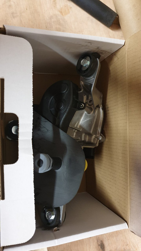

Brand new Genuine right hand side wipers motor ordered from the same Citroen dealer Ebay store as last time...
Thats another £320 then

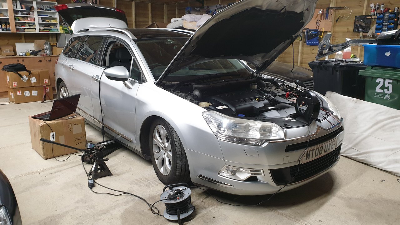

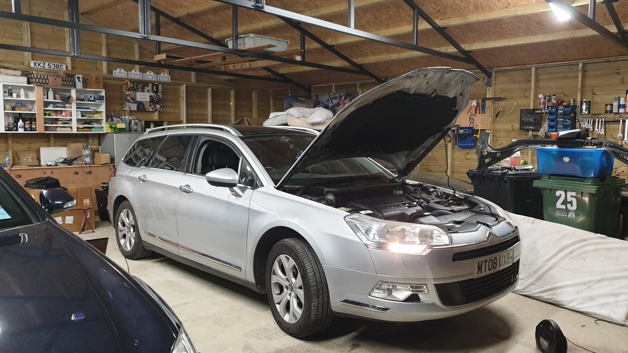

A little more progress on the Citroen...
Total wipeout

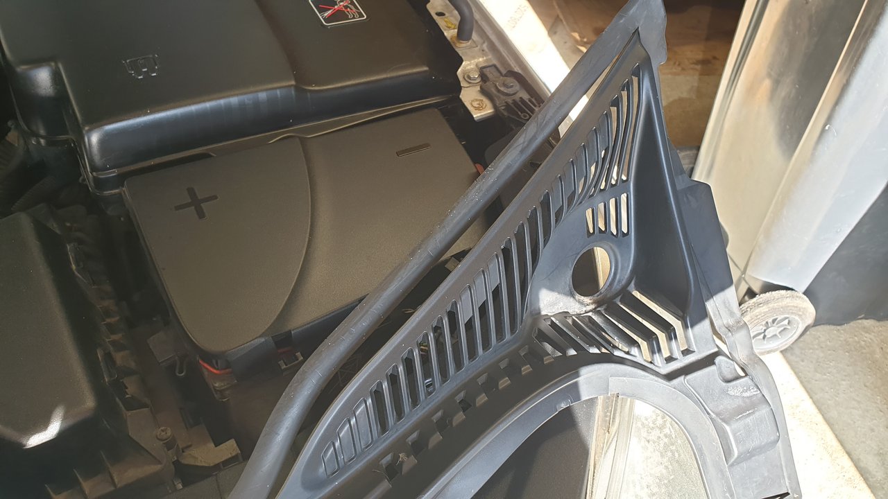

Following my previous discovery that fitment of the brand new passenger side wiper motor had not fixed the issue, I placed an order for a brand new drivers side (right side) wiper motor on Thursday night. It was dispatched on Friday, and to my absolute amazement it arrived on Sunday!! I was very pleased!
We were actually at a family christening on Sunday (don't get me started on why people who have no interest in God have their children christened..) so I was not released and allowed to do some work on the car until around 4pm. But when I was I had that motor fitted fairly quickly.
A quick test without the wiper blades fitted, and both motors were turning beautifully - a perfect result!

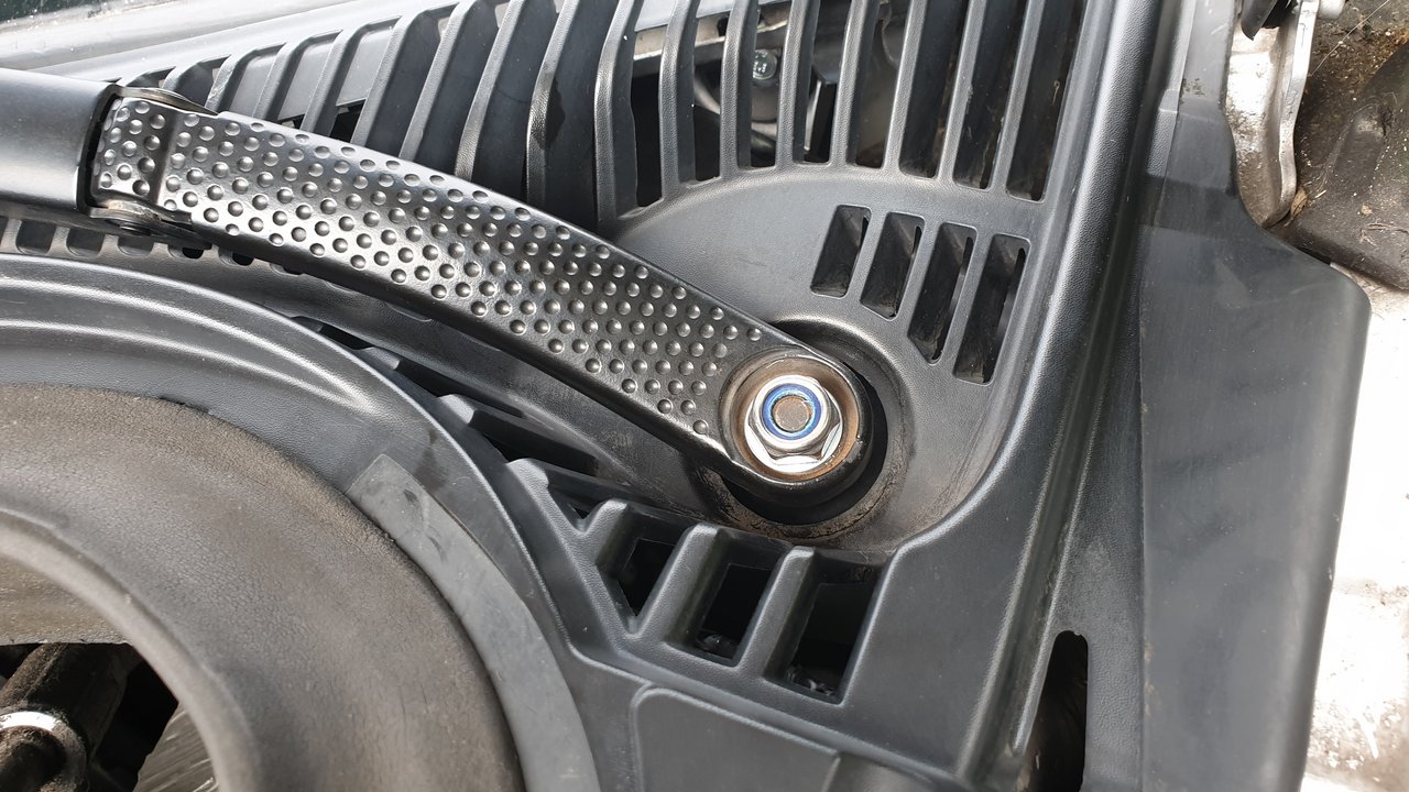

Two important things I noticed when getting them working:
1) When you put the wiper stalk up in the car to do a single wipe, it only activates the drivers side. When you pull it again it does both. This confused me and at first I thought the passenger side was not working.
2) You really do need to disconnect the battery before you fit the wiper blade arms, after ensuring the car has turned the shafts to the lower position. Otherwise you run the risk of the car moving to the upright "maintenance" position, which is exactly what happened to me... and then when you try the wipers they will try to move downwards into the engine bay instead of up to the screen!
I was very annoyed to see I had lost one of the bolts... so luckily I had a stainless steel Nyloc in my cupboard... but it looks awful!
Question for anyone who knows: Should there be a cover over these bolts?
As I mentioned before, I also need to source a new plastic scuttle panel for the bottom of the screen, as the seal is hanging off...
So then with the car fully back together... I was so excited, that I decided to get rid of that cable thingy (turns out to be a trickle charge socket) that was annoying me, poking out of the bottom grille in the bumper... it's now in the bin!

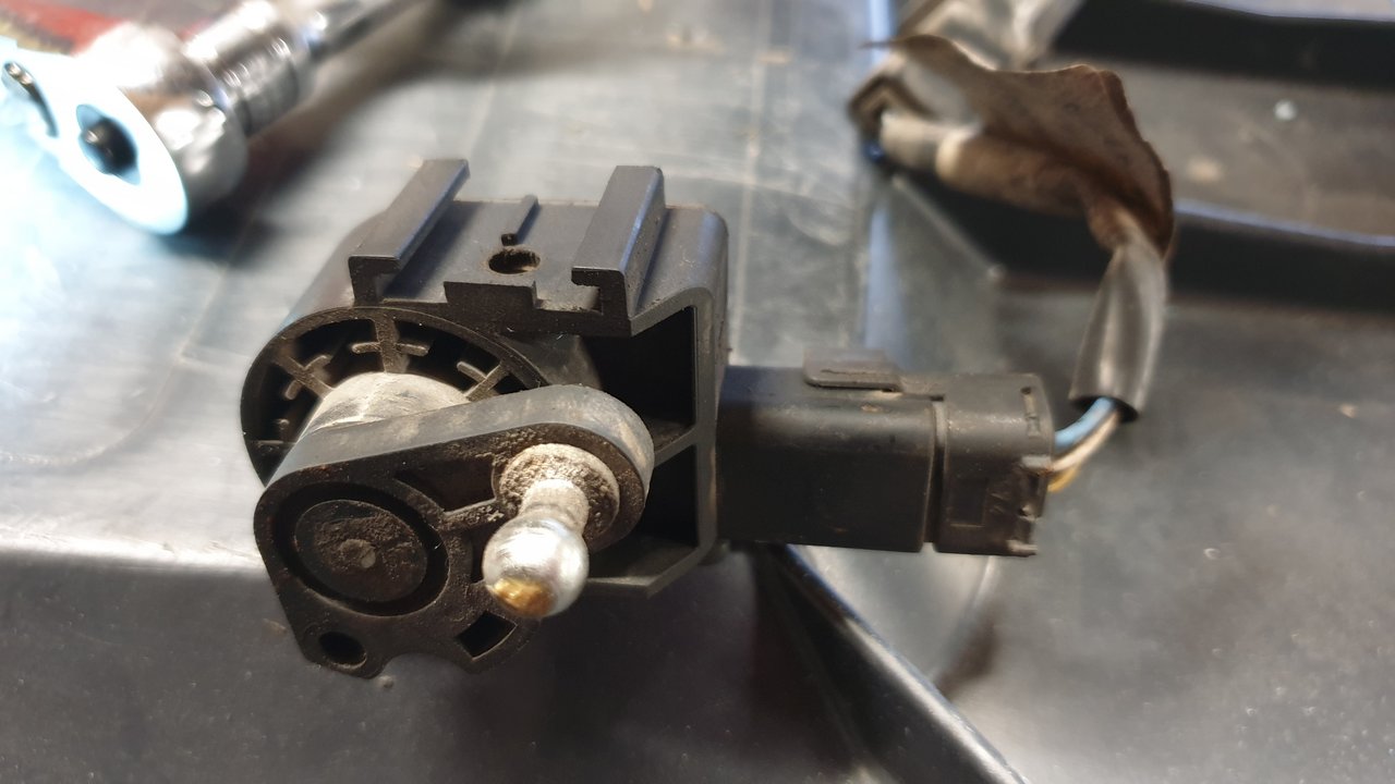

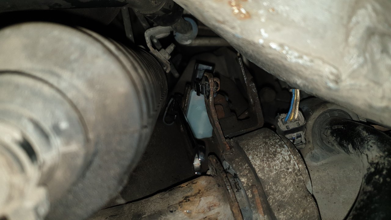

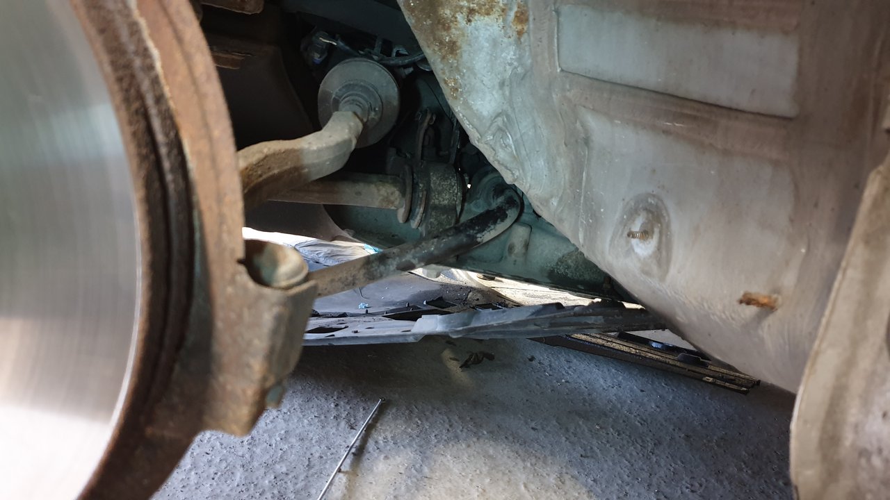

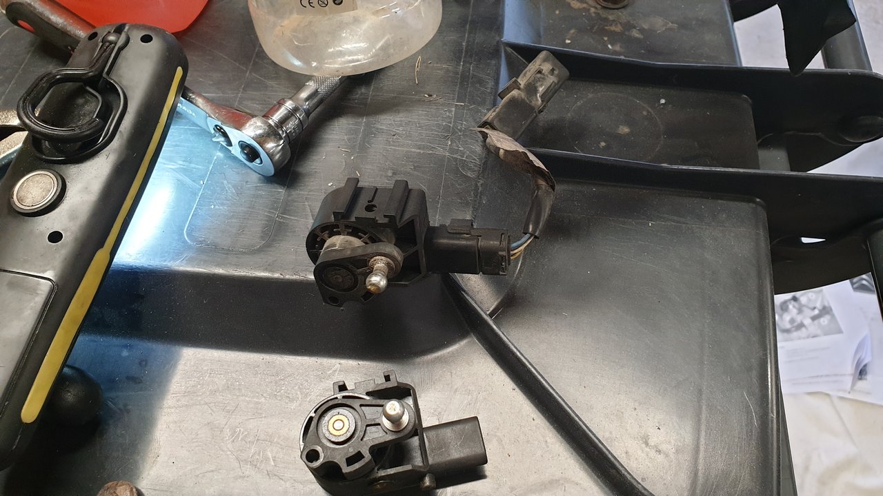

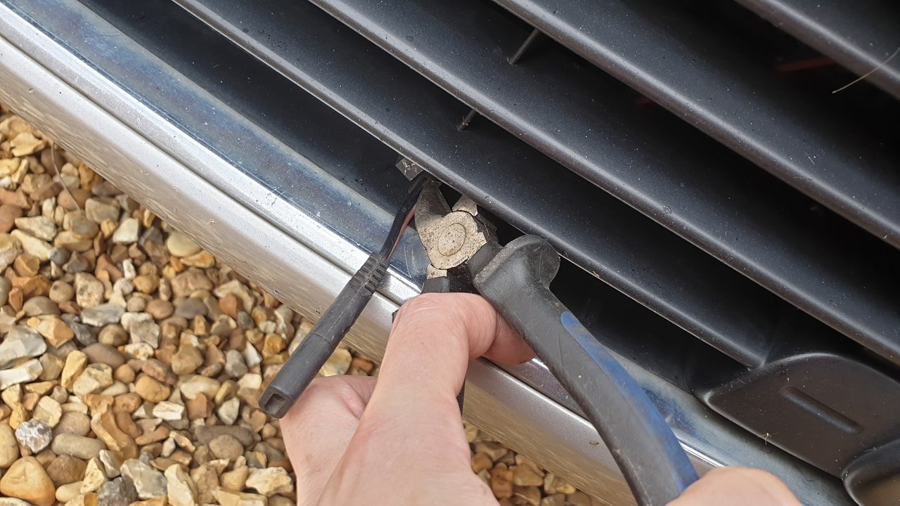

That sodding front height sensor
I made a separate thread for this one, but rewinding back to Friday I fitted the front suspension height sensor. The thread is here, and mostly shows me panicking, probably while all you lot were in the pub ignoring me... I had a nice conversation with myself before managing to do it anyway...
viewtopic.php?t=75981
But to catch things up for those who do not read the Citroen section, this is the sensor I needed to fit:
It's hidden right at the bottom, but on top of some big metal things, that I would not dare remove. So I eventually managed access through the passenger side wheel arch.
I got the old sensor out, and managed to fit the brand new one.
When I put the car back together it sank to it's lowest setting and would not let me have my trolley jack back...
Then worse still, the battery was too flat to start the car... so I had to put that on charge...
Then later that night I went and tried it - and hooray! The car started and the suspension went up!
There is an improvement, because normal ride height is no longer all the way up. But I am sure the car still sits too high at the front.
This is it... very nearly there, but just a tad too high. I'll let the garage sort this out when it goes in on Wednesday for the CAM belt and service.
So it's hardly a success... but at least an improvement.

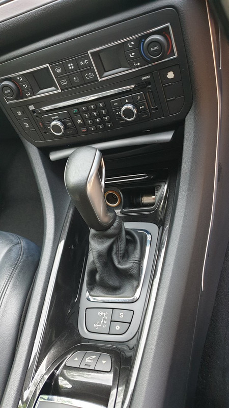

Sneaky but clean fun
After I fixed the wiper blades Sunday night, I got a little carried away and decided to do a little cleaning. The car really is dirty inside.

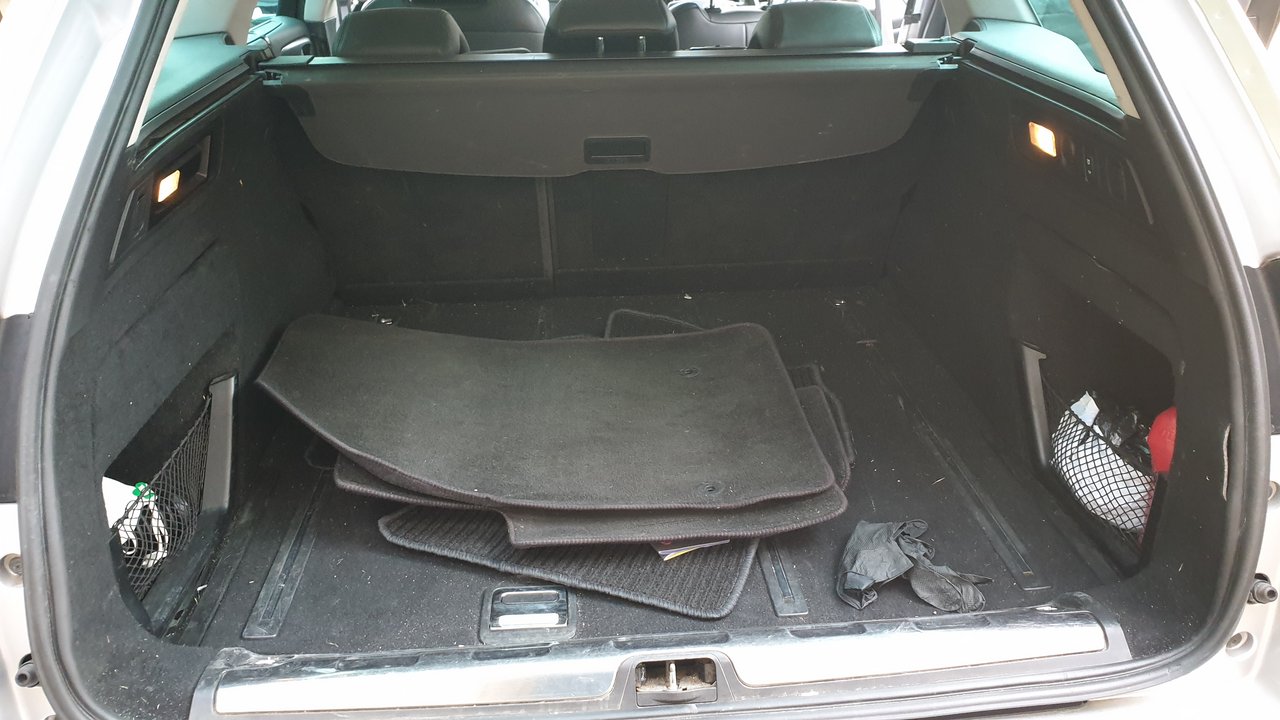

First I chucked all the car mats in the boot.

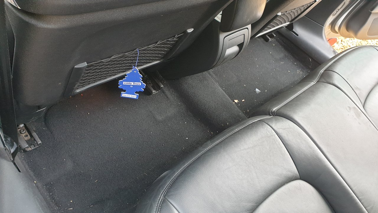

The carpets needed a super hoover front and back, but I decided to focus on the drivers side.
So I hoovered out the drivers footwell, and all the little bits of loose debris from the drivers seat. But the seat really needed a good clean.

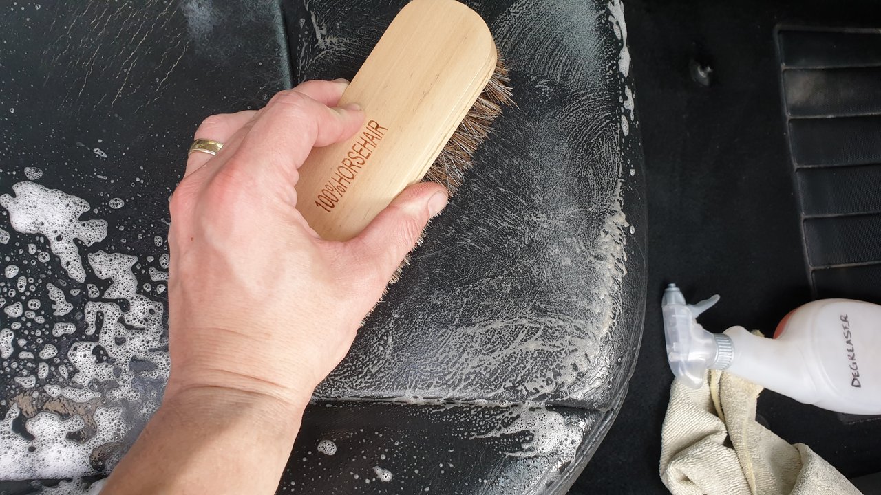

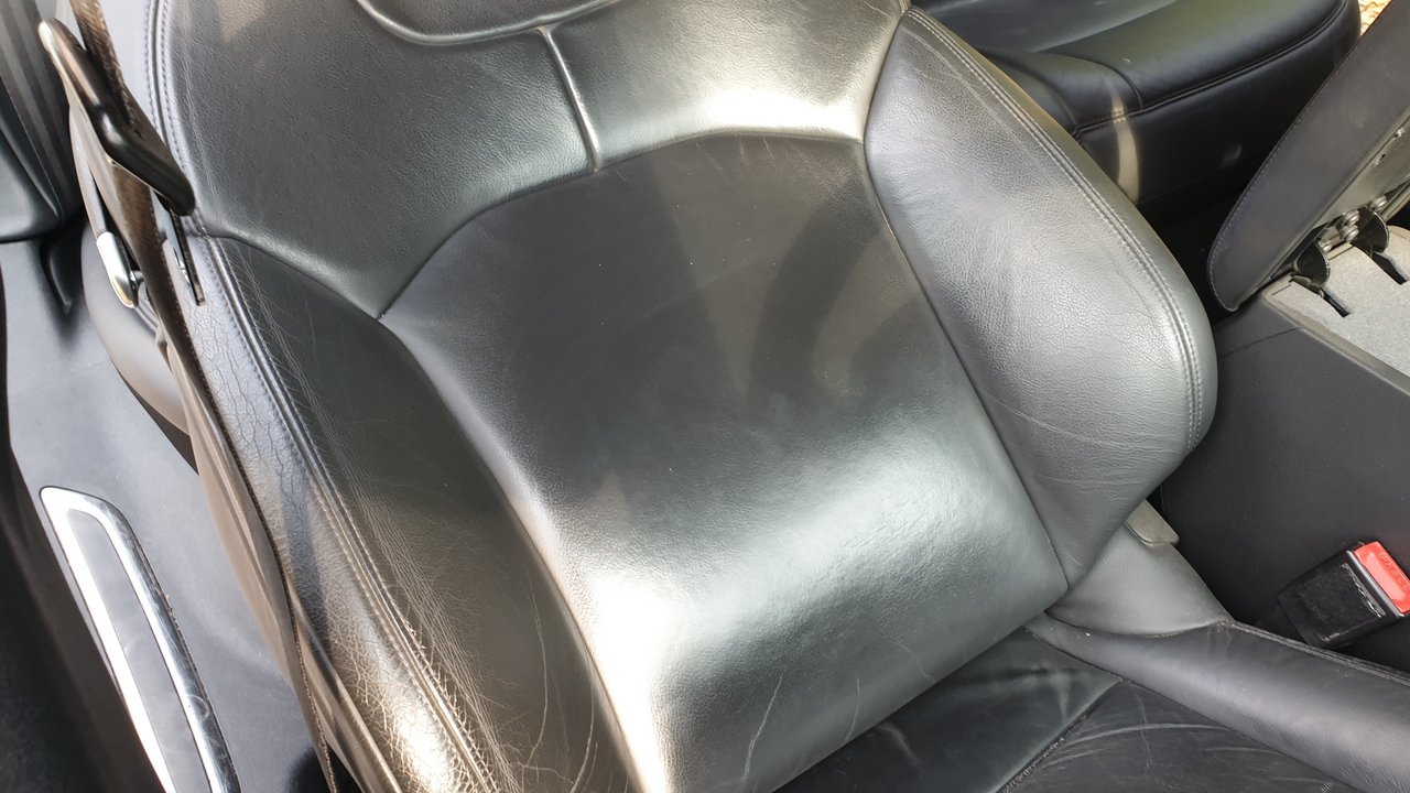

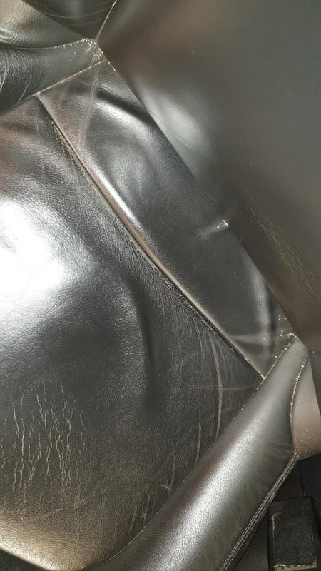

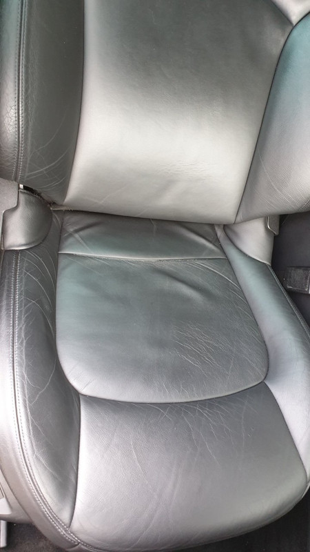

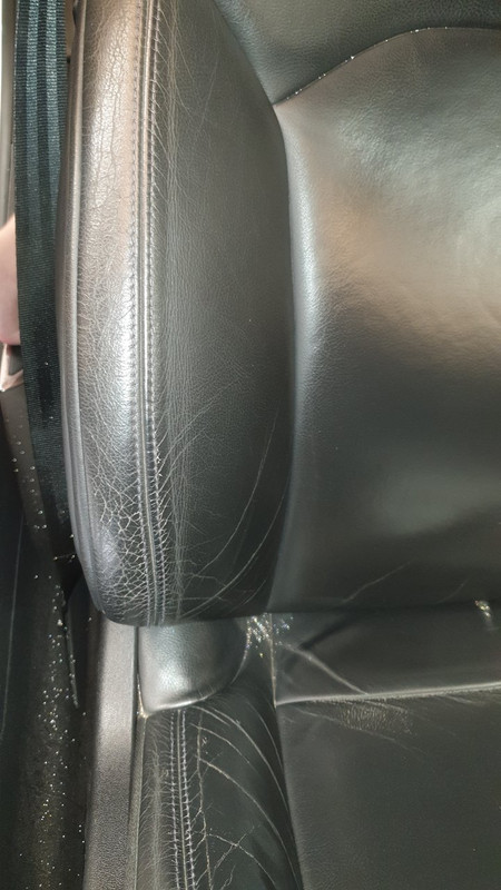

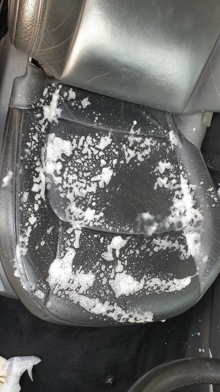

I used Meguiars super degreaser with water (50:50 mix) and sprayed on and scrubbed with a soft horse hair brush.
It got rid of a lot of the surface muck, and the shiny layer that I hate to see on leather faded somewhat. I am pleased with the slight improvement, and will follow up with leather dye to repair the scuffs, leather cleaner and then some conditioner - but I'll do the rest of the seats first.
Before...
After:
I then naturally progressed on to some cleaning of center console.
Drivers door card...
All scrubbed with degreaser and wiped.
But then I was cut short as Lindsey said dinner was ready... and it was getting late. That's why there are not many pictures, as I rather rapidly tidied and went in.
So that wraps up the weekend, and I am pleased with the progress... at least the car is back together and driveable now!
