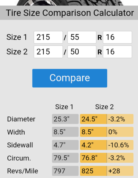

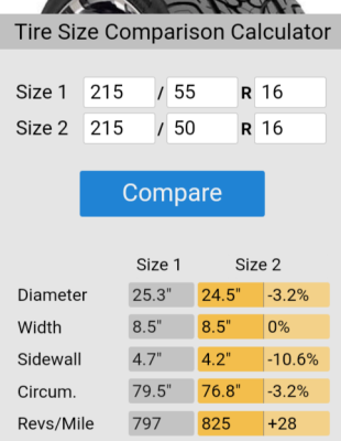

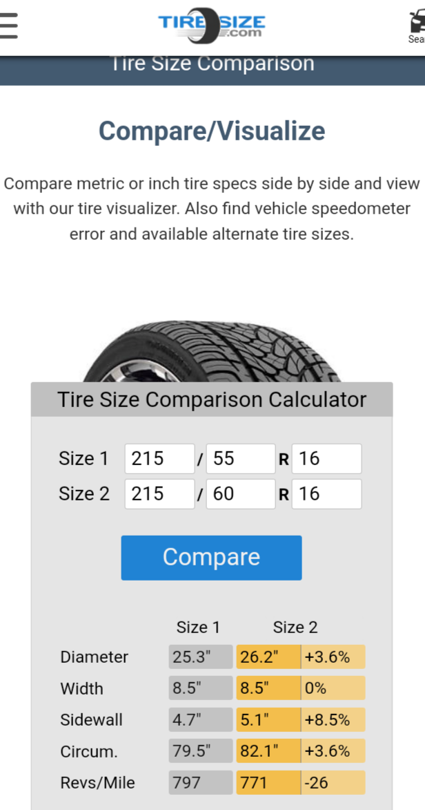

A good idea from an economy point of view but bear in mind altering the tyre height will affect the accuracy of the speedo, so make sure you do the distance travelled per revolution of the wheel sum so you are at least aware of which way the reading will be out and by how much so you can adjust the readings in your mind and stay legal when necessaryMattBLancs wrote: 20 Aug 2023, 14:04 I'd look "either side" of the suggested size
215/50R16,
215/60R16
Sometimes there's a more common size close enough to cause no issue.
I remember it was common to put 195/50R15 rather than 195/55R15 on the 306 Cyclones as they were about a third cheaper!

Yes, good point which I didn't mention,
Here's a good site (if you can overlook the American (mis)spelling of tyre
: https://tiresize.com/comparison/
I think the difference (5% aspect ratio change and calculated 3 and a bit percent circumference change) was small enough to keep you out of trouble but quite right it's worth a check first.
