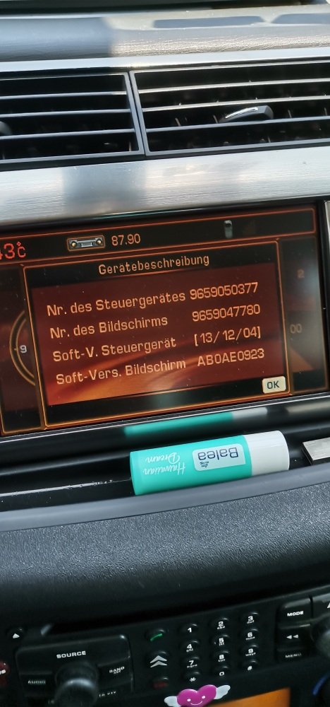

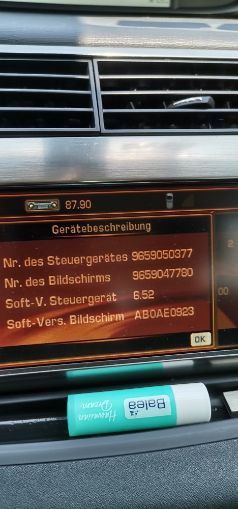

Re: Change language RT3
Hello everyone!
I would like to change the language on a Citroën C4 RT3 head unit.
Thank you very much!
- x 6963
@milence986: Check your Private Messages, but be aware that this firmware version you have will need to be updated to the version on the ISO Cd I have provided. So you will need to update it first, most likely before it will allow you to change the language!
