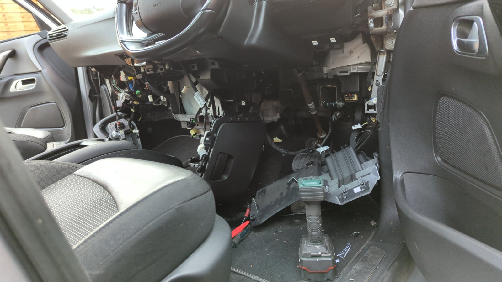

Hello everyone.
Can I have a little help with my heating system in my C4 GP B78.. I brought it like that and the last owner didn't mention that its not working properly.
So... its blowing warm(not hot ) in passenger side (UK ) and driver side its cold..when setted for hight temp, on low both side are blowing same cold temperature.
I have dismantled all underneath dashboard to have clear view at the entire heater block and to be able to see all flaps if they are moving, and yes all seems to turn as the construction plastic its pretty clear(denso).
The heater rad seems to be very hot on both pipes so I.m thinking its not blocked....
If someone able to sort it I.m happy to travel if needed..

My one was blocked internally so only part of the rad would get hot. It seems to be a common theme..... You can try and flush and clean it, I managed to get mine 80% there with white vinegar and hot water and shaking. But I couldn't find a replacement core, otherwise I'd just have done that.

Frenchiemech28 wrote: 07 Jun 2022, 14:27 This is a known issue on all 2014 onwards Picasso or 308 vehicles and there is a tech bulletin on the issue as well. Denso heater system and the cores clog often. The replacement core is cheap and it can be easily changed without dash out. Just loosen the bolt securing the heater pipes on firewall to allow the pipes to move freely and disconnect from heater core end.
Slide out the old core and replace. Genuine kit includes new clamps and O rings.
U can also fix by using a flushing tool with compressed air and water but due to access it's just as easy to replace the core.
