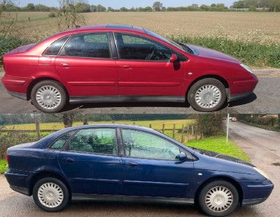

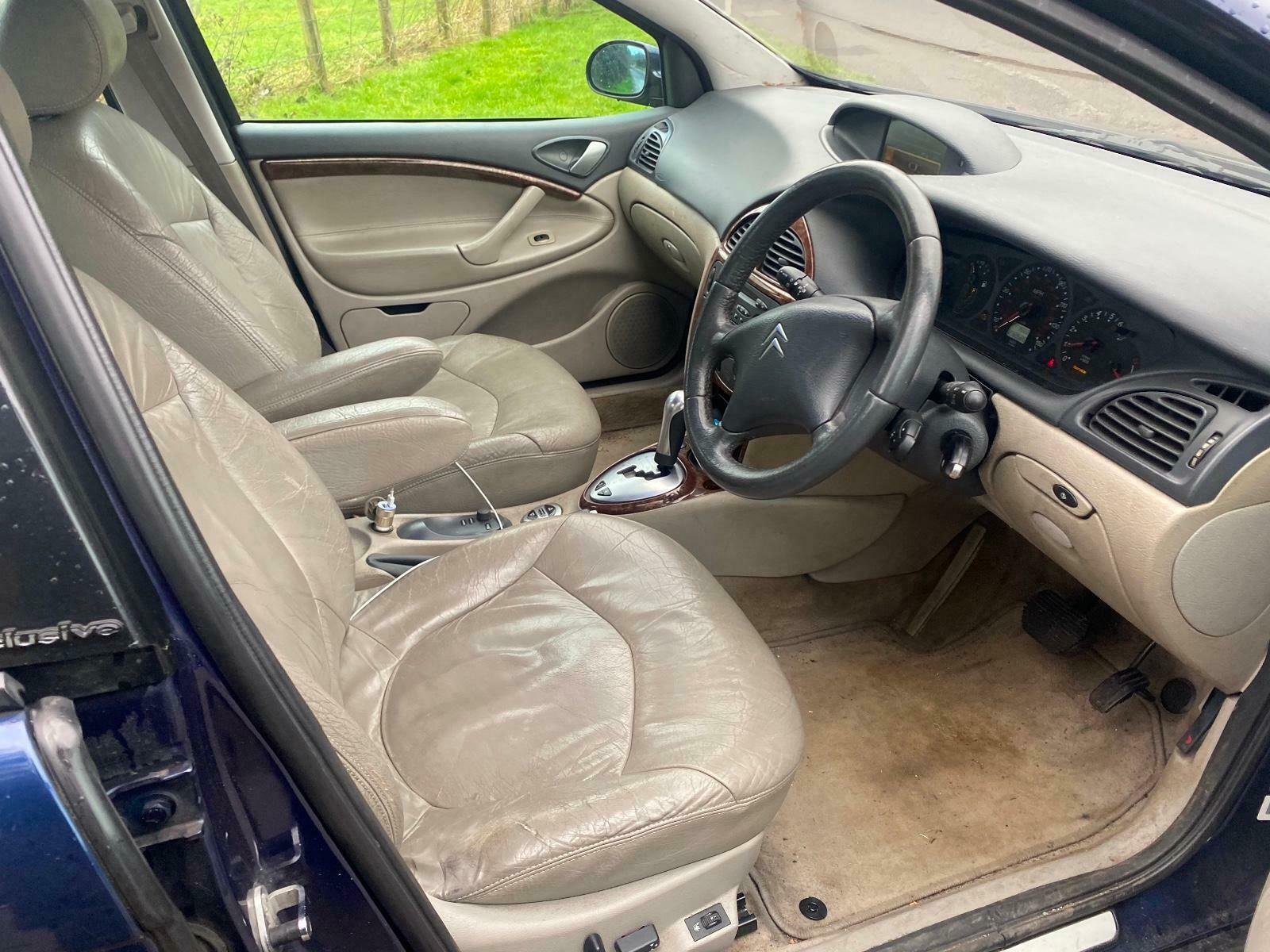

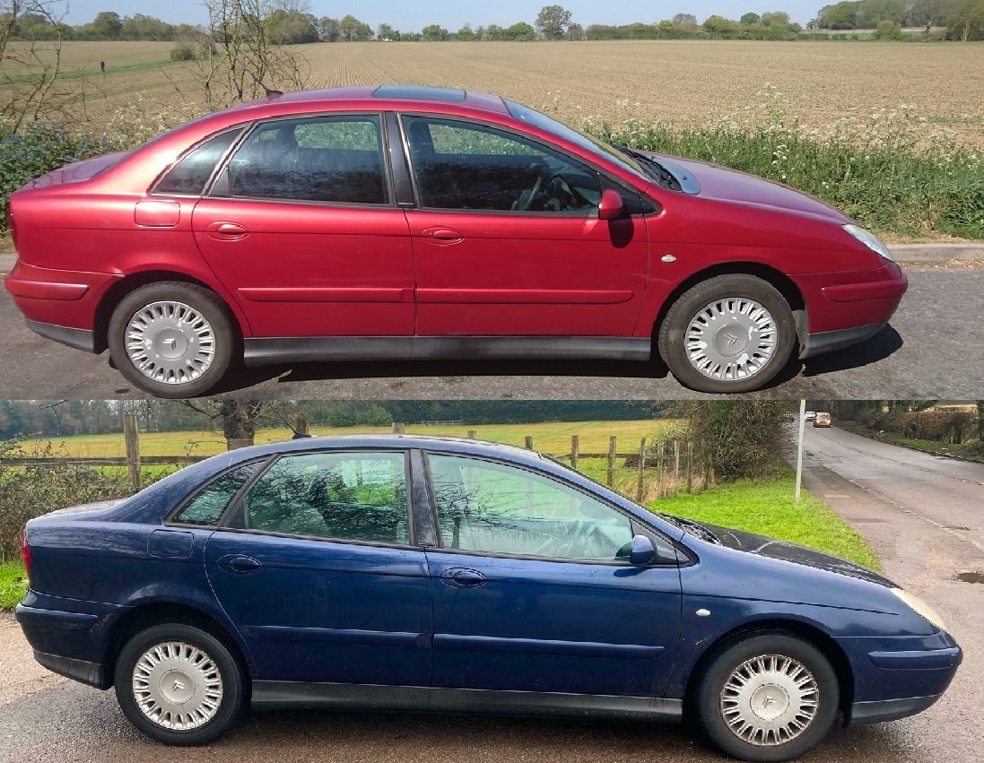

I did say I would take my camera with me but I forgot to use it so the only thing I have is from the ad where I saw the car. Here it is below mine, showing the difference in the wheels. You can see the beige interior which prevented me from a lot more bits!! I think the beige would have been alright had they done it all but retaining the grey dash top and radio surround makes it look too bitty for my liking!

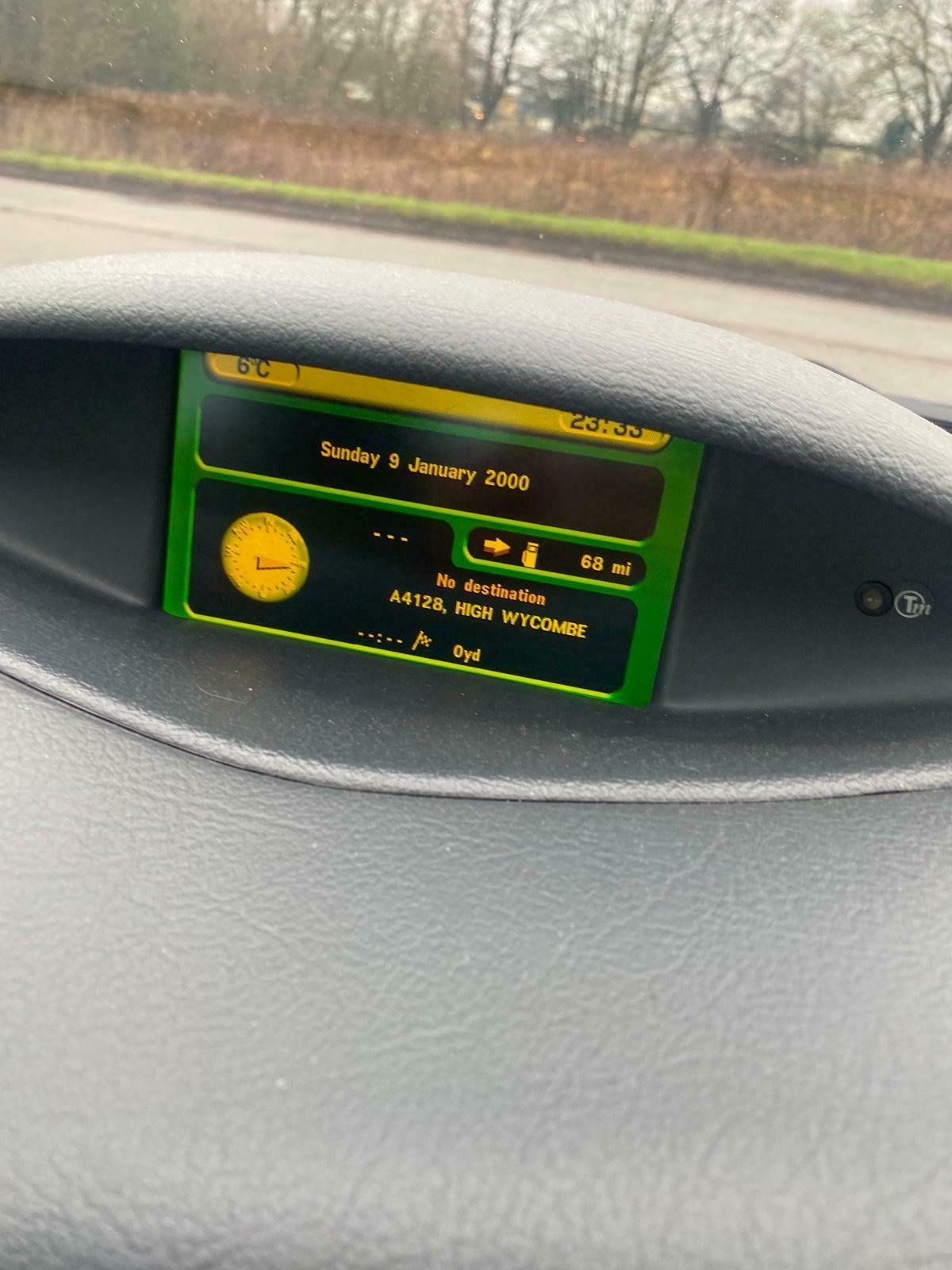

The issue is that the screen is used to display:1) The standard view which includes outside temperature, actual position, day and date and time, direction of travel, range available and current radio tuning status. then 2)Set up screen for adjustment giving options to set up display colours, brightness, language, etc 3) it provides the complete trip computer information showing two trips, range, current mpg and ave mpg, etc 4) aux video input for external camera etc 5) Sat nav map and aux nav information and directions, 6) navigation input and setup screen.
So without the screen you do not have trip computer info or Radio tuning info which are the main pains without which I could live no longer!! The sat nav and reversing camera you can get round but you can't do anything regarding the setup. The other function that interrupts any of those 6 screens is the display of warning and fault messages like "door open graphic showing which door or diesel additive low etc so without it you do risk things going awry!! The fault we believe to lie with degradation of the heat conducting paste on which the processing chips are mounted but when Dave stripped it down it was going to be far too difficult to safely remove and remount the chips concerned so I have put it back in as it does at least work for 15 - 20 mins each time at the moment so will be ok for local journeys. Over a period that time slot will reduce as it has in the previous 4 ECU's until it fails completely!!
