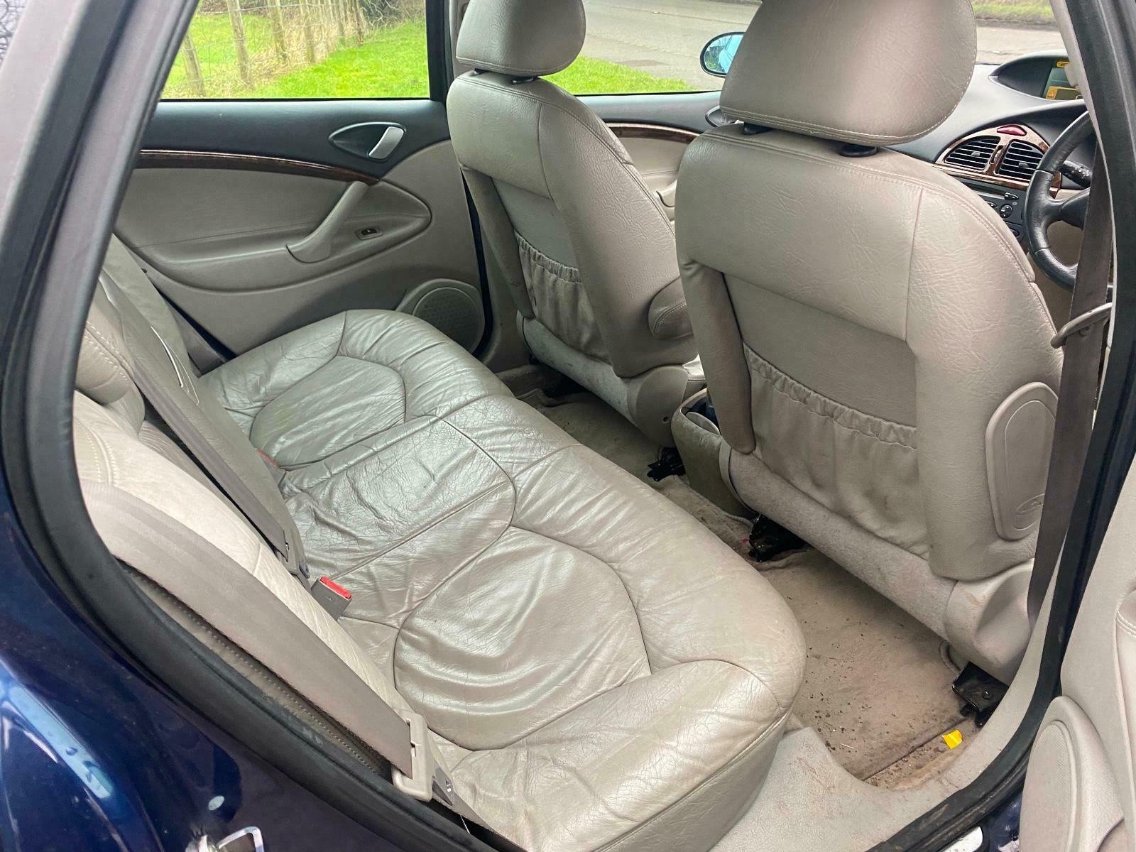

I did say I would take my camera with me but I forgot to use it so the only thing I have is from the ad where I saw the car. Here it is below mine, showing the difference in the wheels. You can see the beige interior which prevented me from a lot more bits!! I think the beige would have been alright had they done it all but retaining the grey dash top and radio surround makes it look too bitty for my liking! :)
