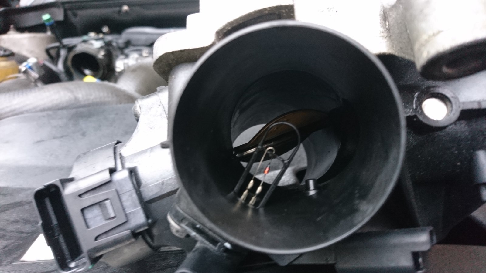

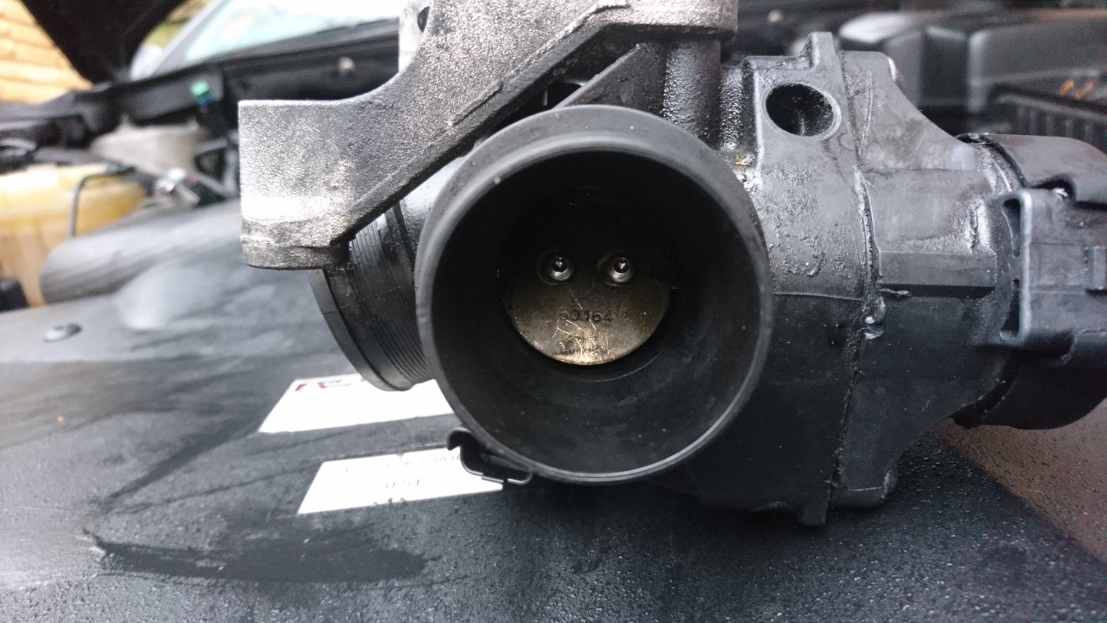

It has been a tad wet here today so have yet to investigate more but i have a question for you regarding part # 26 in the previous posts from Marc and my attempts to clean everything up.
The assembly has 2 butterfly valves and part #26 valve has 2 screws that will enable the butterfly to be removed and the main pin/sensor to be removed.
My question is should this butterfly valve be able to move by manual manipulation, it is something that has been bugging me since i cleaned it out.The other valve is moveable and will spring back into place, this one will move and spring back but not all the time and it did take some force to move it unlike the other butterfly valve which had free movement and always returned to its open position.
Just asking as i try to get my head around what the problems are with this car

Re: C5 2008 (X7 ?) Turbo Fault
Mine has 2 butterflies in a slightly different setup, both can move against the spring manually and return on there own. You can test both of them in diagbox actuator tests independently. You will hear them flicking back and forth.
Thanks Pete i need to get a picture up of them both, one is a flat disc, the other has curves on it if that makes sense?
The flat disc is the one that when removal of the Air Doser is in the closed position and did not return to its closed position when moved by hand/screwdriver. after lots of contact cleaner and prodding it did return to closed position but not the way the other one did, a quick prod on it and it returned to open position everytime
So that should open when the other one closes, if it sticks open moving it by hand then it possibly sticks shut when the vacuum pipe is trying to open it. An actuator test will confirm it's movement.

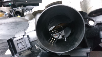

Pete these are the pictures of the Air Doser butterfly valve that i think is giving me trouble, it doesn't always spring back when manually moved
This is the one that does spring back to open every time
You can see that i have cleaned them both inc sensors

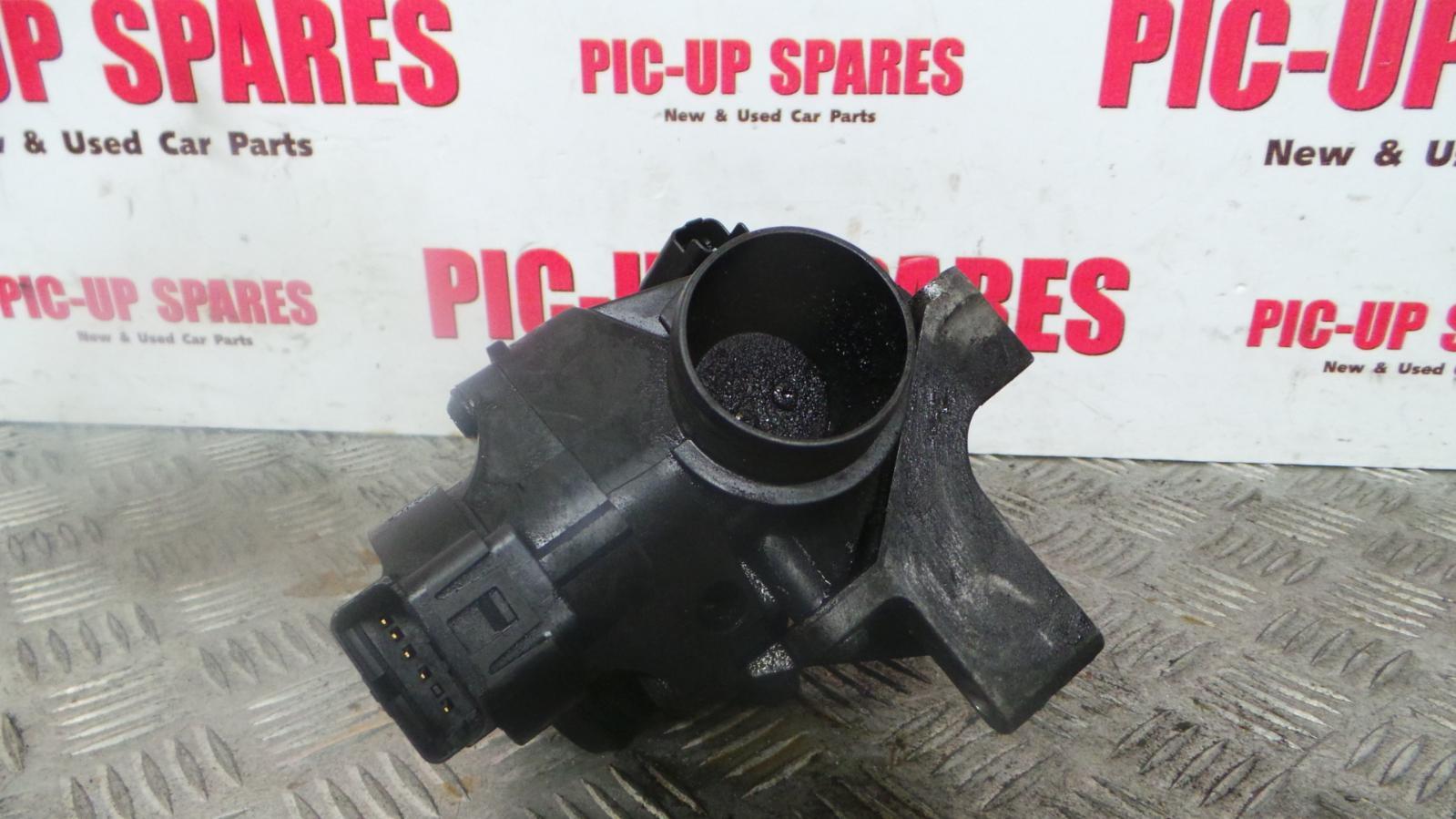

Not sure if this 100% the correct replacement part but it looks a damn sight worse than mine did before i cleaned it out
Here
But this one is the same and maybe a better bet
Better
Here
Better
