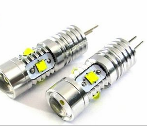

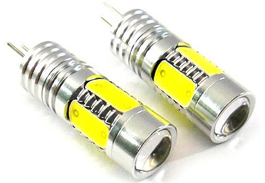

Right stress over. I should of followed my own advice and padded out the space under the headlamp with a towel to prevent the bulb dropping into the ether if it comes out the holder
So now these were the original replacement LEDs that I had. I should of realised when I first installed these that for the X7 DRL, the replacement LED does not need a projection lens as that is effectively focussing the top LED into the sky as these DRLs lean out at an angle of about 20 - 30° when mounted in the housing. It is therefore better to remove the top lens (I used a Dremel with a cutting wheel) and then once the fish eye has been levelled, I carefully ground out the plastic a mm or so using a grinding stone. Then I got a needle type screwdriver bit and picked out the remaining glue and lens material. This will now allow the top LED light to be diffused about the cavity and provide a bit more light as you can see in the second and third pictures. These had a claimed 580 Lumens per bulb.
Now that I managed to drop one of the LEDs into the Bumper area, I've decided to try a newer LED, picture below:
These new ones have a claimed 850 lumens per bulb.
Roll on delivery date and this time I must remember to shove a towel down the headlamp recess!
