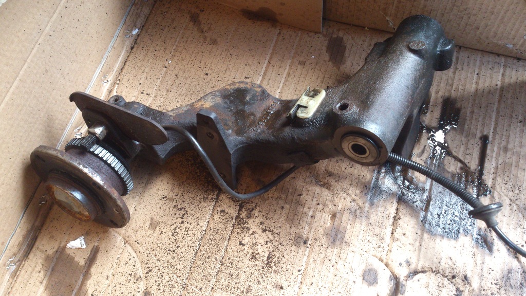

Anyway the arm bearings are done - took quite a long time today despite because of two problems: one the Xantia ABS sensors and two, the usually reassuring discovery that the arm bearings had previously been done so the car was cared for etc... wrong! Sometimes previous work is the cause of your woes!!
So the ABS sensor was totally immovable - in fact the thing was moving but it was the actual core part of the sensor was moving within the thicker metal part of the sensor and that looked bad. I opted to remove the caliper and disk to try and drift the sensor out from the outside but it looked more like the sensor was going to melt like plastiscine so opted to simply disconnect the sensor in the subframe and feed it out still attached to the arm - all went well then.
Arm out

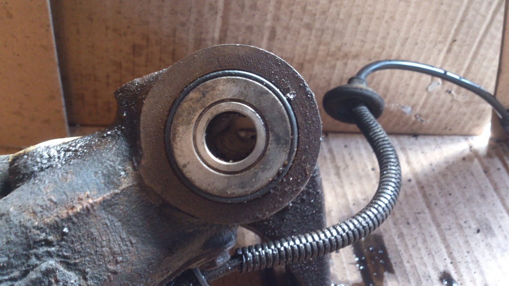

and looking at the outer thrust washers of the arm bearings they actually looked ok huh?
clean and straight - but thenI spied the other side..
that's how it looked - the rubber seal all pinched, the thrust washer (and hence the bearings) were wel off-center so at least one side was gubbed.

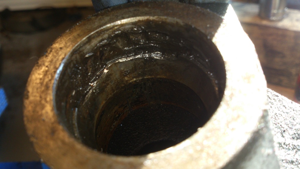

So after the usual arm bearing removal and initial clean up of the bits I found the usual thing of all the bearing rollers falling out and such but I was initially reassured to find the huge amount of grease packed in it looked like someone had done the bearings before. At only 77K miles I'd wondered if it would be the factory parts fitted but at 23 years old, Old Katy has had some attention in her time.
Good thing you'd think?

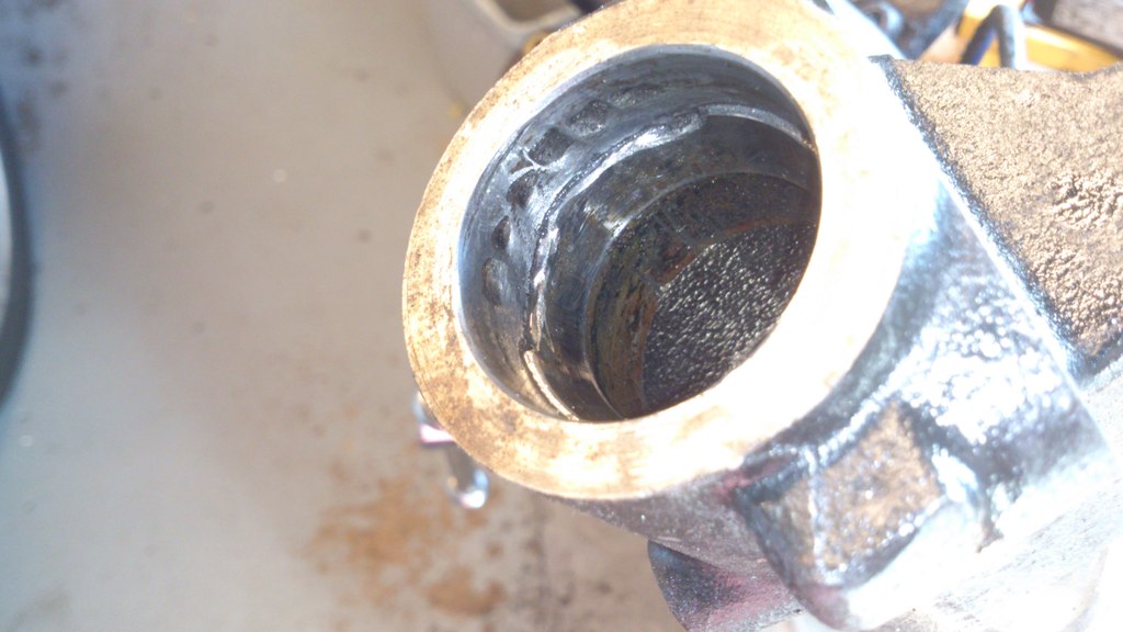

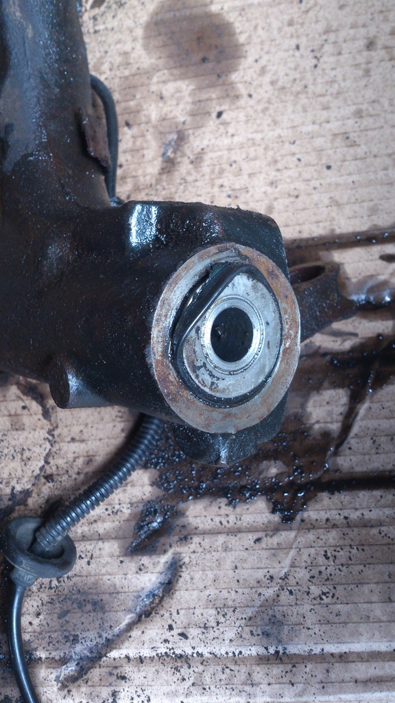

Not a bit of it as I discovered one side of the bearings (the most wrecked set) when cleaned up revealed that the bearing rache was missing some big chunks of metal and the machined inner part of the arm had a set of big nasty gouges in it where it looks like someone who didn't know how you remove the old bearing race had chiseled at the outward side of the bearing race/ arm to (I don't know) shatter the race to remove it but had instead wrecked the inner arm making it hard to now remove the race properly as it was all burred .
Here's what I found

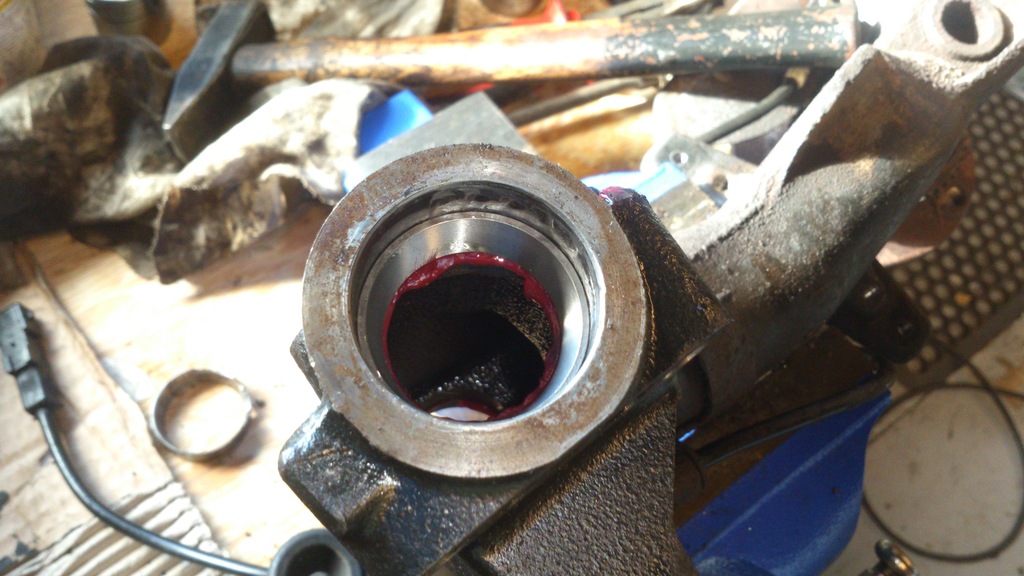

So the only option I could think of was to get the dremel out and grind back the burrs until it was possible to remove the bearing race.
Here it's ground down but the big dings can't be fixed. It looks worse here
And finally the first bearing race could be pressed in after cleaning up the messed up inner arm .
The other side was totally routine and in reasonable condition but this one arm with this find and the previous ABS sensor issue really delayed the job. I was half thinking of only doing one side - this being what I reckoned was the worst but with the anti roll bar out and everything I cautiously tackled other side and found the bearings to be in pretty good condition - both sets of bearings were still fully intact in the bearing shells but obviousy changed at the same time as the other side as the same kind of grease was used and the bearings were SKF with a metal bearing cage. Anyway the side looked ok but the bearing races had visible surface impurity - you could see the short path where each roller had been moving back and forth on the races and although there was no detectable (by feel) wear on the races I thought if I'm coming this far and I have a full bearing kit here I might as well replace the bearings and races all the same .
So the left side was much quicker and easier to change and now the full set are done.
Arm out
Here's what I found
