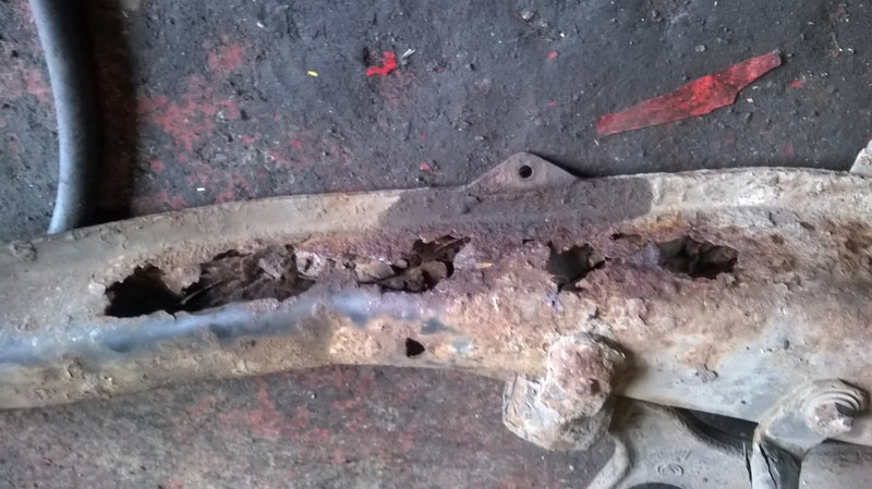

citroen synergie 2001 hdi 2.0 slx front subframe corroded

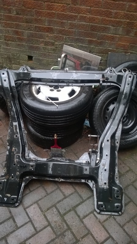

Recieved my subframe today, has been cleaned up and wrapped by the seller, almost as good as new. £48 delivered! RESULT!

Re: citroen synergie 2001 hdi 2.0 slx front subframe corroded
Got my subframe and nice n clean now ready for a coat of paint, I'd love to do it a stupid colour but maybe not! Hopefully have it under the car by the back end of next week

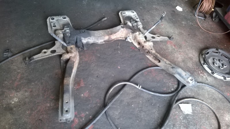

Today's the day! no not the referendum! the day the new subframe went in
Cast out the old.
Bring in the new
not surprisngly, the new one was a lot heavier than the old. No idea who passed this car at last years MOT, but they are seriously dodgy!
Cast out the old.
Bring in the new

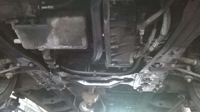

the second subframe didn't fit either and was flimsy and crappy the first wrong subframe was really good nick and strong, hes helping out by cutting the bracket from old subframe and welding it to the new one and drilling out the holes , there are big and small holes in different places and I have the second subframe which i need to return for refund
should be back on the road next week.

She's alive guys 12 months mot result
so good to drive her again. Mechanic took pity on me and only charged me only £200 for ten hours of labour top man £110 to fabricator £50 for mot and £30 pound for some sundries, i paid £55 for the subframe (110 they refunded 50%) £12 for bolts and £30 for a wishbone. Happy days
