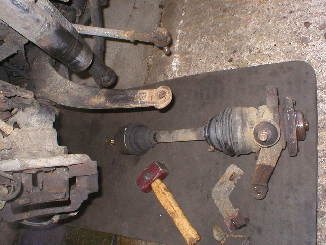

The driveshaft was never going to release easily from the hub despite a bit of judicious heat from the oxy set so I removed the shaft with hub attached! Success and nothing sheared, not even the delicate little ABS sensor bolt

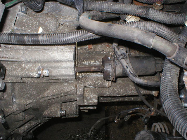

I also released the slave cylinder from the gearbox and confirmed definitely that the release bearing has pulled out of the diaphragm. I's clear to see where the pushrod has massively over-reached but luckily no fluid leakage so a gentle push back should see it all good again.. Dangerously near splitting the gearbox from the engine now...

Maybe if the hydraulic puller ever turns up Davie that'll do the job. Currently it's 'delayed' with UKMail parcels. They've had it for three days now but don't say why it's delayed..... They seem a bit shonky to me.
But yes, if a gaiter or a wheel bearing goes then a new hub and shaft may be the only answer.
But then again, if needs must there are other ways of extracting it such as dismantling the CV joint and then putting it in my hydraulic press. That will do the job for sure...
To be honest, I'd love to know the reason why they are both so tight....

Well if you want to find out just to satisfy your curiosity go for it. If it takes longer to get the car back I don't mind. Your puller is the same as my discs then. Ordered at the same time, pads delivered, discs lost. And while I am on loan mode I have not had a refund from Mr auto for the first clutch. They shall be phoned on Monday.

Oh dear, we're both seeing some shonky service
No, I shall not try too hard with that shaft as I don't want to damage anything...

Give it a try with the new puller, it will get a good test. But as it doesn't really need separating well at least I will know the hub won't fall off [emoji12]
