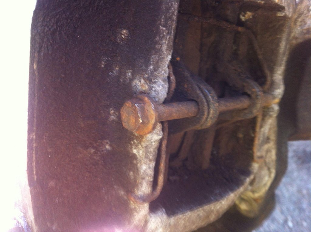

One thing that I think might be a concern which I forgot to mention in all the hullabaloo is this:
The pad retaining screw doesn't seem to have much of the caliper to "hold on to" on the surface nearest the bolts (it does on the other end), is this normal, or is this something that would mean this caliper will need replacing?

Needs a new caliper.... I strongly suspect you are going to need new pipes as well - I can't see them getting that union out easily (at all....)

Re: Failed "MOT" - rear brakes
Hindsight, should have taken the rusty plate off before posting the pics earlier in the thread
Oh well at least we know if someone else comes asking.
I've found some calipers at our equivalent of halfords, for ~£60 a pop, so hopefully can get someone to pick those up for me today.
I guess at least with a new caliper he can take the brake line back to the nearest join and replace just that bit of pipe too.
Wow that's new on me.
If your feeling a bit fed up over this Ben it was a decent attempt and you didn't really stand a chance.
You did well to back out before fluid was going everywhere.

The pipe is rather long, non standard flare, and awkward to replace unfortunately
In the UK it is easier to fit a copper nickel replacement, but not sure if this is allowed in Sweden (it's not in Germany AFAIK).

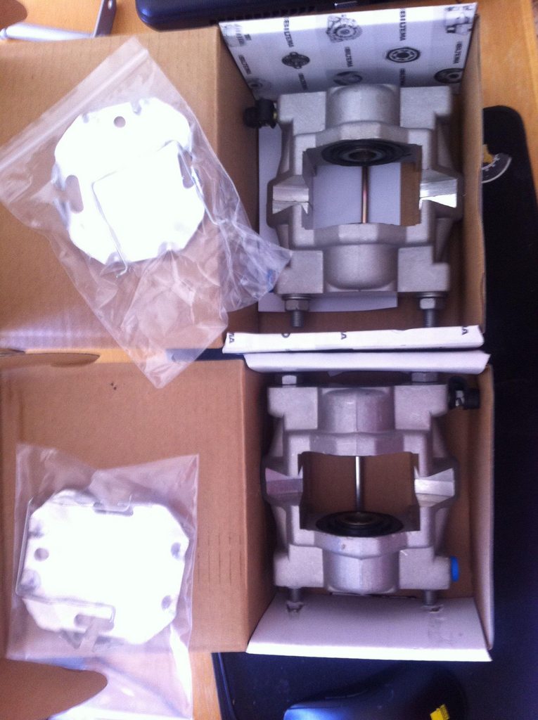

Mother-in-law has just arrived with these:
So will be taking those down to the mechanic shortly. They look very similar at least ( without the corrosion of course
), and come with all the doodars.

- Posts: 14308
- x 3306
Nice mother-in-law!
£60 each seems v.reasonable for those ...

Rear calipers rotting on C5s is not unknown - Citroen appear to have made them out of some specially reactive aluminium alloy! AFAIK dealers faced with this job just cut them off and fit new as the hassle with trying to remove the bolts from the old ones is not worth the hassle / cost (at dealers rates).

Partly it's the exchange rates that are helping recently. 2 years ago they would have been the equivalent of ~£80 each. Not complaining reallyNortherner wrote:£60 each seems v.reasonable for those ...
One problem with getting stuff from Biltema (the semi Halfords equivalent, kind of doing them a disservice as I think they're better than Halfords) as everything is their own branded stuff so it's not as easy to gauge the quality etc, and sometimes getting stuff for the car can be a bit hit and miss. (e.g they do calipers, discs and pads for the rear axle of my car, but nothing for the front, front wipers, not back).
Dad was in his element though when we went there on Sunday, he couldn't believe some of the tools you could just pick up off the shelves to buy there.
