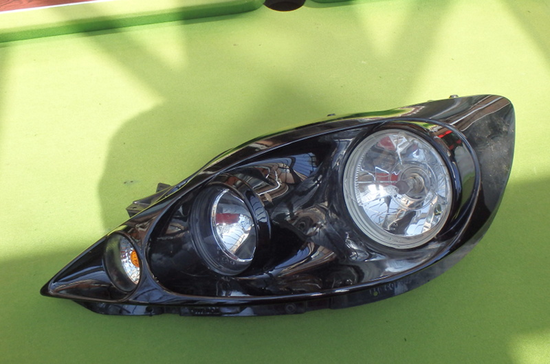

The headache I think is that the car didn't leave the factory with them - they were a dealer fit accessory. This is the whole headlight assembly.
The unit as a whole is fine, it's just the larger dip/main beam unit that needs to be changed as the lens is cracked. However it appears that the size isn't a particularly common one for anything aside from motorcycles. Should have measured it while I had it out but forgot, from memory it's 5 1/2" diameter.
Annoyingly, nothing has any part number on it, the only number anywhere is stamped on the lens, which I assume is the Hella part number (992.981.01) which I have punched into Google without any success.
They weren't cheap when new, so I would really like to get them back on the car again. They do a far better job of lighting the road too (especially on main beam as you'd expect).
I've seen similar units on 106s and 206s in the past, but have never had the opportunity to measure them to see if they are the same size.

Remember all those accessories, these were in a separate brochure which included things like the mesh grill, a carbon fibre (I suspect fake!) Insert for the rear bumper, and the lights I have here among other stuff I can't remember. Still have the brochure, will scan it tomorrow if I get a chance.
They came from Peugeot directly (made for them by Morette) so must be on a list somewhere...just goodness knows where. The whole kit if my scribbles are correct from when I was ordering the car is VAL291. I don't want to spend three hundred odd quid though for the whole lot though!
I have pinged an email off to Morette themselves asking if they can supply the part in question, but no response as yet.
I do find myself wondering if they honestly just are generic Hella branded motorcycle headlight units in there...tempted to get one and compare the beam profile. Failing that...so long as the diameter is right I could in theory probably just rob the front glass off the replacement, though I don't know how hard to separate they would both be...I have successfully re-sealed headlights before at least...

Yep, that's about as far as I got with anything. The kit as a whole I can find from a few soirces for anywhere between two and four hundred quid. Wheras all I want is the main lamp unit out of it, which one would think would be a pretty generic part. Most of their actual lighting bits are sourced from Hella and Cibie as I remember, it's the housings and such that they design and make.
A lot of this style of kits (including I think the one for the 306) use the "standard" size of round lights formerly seen in sealed beam units, and on Land Rovers, Minis, Capris, MGs, Golfs etc. These are NOT that size, and are an inch or so smaller. Fallen into that trap already! ...those will fit the van though so kept them around.
Hoping that Morette will speak some common sense...though I reckon only if my luck changes!

as you said earlier see if there are any makers name and or numbers on the lamp units them selves
