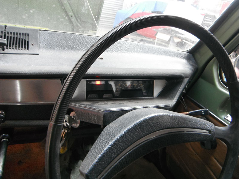

Key in the ignition (which you turn towards yourself and is on the left of the column, counter intuitively) and see what happens. Oooh, an ignition light! We didn't have one of those last time we put a battery on the car.
Soon we realised that more work was going to be needed, connections cleaned up, bulbs replaced, that sort of thing. On trying the various controls we found the wiper motor works at speeds Slow and Not As Slow, the new wiper blades were fitted when the screen was cleaned and that proved entirely satisfactory. The blower fan works, and blows both Slow and Not As Slow, so again that was deemed adequate. Sidelights and front indicators did nothing, indicator switch did nothing, headlights worked on dip and main (twist stalk for sidelights, pull down once for dip and again for main), we tried the hazard switch and one indicator worked on the rear. Here's a boring video.

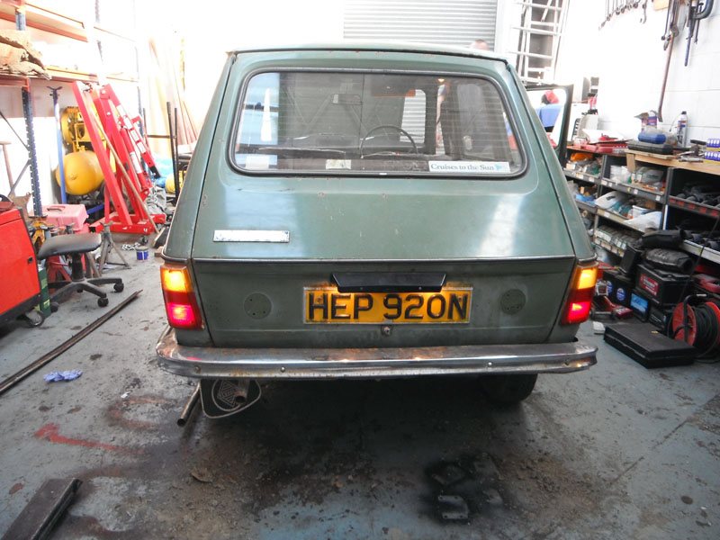

Rear running lights work and, after the switch came unstuck, so did the brake lights. Reversing lights were found to be purely decorative, there's no wires at all running to them and by the looks of things never were on this car so the tailgate is probably off another car, perhaps the same donor as the other metallic green panels came off as this one was also metallic green (that's at least one front door, both inner front wings, one outer front wing for those keeping tabs). Here's an even more boring video.
Also learned that the passenger side lens is the wrong type but that it's because there were two manufacturers offering the same rear light with a slightly different design. Info from R6 guru Mr Reno on that one. I'm going to replace just the lens as the one fitted is not only the wrong type but also appears to be from the wrong side of the car. After some jiggery pokery and a full compliment of new bulbs we had both indicators on the back working.

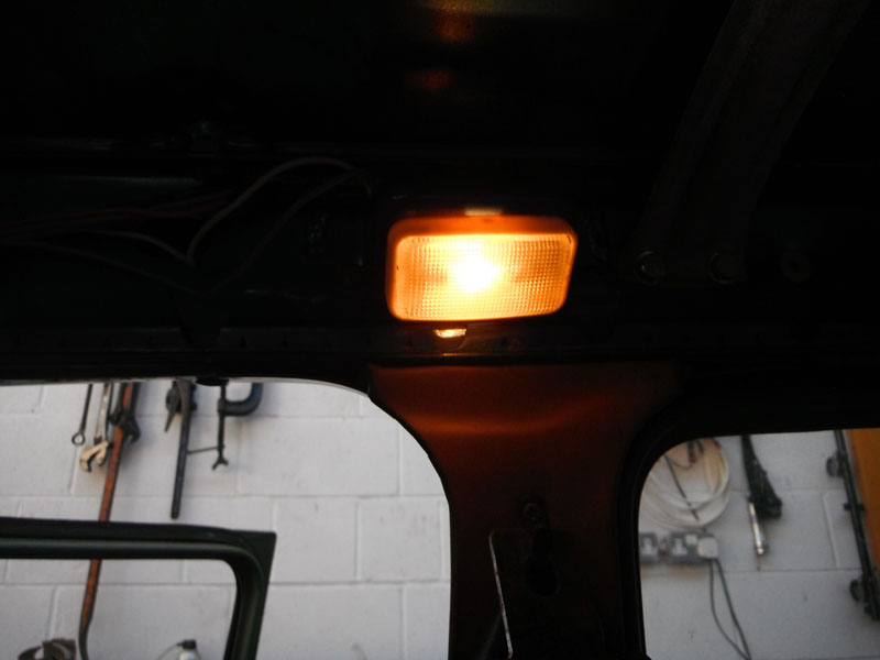

The interior light works, both door switches operate with the passenger one needing a bit of a clean as it's a little sticky.

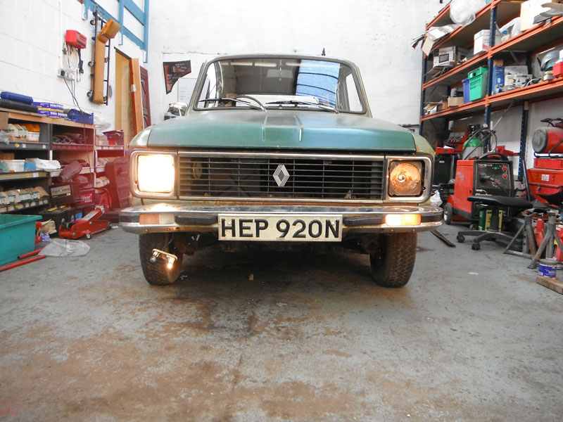

Up front, everything but the driver's side indicator works. We've not found the reason for this yet, we suspect it's a bad connector or earth somewhere, we just ran out of time to investigate further. Used the old headlight bowl just to test the new bulbs and see that things worked. Rather than use the original golf ball type halogens I used a variant that has the same mounting bracket but is more like an H4 in shape. It ups the light output considerably without looking overly modern, a sensible modernisation. I've already forgotten what the bulb type is called.

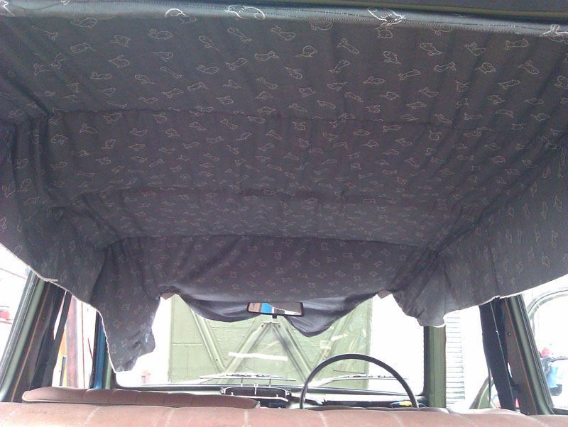

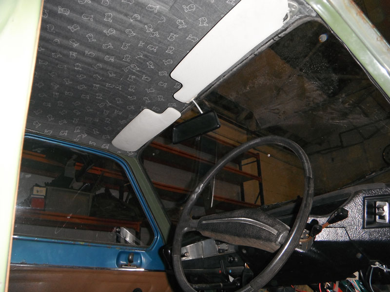

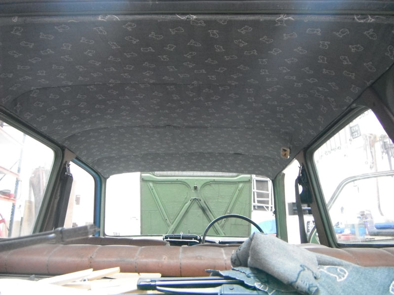

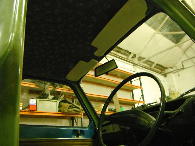

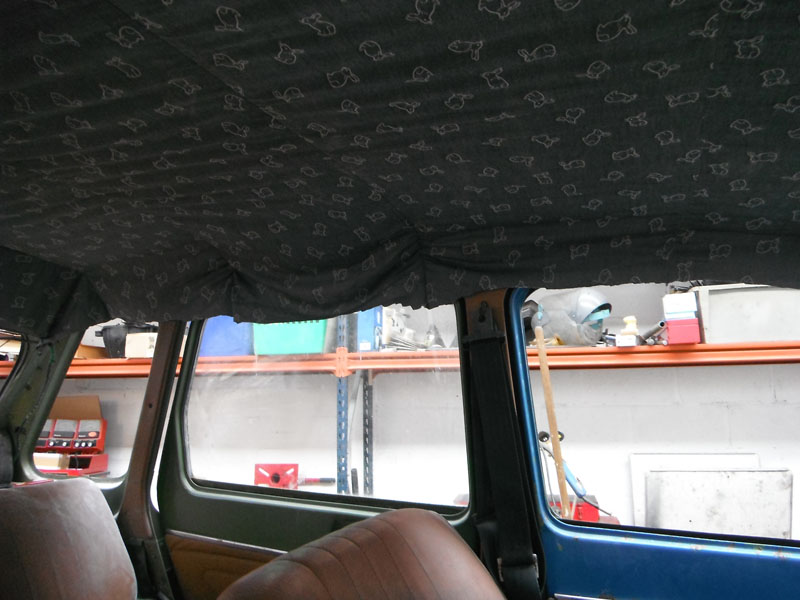

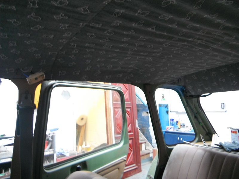

Headlining made today and first fit attempted to check everything was as it should be. This style of headlining is very easy to make, it's essentially a length of fabric with pleats in to hold the wires. The key is getting the pleats in the correct locations so you have good even tension front to back. On the whole I managed that. I salvaged the plastic strip from the old headlining that goes into the tensioning strip at the back of the roof and sewed it into the new headlining. It won't be seen when fully fitted.
At the moment this is just loosely in on the wires. For the most part the tension is really good, at the back especially so. The wrinkles will disappear when I put the side tension on, a job I'm saving for when I know I don't need to do any more work with the wires that run above the headlining and the welding that the roof and passenger side gutter still needs.

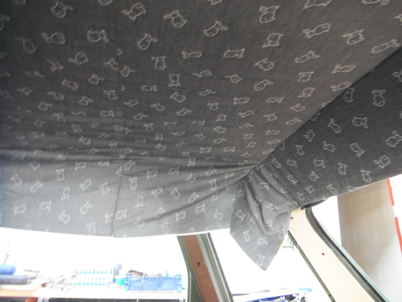

The front wire I've misplaced slightly, not by a great deal but by enough to cause a sag that you can't pull out. It's an easy task to relocate the wire and refit.

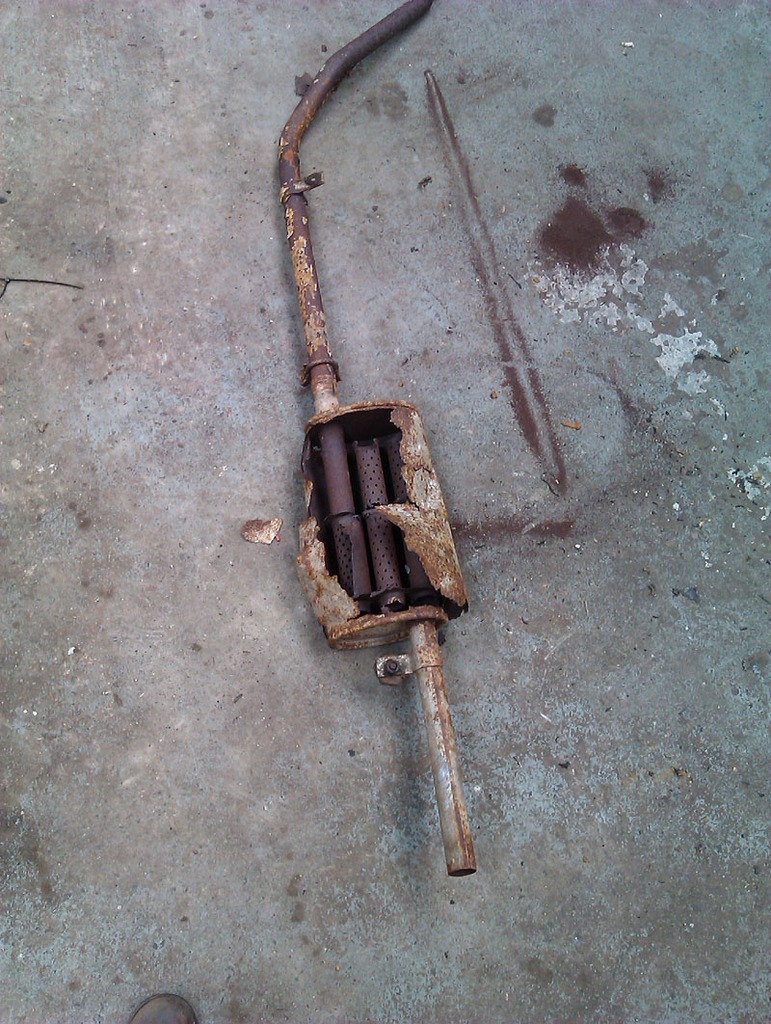

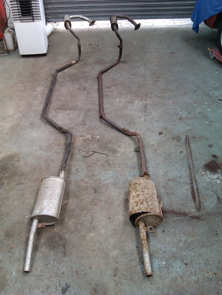

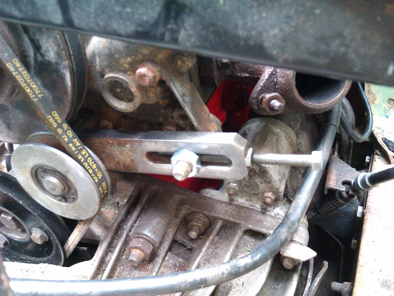

Few little jobs done today, not a huge amount, but a bit. First up, getting that old exhaust off. It was rusted up and even though the nuts came undone fairly easily the backbox did not want to let go so I just cut through the main pipe as it wasn't worth saving. The old exhaust could be sacrificed this way because I had a whole new system to go on. New on the left, old on the right. In the second picture you can see just how comprehensively ruined the old backbox was.
The tensioner was cleaned up and fitted complete with a new nut.

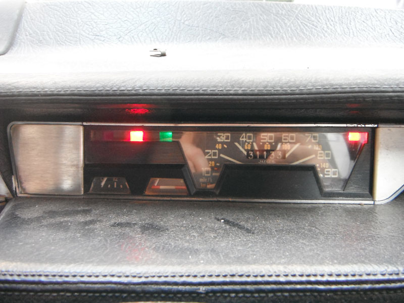

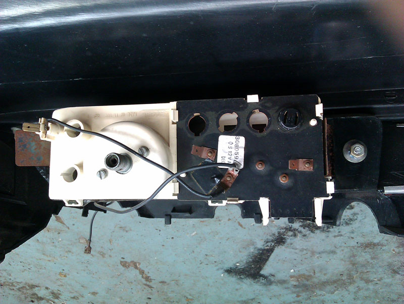

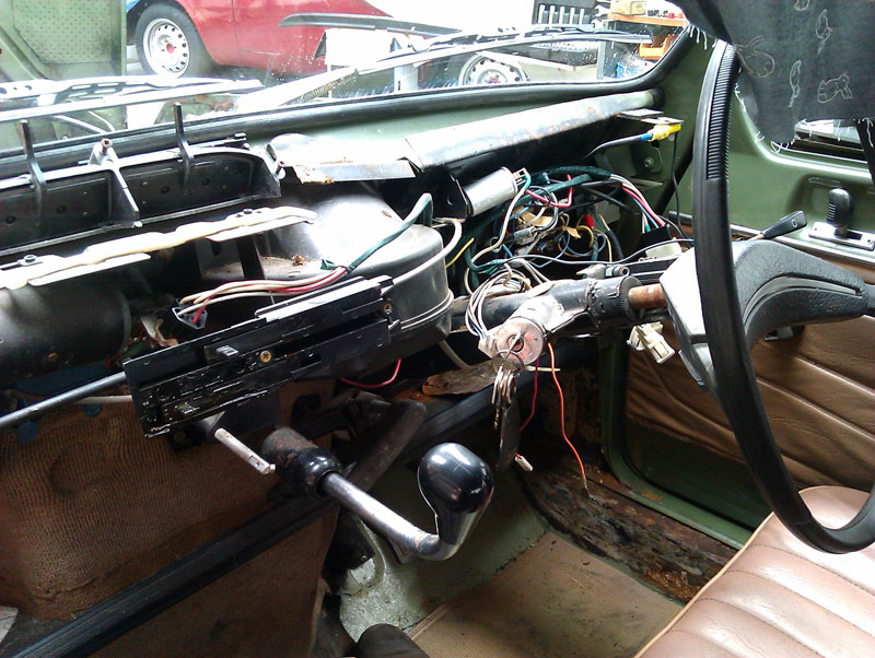

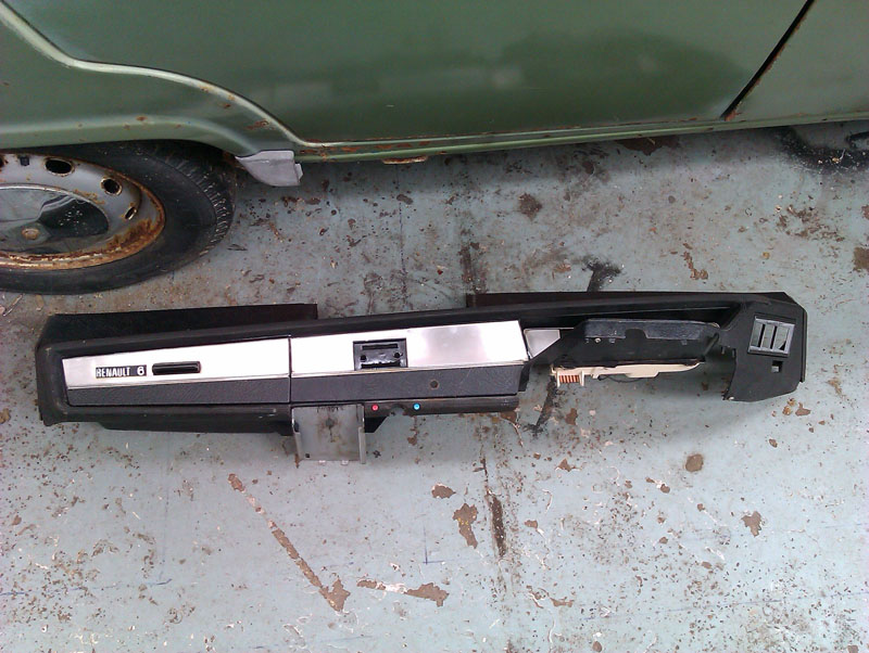

Anyway, enough Divine Comedy for now, here's what little there is behind the dashboard. With it all out there was a delightful lack of bodge or wiring danger. With gentle persuasion the hot/cold lever was made to move again, spending a long time just wiggling it side to side until now it moves with the proper lever attached. The fan control panel has a smear of some sort of gunk all over it that was hiding behind the decorative plate, which seemed a bit odd. All of the dead wasps were vacuumed out from behind the dashboard too.
I was very careful with the dashboard, it's 40+ year old plastic and rare in right hand drive format, I'm highly unlikely to find another. It will be a lot easier to clean up properly out of the car.

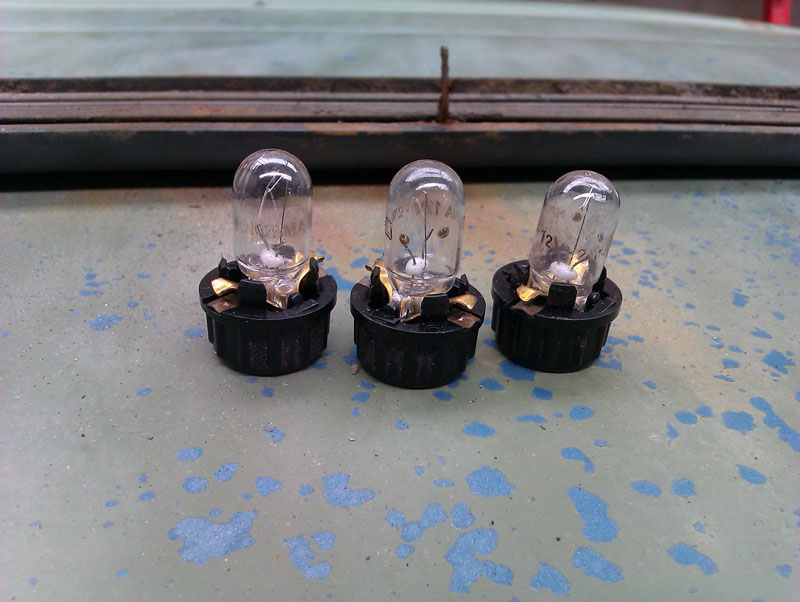

I could now inspect the bulbs too. At least one appears to have blown so I'm just going to replace all 5 of the bulbs with new ones. I notice there are what look like two empty sockets in the white section of the cluster, there doesn't appear to be anything that fits in them and I'm not sure if that's by design or not. I'm also uncertain if this car even has a dip/main telltale.
The bulbs are push-fit into little holders. I can't imagine these are any fun to change with the dashboard fitted.
Happily, I managed to resolve the issue with the sagging headlining section without doing any sewing. In the roof sides there are holes that the tensioning bars slot into and at the front there are two identical holes set close together. I'd just put the bar into the wrong hole, fitting it in the proper hole put a healthy amount of tension across the entire headlining.

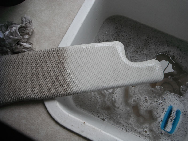

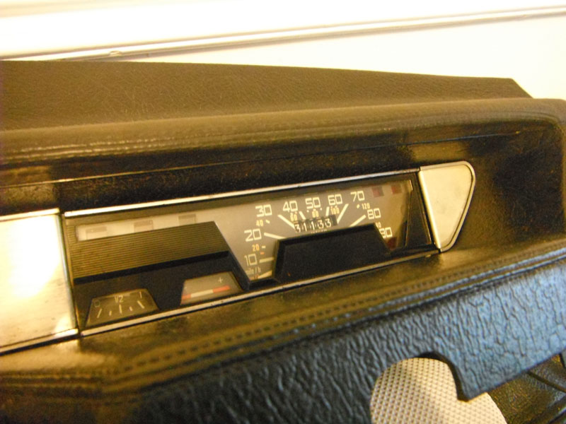

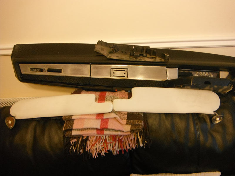

Last night, in readiness for a few hours of Renault repairs today, I got the dashboard and sunvisors into some soapy water so they can go back in sooner rather than later. It was a little bit grim.
Caretaker Kes had already done a cracking job on the brushed metal trim on the dash. All the plastics, however, were covered in dust and mud and that grime you get from someone smoking in a car for a very long time. Didn't realise how smelly things were until yesterday when we came back to the house and it stank of stale tobacco just from having the dashboard in the living room for a few hours. Nasty. All clean now, happily.

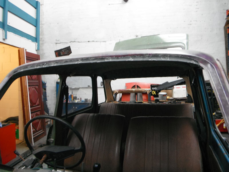

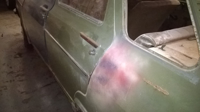

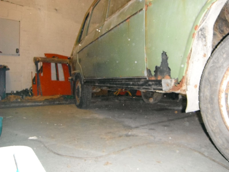

Today I intended to get the passenger side gutter sorted out and ready for filler and paint. I got as far as the first stage of trimming back and tacking so I can build the repair sections where needed when the welding gas ran out. That was quite annoying because until I've repaired the roof there's a few jobs it holds up. The headlining can't be fitted until the roof is repaired, which also means the windscreen can't come out to have the leak sorted and the dashboard has to wait a bit longer before its refitted. Still, it's a bit of progress and a bit of rust removed, just got to wait on the new gas bottle being ordered and delivered now. The roof this side isn't quite as bad as I'd expected, I should only need a couple of very small pieces of new metal let in where the old has dissolved.

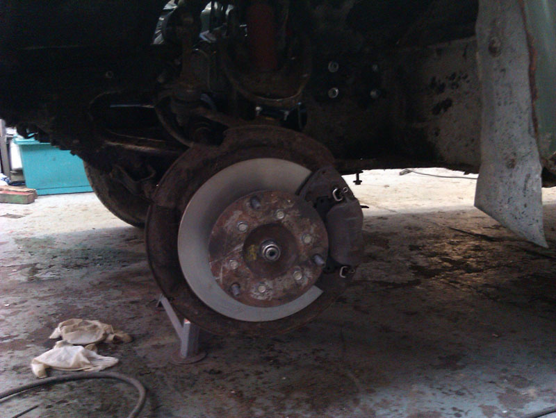

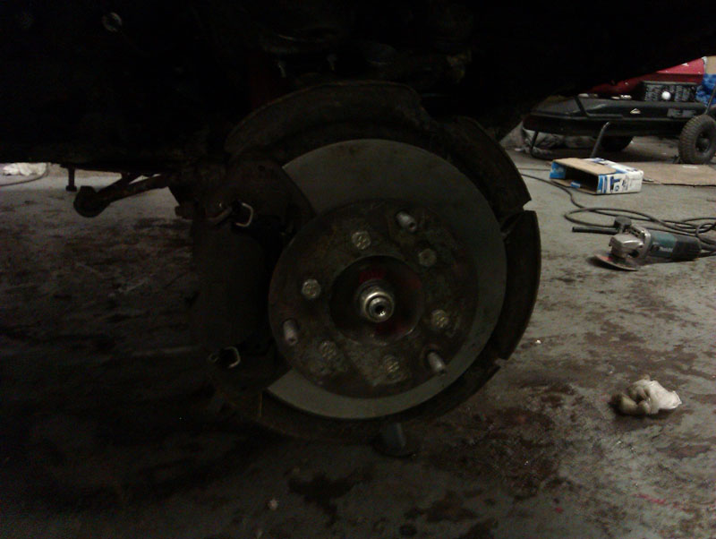

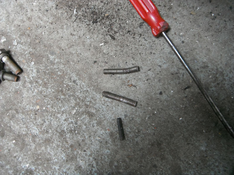

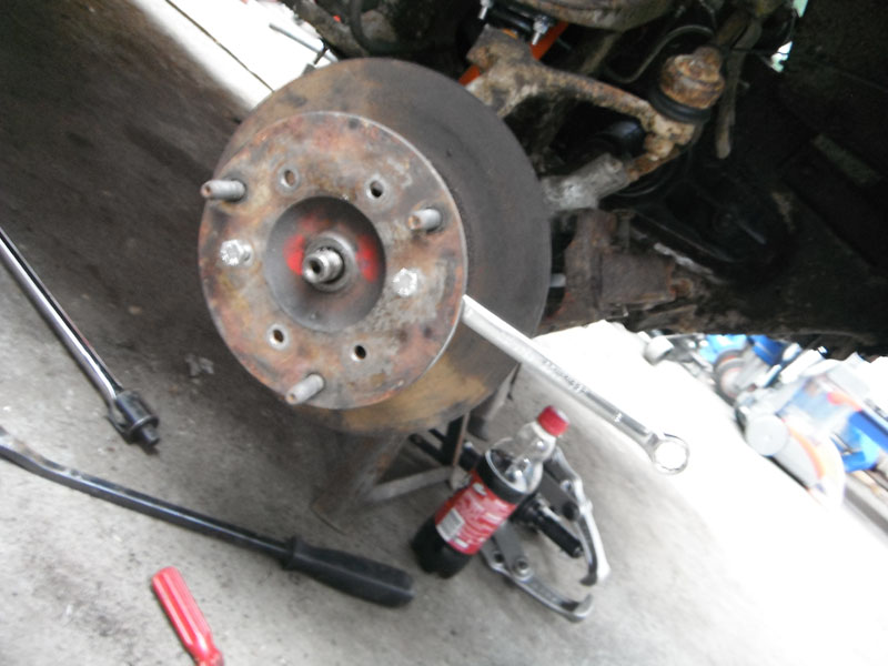

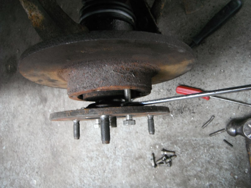

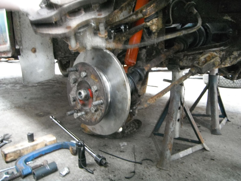

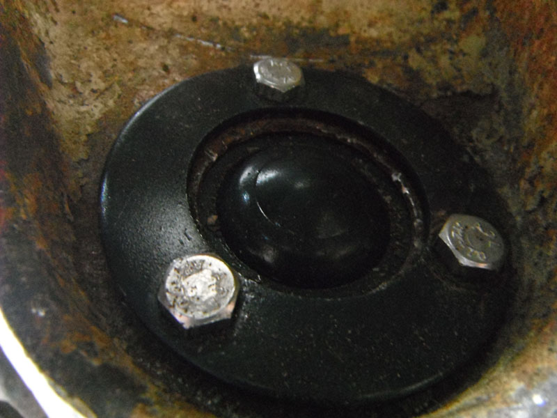

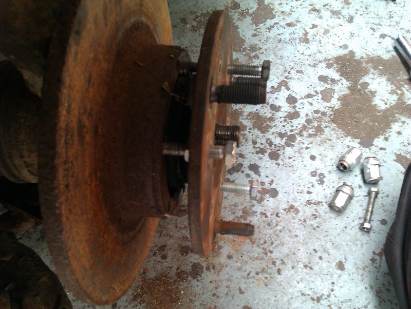

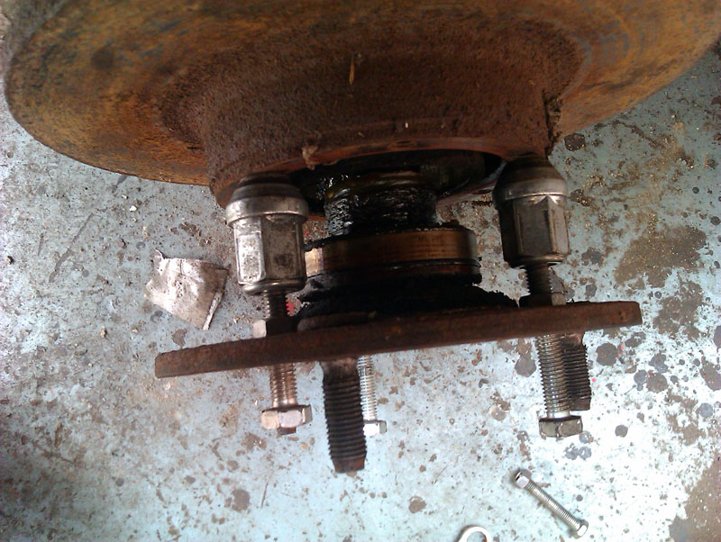

Today it was decided to make a proper effort on the front brakes.  Luckily, my brother turned up because it was one of *those* jobs as it happens.  Is there a reason French cars have to have daft brake set ups?  It's really annoying.  The front discs on the 6 are sandwiched between the two halves of the hub.  It's a very silly design and does not make changing discs easy, I was not happy about this job.  The wording in the Haynes book was also less than good (as has come to be expected of it) so some improvising had to happen.  The advise is to remove three of the disc retaining bolts and put in some longer bar and then the bolts to push the two halves of the hub apart.  You can't use a hub puller as there's nothing for the arms to attach to and you have to split the hub to get the disc out.
We started by trying out some what should have been toughened bolts with the heads chopped off in place of the rod suggested in the book.  That just resulted in a small amount of movement and bent threaded bar.
Then we found some better, longer bolts and some nuts and devised a method that actually worked.  We removed all of the disc retaining bolts so it could be pushed back off the hub face, then put a longer bolt through with a nut on the back.  Three bolts were used in total to push the hub apart, it worked very well.  When the bolts proved to be a little too short we improvised using some closed-end wheel nuts that had a flat seat one side and a dimple the other, rendering them perfect for the job.
Then one of the replacement bolts decided it didn't like being threaded any more so we had to rejig with just two.  Much slower going and with a great deal of care taken but we did get there in the end.

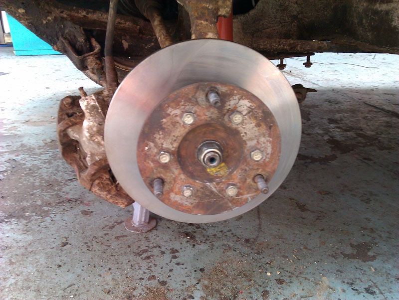

With the outer half of the hub off it's really easy to replace the disc but we found it very difficult to keep the bearing, driveshaft and hub halves lined up on the car so removed the hub and put it all together on the workbench before sliding the whole hub back home onto the drive shaft and ball joints.  Surprisingly easy to bolt back together and now we know how not to do it, the other side should be much easier.  Nice to see shiny things on the car.
In no time the old disc was heading binwards and the new one was sitting pretty on the car where it belongs.

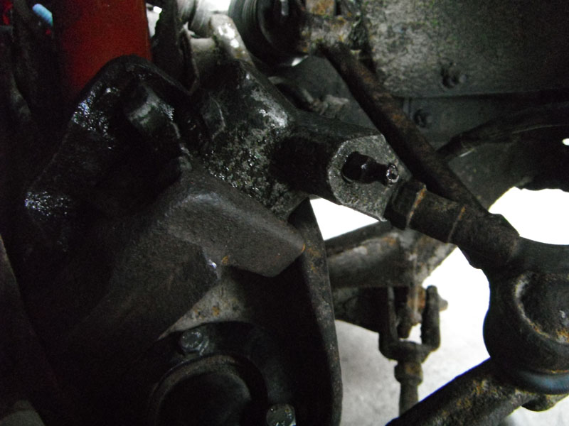

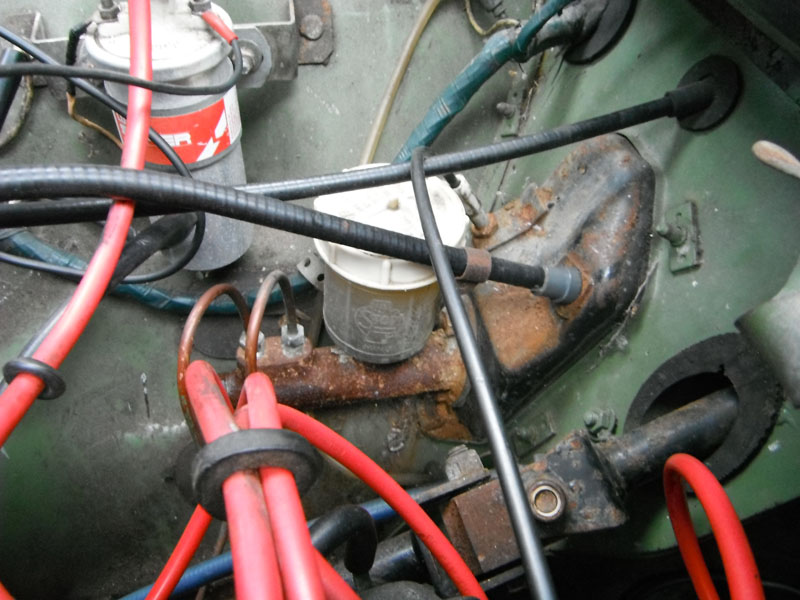

Next was the caliper.  The piston was seized and over extended but otherwise complete and in good order.  We were particularly surprised when the bleed nipple and flexihose unbolted from the caliper without difficulty.  The old brake fluid that came out was a less pleasant surprise, smelled just like rat wee.  I was surprised there was any fluid in the system at all.

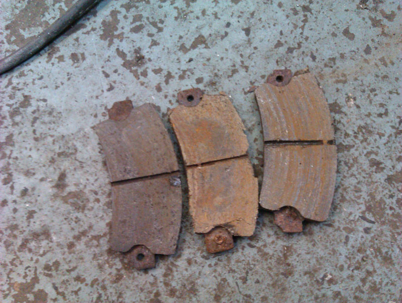

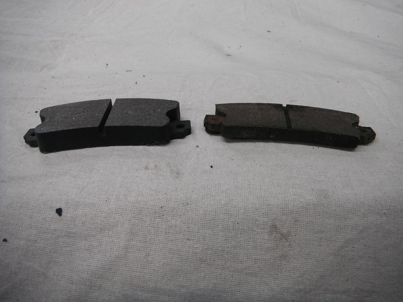

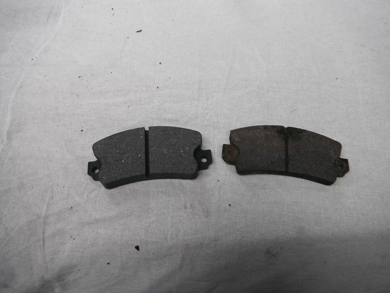

The second set of brake pads I bought were correct, happily.
They were also very needed.
The caliper was taken apart as much as it would go and with some persuasion the piston was convinced to move again.  Another pleasant surprise that.  Before reassembling the caliper we wanted to make sure fresh fluid was getting through the system from the master cylinder.  Filled up the tiny reservoir, which is a challenge because of the various cables that run over the top of it.
Gave the pedal a few goes and nothing.  Cracked off the brake lines from the master cylinder and... nothing.  Cracked off the big nut on the end to see if it would at least let all the fluid in the reservoir leak onto the floor but nope, nada, zilch.  That'll be a dead master cylinder then, which is hardly surprising.  I need one like this which has two outlets on the top and one outlet on the driver's side.
Tidied up, put the wheels back on and left it at that for today.  As an aside, I had difficulty pushing the car today to get it where I wanted it to go, just wouldn't budge!  Guess which moron had left the handbrake on?  Still, at least half the brakes work.

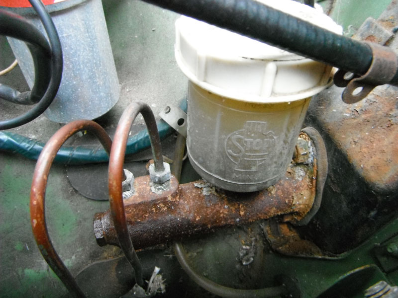

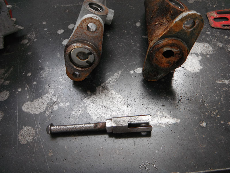

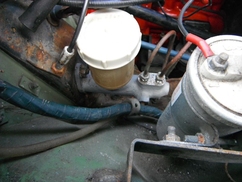

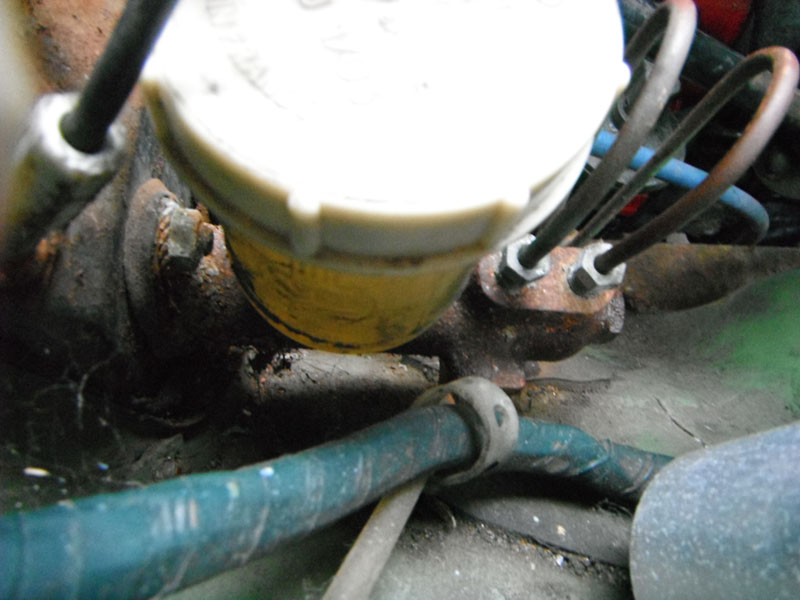

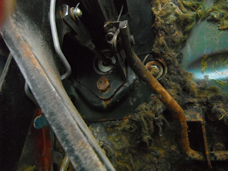

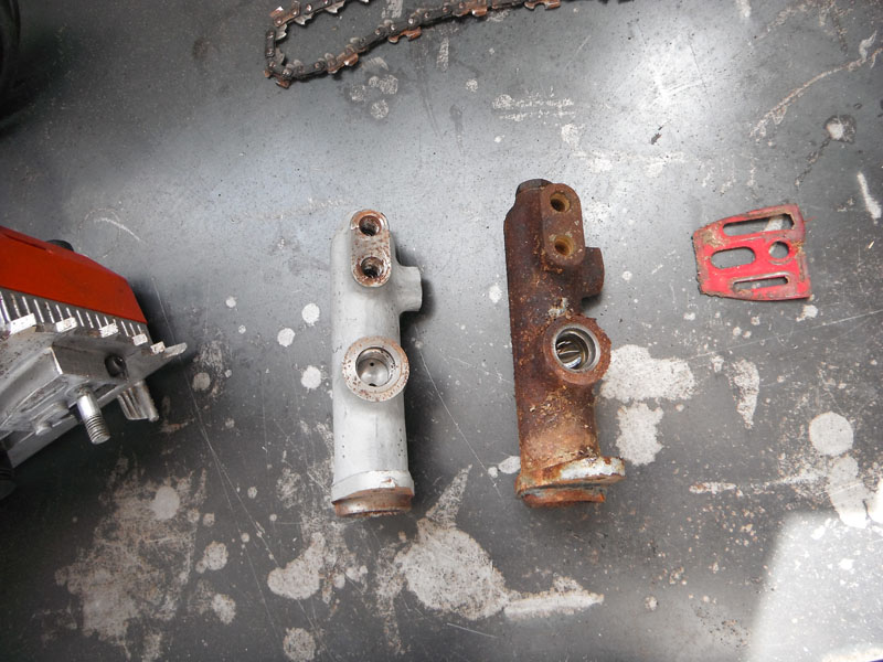

Today I stole a few minutes while having lunch and commandeered Mike into helping replace the master cylinder that arrived this morning.  A fiddly job, made more annoying by a lack of access and, for the lower bolt and pedal plunger assembly needing two people to keep it all lined up and frustration at a minimum. Old (right) and new (left) on the bench, thankfully it is the correct part and they are identical apart from condition.
Cleaned the pedal plunger bit up because it looked a bit worse for wear before putting it all back in the car.
The brake fluid reservoir was fitted with a new copper crush washer to replace the old one.  Refitting is slightly more fiddly than removal, there's very little space to actually get tools, let alone hands, into the gaps around this part.  All three brake lines reattached without any bother at all.
Pedal side of it all went together fairly easily and was given a new split pin.  Pedal actually feels to travel properly now even without fluid in the system, it feels more as a brake pedal should where before it was just sort of floppy.

I had an unexpected half-day today so spent my spare time on the Renault, it's rare I get the luxury of bonus car time.  Decided the best thing to do would be to get the brakes finished and take some pictures to illustrate how the front discs are done.  After removing the wheel and putting it on stands, put the car in reverse to undo the hub nut if you haven't someone to help brace the wheel and then undo the nuts holding the disc to the outer hub.  After that, put some bolts through the holes in the hub so the end of the thread rests on the disc face.

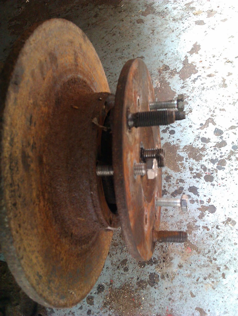

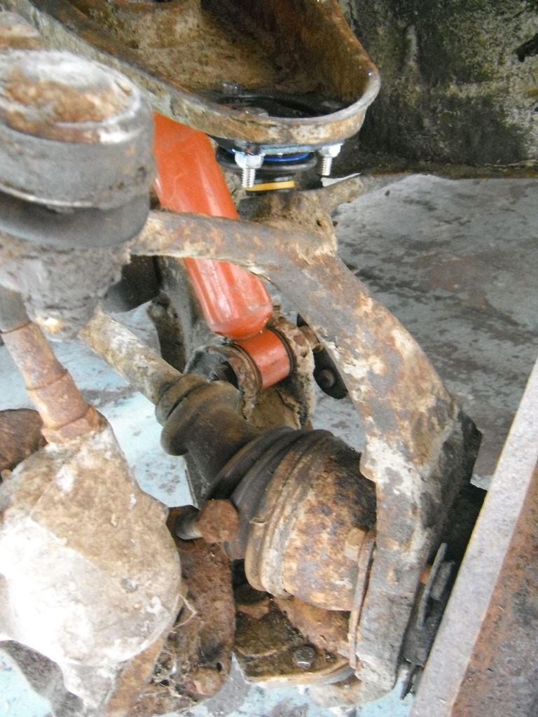

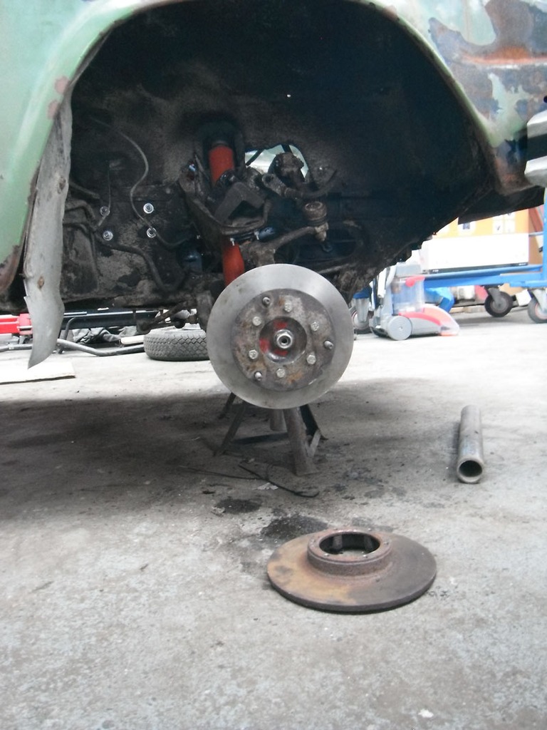

I had three bolts I could use and this makes life easier.  Fit a nut on the bolt between the outer hub and the disc brake.  Working on one bolt at a time, tighten the bolt with a spanner holding the nut to ease the hub apart.  It's steady going, but quick enough really.  Changing discs is hopefully not a job you do that often.
You do need to get the outer hub to move quite a long way and my bolts weren't long enough.  I spaced them out with some sturdy wheel nuts that have a solid dimple in one end and  good flat face the other.  This allowed me to remove the outer hub completely and safely.
With the outer hub off, you remove the old disc, put the new one on and refit the outer hub.  I was quite lucky on this side as the hub halves went together very smoothly.  A little bit of hammering was required to knock the outer hub home but once you've got enough driveshaft thread through you can put the bolt on and tighten it up.  You might need to use the hammer to help a bit as I did on this one but eventually you get the hub safely back together and can then bolt the disc in place.  After that be sure to tighten the hub nut.
With both discs now renewed, the new pads could be fitted.  It's a bit of a faff and I found the best way was to bolt the carrier to the hub with the pads in and then fit the caliper and shims and pins in situ.  The last thing to go on was the dust shield and then the brakes were bled pushing out lots of air and a bit of really disgusting contaminated old brake fluid.
The old pads that came out were very dead.

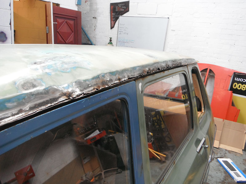

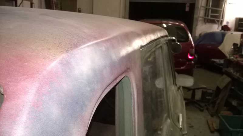

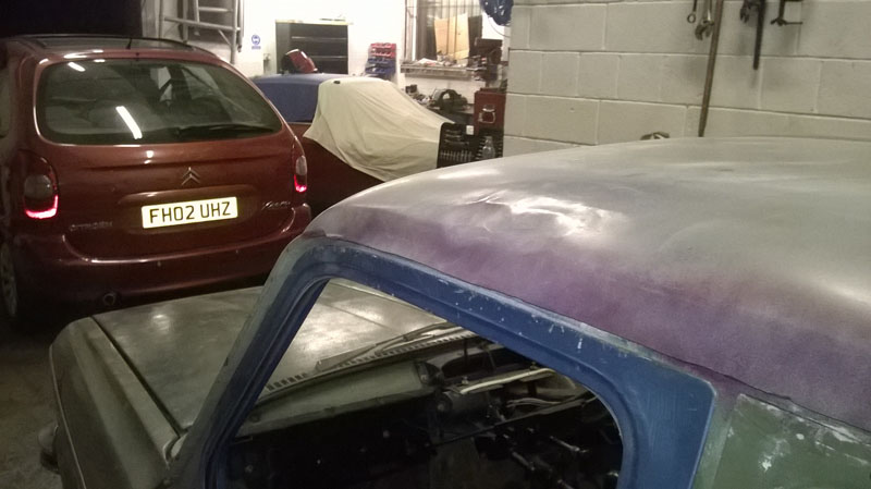

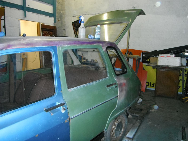

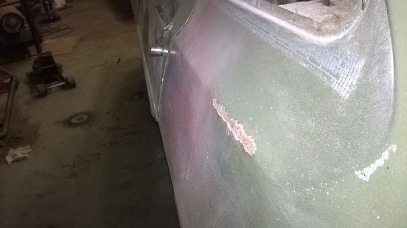

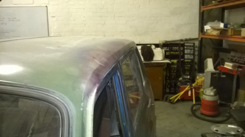

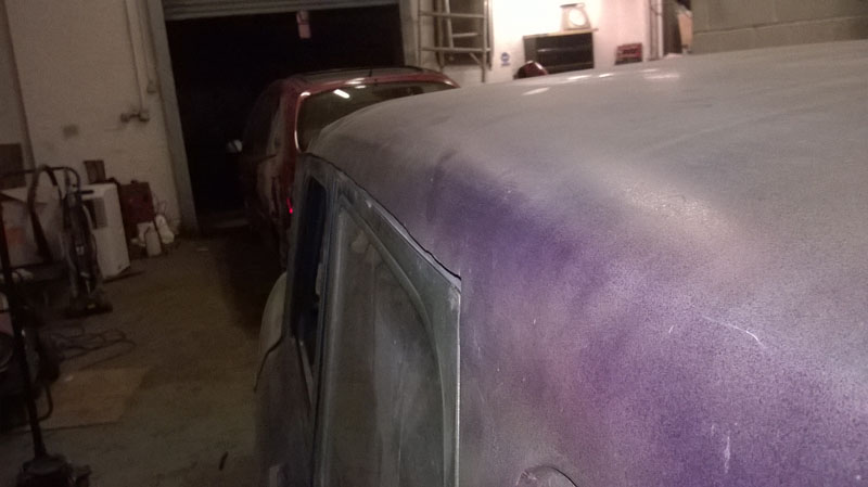

The filler work on the roof was completed and the paint put on.  I've gone for a unique approach of layering different coloured aerosols to make the repaired areas blend in with the rest of the car and not jump out.  It's so effective I'm running with it for everything.  Some dents are left in on purpose because they're part of this car's story and will be a talking point when I get to using the car, I'm sure.  The camera has mostly picked out purple on the passenger side but there's red, blue and beige over the green and blue paint already on the car in this area.
The small bit of damage that was welded on the rear wing was given the same treatment, to good effect.
The driver's side got the filler work finished and the final coat of paint on, orange instead of purple on this side until the orange ran out.

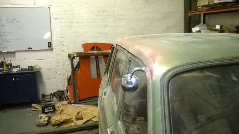

Of note is the small peep/overtaking mirror that I got for very little on eBay.  It was originally destined for the Princess but was far too small so became a neat addition for the Renault.

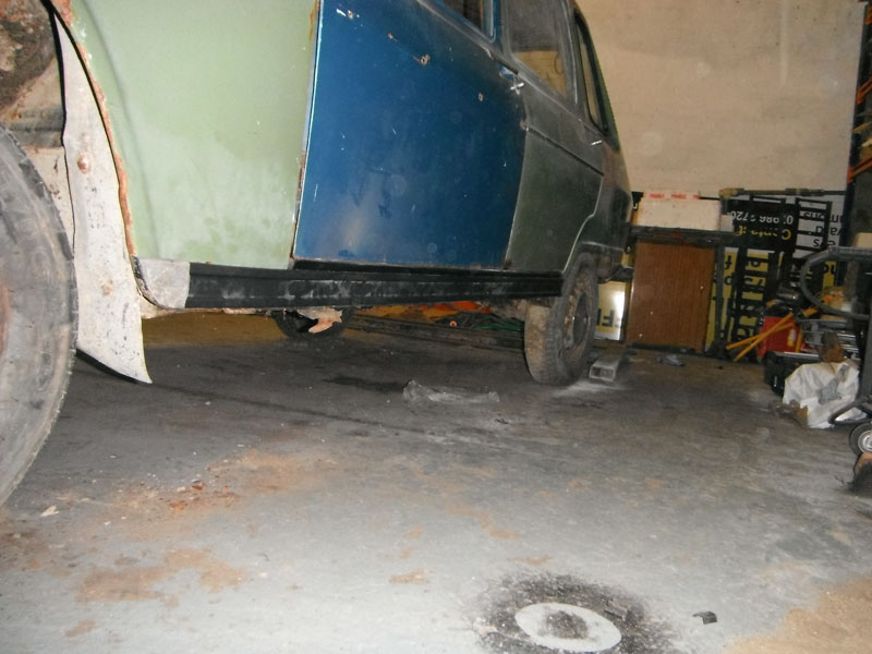

Crumbs, another busy day on Crapaud. I bought some new spring clips for the sill trims so I could get those back on. The old clips had rusted out for the most part and were a nuisance to remove. The new clips were even more of a nuisance to fit but I persisted and got there. Cleaned off the rust and flakey paint on the sills and then popped one trim on which fitted well enough, pushed the end caps home which have seen better days and this side was done.
The other side it turns out the trim strip is considerably shorter than it should be. I only found this out after fighting with all the trim clips because I'd foolishly assumed it would be the correct length. Never mind, it doesn't bother me, just part of what this car is all about.

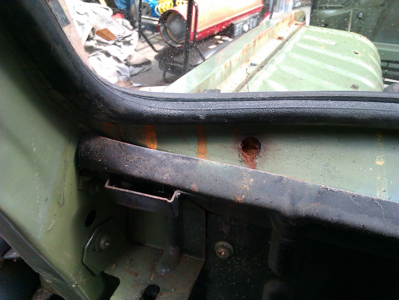

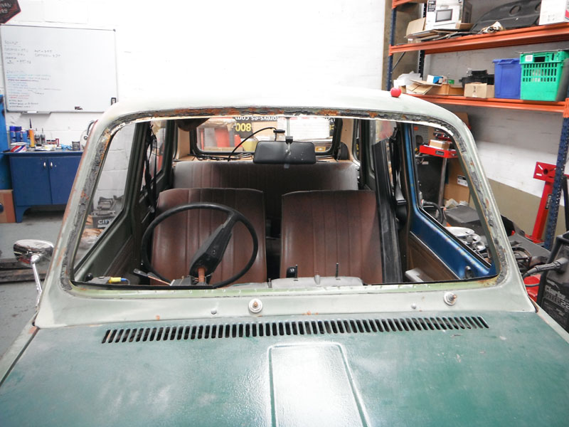

Windscreen was popped out. This has to be the easiest windscreen I've ever removed. The seal had some sort of sealant gunge which meant the top wasn't sitting flush with the frame and allowing water to get trapped. The driver's side had loads of sealant for no real reason and the passenger side practically none. The windscreen has been out before as the green repaint was underneath everything. The whole surround and the seal - which is in surprisingly good shape - were cleaned to get rid of the sealant and rust and so we could make a start on the next job...

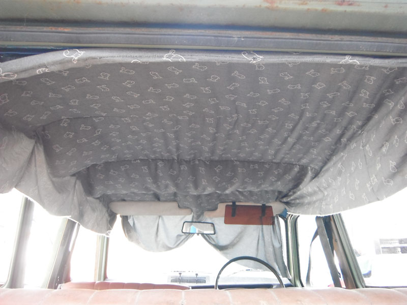

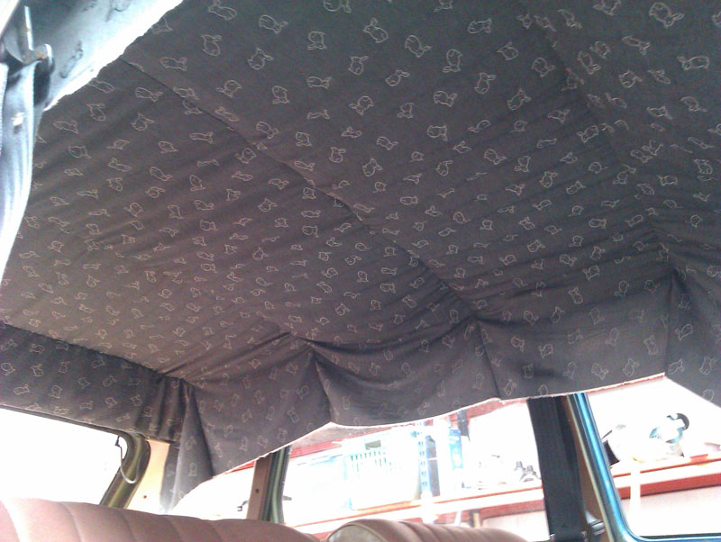

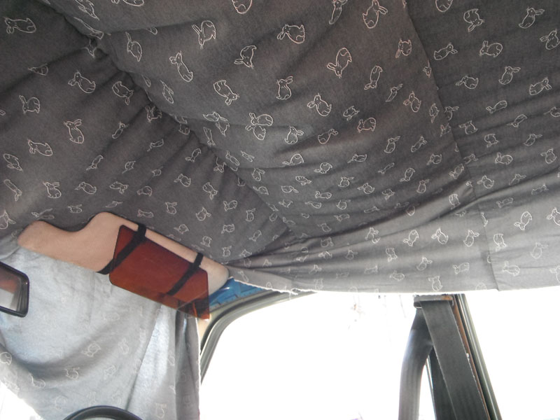

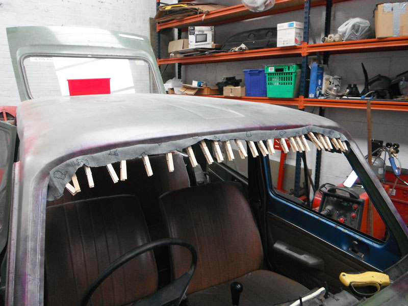

Fitting the headlining. After popping all the rods into the relevant holes, the rear tension was set by putting the special plastic piece into the grip rod and then pressing the grip rod down where it was lifted from the previous headlining removal. At the front, a little bit of good strong adhesive was applied before putting the tension on and holding it all down with pegs. It works exceptionally well.
Once it's all dried, the excess fabric and pegs are removed and then the side tension can be set.
There was a couple of inches of excess fabric to remove before I could tuck it away into the grip rods and to prevent puckering on the seams, the roof bow pleats were split (on the fabric, not the stitches) to allow the new headlining to fit smoothly. Here it is before trimming and after front-to-rear tension has been set.
I had thought some of the fabric needed to go in the rear side window holes as when I removed the old headlining that's where it was. However, the grip rod runs all the way to the back so I put it back in there which is much neater. It also reveals where the respray was done by masking off the old headlining but removing the rear side windows. To fit the fabric for side tension you get a large, blunt screwdriver and, working from the seams, push the fabric into the grip rods. If any of the grip rods (I've typed grip rods too many times, it's lost all meaning now) need it, gently tap them down to hold the fabric. It's a really, really fast way of doing a headlining, I like it.
Repeat on the other side until complete. The finished article is really satisfying and it's made the interior a nicer place to be.

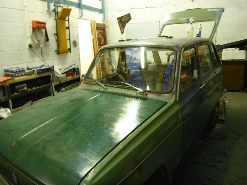

Finally, the windscreen went in. It sits in the frame much better than it did before it was removed. I didn't have the special tool for fitting the chrome trim but I do have a tried and tested technique using fingers and a screwdriver carefully. I also found climbing onto the bonnet of Renault 6 from the side is very difficult because it tips much more than you expect.
With all the glass in and the headlining fitted I faffed about refitting the dashboard and then the mirror - which I cleaned the stem on since it had too much green paint on one side - and the visors.
Another shot with flash, so you can see the rabbits.
