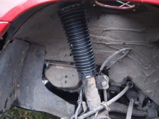

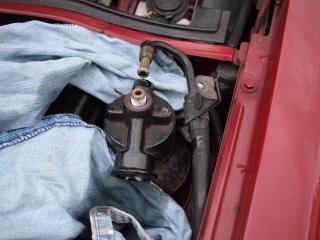

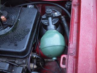

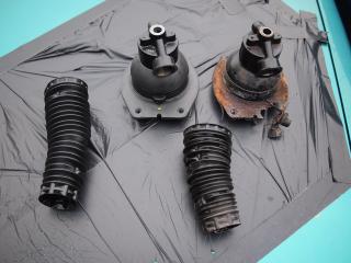

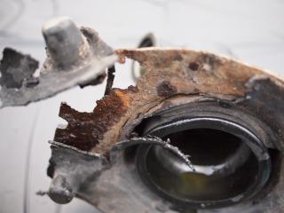

Strut Tops done today at 105,576Miles. I seem to have misplaced my little camera at the moment so the cambelt stuff will creep in later even though it's already done. I didn't have the time to get the seal on the LHM tank changed so that and the Hydraflush are still to happen.
N/S strut was 25% failed. O/S actually isn't too bad and I would not have replaced it had I seen it off the car before I bought the new ones. The failed bit is where I investigated a little with a screwdriver, I reckon the lot would look like that if I investigated further.
Image Image Image ImageImage Image Image
As usual no pics of the 2nd side as it got dark. It's all bled up now ready for work tomorrow. Oh yeah, the temp agency already have me more work than I need so thats one problem gone. Regarding the cambelt the pulleys were a bit worn, they had minimal play and the tensioner freespan a little. The belt itself was ok, but definitely old and the water pump was fine. When I find my mini camera I'll get the pics up, there aren't too many though as it was a full on pain in the butt. If anyone could put up a pic of where the diesel hose that comes from the back of the engine along a similar route to the 2 plastic turbo pipes I'd appreciate that as I'm fairly sure I've put it back in the wrong place. Might be easier if I just take one tomorrow and ask whats wrong actually. I'll probably be quiet til christmas now, got no days off but it's deliberate as New Years eve is my birthday and I fancy a week off.

Gosh, those strut tops were well past their best Elma...
Thank goodness you've now swapped them!

Scary stuff isn't it. Strange how O/S is ok though, but they were both installed differently so probably not a pair as such. The O/S was thread locked and not done up tight and the N/S was the opposite. I found my mini camera this morning so cambelt pics this evening hopefully. Off to work now, bye bye.
