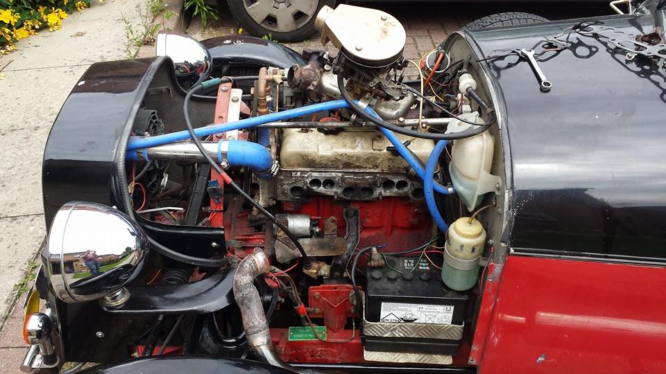

All this travel at speed - and I thrashed the poor thing all the way up to Lancs, possibly averaging a speed I should not have - appears to have done it no good at all. Some rough running crept in during the week, and coming back from work at 5am one day (convenient) it was bearing on undriveable without either full throttle or loads of choke. A clear case of an air leak on the inlet side . A few minutes with a spray bottle of a flammable liquid while ticking over and revving it proved this. I ordered a gasket off eBay, amazingly got the right one, so after venting some fury on the Xantia this morning, I thought I'd better fix the DRK, or at least make a start.
Taking the side panel was easy. 2 screws, as two have gone missing somewhere on my journey. I thought I'd go for doing it quickly, so armed with a 13mm spanner, a variety of ratchets, extensions and 13mm sockets of various depths, I set to work.

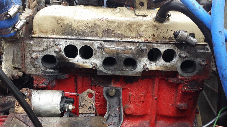

Took me about 20 mins to get to this stage, simply because two of the nuts are simply inaccessible with anything other than an open-ended 13mm spanner and you can only turn it 1/8th of a turn each time, and there's a long thread on the studs. Everything came apart remarkably easily after I soaked it in WD40 penetrating fluid a few days ago, I got the engine nice and hot first, and miraculously only burnt my arms twice on the exhaust pipe.
You can clearly see where the old gasket was blowing.. almost everywhere!
I cleaned the head up with a brillo pad and it came up pretty well, and that removed all the crud and remains of the old gasket. The manifolds were a little worse, especially the exhaust manifold. Lots of roughness and glazed bits on it, so I got the dremel out with a light sanding attachment on it and cleaned it all up, then used a small flap-wheel on it to clean the inlet part of the manifold.
I then whizzed it all back together. Then it started to rain hard, so I didn't get chance to strip the other side and replace the fuel pump, that's tomorrow's job.

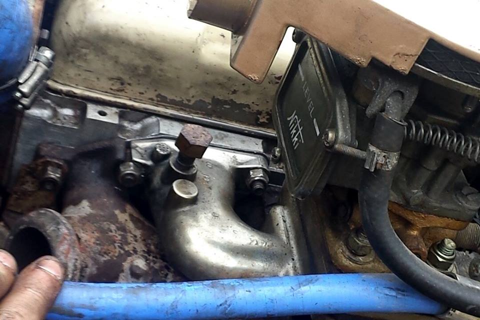

Nice new gasket freshly squeezed in place. Yes, that is the exhaust manifold exit by my hand, yes it exits pointing forward. It's French, did you expect it to be normal?
