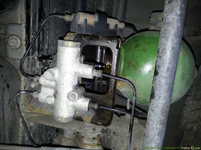

Today I started the car and it didn't drop down to the floor. So I think I might have got away with it... If the anti-sink valve isn't the right one there should be problems with the hydraulics. But everything seems to be working fine. But I have forgot that there is another anti-sink valve at the back of the car just under the anti-sink sphere
By priority valve you mean security valve? I've tried to change that one too but couldn't get to it. Maybe if I remove the fender I could get to it. But the pipes are all very rusty so it would be a PITA to remove them and I bet that I would brake some...
I think Citroen might have changed some hydraulic parts, as my Xantia for parts is year 2000 and I believe that there have been some modifications.
Here is how the anti-sink looks like from Xantia year 2000. It's a picture from the web but you can see it has only 4 ports...

Non-radioactive cars have four and Hydractives have five. I know for sure as today we've stripped an Activa rear subframe..
Anti-sink valves must be mounted the correct way up. A XM years ago used to sink at the rear and nobody could ever work out why. Eventually the cause was found to be the anti-sink valve being mounted upside-down.
I know that sounds like a wind-up but it is absolutely the truth.

Well it's definitely hydractive but it has only four ports. The anti-sink valve was located under the LHM reservoir... Maybe someone tempered with it and redirected the pipes and just put a blind cap on the other side. Ohh well I will just see what happens with the car in the future and hopefully I plumbed it right.
If you remove the anti-sink valve you must bleed the brakes afterwards?
