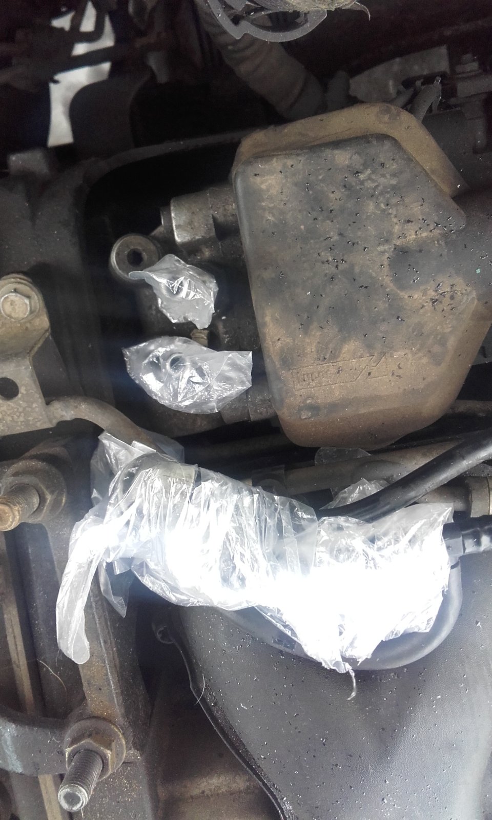

Ok I am after my first ever hands-on experience with fuel system.
I run motor for couple minutes just to warm it a little to make those plastic fuel terminals easier to disconnect
Upon successfully taking them off I was surprised to find them completely empty (no fuel dropping from them at all).
I know that after shuting the engine off certain under-pressure occurs at these terminals - yet I expected them both to be full of diesel. Taking them off the engine took me some time as it was the first time I did this, yet still engine couple minutes earlier was running normally.
Should I be concerned about it?

Although I have no Fiat experience I'd have expected to see plenty of fuel here...moizeau wrote: 04 Feb 2021, 16:20 I would expect to see fuel there but having not ever done this on a Fiat I'm not sure.
Maybe that's the root of the problem. The EPIC relies upon a good supply of clean fuel from the tank via the filter and if it does not then it can do all sorts of odd things...
Before proceeding any further I'd be checking the filter, the strainer in the tank and all points between tank and pump for air ingress...
