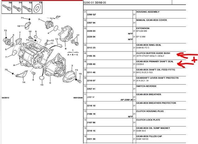

Think I missed something, do I change the seal to go with the 'clutch buffer guide bush' yes?RichardW wrote:Bushes on E-bay
Input shaft guide / seal is part number:
05
2105 35
01 CLUTCH BUFFER GUIDE BUSH
- BE3
Genuine one on e-bay also Aftermarket ones there for about £10. Dealer price is £17.04 as per the e-bay ad.
Item 6 in below image?
Thanks

flying clutchman
- Posts: 321
- Joined: 22 Oct 2009, 12:58
- x 3
Re: Xantia clutch replacement by dropping end of engine down
the seal is contained in the guide tube. YOU HAVE ABSOLUTELY NO NEED TO CHANGE THIS. It often needs changing on the push type clutch because if the release bearing fails it chews up the guide tube. On vehicles fitted with a pull-type clutch (yours) the bearing is not in contact with the tube. It is fixed into the clutch cover.
romie
- Posts: 451
- Joined: 07 May 2010, 14:02
- x 2
hey, thanks for reply.flying clutchman wrote:the seal is contained in the guide tube. YOU HAVE ABSOLUTELY NO NEED TO CHANGE THIS. It often needs changing on the push type clutch because if the release bearing fails it chews up the guide tube. On vehicles fitted with a pull-type clutch (yours) the bearing is not in contact with the tube. It is fixed into the clutch cover.
Great, good news!
