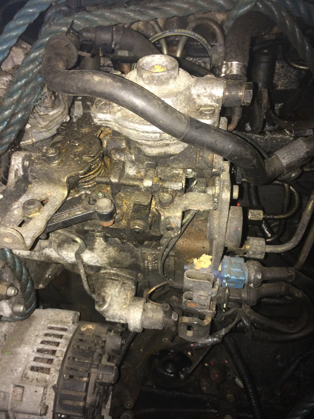

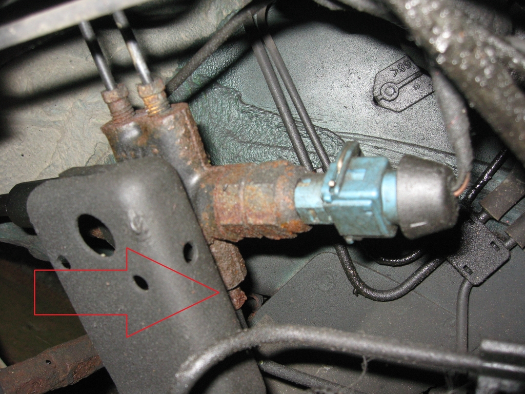

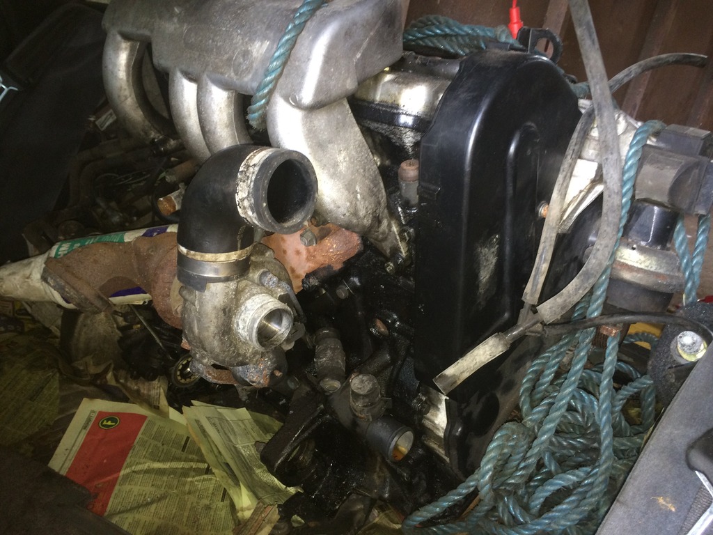

just been talking to the farmer whos scrapping his 1.9 td dispatch van. Are any of the parts transferable? I'm thinking especially about the rubber pipes etc air filter pipe that tend to perish. But the engine bay is a different shape/orientation so i'm not sure what will fit? any thoughts? tempting to nick the turbo....but he reckons its unreliable and is awaiting scrap now.. (obviously if anyone else needs parts I can ask).
right think I've got it. Its this component and its the pipe highlighted? (photo looking towards the lhm tank and orientation as fitted to the car per fitted to car) on the other hand is there only one 9mm pipe leading into the safety valve?
Also is it ok that its that rusty?
will head to dealers to enquire about pipe and new 9mm seal.
thanks very much guys

well am assuming that above is correct component.
Just trying to remove old 9mm pipe. Access is interesting. Just trying to remove the old plastic guards underneath to give better access to clip on gearbox (??) housing. Is difficult as someone has cable tied it all together in one mess.
clip on gearbox housing is well rusted. bolt comes off but twists the pipe too. hence hoping to clear plastic and get a socket on it..or enough access to grip it. Would rather not destroy it as not sure if its still available nor at what cost..
will report back as and when I actually achieve anything today. (feeling a bit down t.b.h that even the clips are difficult to remove.)
thanks (if anyone's still there?!)
Phil
edit one on gearbox off though clip all fused together. hopefully can get a replacement as I don't fancy leaving it unsupported. other one off to though clip still on pipe I got the nut off ok. Bolt seems to want to remain where it is as it comes through inner front wing. Any idea if there are only two clips and need to know if im right over the above/which pipe on safety valve to remove
next one then...
oh dear that 9mm pipe on pressure reg is a nightmare to get to. Literally cant get the spanner onto it never mind turn it. any ideas as to what to remove
Phil
next one then...

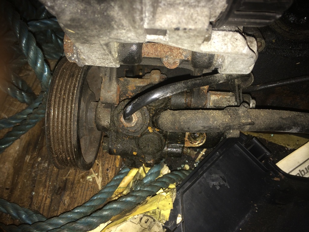

Re: Sinker xantia scrap or keep, bosch fuel pump issues...
Hi guys
chris has kindly come down today to help me with the pipe.
Unfortunately we are unable to get the pipe off/get to it. Have tried removing plastic wheel arch liner but to no avail as component is behind metal of front inner wing. LHM tank still out too. Nut is now rounding off. Cant really get to cut it either. Though if we do cut it and get it off how do you get a spanner to the new one??!
Please please help. This has dragged on for long enough lol and chris isn't here for too long.
SOX (Save Our Xantia!!)
thanks
chris and phil
edit never mind done! thanks to chris!!!
