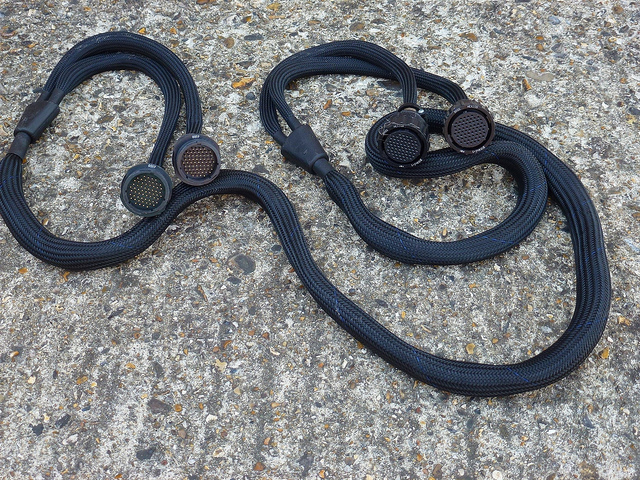

Here's a photo of the harness tester to breakout box lead, more of an elongated 'X' rather than a 'Y' really :oops:

Richard, thanks. I'm sure that one of them looks like that but I tried to connect the breakout box and couldn't work out how it fits. I'll check tonite and let you know.

......Actually, looking at that breakout lead, it appears to be a replacement for the in car harness section, you will another lead (a Y shaped one with a female round plug on end, male on the other, and the lexia connection in the middle) in order to connect the lexia.

Richard, the breakout boxes dont connect to the (IC) interconnectors, they connect directly to components like ECU's & bigger relays.
The big long lead is really just an extension cable to connect either the manual or electronic breakout box to the relevant ECU harness adaptor you are testing, the adaptor harness can connect directly to the breakout box although you would have to get the Lexia very close to the car :D
One thing to be carefull of when using the breakout box, one of the round connectors has a green tab & the other a white tab to identify which is which but the leads can be fitted the wrong way around which could give you some strange readings.
