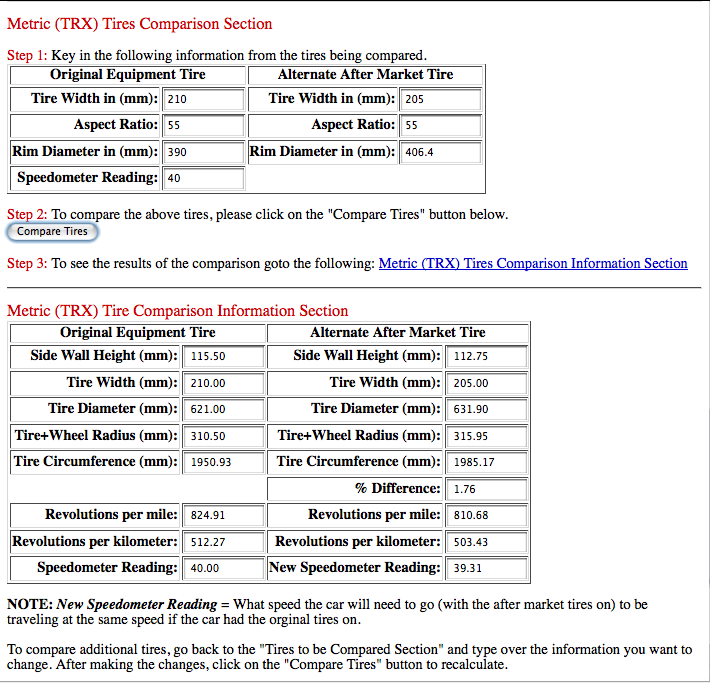

I've never seen decent TRX remoulds - even if they look the same pattern etc
they've been rubbish. For reference with 16" working out as 406.4mm:
http://pw1.netcom.com/~sgalaba/tiresize.htm#metrictires
The exact same standard tyres that were fitted as standard on the Alfa
147/156 models. I've bought and run Bridgestone, Uniroyals, Pirellis and
Vredestein and they're all good - decent name quality tyres.

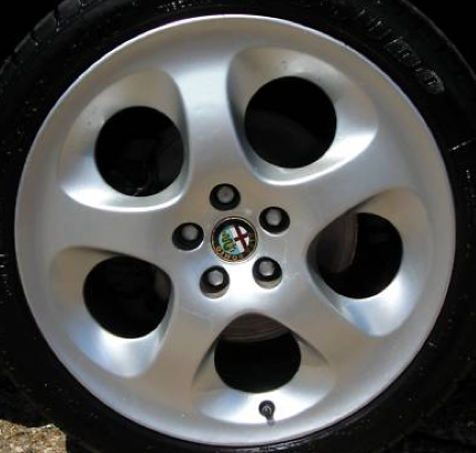

Chuck these on with 215 45 17's and the difference to the genuine
TRX 210 55 15 is 0.69%
http://cgi.ebay.co.uk/GENUINE-RARE-ALFA ... 0568247721
You could try them, see if you like them and still sell them for the same
money all day long on ebay.
IMHO, by far the prettiest Alfa alloys there were, are these 5 hole
'Selespeed' ones. I think the 'petal' indentation shape and the circular
cut through hole is reminicent of the Cx sharp edges but full and flowing
bodywork and it the Cx door handle recesses. Looks like it belongs to the
same design idea for me. Not everyone agress but Hell, it's my car!
