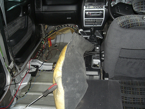

What seemed like the first time in ages i managed to get home early today so decided to pull the passenger side carpet out to try and track down my leak properly and dry it all out, there was plenty of mould under there and the foam was holding a lot of water. Its all drying in the shed now and there is paper towel in the front footwell so i will see if its wet again and where in the morning if it rains tonight.

Home early again today so i got the regulator back together and producing 140-180 bar, it took a little bit of fiddling but got tthere in the end, not found the leak yet as i have not really looked but it will take quite a while to dry out first anyway :lol:
I am thinking about taking the whole interior out and dumping it now anyway unless someone wants it? the leather interior will be here sometime over the winter and it will make it easier to do the matrix with it all gone.
