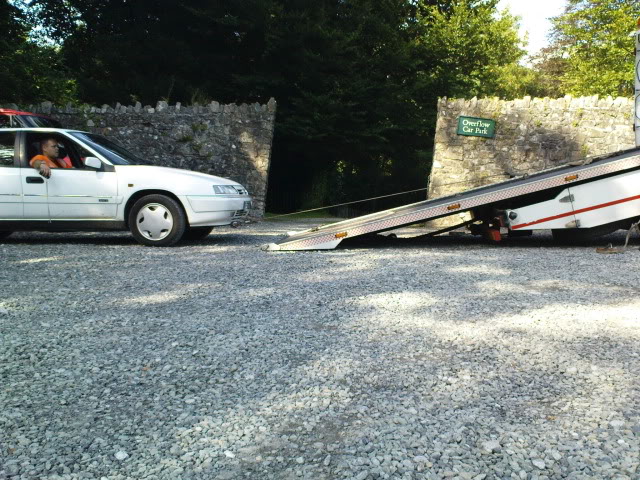

Lovely day out today with the family to Lydford Gorge, nice and chilled under all those picturesque trees and the sparkling and soothing water. The Xantia was doing me proud with the boot containing food/jackets/sunglasses and snowboots
and 3 passengers. The suspension does appear to be more comfortable with a few passengers and after I cleaned the rear height corrector yesterday. I can also report that the rear HC linkage can be removed without disturbing the hydraulic side of things with relative ease. After around 7 months and 3-4k I also changed the oil and filter. Yes, im expecting this Xantia to be around for quite a while yet
Going back to our visit to Lydford Gorge. We had taken two cars as there were 8 of us. After finishing the day off with a fantastic cream tea at 4pm we trotted off to the cars I reversed out of my space and was putting the clutch down ready to go into first and BANG stuck in reverse...
First time in a breakdown situation and I was blocking one of the exits from the car park
I was on a downhill stretch so a few people pushed the car forward so we could stick it in neutral and rolled right back into a space next to a C5.
I was contemplating putting the clip that I had in the breakdown bag in but after taking a torch to the location I decided that it would be best to tackle it at home and so rang the very helpful people at Autonational Rescue
got through to them immediatly and shortly after recieved a text message containing details of the local garage that would be taking the Xantia back home and when the estimated time of arrival would be. A couple minutes after that I had the local breakdown firm ring me asking for more details of location etc, all very helpful. About half an hour after that, Lifton Down garage attended with a chirpy chap who had a soft spot the suspension design.
Im going to attempt to replace the clip this evening/all day tomorrow/full time for the next 5 days (delete as appropriate)
Im rather glad that it happened in a car park at the destination

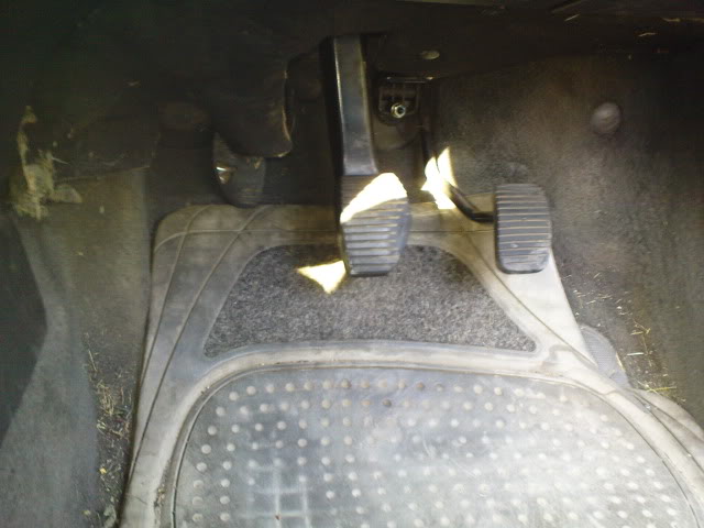

UPDATE:
After taking a more indepth look, the clutch clip (both plastic bit and metal retainer) are still there all intact albeit without a cable. Also around the gearbox end after taking off the airbox I find that the lever at this end is rather slack, a few inches, surely this should be quite solid?
The plan at the moment is to unclip the cable from this end, and reclip the cable in with a new metal retainer and see if it works.

Sounds like the cable has broken perhaps? That movement at the arm end is normal if the cable is not anchored to the pedal.

This movement you are talking about - is it the operating lever for the clutch on the top of the gearbox? I wouldn't expect much (a few mm?) slack movement in this - it is permanently engaged with the release bearing. The movement of the operating end of the cable (the outer remember on these infernal pull clutches!) is only about 2" for normal clutch operation. If you have lots of movement on this arm, then sadly I fear the release bearing has parted company with the clutch, and it's gearbox out time
If the play is in the bracket for the end of the inner cable, then this has parted company with the gearbox - might be able to fix it back on, depends on the damage to the mounting bolts on the box casing.

Hi Richard
*cough*
It turns out I was looking at the wrong bit of the gearbox. It took me a while to find the cable
It turns out that the plastic clip is intact and it was the metal retainer that had snapped
Once I got going, it didn't take long to take the pedal off with an allen key type torx and a 13mm ratchet spanner. My nut was on the brake pedal side which I presume is the right side. I slipped the new metal clip partly on with the pedal off, stuck the bolt back in, unclipped the cable from the gearbox end, pushed it through so the bullet poked into the passenger compartment, lined up the plastic clip using an open ended 13mm spanner, lifted the clutch pedal to push the white clip onto the bullet, pushed the cable through from the gearbox end and clipped the new clip on with some VERY long nose pliers
Took about an hour.
