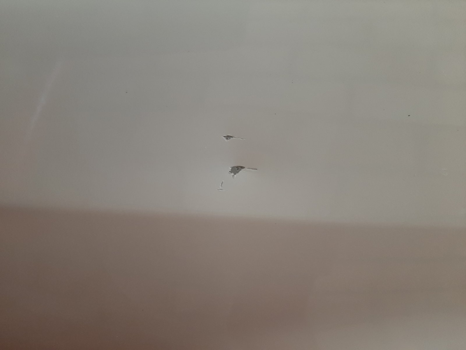

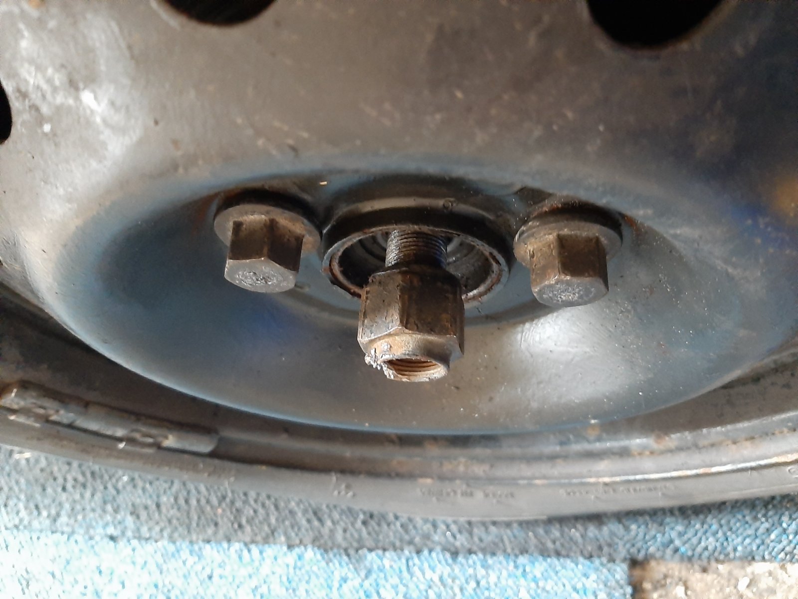

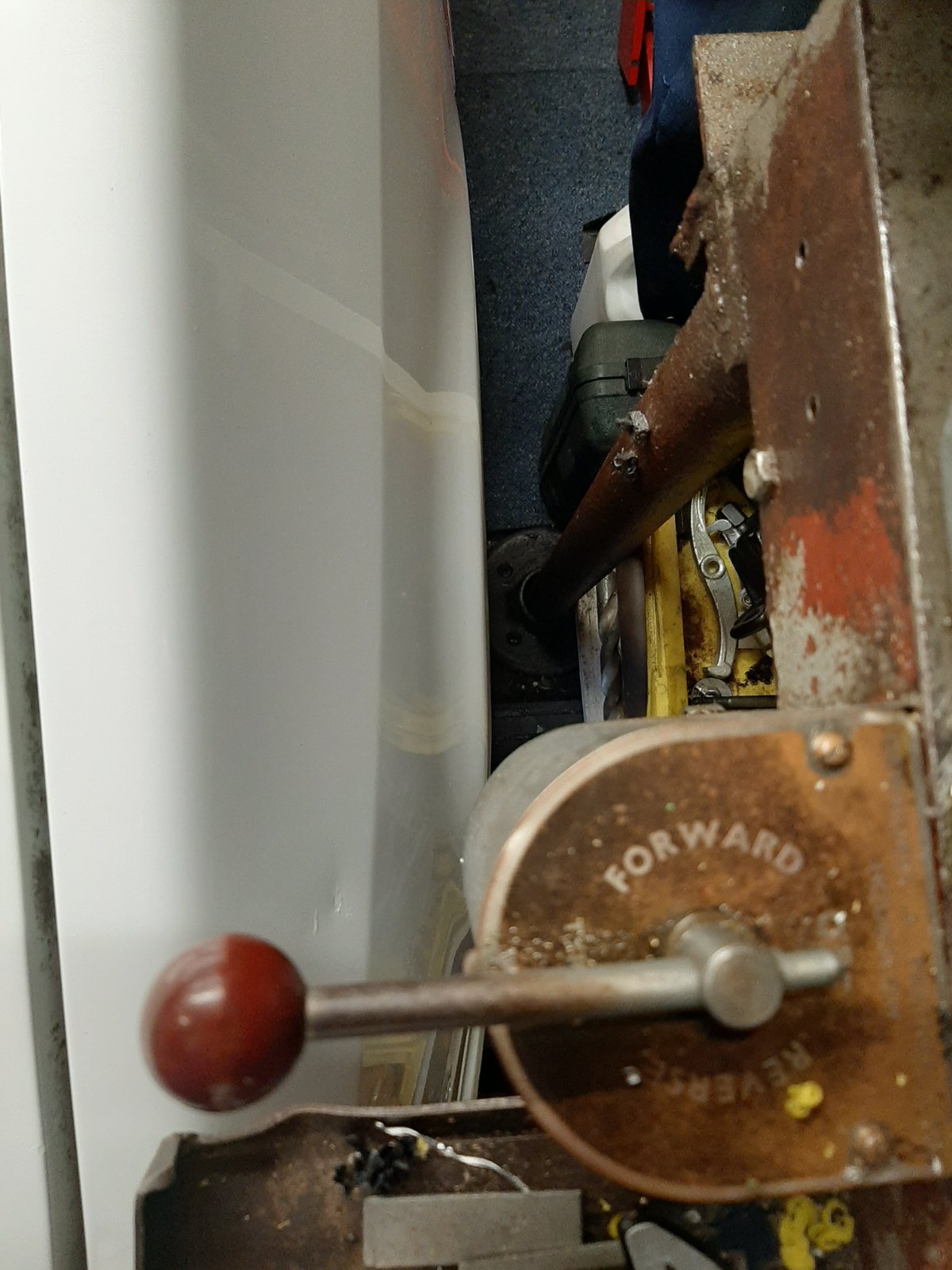

Success today
With engine running, an assistant standing on the brake pedal and a breaker bar bending alarmingly it finally gave in!
At the cost of a small wound to her wing inflicted by the lathe
The offending switch...
I've touched it up with a bit of paint to keep any potential rust at bay... I need to get a few other blemishes sorted out at some point before the shows start and this new one has now been added to the list... I'll try not to inflict any more!

The offer still stands though. It rattled the wheel bolts off the van like they were finger tight when I'd been literally jumping on the end of an 8' breaker bar trying to undo beforehand. Likewise the bolts holding the prop onto the diff.

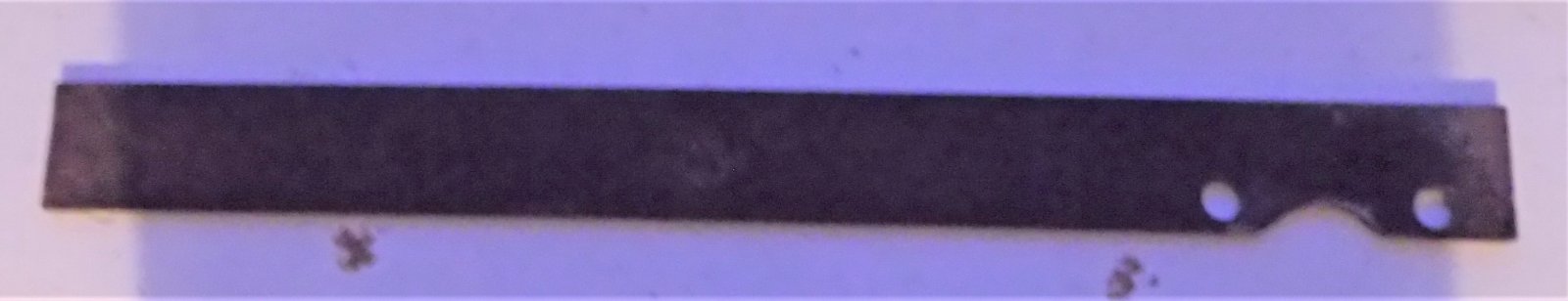

I knocked this up years ago to get those hub nuts undone, quarter inch steel, fasten it to the wheel studs and wedge on the floor.
It's also long enough to pop between the seat and pedal to check the brake lights.

My preferred method would be car firmly on the floor under the cars weight, seems to help and whichever bar you use, supported at the pivot point by either a trolley jack or axle stand.
