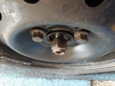

Success today
With engine running, an assistant standing on the brake pedal and a breaker bar bending alarmingly it finally gave in!
At the cost of a small wound to her wing inflicted by the lathe
The offending switch...
I've touched it up with a bit of paint to keep any potential rust at bay... I need to get a few other blemishes sorted out at some point before the shows start and this new one has now been added to the list... I'll try not to inflict any more!

I knocked this up years ago to get those hub nuts undone, quarter inch steel, fasten it to the wheel studs and wedge on the floor.
It's also long enough to pop between the seat and pedal to check the brake lights.

Well done Jim they are satisfying when they finally give inCitroJim wrote: 13 Nov 2020, 14:36
Success today
My preferred method would be car firmly on the floor under the cars weight, seems to help and whichever bar you use, supported at the pivot point by either a trolley jack or axle stand.
The only tip I have for bleed nipples is the one where you make a well around it with putty/blue tac or similar and fill that with light oil, apply some heat to try to encourage the lube to run down the thread. Good Luck .....
