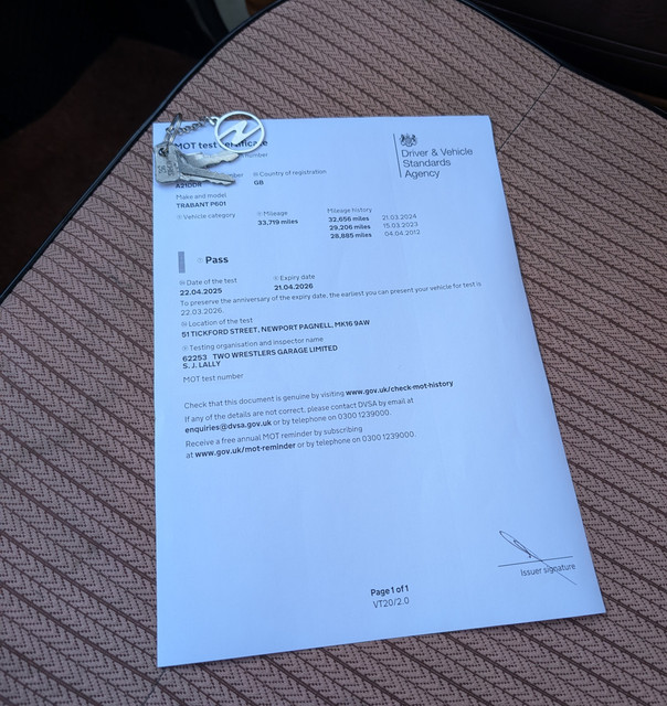

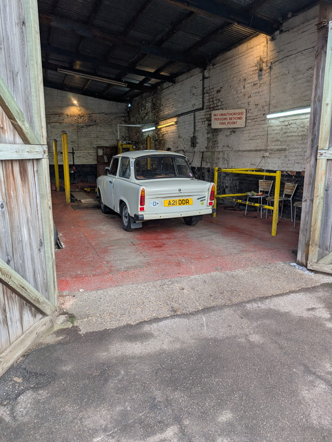

Hard to believe it's been a year again already, but once more I found myself here with the Trabant.
Which shortly later resulted in this being issued.
Which the car doesn't actually need - but I don't have a four post lift or a set of brake rollers at home. Plus I reckon the MOT represents excellent value in having a second pair of eyes look over the car. I'm only human and can and do miss things and make mistakes. Plus in the event anything did happen it's one less thing for insurers to quibble over. It will continue to be tested yearly. Fingers crossed I get to cover a few more miles between now and the next test...given the car was parked up for about ten months of the last test period after the engine went bang.

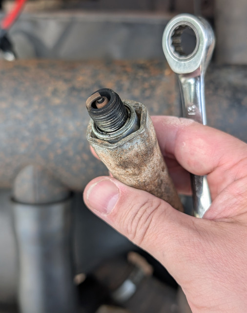

Had a look at the plugs when I got back from today's driving and this is what they have to say.
One downside that was apparent with having knocked the mixture by a notch though was once again having to poke the cold start lever a couple of times before I got onto the main road and the engine started to do meaningful work and get some heat into it. I think this however is largely down the the supposedly smart choke as Mikuni call it trying to be too smart for it's own good. I'm sure the warmup profile they have works fine for a bike. The cylinder on a bike engine will heat up really pretty quick when you're stationary given there's virtually no airflow over it. This is a bit different though in that there's a great big (really quite powerful!) fan blasting cool air at the engine as soon as it's started - so I imagine it takes a good deal longer to get up to temperature than a similar capacity bike engine would. I'd really prefer to just have a cable attached to the choke control on the carb that I could set where I wanted it. Something I might have to look into at some point in the future. It's not a problem really rather just an annoyance.
I really do need to kick the idle speed up a touch as well as it is idling too slow currently - and being a two cylinder two stroke it makes it very well known that it's a bit too slow! Quite a contrast actually as as soon as you're off idle it really is a heck of a lot smoother than you'd expect. That is a moderate faff to adjust though as that screw is right on the back of the carb so is completely inaccessible with it attached to the intake boss...which given I imagine is going to require a few trips backwards and forwards dialling it in will get old in a hurry. Which is why I've been putting off dealing with that. I did see if I could cheat by tweaking the throttle cable adjustment (the idle speed adjustment is basically just a set screw which sets the resting position of the throttle slide), but that just makes the throttle hang 50% of the time...so no, I'm just going to have to do it properly, being lazy isn't an option. I did discover that I had at least 1/4" of slack in the throttle cable though, so it was worth messing with anyway as there's no way I'd have been able to get full throttle with it like that.

Excellent and congrats on the MoT pass Zel :)
The mixture is looking a lot happier now!

Agree that it is well worth the cost of an MOT although not strictly required, just for pace of mind.

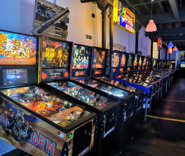

The beginnings of an engineering related Occasional Distraction (TM) are currently in progress. This is actually one that's kind of been at the back of my mind for a number of years but I've decided it's time to actually do something with as technology has progressed now to a point where I think it's worthwhile. Those of you who have put up with my ramblings for long enough will know that among the utterly useless in real life things that I enjoy is playing pinball. I was extremely happy to discover when I accompanied the family on a trip to Arcade Club up in Bury last year that they have a solid half of one of their floors dedicated to it. Though I really wish I'd taken the photo from the other end of this line where the more classic machines were rather than this modern Stern nonsense.
I shouldn't really be too hard on Stern I guess - at least they're still actually making them. Plus there's nothing really *wrong* with them, they're just exceptionally average in my view and rarely hold my attention long. They've gone with lots of electronic fluff to try to draw people in rather than actually investing in designing a playfield that flows well and has any real replay value in my view.
I'm looking forward to visiting there again at some point, especially as they've apparently moved the machines since the last visit to a different area which is 16+ only so the perpetual stream of screaming ill behaved children who detracted somewhat from the experience last time should be greatly reduced.
There is a downside to enjoying this in the UK though, and that's that it never really was as popular here as it was in the US. This combined with pinball having enjoyed something of a resurgence in the last five or ten years has meant that machines in the UK are fairly thin on the ground, and are painfully expensive. For the vast majority of the tables I'd really want to dedicate a chunk of floor space in my house to you're looking very likely north of ten grand, and I quite simply ain't paying that much for something that is absolutely not useful in any way beyond providing entertainment.

Excellent :D I'm absolutely rubbish at pinball but love the machines. That place is really rather wonderful!

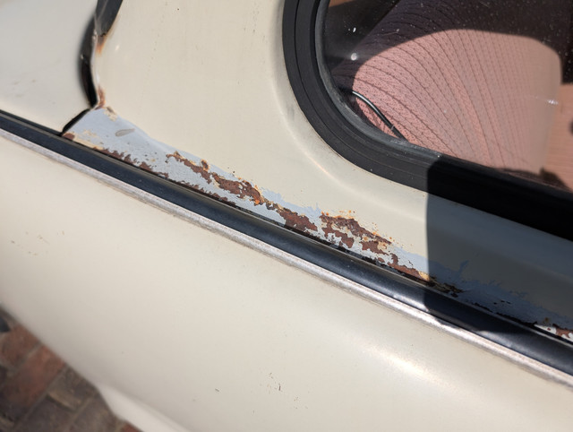

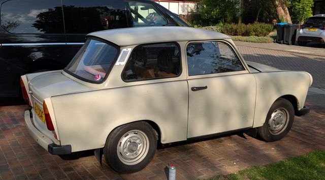

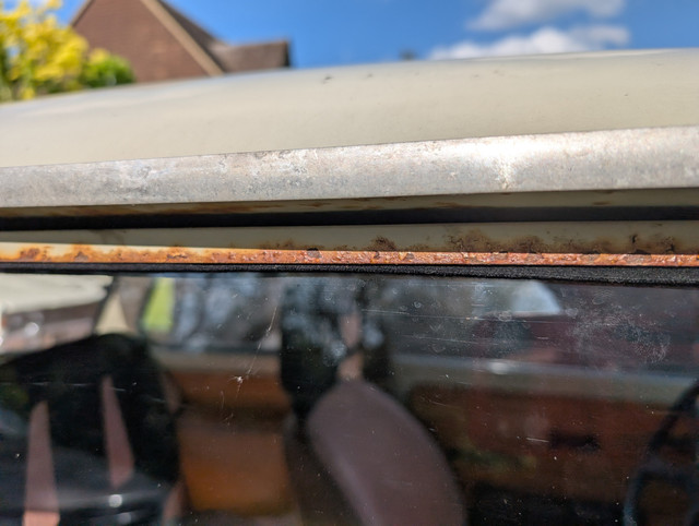

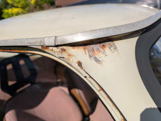

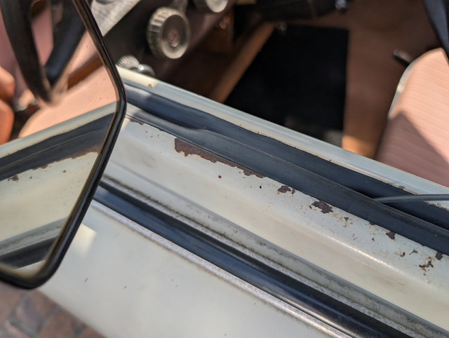

Spot the difference?
Yeah, have finally started doing something about the large chunks of paint that are missing.
Few examples.
I'm not interested in making an invisible job of it, I just want the car to look cared for and presentable from ten paces. So we're not going overboard. Bit of paint in the right places will make a big difference though and make the car look more presentable.

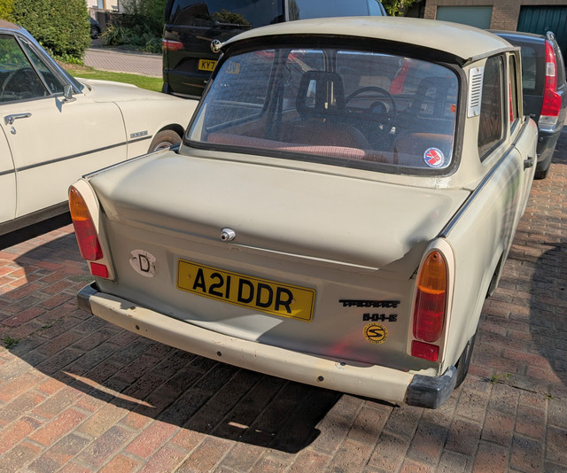

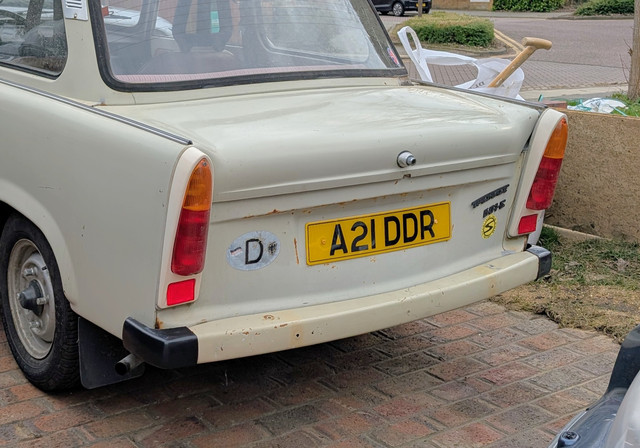

Example of how much difference a little paint can make.
Primarily the rear panel I'm pointing at here.

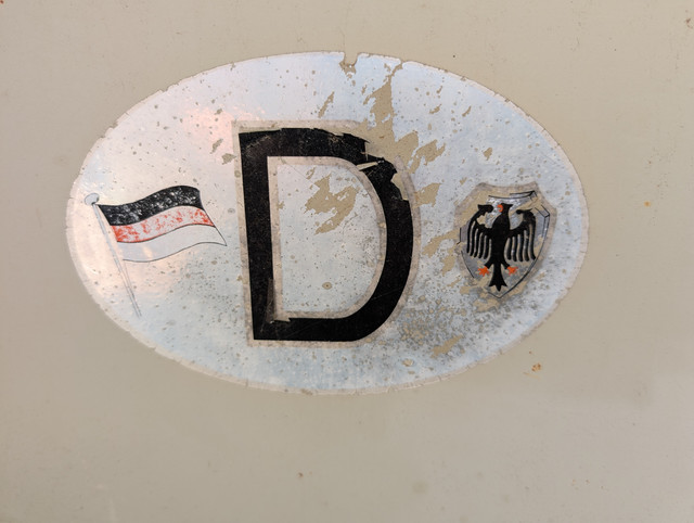

This sticker will have to go.
I usually dislike stickers and similar things on my cars, but when they've been there this long I'm always a bit conflicted - this one though is shedding bits of silver foil every time I lean against the car putting stuff in the boot and is looking really shabby, so it'll have to go.
It's going to be an absolute pig to remove though as there's absolutely nothing structurally speaking left of it - except the actual adhesive of course!

Careful Zel, you my be allowing the press free reigni if you remove your D notice! :sulk: :-D
