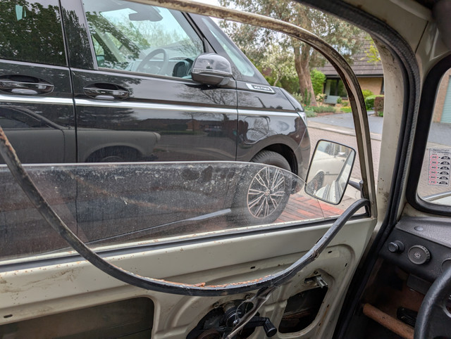

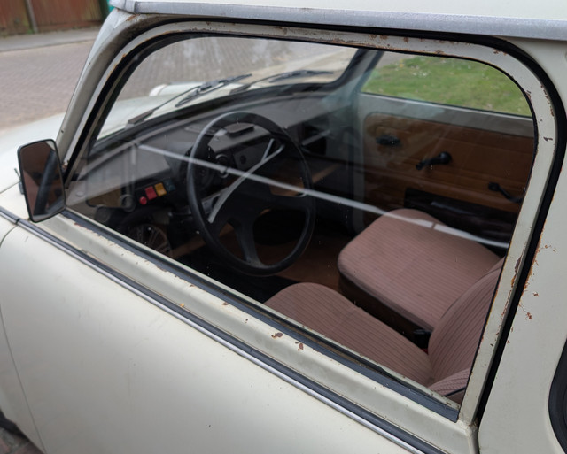

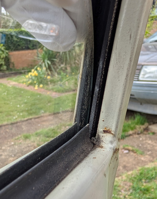

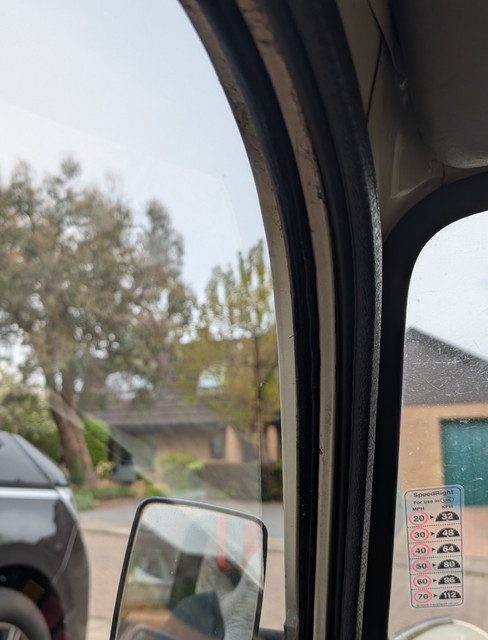

Had planned to go tweak the carb on the Trabant today (going to knock it back one notch), but as soon as I went to get the tools out the weather laughed at me.
So I changed tack and went looking for a job I could do at least mostly inside. Of course it then never actually started raining properly. Ended up going for one job which functionally is minor but will be a huge quality of life improvement.
This was my chosen target.

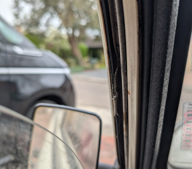

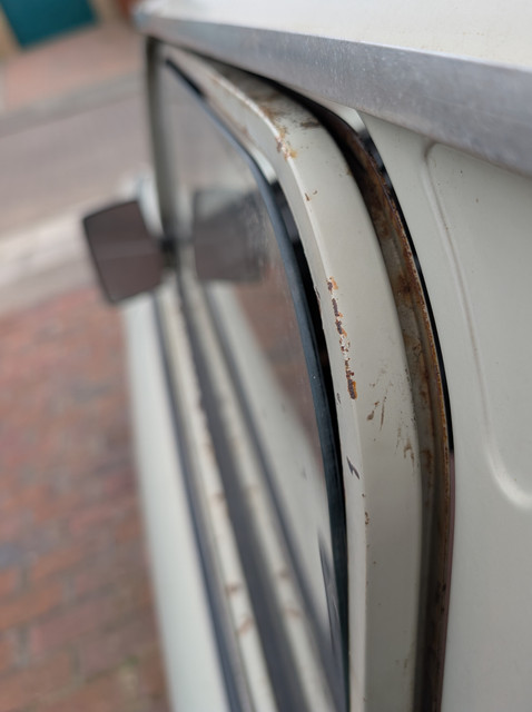

The front window seals are utterly knackered.
This resulted in two issues. One being that the glass could wobble around a bunch and it rattled incessantly. The second was that because it could wobble around so much that while you could open the window just fine while driving, if you tried to close it in motion the glass would do this and jam.

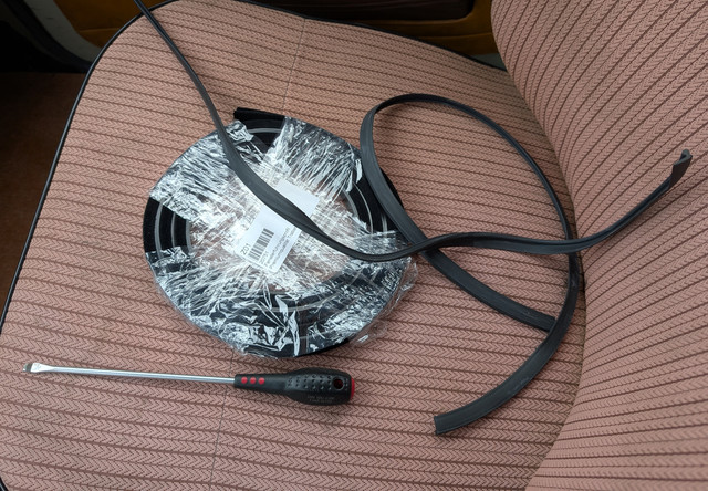

I actually bought a full set of window seals only a week or so after I got the car (this includes windscreen, rear windscreen and boot lid as well) however I've been largely ignoring them.
Have been putting this off as every time I've changed window seals before it's generally been an utter pig of a job.
Let's get into it.
Spot the difference?
Should have known the Trabant would be different.
Time taken: About 30 minutes. Tools required: One flat blade screwdriver (to help push the wiper strip at the bottom of the window into it's channel). Technically you don't even need to take door door card off.
I've only done the outside wiper so far as I want to attack the top of the inside of the door top with some cutting paste to try to remove some of the black grime from there and I know it will end up all over that, so doing it AFTER that cleaning makes more sense. The actual window seal just slides into the channel and can just be pushed from one side to the other.
I did take the door card off as I thought I'd need to (that again only needs one flat blade screwdriver and about 5 minutes work). That gave me a good opportunity to clean and lubricate the winder mech and hoover all the accumulated gunk out of the bottom of the door.
The difference when closing the door is ridiculously obvious, it really shuts with a solid thump now rather than rattling. It's a minor thing but not having the door continually rattling right in my ear will be a big quality of life improvement.

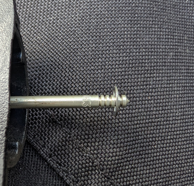

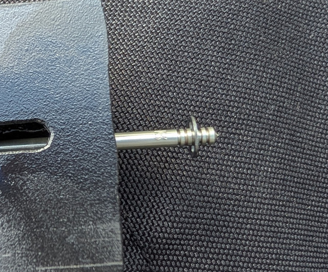

Also noticed that the passenger side wiper arm was closed to making a bid for freedom - the grub screw was loose, so that's been tightened up. Will get the passenger door window done tomorrow.
It will be strange driving the car without the doors rattling so much. The interior itself is actually surprisingly rattle free to be totally honest so it will make a lot of difference. Replacing the broken clip on the ashtray will get shot of the next most obvious one.

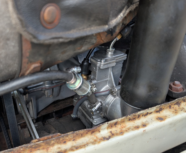

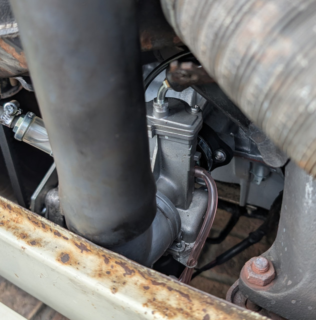

Carb tweaking was first on today's to do list.
Previously I had the needle set here, on the centre notch.
I've now moved it up one to here.
I'll take it for a run tomorrow afternoon then read the plugs again.
It is a good thing that this carb isn't any bigger!
Looks hard to get to but the fastening screw on the fitting boss is actually easily accessible from the right hand side, and the carb sits conveniently on top of the alternator while you remove the lid and mess with the innards. Takes all of about a minute.

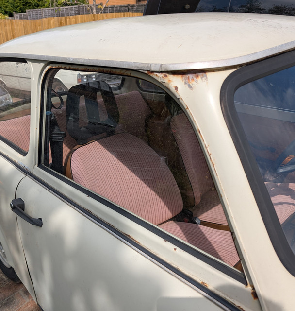

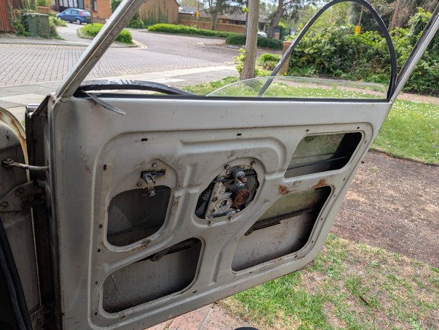

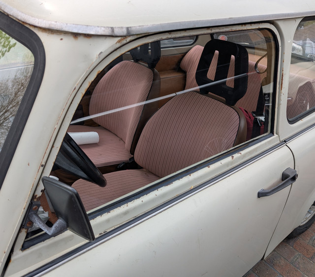

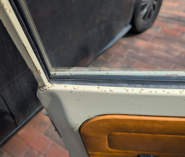

Passenger door was attacked like the driver's one yesterday. You can see here how slack the glass was in the old seals.
Just like yesterday everything was pulled apart.
New seals in.
The wiper seals at the base of the window on this side are in good shape so I left them alone.

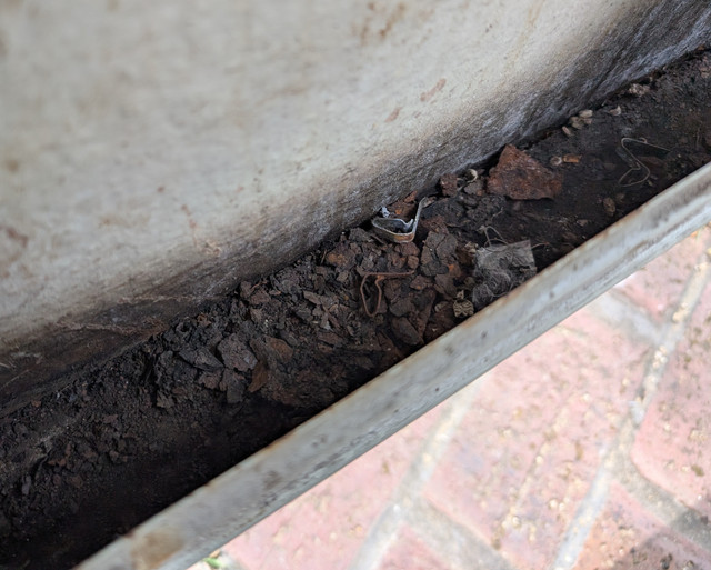

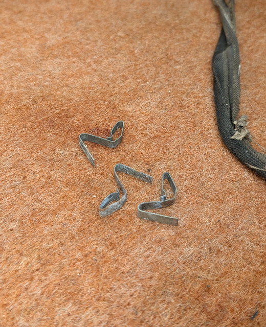

I also took the opportunity to hoover all the detritus out of the bottom of the door.
Which somewhat surprisingly included three usable trim clips.

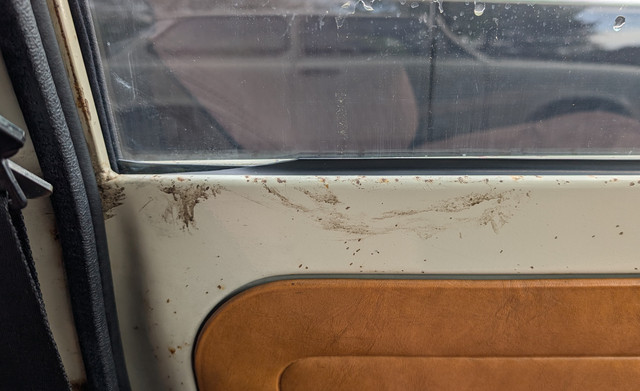

There has been a horrible smear of paint or something on the top of the inside of the driver's door since I got the car.
This has defied all efforts to remove it with normal cleaning products, so today I hit it with some cutting paste to see if that would do anything - it finally did but took a fair bit of scrubbing.
Have also replaced the torn wiper seal on that window now. This was far more of a fight than the outside one as there was a window in the way which was now fairly firmly held in place because everything else had been replaced.

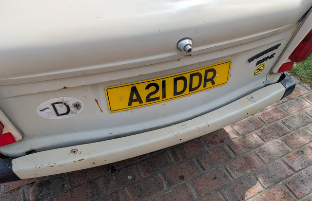

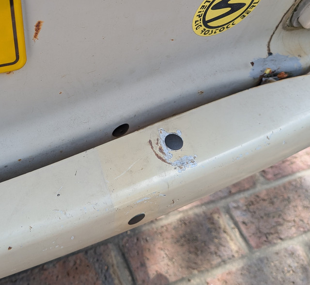

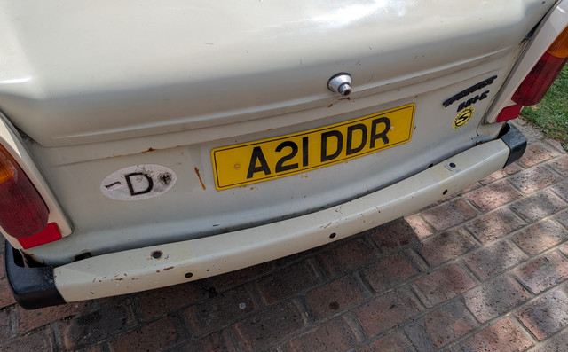

Minor details seem to be the order of the day this weekend. Like the holes in the bumpers which originally held additional lights or something like that.
Much tidier.

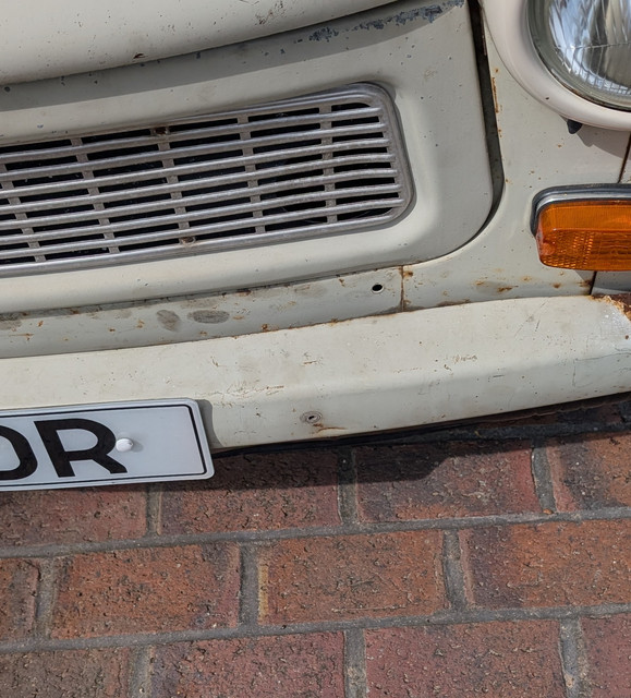

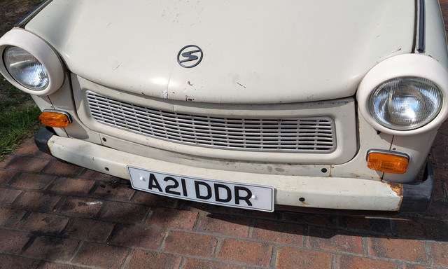

Same deal up front where I was missing two blanking plugs.
Oh, and finally wiped that oily handprint off the front panel and bonnet.

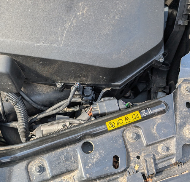

Final quick job was dealing with a bright red cable tie in the engine bay of the Volvo which has been bugging me for at least the last six months.
The solenoid which controls the vacuum supply to on the engine mounts (yes really) has a broken clip and was zip tied to its bracket. Fair enough but it was squint and had a red zip tie holding it on. Lined it up better and swapped for a black one so it doesn't stick out like such a sore thumb.
Has only taken me six months to sort that...
