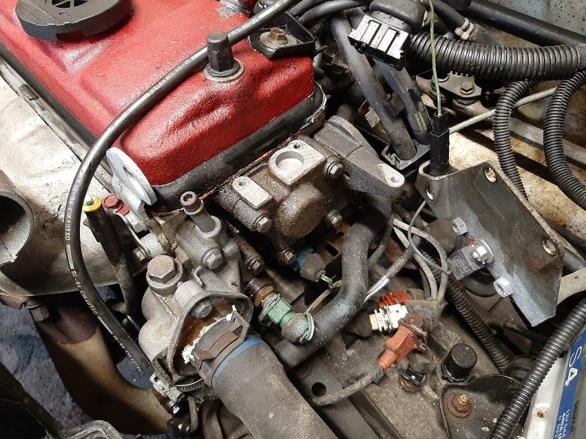

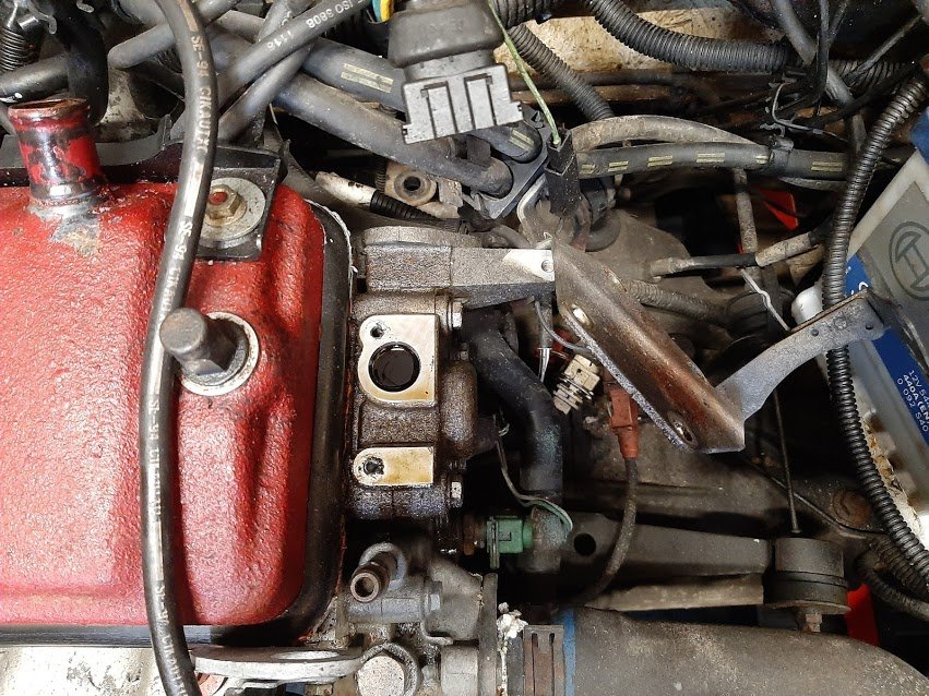

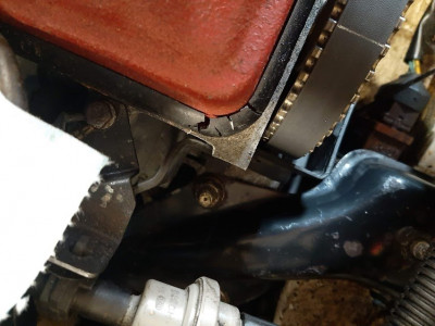

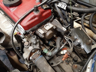

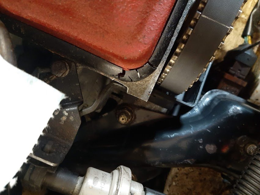

Today is another wet one here so after I enjoyed a virtual bike ride around Innsbruck in Austria I set about looking into the oil leak at the top of Daffodil's engine. I was keen to determine if iot was from her rocker box or her cylinder head... I stripped off all that was needed for full access (coil and induction mainly) and was happy to confirm it was the rocker box. A nice pool of oil had gathered in a blind hole in the end casting just under where the coil sits...
Oil Leak 1
Oil Leak 1
Another view with the oil 'pond' now drained...
Oil Leak 2
Oil Leak 2
I spent some time cleaning up where the oil had made a mess and cleaned up all the bits I'd removed to gain access. very satisfying work :D
The rocker box gasket has definitely seen better days! A replacement is on order :)
Cracks in rocker box gasket...
When I replace the rocker box gasket I'll take the opportunity to check the valve clearances...
