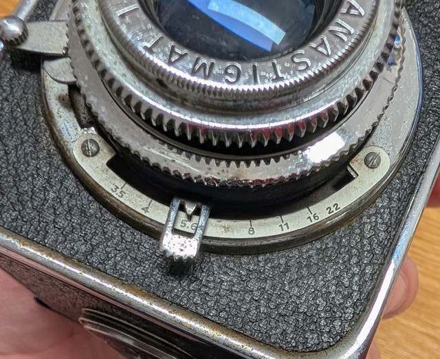

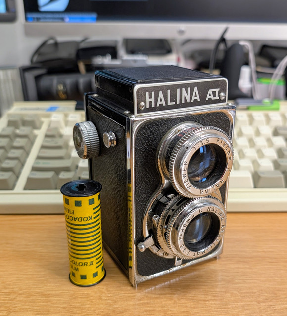

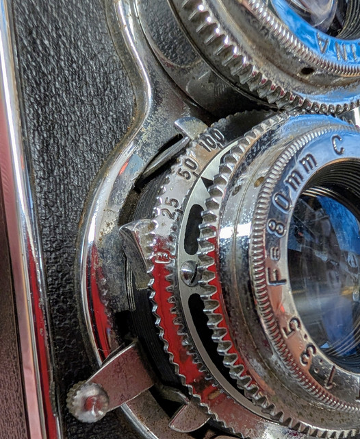

I need another camera like a hole in the head, so of course I picked this up today.
Been after a TLR for a while but hadn't seen one cheap enough. Had a roll of fully exposed film in too - which I'll definitely be getting developed to see if there's anything on there. May well be given that as far as I can tell this camera seems to be fully working.
Pretty basic little thing, just four shutter speeds - B, 1/25, 1/50, 1/100s, f/3.5-22, and that's about it.
The world being upside down and back to front in the viewfinder is a recipe for making yourself feel properly motion sick if you're trying to frame anything that's moving. It is nice bright and clear though.
A lot of photographers seem to like to hate on Halina, but I've had quite a few of their cameras and the worst I've been able to say about any of them, even the cheapest and most basic was that they were aversge and performed as you'd have expected for the price tag. Never thought there was anything wrong with them. Yes they churned out some utter tat in the late 80s and into the 90s, but you can say that about just about any company aiming at the general consumer market.
This one isn't going to give a Rolleiflex anything to worry about, but it seems absolutely perfectly fit for purpose, and I'd wager that with a bit of patience and practice it'll produce some cracking photos.
All it's needed as far as I can tell was freeing up the focus control which was a bit gummy, and cleaning the cobwebs off the viewfinder screen. Has some relatively cheap film in just now as a test run.

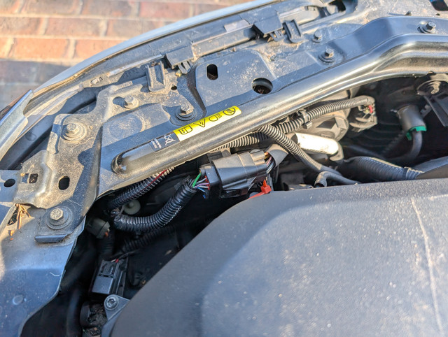

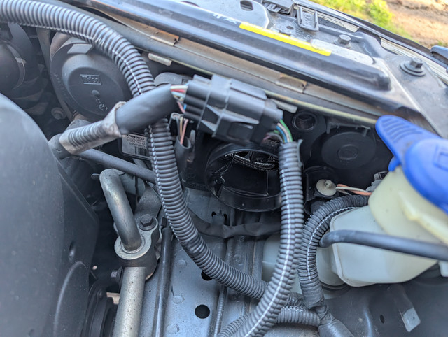

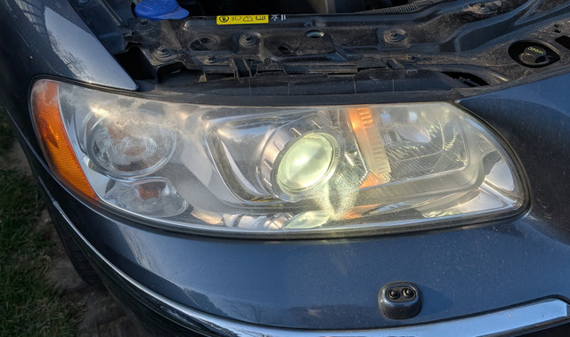

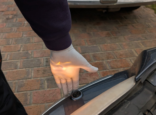

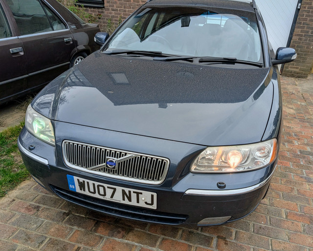

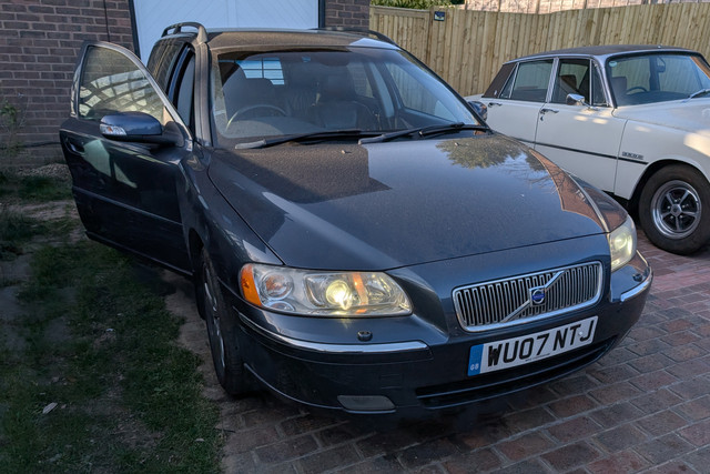

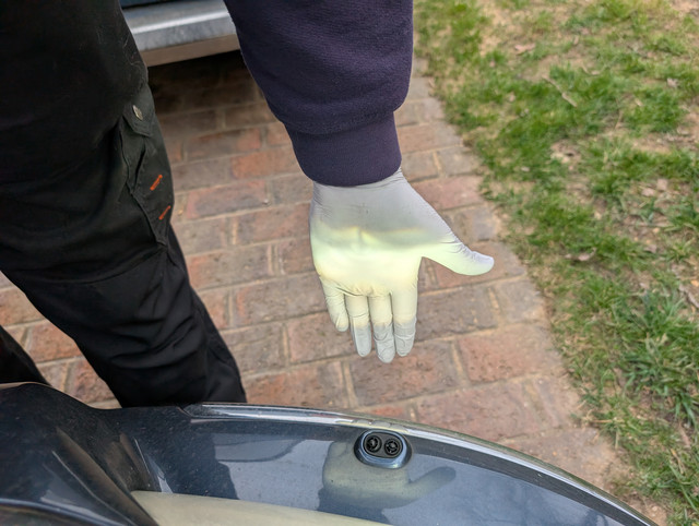

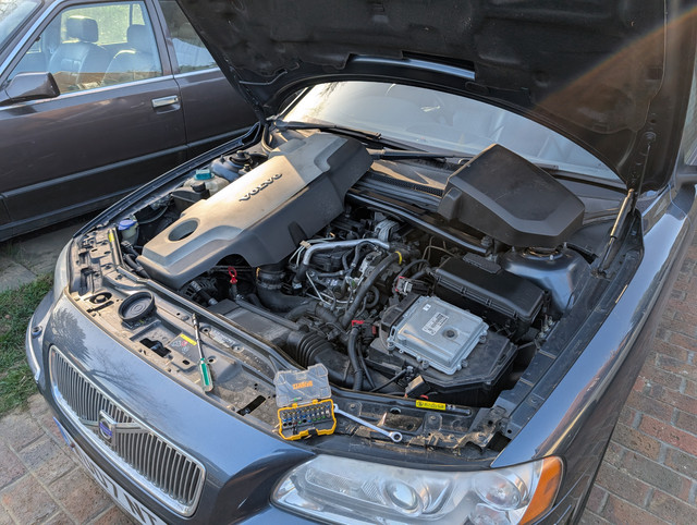

Well this isn't ideal.
My camera has got hopelessly confused with the colour balance here (I did spend several minutes fighting with it before giving up). The offside headlight is actually a normal neutral 4000K-ish white. The nearside one however has turned a distinctly orangish-pink colour.
Good side:
Bad side:

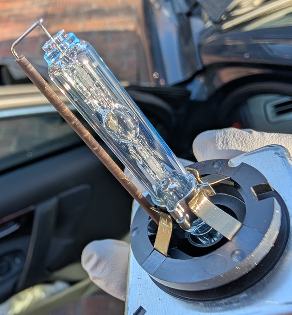

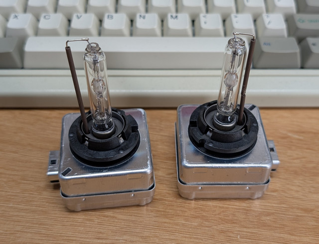

This is a pretty standard failure mode of any metal halide discharge lamp, automotive or otherwise. Basically as the lamp ages the halide salts are used up, until eventually the balance is thrown off - or blackening of the arc tube causes is to start overheating, which also throws things off and will usually manifest as a colour shift. It's pretty important that as soon as a halide lamp starts to show any change in characteristics that it's replaced then - don't just leave it until it stops working. For a very simple reason, it might explode! The halide salts are actually corrosive and over the life of the lamp do eat away at the envelope, so if operated until the very end they can (and in some cases do) go pop. Especially keeping in mind that the atmosphere in ones like this is somewhere in the region of 7 bar when operating, so there's quite a bit of pressure in that tiny little quartz capsule.
New ground for me as this is the first car I've ever owned with HID headlights (which in this case also swivel to look round corners), but something I figured I'd need to do battle with at some point, especially as the lights on this car are always on when the engine is running.
Surprisingly there is actually provision for replacement of the lamps here and it's not too bad to get to them. Though on the nearside the air cleaner/one of the ECUs is just close enough to the back of the headlight to be REALLY ANNOYING.
The connector just pulls off the bottom, then twisting the big black tab you can see at about 10 o'clock anticlockwise releases the lamp from the housing.
The silver boxes attached to the lamps contains the high voltage igniter - these require a pulse somewhere in the region of 20-30kV to provide the ability for hot restrike (as waiting several minutes to relight a lamp in an automotive application is a big no no). This arrangement with the igniter integrated into the lamp base vastly simplifies the wiring arrangements as the line between the ballast and lamp only has to deal with ~100V rather than the starting pulse. It's also the most likely component to fail, so having a new one fitted with each lamp isn't the worst idea.
A new pair of lamps are on the way and hopefully will be here tomorrow. At which point I'll find out precisely how much more annoying the proximity of the air cleaner housing is going to be in getting the new lamp into place.

CitroJim wrote: 30 Mar 2025, 06:24 Interesting stuff Zel :) Good to see they're not hugely difficult to make good again... I would imagine those bulbs are quite pricy compared to a good old H4 Halogen?
They are comparatively pricy at around fifty quid a pop. Though if they only need changing every 75K miles or 18 years I'm honestly not going to complain. Yes you can probably get them cheaper if you're willing to use ones from a brand you've never heard of or play the counterfeit lottery on eBay/Amazon - personally I'm not though. The lamps are comparatively cheap and easy to replace - the ballasts aren't and require me to dismantle a not inconsiderable percentage of the front end of the car to get to.
Of course it's a thousand times better than the LED setups on virtually everything in the last couple of years where there are no user replaceable lamps in there at all. It's new headlight time - which often have four figure price tags attached. I can honestly see a situation where headlights failing simply due to the bell curve of natural attrition over time start to write off cars which are only around ten years old.
MattBLancs wrote: 30 Mar 2025, 09:45 How about removing the headlight complete? I am sure I read somewhere about the whole headlamp assembly being very easy to remove on certain Volvo models. Can't recall which, so typically unhelpful there, sorry!
Sadly that's a "dismantle the entire front of the car first" job on this one. Which is a pain as getting the units on the bench would make getting them properly polished up WAY easier than it is trying to do that with them on the car without damaging surrounding paintwork. I don't think it's as involved as on some cars, but it's still far from a five minute job.

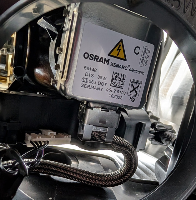

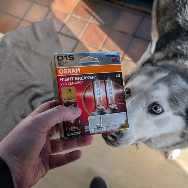

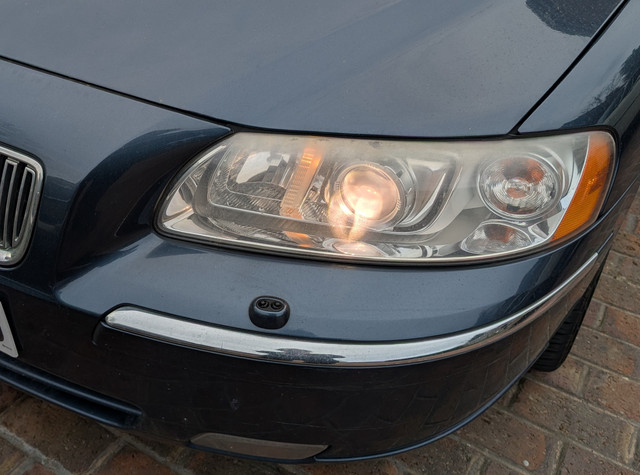

Replacements arrived today. Shown here during the standard customs inspection.
Failed inspection on account of being too boring and not edible. Better put them in the car then if they're not allowed in the house!
Shiny.

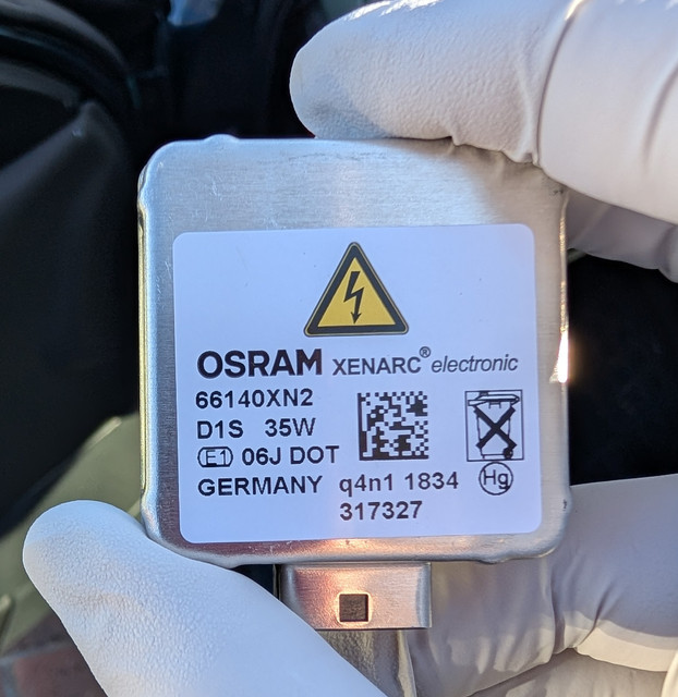

Part number for those of you playing along at home.

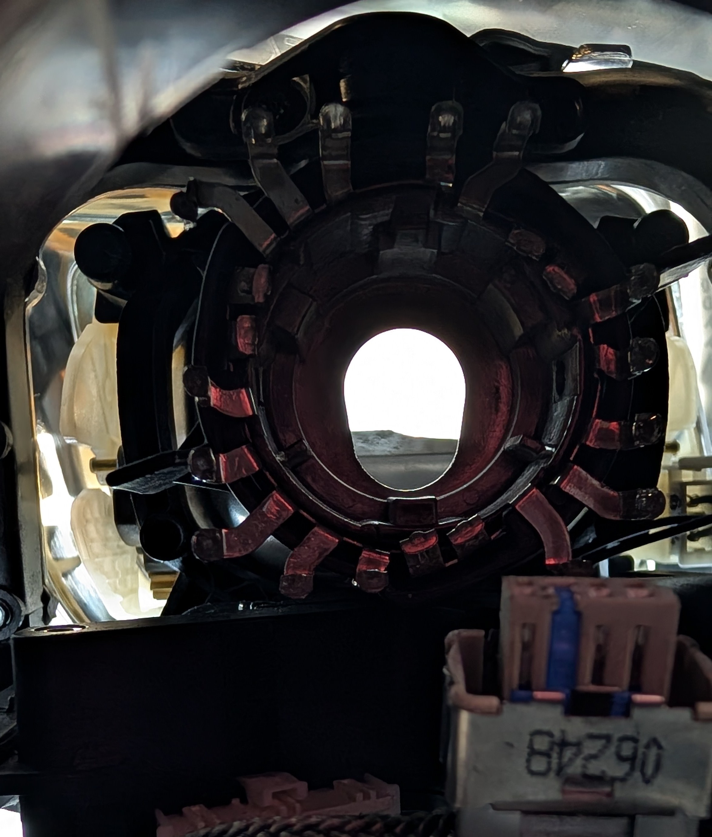

The driver's side is really easy. You can clearly see where the access cover is off below. This took roughly 30 seconds to install.
Passenger side, not so much.
Of course this one was the side which refused to just slot in wasn't it. Cue escalation.
Eventually I figured out why it was refusing to seat. Around the perimeter there are a bunch of springy copper "fingers" which grip the metal housing of the igniter, presumably for RFI suppression. Two of these had been bent over so were getting in the way. Just to the right of 6 o'clock in the photo below.
Given how ridiculously tight the locking ring was when I tried to remove the lamp from this side and scratches in that area on the lamp i removed I reckon these have been bent out of shape for a long time. With them bent back out of the way the lamp just slotted in and locked into place without needing to use unreasonable force. Which given the whole thing you're locking it to sits on a gimbal arrangement which can move in all directions is nice as you really don't want to break it as then it would be new headlight time.
Much better.
Both lights are now the same colour. Definitely better than they were - definitely had a distinctly greenish tint before.
Be curious to take the car out after dark to see if they're noticeably brighter - kind of hard to tell just sitting in the driveway. Really do need to get the lenses properly polished up though as they no doubt aren't helping, and do let down the look of the car a bit. Job done for now though.
Now just to wait a couple of weeks for the skin on my right wrist to grow back!
