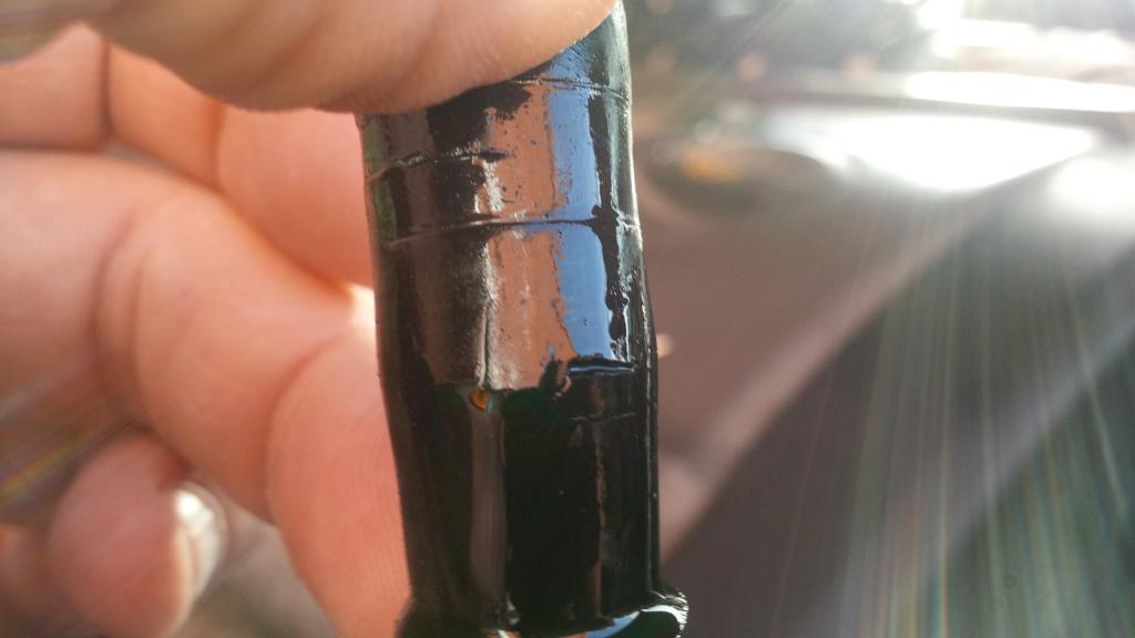

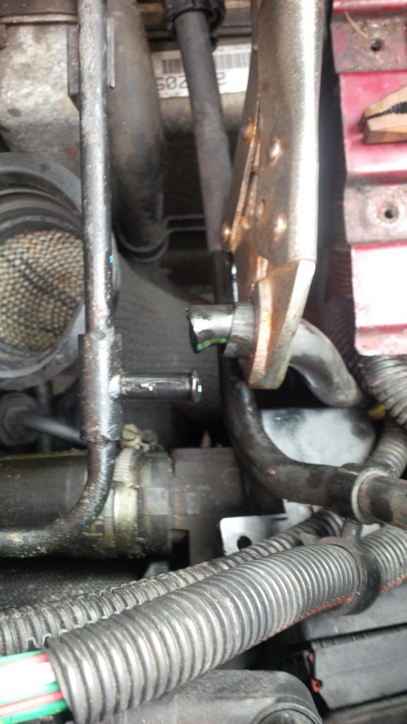

I decided this morning that I was going to tackle the leak from the push together jubilee clip on the Xantia, only to discover after replacing the clip, that it was in fact a split pipe
I managed to cut off the damaged part, about 1/2 inch and replaced it. so now being covered in LHM i decided to have a look at the other pipe that I had been concerned about for sometime and do the same thing
I'm getting quite brave now

Well done on the pipe repairs Steve
You see, little jobs like that will soon lead to larger ones as confidence grows.. Soon you'll only ever need a garage for an MOT.
I'm serious. It's how most of us started. Work up to the bigger stuff gently and you'll amaze yourself what you'll soon be doing.
