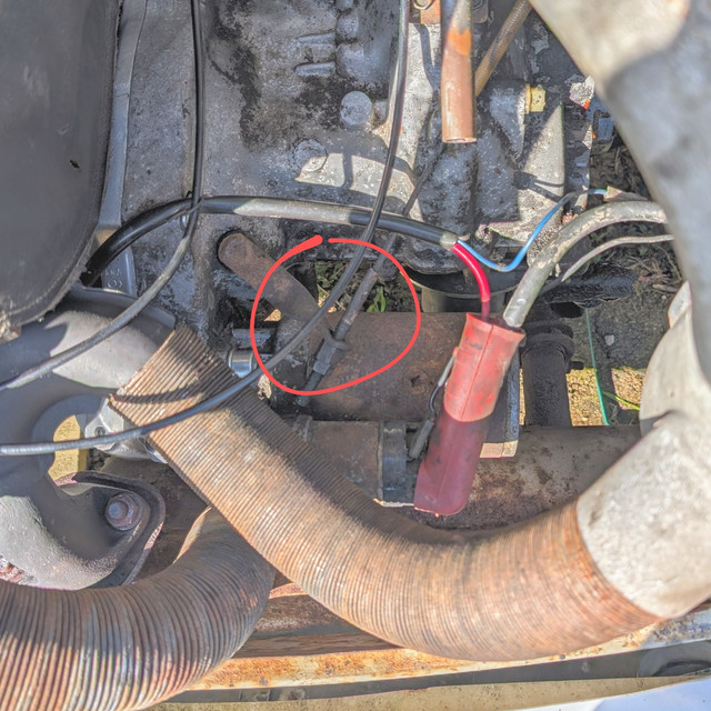

The horrible noise when I turned round was coming from the nearside rear wheel. The hub nut needed to be tightened up a bit so there was a bit of play in there. Seems to now have stopped. I am braced for having to take that all apart soon anyway - I've had to change one rear wheel bearing, so am expecting to change that one most likely at some point as well.

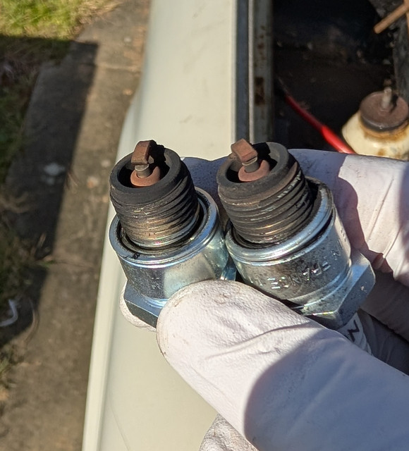

First up was the violently rough idle.

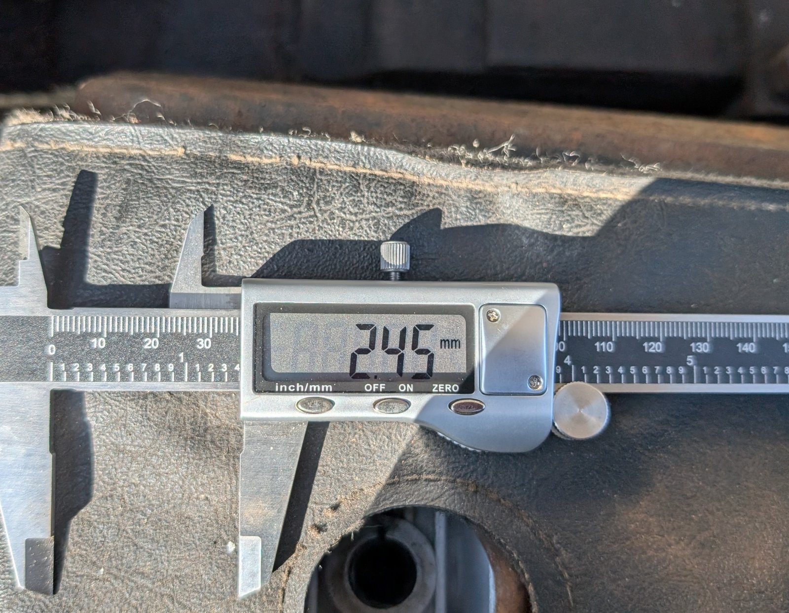

I wanted to double check my timing there as it just didn't sound quite right to me. Not sure if I just fouled up setting things last time round or if the plate moved slightly while I was tightening things up, but sure enough it was quite a way off. The way timing it set in these engines is a bit odd compared to a normal four stroke, in that it's nothing to do with timing lights or marks. The timing is set to fire when the *piston* is 2mm before top dead centre. There seems to be a bit of debate as to whether 2 or 3 is the best number, but I've gone with 2. It was nearer 5 before. This is actually set by setting the piston to where you want it to be, then slowly rotating the board the pickup is on until you hear the plugs fire. This is probably a bit more fiddly on the older setup with dual points, but with the electronic ignition (84 onwards) it's dead simple.
This is what the plugs look like after the ~100 miles or so the engine has now done.
This has definitely helped, though I think I'd still like to bump the idle speed up a touch - probably only needs a hundred RPM or so, just want to reduce the amount of vibration a bit. I was loathe to mess with things too much until everything had had a chance to bed in a bit though.

Definitely have a bit of noise coming from the nearside rear wheel. You can hear something lightly squeaking if you're driving at low speed and there's a wall etc bouncing the sound back to you. I'll have a closer poke around at the weekend, but most likely it wants the bearings changed as I did on the other side. Actually I reckon the bearing probably would have been fine if thoroughly cleaned and re-greased, but given there's no way to do that without dismantling the hub, which involves removing the suspension arm it's a bit daft to not just replace everything while you're in there anyway by that point. I will just make sure it's not just the nut needing tightened up though as if it's loose that will allow there to be play where there shouldn't be. I'm not actually too worried immediately, having seen how hugely chunky the bearings etc are compared to the car! If they were about to come apart you'd know about it - what I'm actually hearing is the brake shoes just lightly touching the drum most likely.

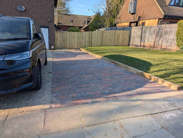

In other vaguely car related exciting news...look at what's nearly finished!
Useful space on the right used to finish roughly where the shadow of the second car starts.
Hopefully will be able to start using it in the next day or two - one more round with the vibrating plate tomorrow hopefully should be it I believe. Pretty sure that there will be room to get the car behind there in/out without the forward one having to move. Have never actually had room to get a car in there - while the hard standing actually extended in there further than we realised, it has always been overgrown and there was a fence in the way as for some unknown reason it used to kick out towards us right where the driveway starts. Was a useless space on both sides. So this will finally get me to a point where I'm only one car short of actually having everything on the driveway properly.

I'm liking the driveway Zel
Reminds me, I must make arrangements to get mine done soon...

I've just started to scrub the moss off my paved area.

Timing on the Trabant is something I've been advised by several folks to just follow the guides on. It's something where the required adjustment apparently needs to be really precise. Given how close to the ragged edge of tearing themselves to pieces two strokes run at the best of times I'm inclined to just trust the advice from the owners clubs on that.
I imagine with how much the thing you're trying to adjust by fractions of a millimetre would be bouncing around with the engine running, it would be near impossible to get the necessary precision that way. If there was actually an adjustment screw maybe - but it's just a case of loosening the whole pickup assembly, rotating it to the necessary spot and then tightening the screws back up (while making sure it doesn't move). So doing that while things are wobbling around sounds like a recipe for frustration.

Pressure washers are your friend here!

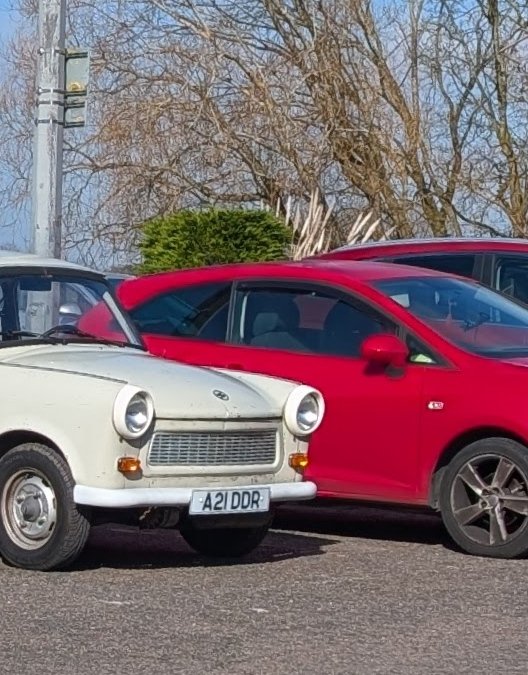

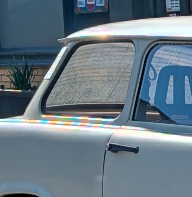

Couple of examples of the nonsense I get with the camera on this thing.
Aside from the obvious colour flaring (which regularly makes itself known on any highlights), note also the "steps" on that strip running left to right and on the base of the window - also the cogging along the door frame. This is no less evident even if you've got it set to 50MP rather than 10MP. It's like life with a 1MP £50 digital camera from 2001 all over again. That step about 1/3 of the way right-left along the bottom of the rear window, that's not there. That is entirely a step that has been invented by the camera.

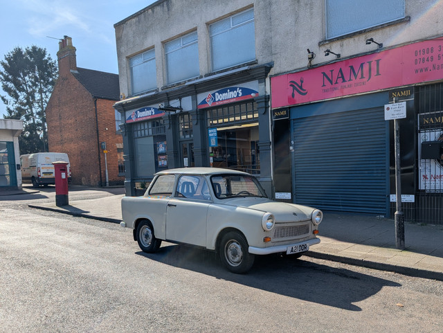

"JPEG compression like effects" are most obvious on red objects - like the car below.
I could accept this maybe if I had the quality settings turned waaaaaaaay down. However it's saving at a quality setting of 98, and most critically even if you're saving as RAW files it looks just as bad. Whatever's going on there is going on on the sensor rather than in post processing.
I can't immediately find any examples (probably because I deleted the photos), but it regularly gets its knickers in a twist when dealing with repeating geometric patterns like brickwork as well.

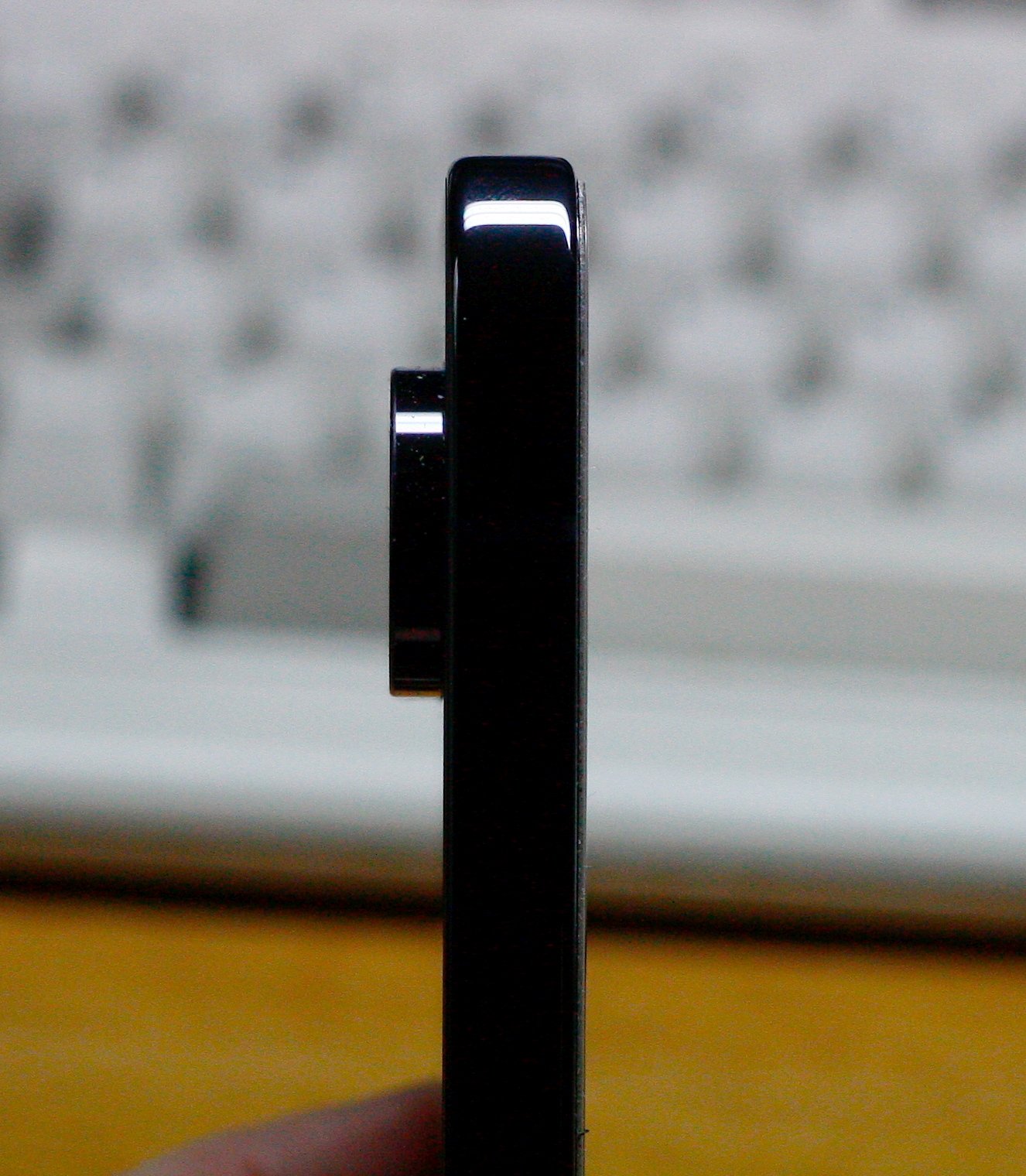

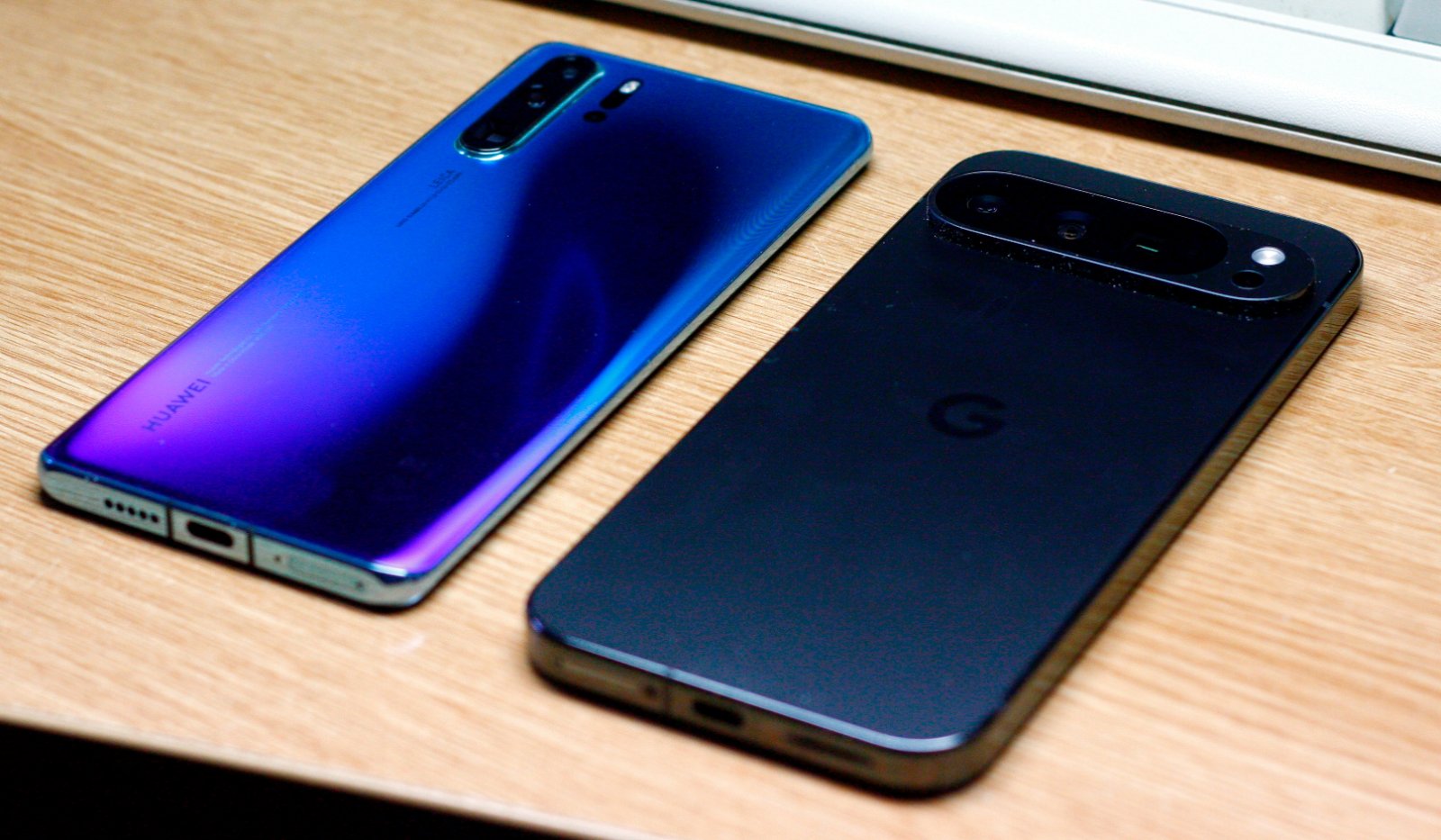

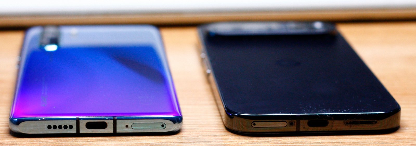

Speaking of the camera...Who on earth thought THIS was a sensible design?
The thing is a decent bit chunkier than the Huawei anyway - but not so much you'd really notice if it wasn't for the stupid sticky-outy-camera at the top.
That camera though, especially once you've added a case that provides any meaningful protection results in something that's about 1/2" thick. It's not twice as thick as the Huawei, but it's close. Also means it can't lay flat on surfaces (like wireless charging pads - so that functionality is basically pointless), and means it won't fit in most windscreen mounts without removing the case. Where another annoyance becomes apparent - they've situated the buttons along the side for volume/lock screen way further down the side of the phone than I'm used to - so I have to have it dangling way over to one side in the holder or I'll keep turning the volume down or activating Google's stupid artificially insane assistant.
Just from a qualitative standpoint of the device itself though. Like they say with food, the first bite is with the eye.
Which of these immediately looks expensive, versus which looks like an overgrown TV remote with tumour in the form of a camera module growing out of it?
It's just been an very expensive brick of disappointment on every level to be honest. At least I can just pay off the remaining balance on the contract without any additional fees, and they still have a decent enough value on the used market that I could sell it on without being much out of pocket if I can summon enough enthusiasm to deal with the nonsense of trying to sell an electronic device in 2025...

Gosh Zel, the quality of those photos is horrendous for such an expensive 'phone. And that 'sticky out' bit is ridiculous
The quality is so bad, I wonder if there's a fault with it? Never seen colour flare as bad as that. I thought it was lens aberration at first but it doesn't look right for that, more like internal reflections...
On to timing. If you need one, I have a DTI or two here, complete with a 14mm spark plug adaptor.
May take you up on the DTI at some point, though I made it work pretty well by just zeroing this out at TDC I think.
The base was happy enough to sit squarely on the head so it wasn't too much of a faff. Only tools you need are a spark plug spanner, a flat head screwdriver and a means to take the measurement...so pretty simple.

Excellent! That was a good plan to use a vernier caliper... As good as a DTI I reckon
