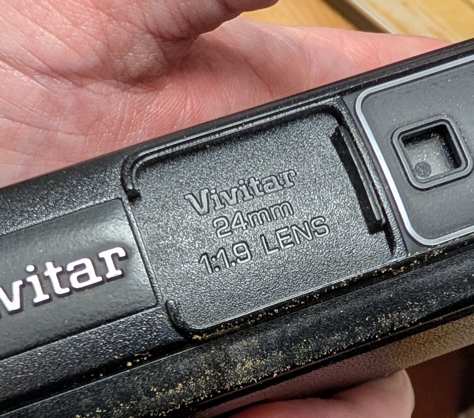

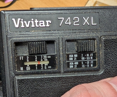

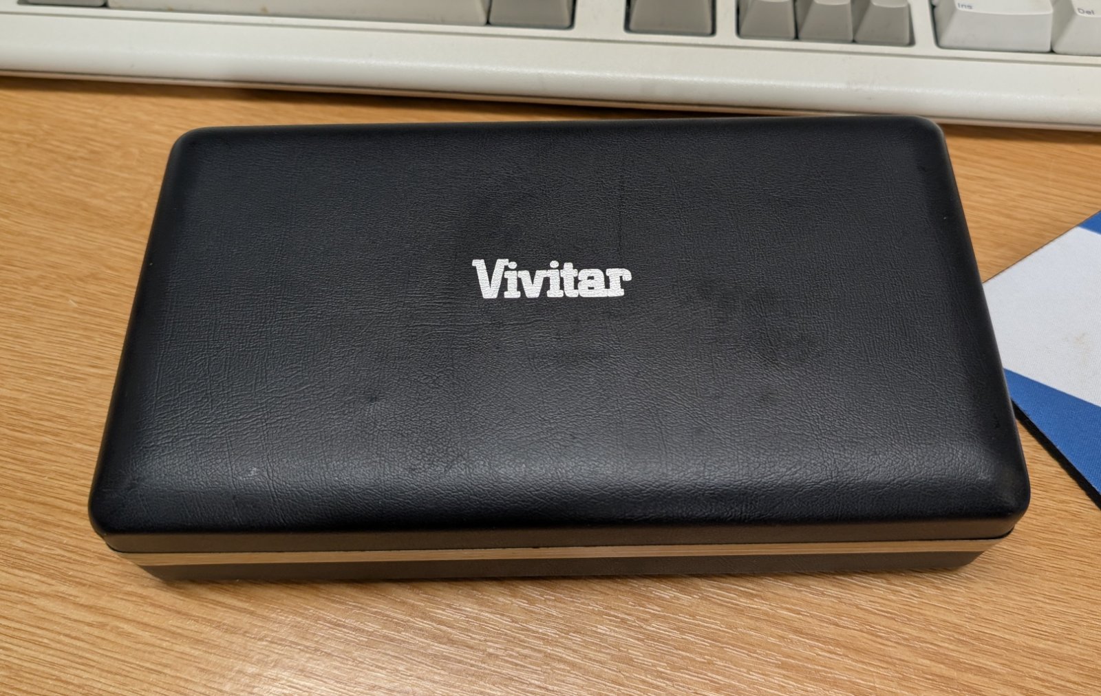

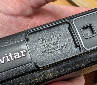

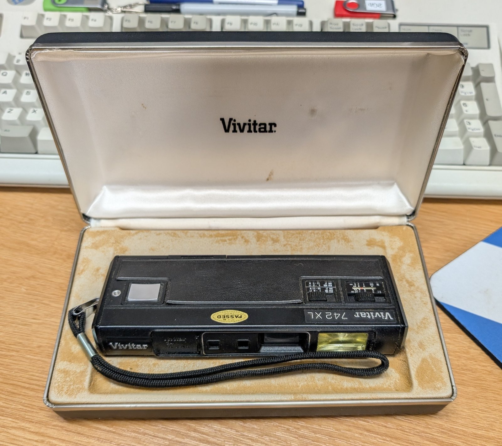

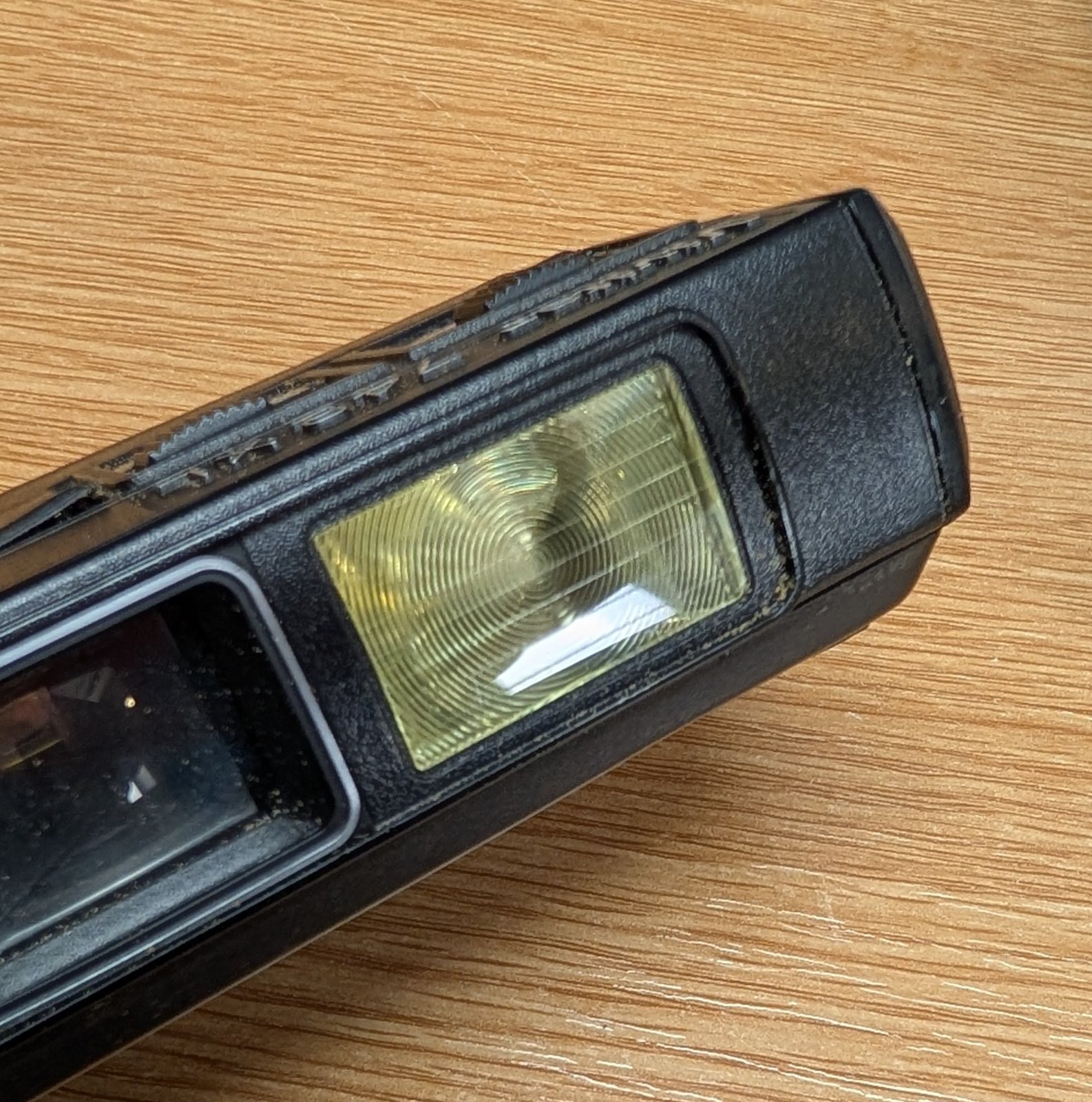

Anyone who's talked photography with me will know I have a major soft spot for 110 cameras, simply because that's where I started out. Plus there are actually some out there which can produce far better results than people would like you to believe. When most people think of 110 cameras they think of fixed focus cheap plastic lenses, fixed exposure times and if you're lucky a built in flash.

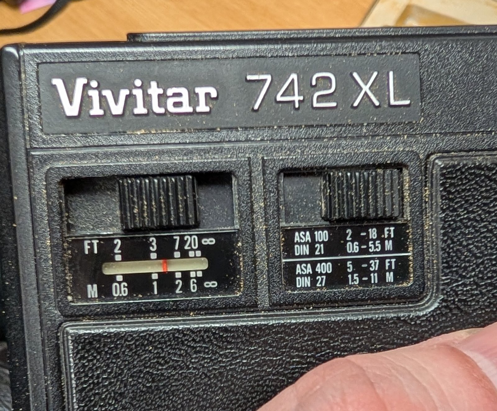

At a glance despite a fancy presentation case this doesn't *look* anything special. Most of Vivitar's 110 cameras are very ordinary. Usually pretty dependable but nothing to write home about. The 742XL however has specs that it's rather drab appearance don't really bely.
For a start unlike most 110 cameras this has a proper five element glass lens, a 24mm example in this case - which can open up all the way to f/1.1.9.
The little plastic lens cover when closed locks the shutter release button and disables power to the flash so you can't waste film nor batteries accident while the camera is in your pocket.

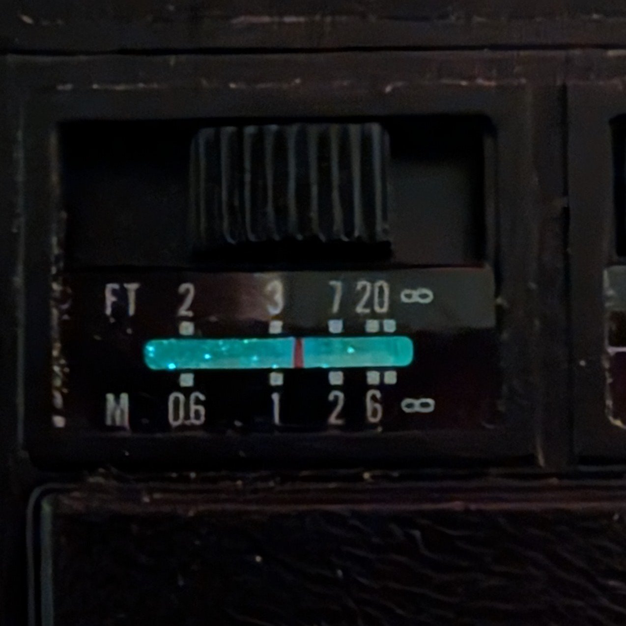

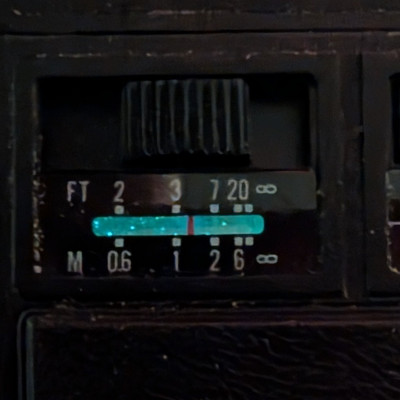

It also has manual focusing - and somewhat to my surprise when I looked through the viewfinder I discovered that this is actually a proper range finder (with an extremely bright and clear viewfinder too).
Exposure is handled electronically, with shutter speeds from 1/800 all the way to 5 seconds available.
The viewfinder has indicator lights for normal and low light level operation, flash ready and low battery level.
Unlike most 110 cameras this has a proper metal threaded tripod mount and even a cable attachment for a remote shutter release.
The flash is apparently good for about ten metres.
Another sign of the attention to detail they have gone to here is that when the flash is turned on, the focus range dial is backlit (by a tiny electroluminescent strip it looks like).
That's unusual to see on any camera, never mind a lowly 110.
It also feels incredibly solid. Most 110 cameras do feel like slightly overgrown TV remote controls - not this one. It has a feeling of solidity to it that you'd normally expect from an old school SLR.
From what I've read (and example photos I've seen) this should be able to produce some results which most people wouldn't believe had come from a 110. Especially with modern films like Lomography's Orca black & white.
This particular example needs a really good clean as the flocked finish in the case has disintegrated - but it all appears to be external only so shouldn't be a problem. I'm definitely looking forward to putting it through it's paces. Having proper adjustable focus (which is apparently actually good down to about 0.4m) on a 110 without the awkward form factors of the Minolta or Pentax SLRs really does open up more options for a bit more than just point and shoot.
Oh, one thing I forgot to mention about this particular camera - it launched in 1976. Yes really, with that comprehensive a feature set.
Not a camera I'd heard of until today, but now I do I'm glad I grabbed it. Also grabbed a couple of filters and a huge handheld Metz flash gun. All for less than £30.

Wow! That's excellent Zel
Wish I'd have known about ImageX's vintage/collectable camera fair. I'd have loved to have joined you! Maybe the next one...
That little 110 Vivitar looks amazing - be great to see photos from it in due course

It must have been a hell of a spec for a 110. Comparing to another one I have on hand (which isn't an ultra basic one - it has a telephoto mode, flash and motor drive. However the optical specs are what you'd usually expect from a 110 - fixed shutter speed of 1/250 second and an aperture of f/5.6. These are the numbers you'd expect - not f/1.9 and 1/800-5 second shutter speeds. I do have one or two others which have variable focus (obviously aside from the two SLRs which are oddballs in their own right) but they just rely on your guesswork for focus - having a proper range finder viewfinder should make it orders of magnitude more usable.CitroJim wrote: 16 Feb 2025, 05:20 Wow! That's excellent ZelWish I'd have known about ImageX's vintage/collectable camera fair. I'd have loved to have joined you! Maybe the next one...
That little 110 Vivitar looks amazing - be great to see photos from it in due course![]()
I'll let you know when the next one is - they're pretty regular throughout the year though. I know you've been feeling under the weather this week, only reason I didn't think to check in with you beforehand this time round. That and only finding out it was on the afternoon before!

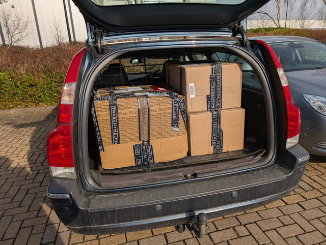

Having followed the tracking numbers for the packages from Trabantwelt, I knew they arrived at my local Parcel Force depot a week ago. Waiting to be dispatched to me once the customs charges were paid...which they insist on sending a physical letter to you containing the reference number that you need to use to pay said charge through their website. Why they couldn't email that number to you with the rest of the tracking information, or indeed let you use one of the two tracking numbers provided to pay the charges I don't know. The last couple of times this had happened I just went to the depot in person with all the details, paid and collected my item then - last time the letter arrived a full 10 days later! No dice when I tried this at the end of last week though, they weren't willing to do anything without the letter. Today I had a parcel to drop off there anyway so asked again as it was someone different on the desk. Result?
A pocket £400 lighter for customs charges and a boot full of boxes. I was sure I was going to have to fold the seats down when I was walking up to the car, but they just vanished into the boot with room to spare. The amount of stuff you can get in the boot of this car is just silly.
Everything was very well packed and double boxed.
This is just the order I randomly found things when I checked out what was in the boxes.

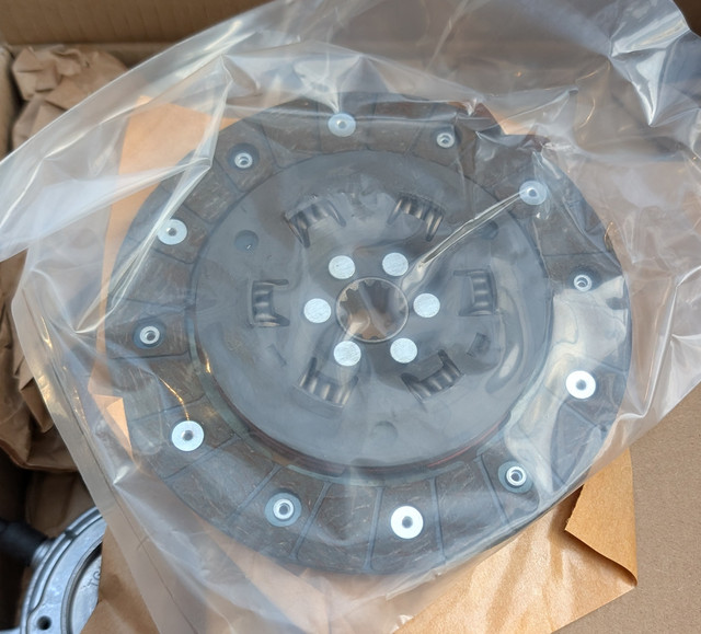

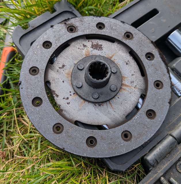

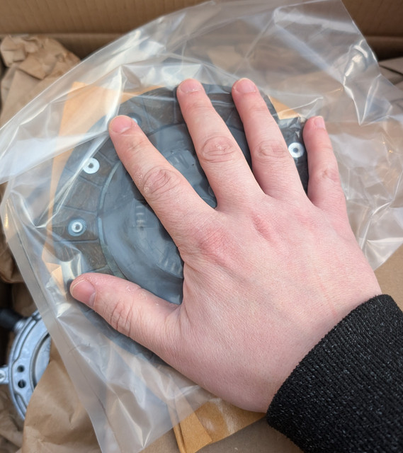

First item I fished out was the new clutch friction disc.
Which is definitely the smallest I've seen on a car. Hand for scale.

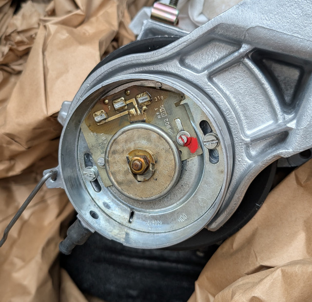

New contact breaker point box.

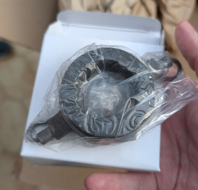

Clutch release bearing.

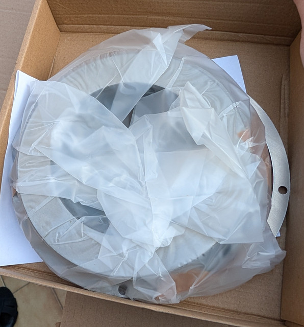

Clutch pressure plate, fittings and instructions.

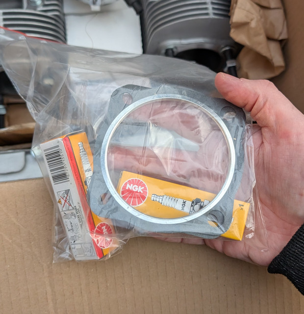

Head gasket set & spark plugs (handy as the new pair of plugs I originally picked up were the wrong sort and I'd forgotten to order more).

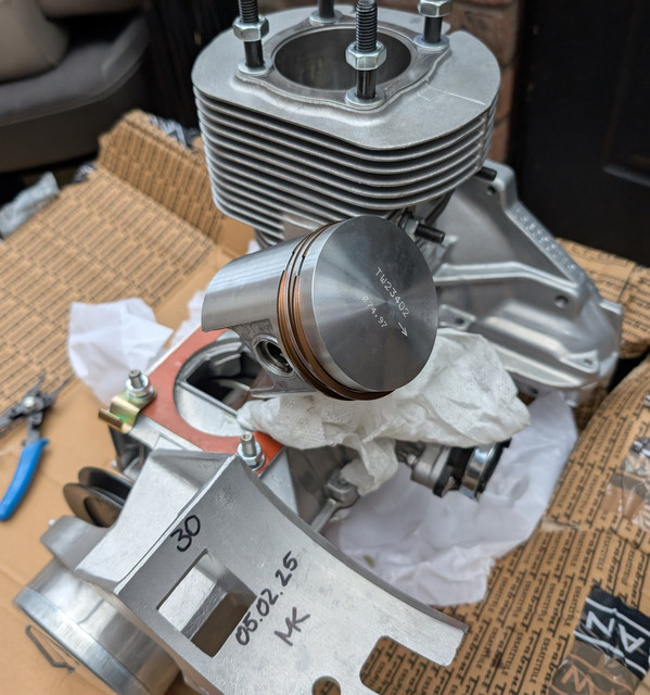

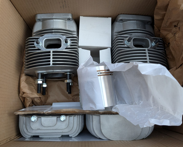

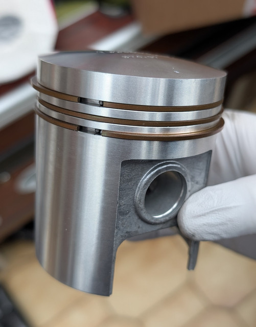

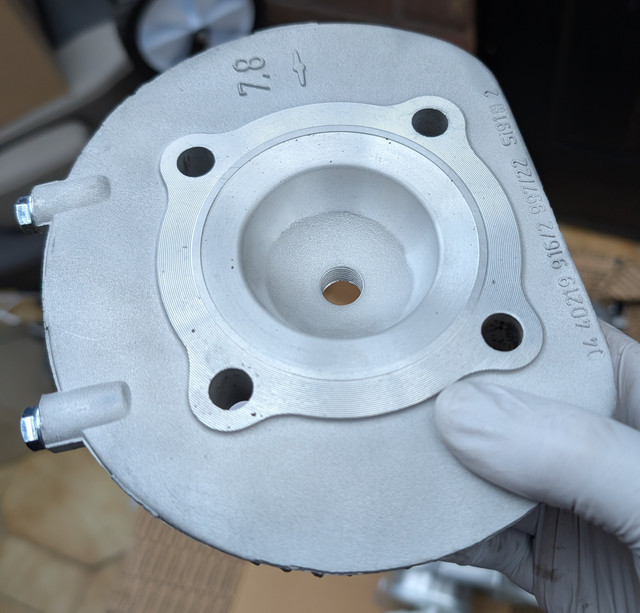

New jugs, heads and pistons. Seeing things like this that are well...new...is kind of strange. Never mind for something that's not been in production for going on 35 years.

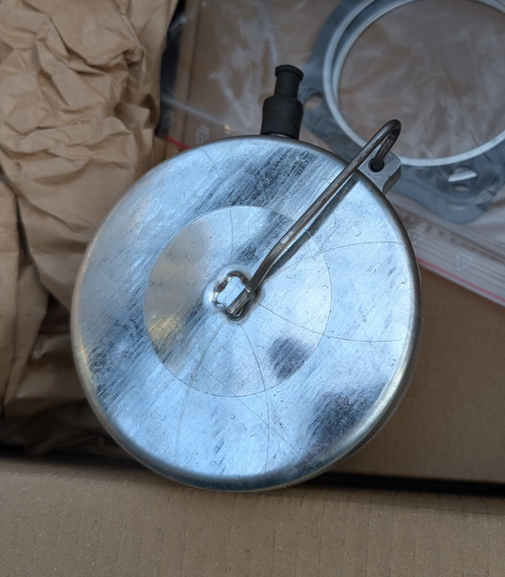

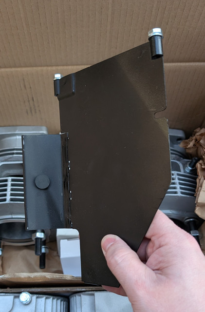

New air guide plate for between the cylinders. Didn't know this was included, not sure if it's a tweaked version as part of the upgrades.

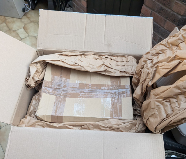

Next box.
Firstly involved extracting an unfeasible seeming amount of padding before extracting any actual parts.

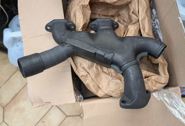

New exhaust manifold. This is one which has had the air jacket modified to provide the additional clearance needed to accommodate the larger (in particular taller) carb. Usually fitting that means losing the preheater duct for the cabin heater. This allows that to be retained and the heater to work as designed. This does actually make a huge difference to how effective the heater is.

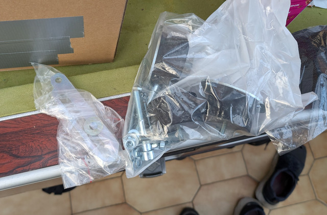

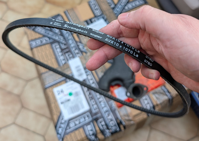

New fan belt - a slightly different length to the stock one. A modified alternator bracket is another part of the Mikuni carb upgrade, and necessitates a slightly different belt length (longer I think).
The aforementioned alternator bracket is on the left, full set of engine/gearbox mounts and their associated hardware on the right.

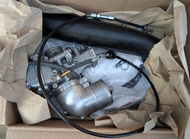

One shiny flat slide Mikuni carb and the required larger bore air filter duct. This has already been jetted and tuned for this engine which should save me a fair bit of time.

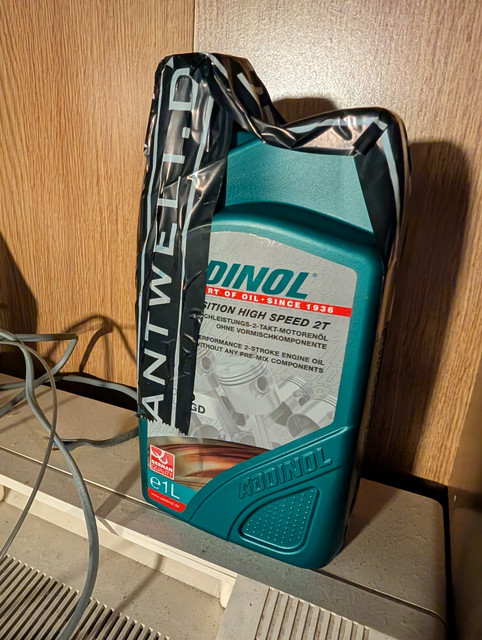

Random bottle of two stroke oil which seems to ship with all their engines and rebuild kits.

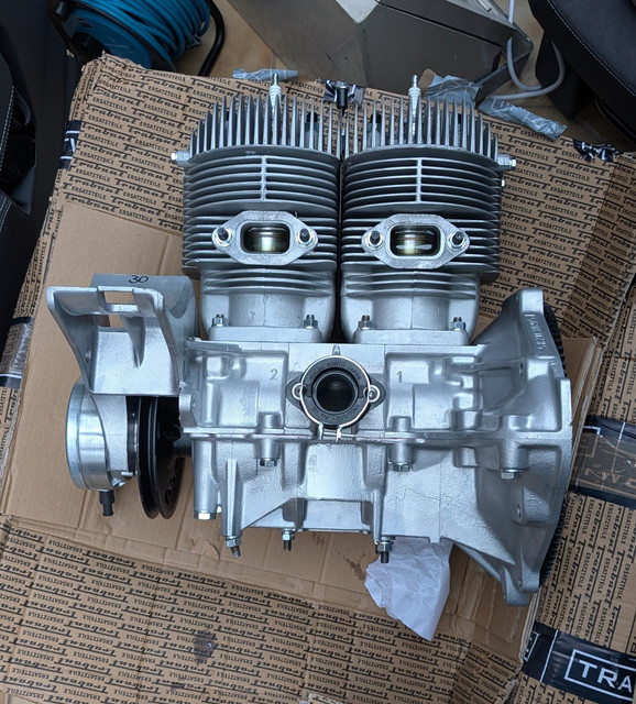

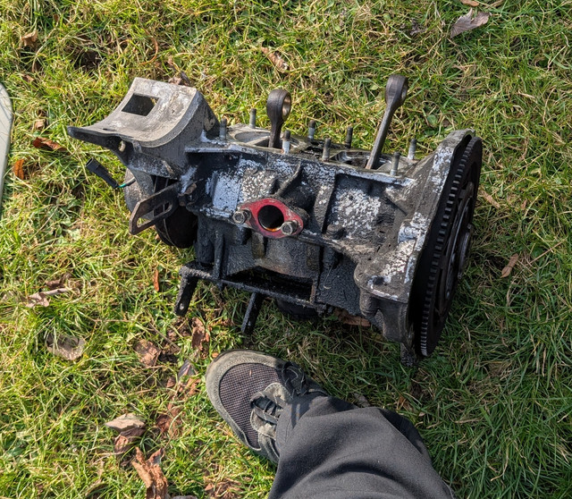

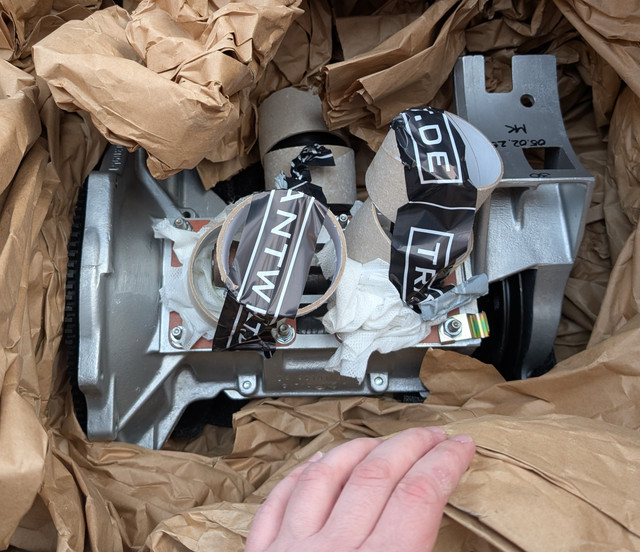

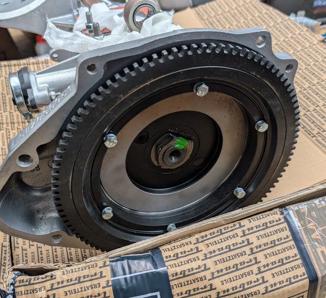

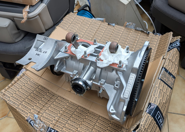

Finally the main event.
One shiny new engine core.

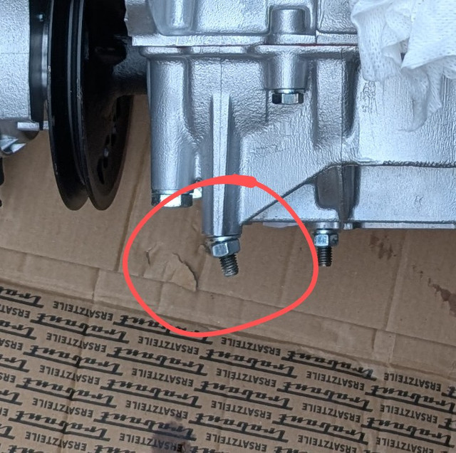

Normally this would have been shipped with the cylinders already fitted, they had to be split to get the weight of the packages down to a point where they could be shipped via their usual DHL setup rather than having to resort to freight which would have been a major headache as far as customs arrangements would have been concerned due to changes which came in at the end of January.
This crankcase also has the necessary adapter to accept the Mikuni carb already installed.
So with this lot all here we can start getting the car back on the road now. Hopefully get the old unit pulled out shortly and get the necessary bits transferred over.

Wow that tiny clutch is hilarious! I looked at the first image without your hand for scale and thought "by Eck, that's some meaty splines on that input shaft!"

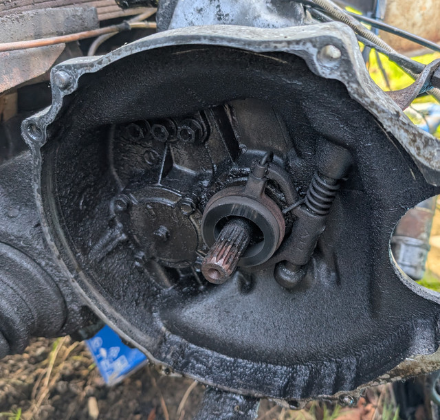

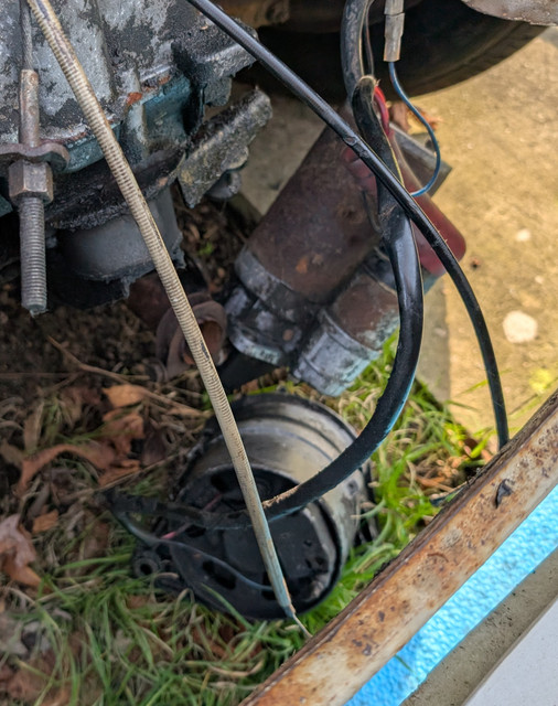

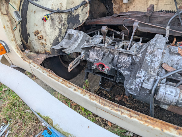

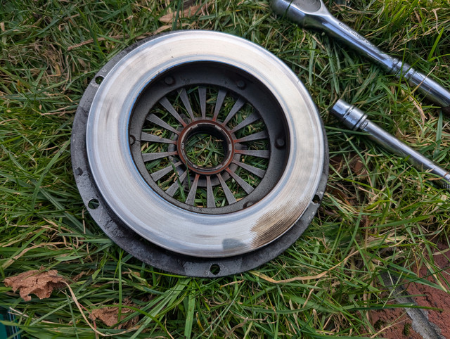

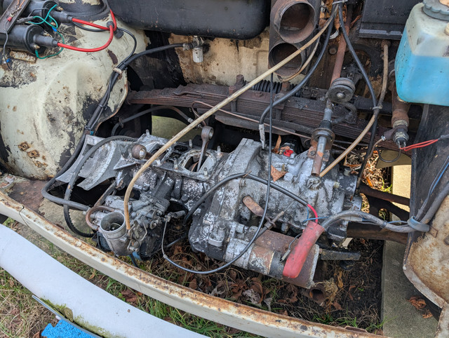

Having to rewind to June to remind myself exactly where we were with this?

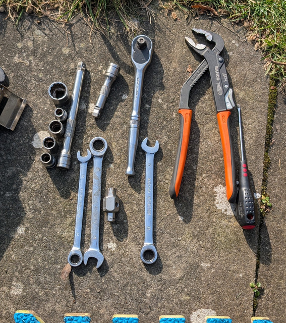

After a brief bit of reminding myself what was and wasn't removed/disconnected we got stuck back in.

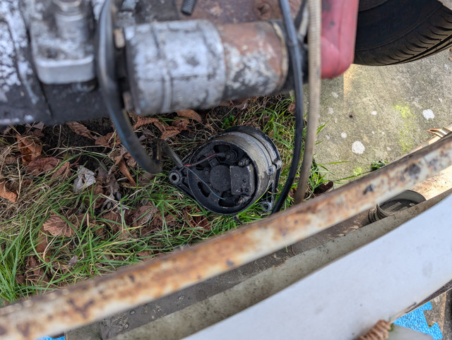

Alternator was detached and tucked out of the way - the main terminal was threatening to pull the post out rather than unbolt do I just left it connected - there's plenty of slack in the wiring to do this once unclipped from the guides on the bell housing and crankcase.

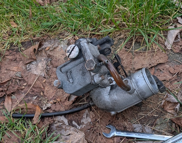

In my sights next was the carb. I'm not absolutely certain it needs to come off to pull the unit, but it sits quite close to the front panel so I figured there was a chance of it causing clearance issues. Cables needed to come off either way, so for the sake of two additional nuts there didn't seem to be much reason not to pull it off.

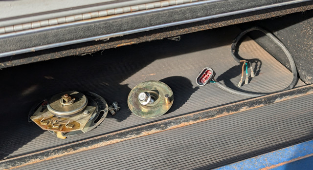

The ignition pickup was disconnected (made easier by the connector I added a while back) and the old fan belt was then pulled. This has reduced the amount of "stuff" we need to contend with quite a lot and made the already small unit look far smaller still.

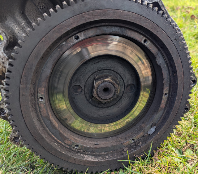

As the bolts holding the starter motor in place also double as two of the bell housing bolts, that had to go and hang out with the alternator for a while. That cost me by far the most time as I had to go and excavate a fair portion of the garage to find a suitable hex bit for them as they have Allen heads. They were also absolutely wicked tight.
Don't do this by the way in most cases. It's a good way to break wiring. However the wiring to the starter on this thing you could probably lift the whole car by.
The cover on the points box was also removed to give a bit of extra clearance at that end of the engine. The one engine mount directly under it was unbolted followed by the remaining bell housing bolts. All four of them. I kept thinking I must have missed one. After only a small amount of swearing later while I figured out exactly which direction things needed to be twisted to fit through the available space, the engine was out.

You may recall me mentioning that I was kind of curious to examine the clutch to see if we could see any evidence which would suggest a reason for the judder. Yeah, we didn't need to look too hard!
While the friction disc doesn't look bad, both the pressure plate and flywheel are pretty horrendous. There are several clear hot spots and some very deep grooves in there on both surfaces. Thankfully none of these parts need to be reused so it's not an issue and it's nice to see a likely cause. The release bearing actually looks near enough new, though as I've got a new one I'll change it. The one coming off is entirely good enough to keep as a spare.
Probably 45 minutes or so (and a decent chunk of that was me finding a hex bit to undo the starter motor bolts) to get from where we started to having it out and the bits I need to transfer removed. Tools used:
Only thing we used initially stripping the engine down and removing the whole top end not shown here was a pair of circlip pliers to remove the clips holding the wrist pins in when pulling the pistons.
Really do wish all cars were this simple to work on!

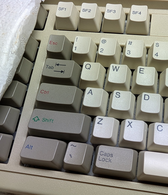

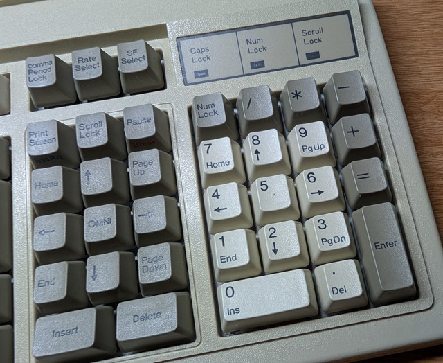

Which if you know your computer keyboards is immediately recognisable.
It's a very subjective thing, but in my opinion Northgate have made the outright nicest to type on keyboards that have ever been out there. This being the top of the tree that they made.
They are also absolute tanks. This thing makes my IBM Model-M feel positively flimsy in comparison, and that's not easy! In addition to a thick steel internal chassis, it's all fastened to an additional steel base plate which weighs more than most modern keyboards in itself - it's well over 2.5kg all in. Not one for a small desk either!
I was lucky enough to have one of these at work for a couple of years (found behind the stationary cupboard when we did a major tidy and rearranged a few things, having been there since the mid 90s based on how deeply buried in the dust it was), sadly cut short when IT upgraded my workstation while I was off site and they swiped it! Have promised myself I'd buy one ever since. This one popped up recently in near enough as new looking condition, and I decided it was time. They're only going to get MORE expensive as time goes on...and they're fluffing expensive as it is.
This one clearly hasn't seen much if indeed *any* use.
Note caps lock and control being in far more sensible locations than we've got used to. When did you last use caps lock? For my part I can't recall any time in the last five years other than having hit it accidentally. Control on the other hand I use all the time. If you prefer those keys in their conventional positions, no problem. It can be changed by DIP switches on the back, and alternative keycaps (and branded key cap pullers) come in the box.
Other layout oddities include something which made using Excel (which I did a lot at work) waaaaaay less annoying. A dedicated equals key as part of the number pad.
It's one of those little things which you really don't notice until you've had it and then had to go back to not. The altered arrangement of the cursor and page navigation keys makes a lot of sense - it's basically identical to that on the number pad so combines cursor control and page navigation rather than having to shuffle your hand back and forth - but without needing you to turn num lock on/off - giving you the best of both worlds. It's something that I'm sure not everyone would like though.
Probably the single most obvious thing about it though is the plethora of extra function keys. Your normal 12 are over on the left (as IBM originally intended and I've always preferred), the 12 across the top (labelled SF1 through SF12) are user programmable. Handy - and definitely something which gives it visible presence on any workstation.

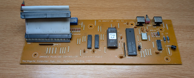

Unfortunately...it doesn't work!
The LEDs blink once as you'd expect when power is supplied, but that's it. Of course as with basically any 30+ year old bit of tech bought from a private seller on eBay there's no comeback - and the costs of returning this to the US would be absurd anyway. Given that depending on the DIP switch settings this can be used with a whole variety of systems (IBM PC-AT/PS2, XT, Tandy 1000 series, Amiga 2/4000, and a few I'd never heard of), I do have to wonder if someone has plugged it in with them set wrong and blown something. I seem to recall that connecting XT keyboards to an AT or vice-versa was a big no-no back in the day despite using the same physical connector.
On the plus side, aside from the actual contents of the EPROM, everything on the controller is readily available and it couldn't be easier to work on.
Just a pretty ordinary 4-bit microcontroller running the show and a scattering of 74-series logic. So assuming someone hasn't done something which has fried that EPROM hopefully we should be able to sort it. If that ROM has gone though we're likely in trouble given that I doubt the image of that is going to be easy to find these days. I do need to do a couple of checks first though just to make sure we don't have something daft like a duff socket or cabling problem - or indeed that the cable in the box isn't the right one - just because it has a PS/2 style plug on the end doesn't necessarily mean anything back in the early 90s! It may well be that simple after all.
Hopefully we can get it going...but it would have been nice for something I buy to NOT need me to start out ownership with a repair just for a change!
It is indeed quite a tight fit to get it out between the inner wing and the gearbox in situ but it's entirely doable, contrary to what a couple of things I've read suggested. Which I'm pleased about as anything which saves me from having to mess about with CV joints can only be a good thing.
As far as weight is concerned, yes it's a reasonably heavy chunk of metal. However it's absolutely reasonable to lift it by hand so long as you've planned it out and are a bit careful. Once out the car and you can get a better angle on it it's really not hard to pick up or carry around. It's a lot lighter than the starter motor on a Gardner 6LXW - that much I can tell you!
Ignition pickup bits have been removed and safely stashed for transfer to the new unit.
Helpfully is all keyed so you'd really have to try to fit it wrong - the only actual adjustment needed is to ensure that the ignition triggers with the piston 2mm before top dead centre.

Speaking of judder, the clutch that's come off is looking remarkably devoid of springs - they help with smoothing the engagement, don't they?
As only ever really messed with four stroke things, does look really odd to my eyes, seeing the carb flange in the middle of the block!
Zelandeth
- Posts: 5331
- Joined: 16 Nov 2014, 23:36
- x 1607
Re: Zel's Fleet Blog - BX, Jag XJ-S, Sinclair C5, Mercedes 208D & 230TE, AC Model 70.
Yes they do. The clutch that's going on has a sprung friction plate. The stock ones do tend to feel a bit agricultural. The sprung plate is a nice quality of life upgrade apparently.MattBLancs wrote: 19 Feb 2025, 21:12 Speaking of judder, the clutch that's come off is looking remarkably devoid of springs - they help with smoothing the engagement, don't they?
As only ever really messed with four stroke things, does look really odd to my eyes, seeing the carb flange in the middle of the block!![]()
If the intake looks strange to you, how about the cylinder heads?
This afternoon I took advantage of the packaging holding the engine snugly enough to hold it at an odd angle while I attached the ignition pickup module.
Then I pulled it out of the box and used the box it came in as a workbench.
Having seen the state of the flywheel on the original engine, here's what it should look like.
Let's get this pile of boxes looking more like an engine.
Shiny new pistons.
Note that it's very important to ensure the rings are clocked correctly on these engines as there's a little pin which keeps the ring gap clear of the cylinder ports. If you don't line it up right you'll break things.
Things really went together pretty painlessly.
Somehow I managed not to even launch any of the wrist pin circlips into my face.
I really appreciate that Trabant machined a little chamfer on the bottom of the cylinder barrels so you don't need a piston ring compressor to get the barrels on.
It's almost looking like an engine now.
Yes, I did stuff a rag in that intake immediately after the photo.
Tomorrow I will hopefully get the timing set, attach the clutch, the lower engine mount and alternator bracket, then it should be ready to go in the car. Head bolts still need to be torqued down, but that will be orders of magnitude easier when it's actually in the car and held in place.
One thing I did spot was that we do have one stud that's been bent during shipping.
This is where the alternator bracket attaches. Not quite sure how they managed that as this was really well packaged. Not the end of the world, I'll just pull the stud from the old engine and swap that over. Just glad I spotted it before I was actively attaching things to it.
Glad to report we have a success story with the keyboard.
This is why you always should check the basics before panicking too much. Turns out all that was amiss was a duff AT to PS/2 converter. Funnily enough, something using a serial data stream doesn't work so well when there's no clock signal getting through. Having dug a random male-male PS/2 cable out of the Box O' Cables (TM) we're now up and running. Ten minutes of testing has allowed me to confirm that in fact the occasional double typing of the letter A is in fact something to do with my PC rather than the keyboard as it's happening on here as well. Something for future me to investigate I guess.

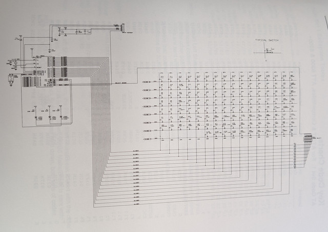

Something worth noting...this is a keyboard. Just a keyboard. It comes with a 43 page manual, which aside from instructions on how to use and configure the more advanced features also includes...
Full schematics, including the key matrix.
...and all the scan codes it sends in all the various operating modes.
If only all hardware came this well documented today.

Excellent Zel
That new engine is a proper thing of beauty
