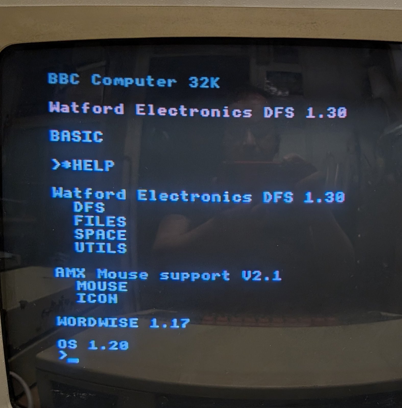

As reported, it did indeed have a DFS ROM installed, along with a word processor and software to go with a mouse - which sadly I don't have, rendering that ROM pretty useless.

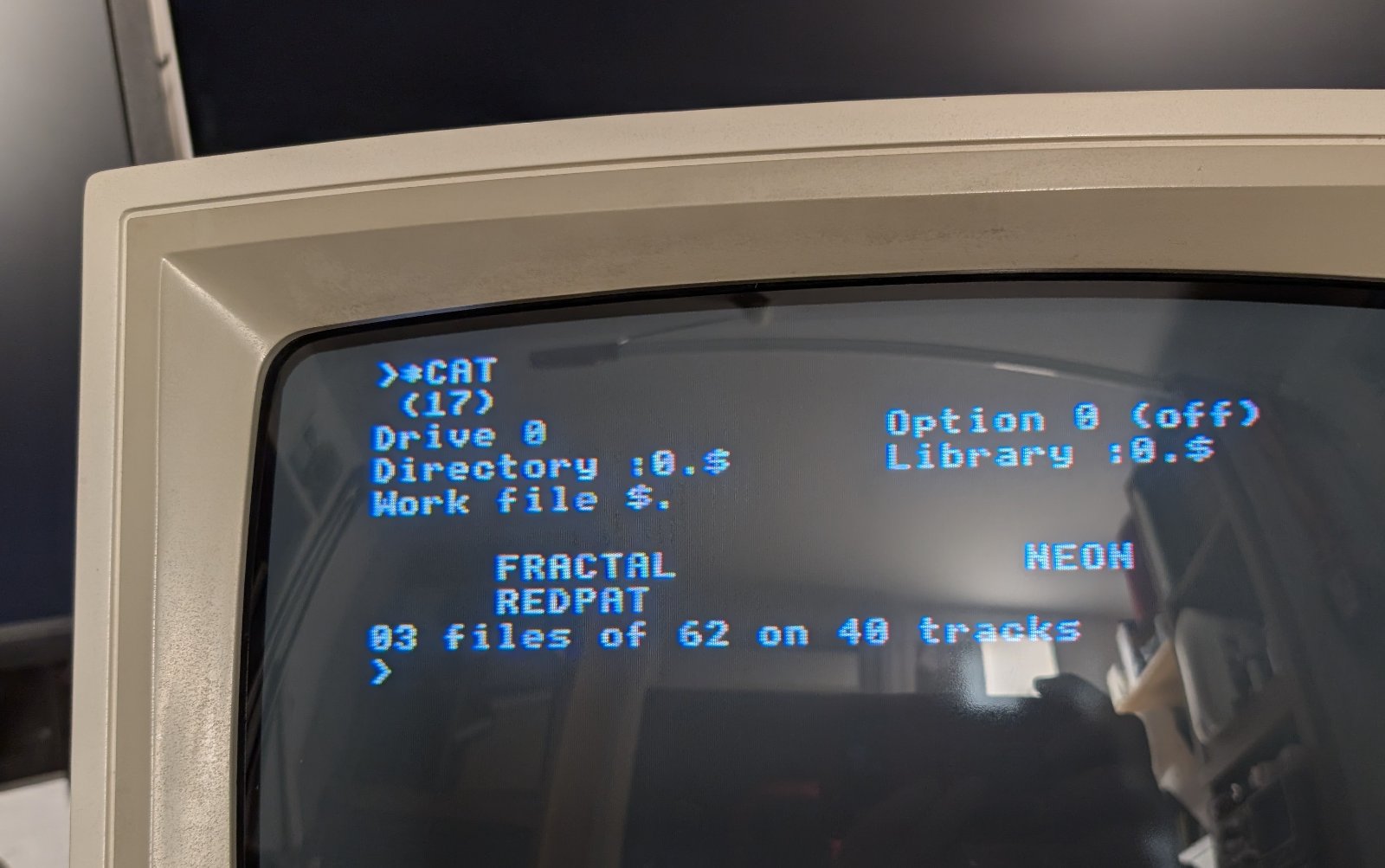

As predicted, the disk drive just needed a very quick clean but was then happy to read/write disks just fine.
I bashed in a few BASIC programs and it was happy to both save and retrieve them without any issues.
Nice to find that it's a universal drive as well so can handle both 40 and 80 track disks, not a given at this age.

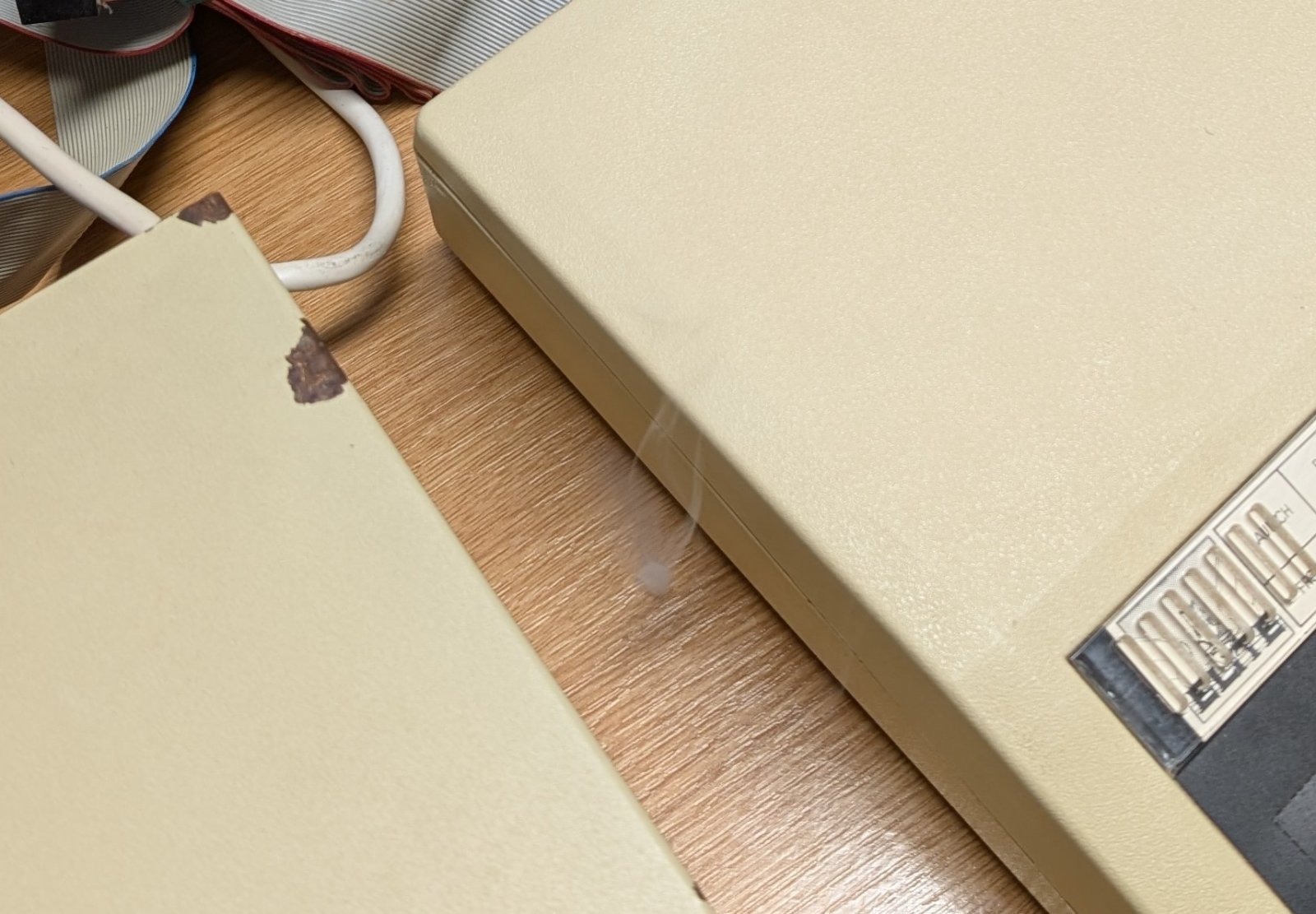

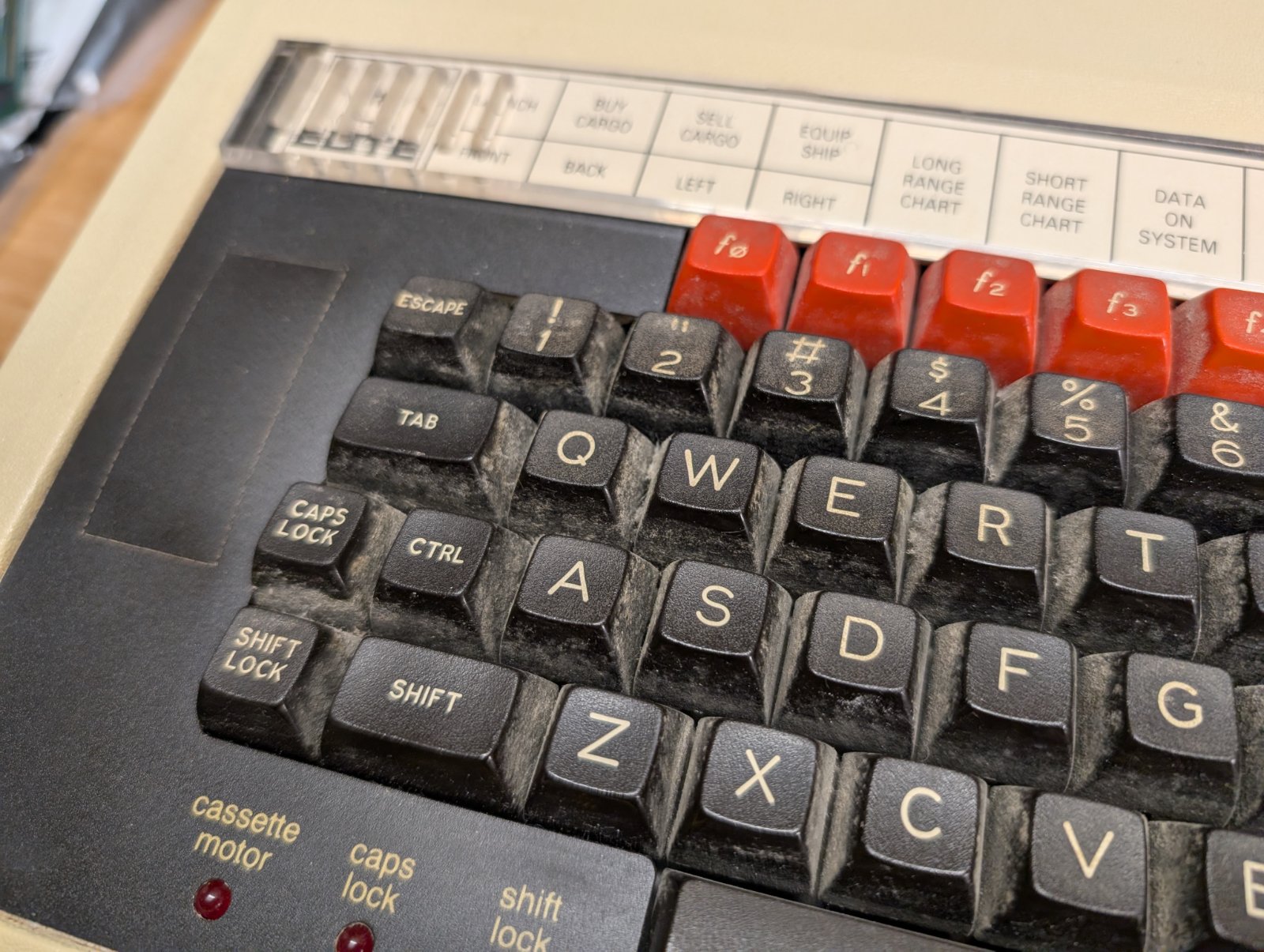

The machine as a whole though was filthy.

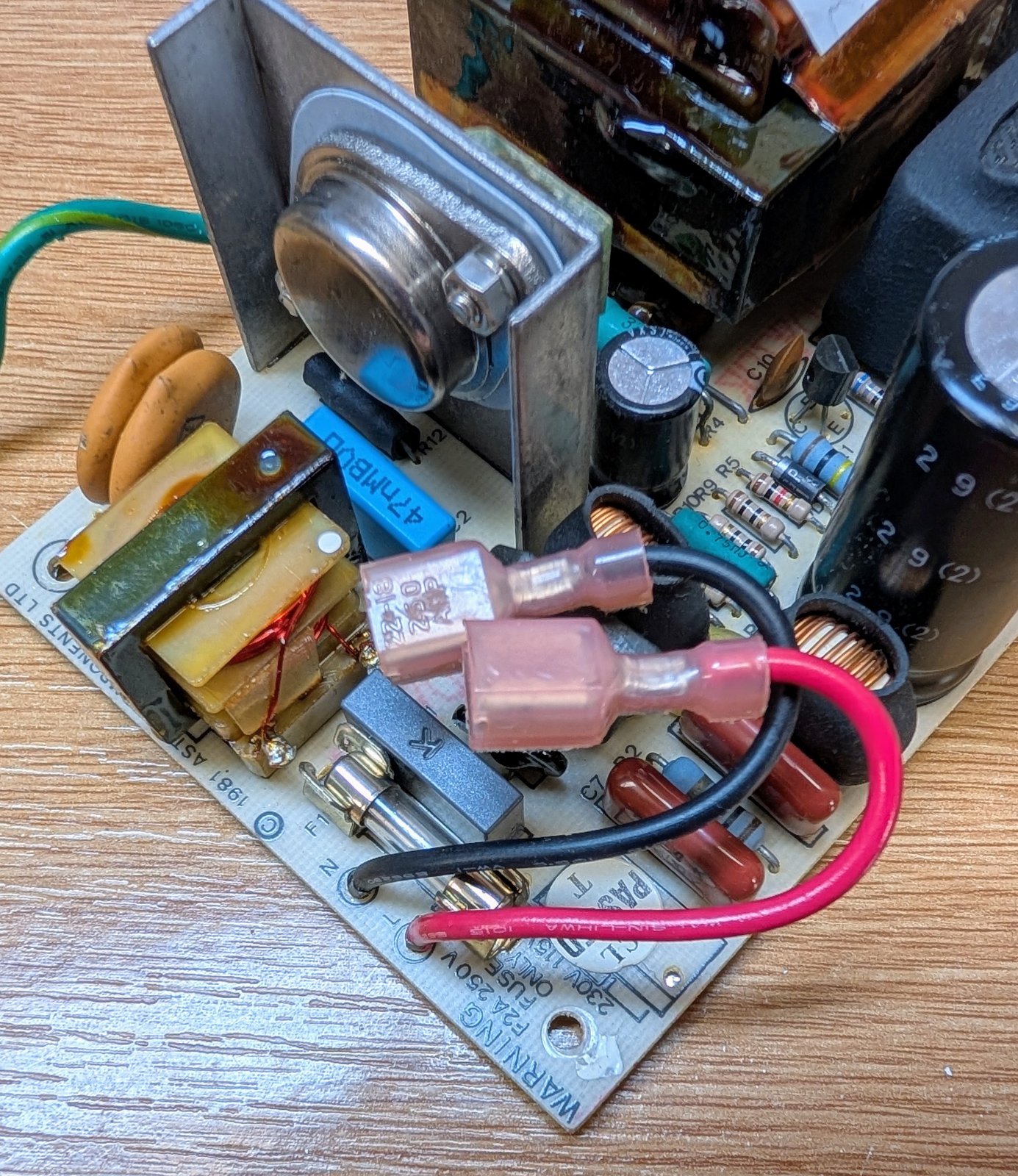

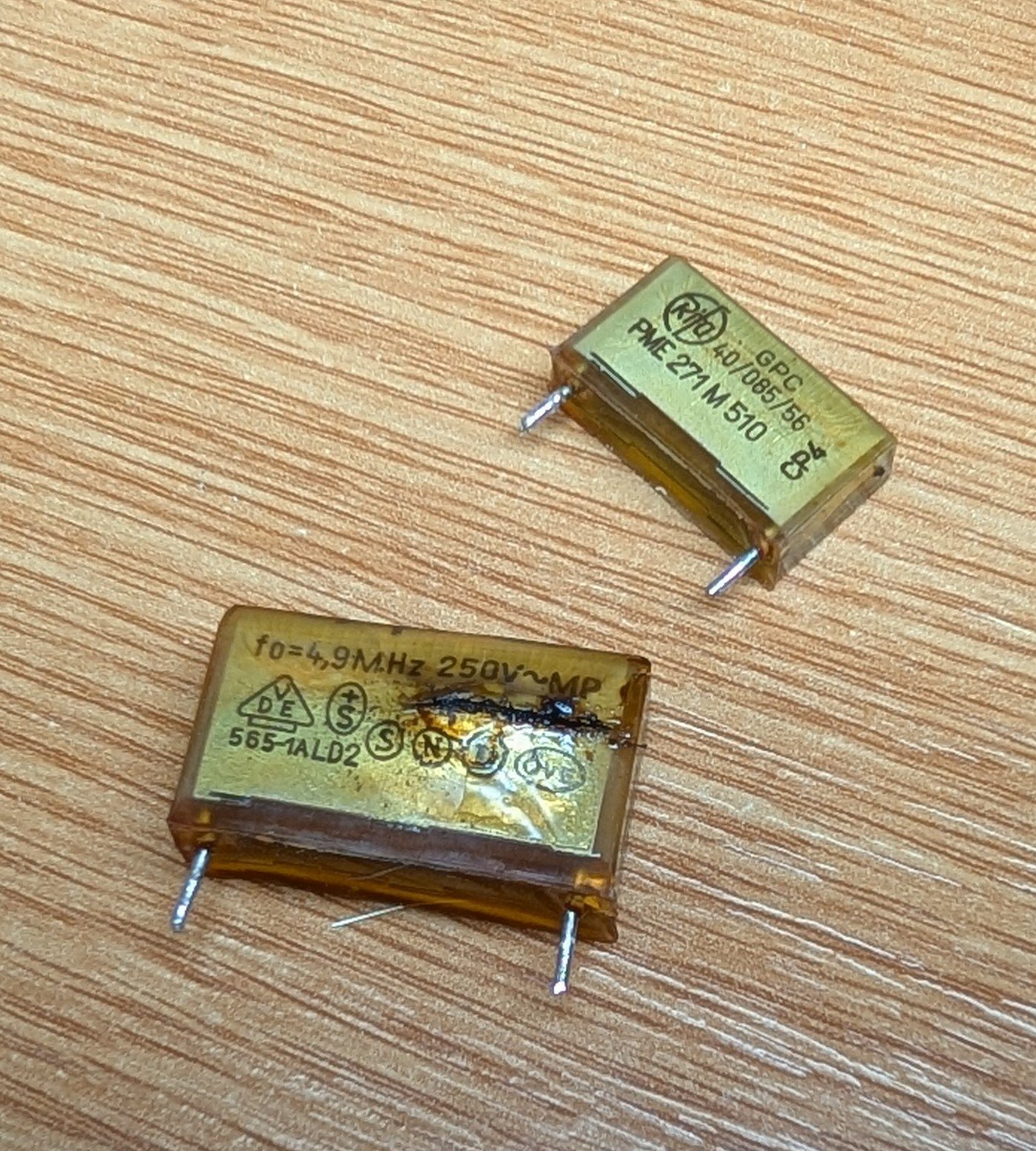

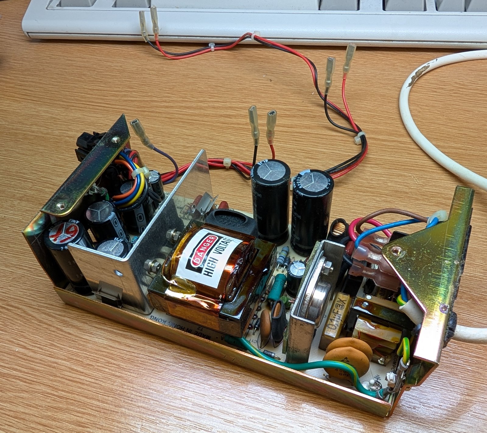

It also then went pop as my gamble with the pair of Rifa caps in the power supply failed and smoke started gently wafting out of it.
Better than the last one though, that was on a little portable Sharp PC and was like someone chucking a smoke grenade in through the door. I also managed to get to the smoke detector this time before the smoke did. The power supplies on the early (Issue 1 and 2 I believe) machines don't contain any Rifas. They however have their own reliability issues mainly because being rated at only 35W they were being run pretty hard. The later ones are 50W units and are far more reliable aside from having two Rifas lurking.

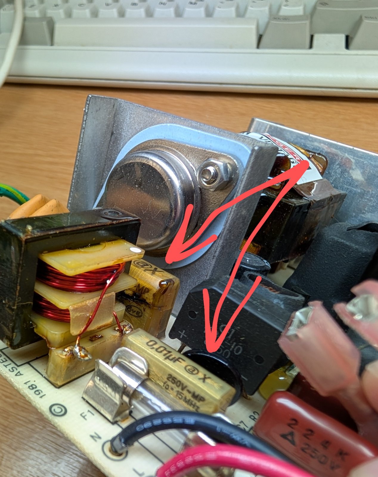

I do appreciate how service friendly these machines are. Less than ten minutes had the power supply out and on the bench ready for repair.
Our targets:
Another ten minutes saw those replaced. No second guessing where the smoke came from this time.
Two new X2 rated caps were soldered in and that was declared done.
One is a bit smaller than the original, but the exact capacitance isn't really critical here.

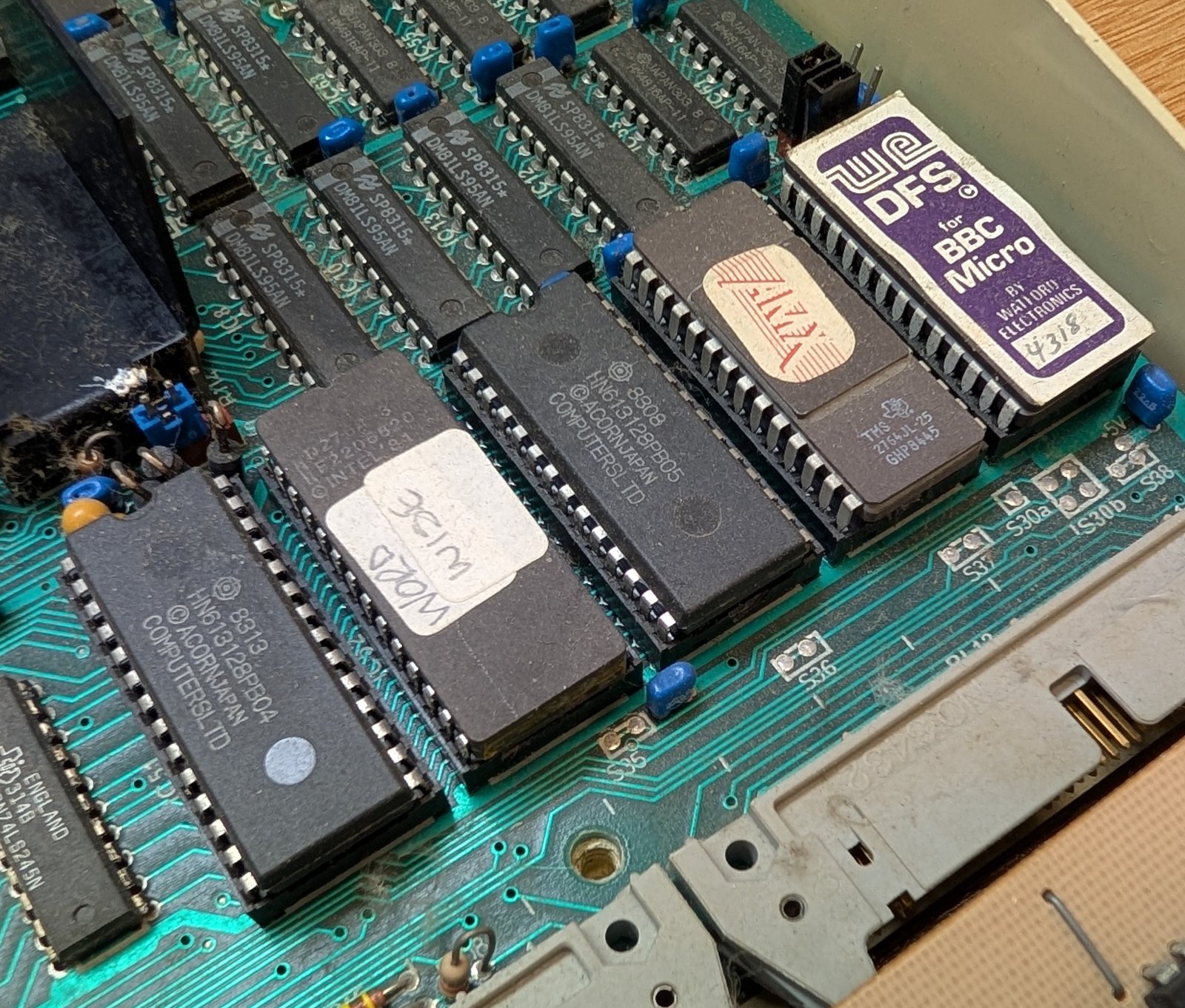

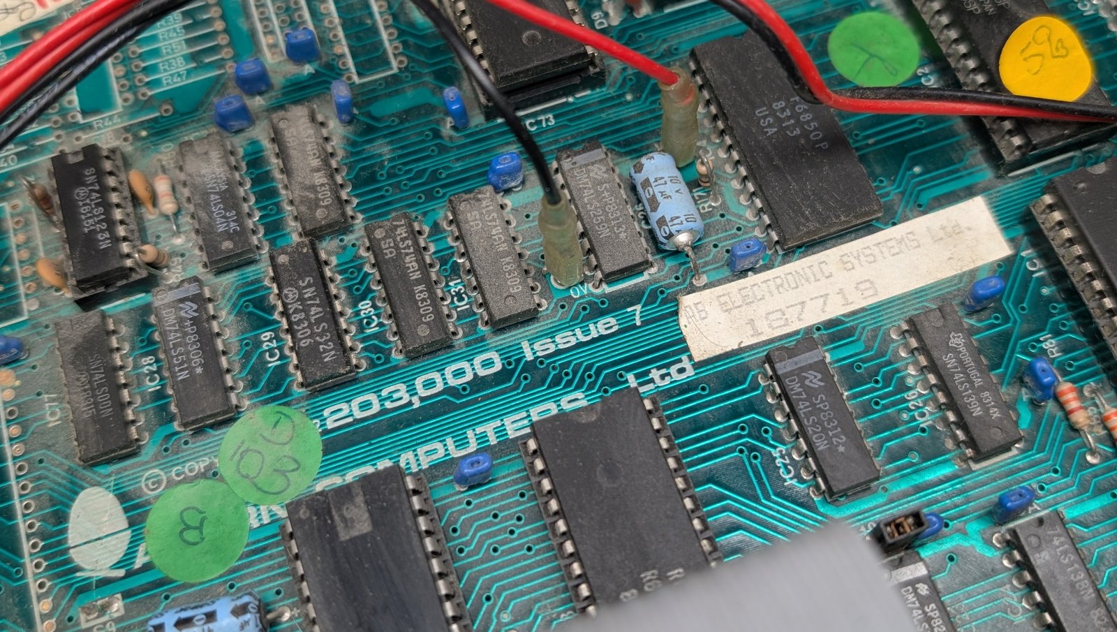

While I had the covers off I confirmed my suspicion that this was a later machine than my other one - that being an Issue 2 motherboard, this is an issue 7.
Also a look at the ROMs - I'm sure that's an *absolutely* legitimate copy of Word Wise...
The AMX one relates to mouse hardware that I don't have. So I'll likely remove that and replace it with the SD card adapter I have which will allow me to essentially have the entire software library for the machine on hand.

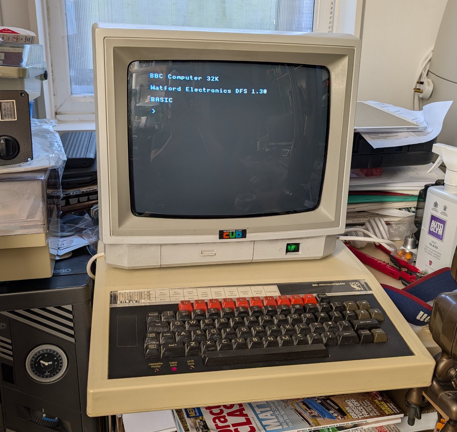

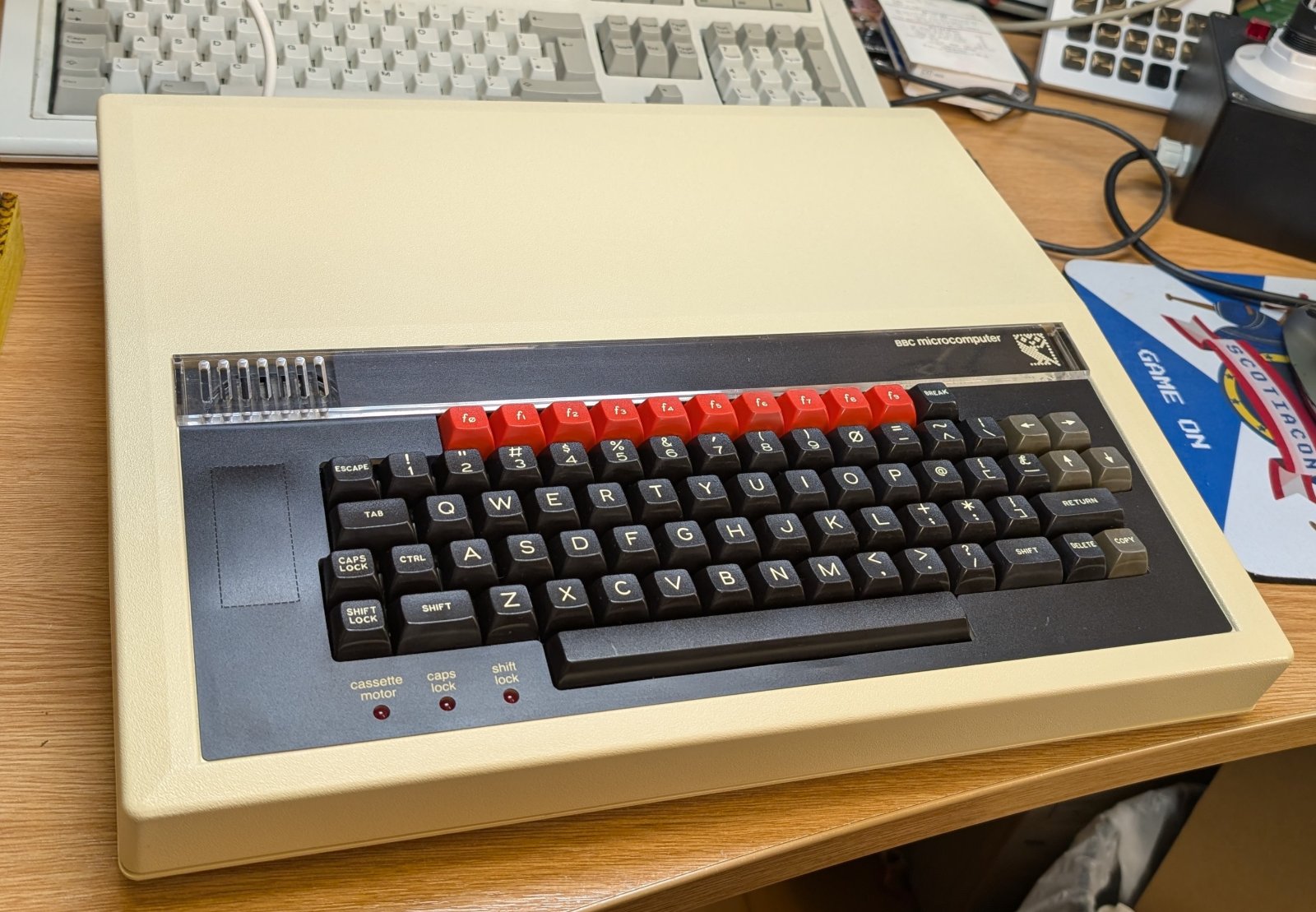

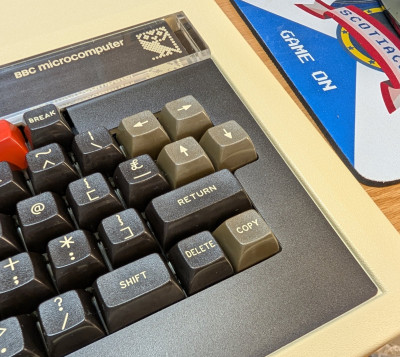

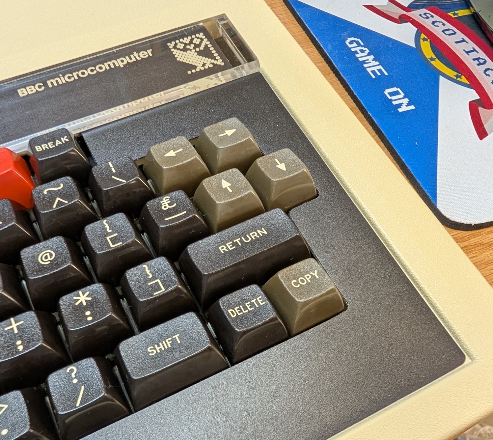

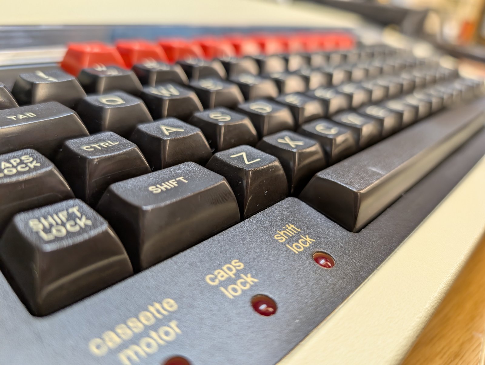

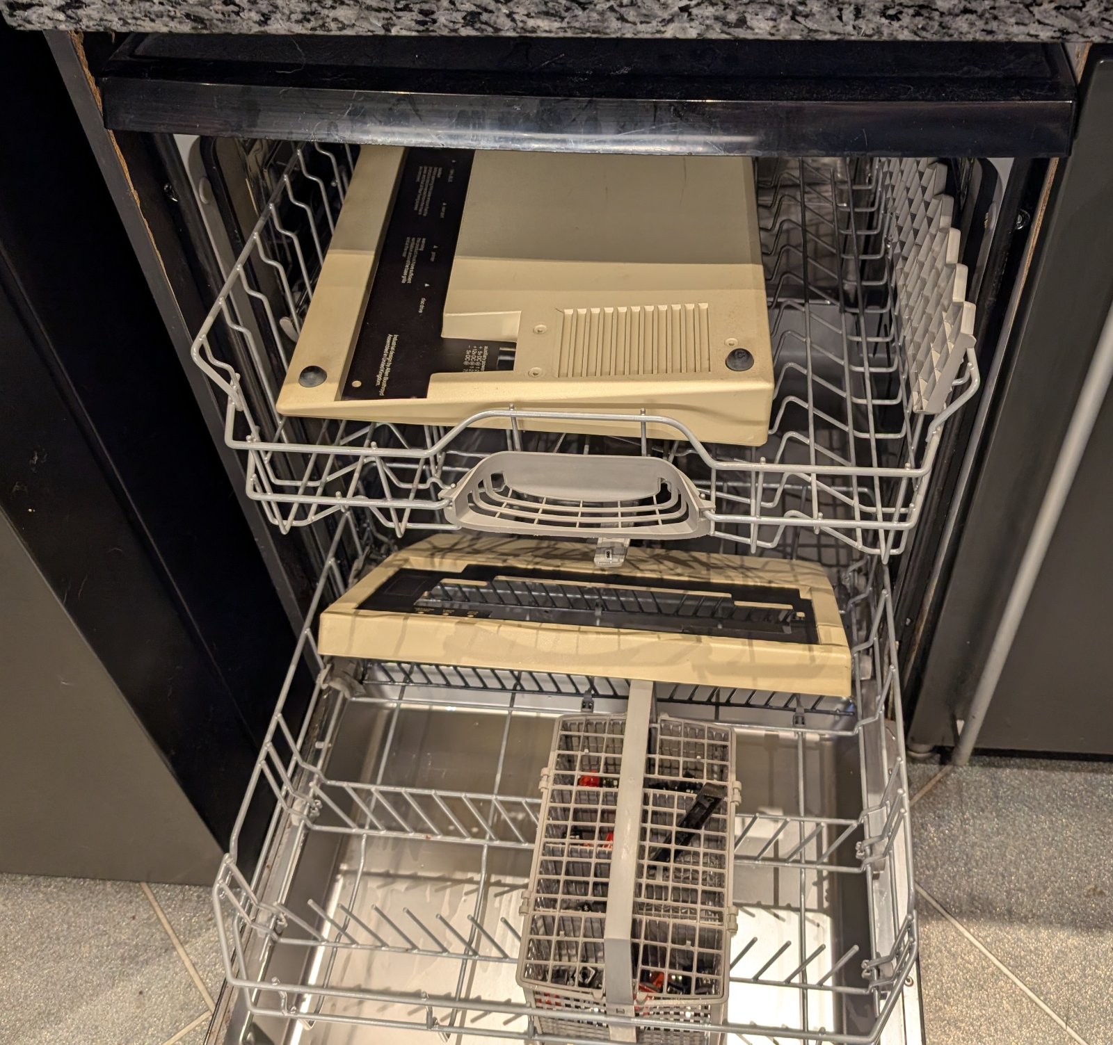

Equally important in my mind as fixing the power issues though was giving it a clean.

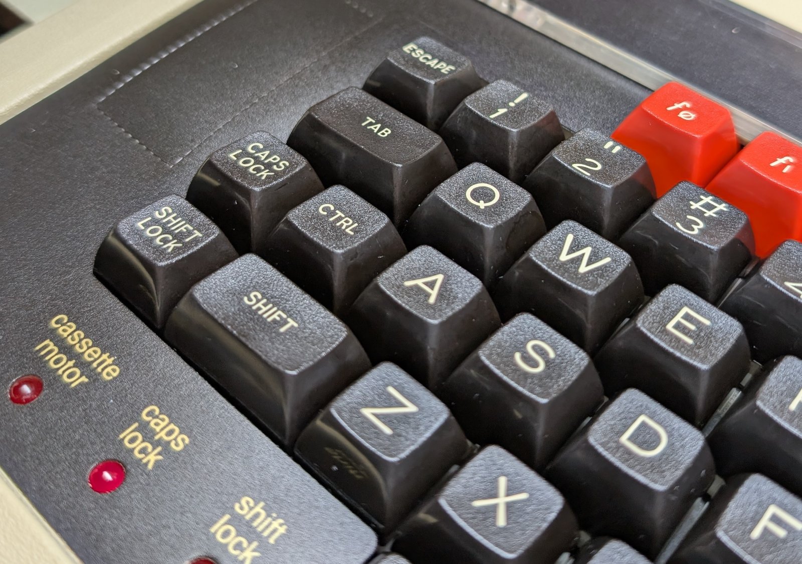

I don't like to use the "cleaned up like new" phrase too often, but on this occasion I think it is accurate.
Given the complete lack of wear on the keyboard and how well this has cleaned up I reckon that this must be a very "low mileage" machine to use an automotive term. The monitor will similarly need to come apart for a deep clean, but equally appears to still be in its prime given how bright and vibrant it is.

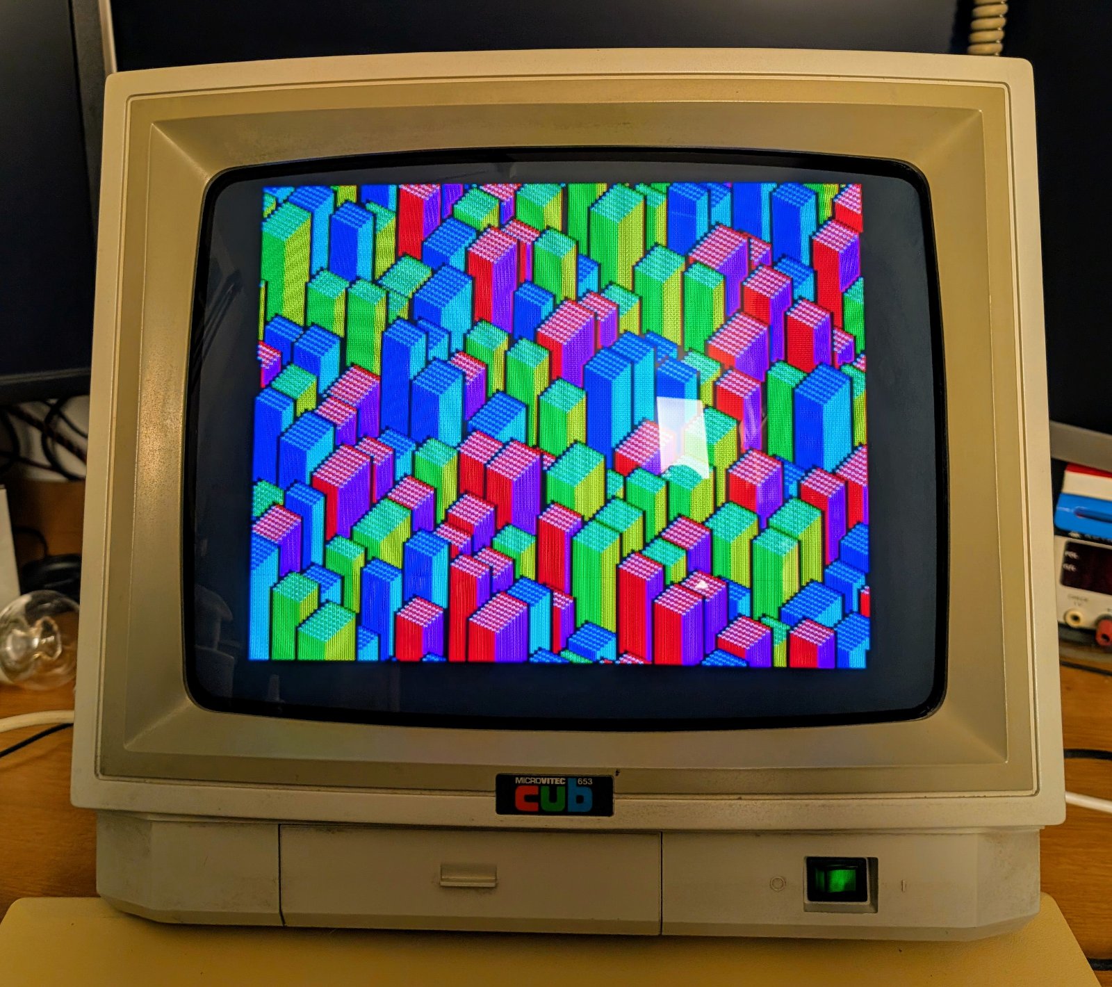

It's really easy to forget how good the image on a good CRT could be.
All in all very happy with this one and will enjoy getting to have a play around with it in due course. I was surprised given how long it is since I used one of these machines with any real regularity (28 years ago) how much my brain and muscle memory still remembered where some of the odder keyboard layout items were - only thing I keep doing is hitting shift lock when going for the left shift key.
Sure I'll get used to that again over time.
Our targets:

Absolutely awesome Zel and that all brings back a few memories
Good ol' RIFAs - they really are time-bombs... or time-smoke-bombs
If ever there was a 'change on sight' capacitor, they're the ones!
That said, I still have two in service, relatively new ones, in my Kenwood Chef.
Amazingly, they're still in production despite their shortcomings...
