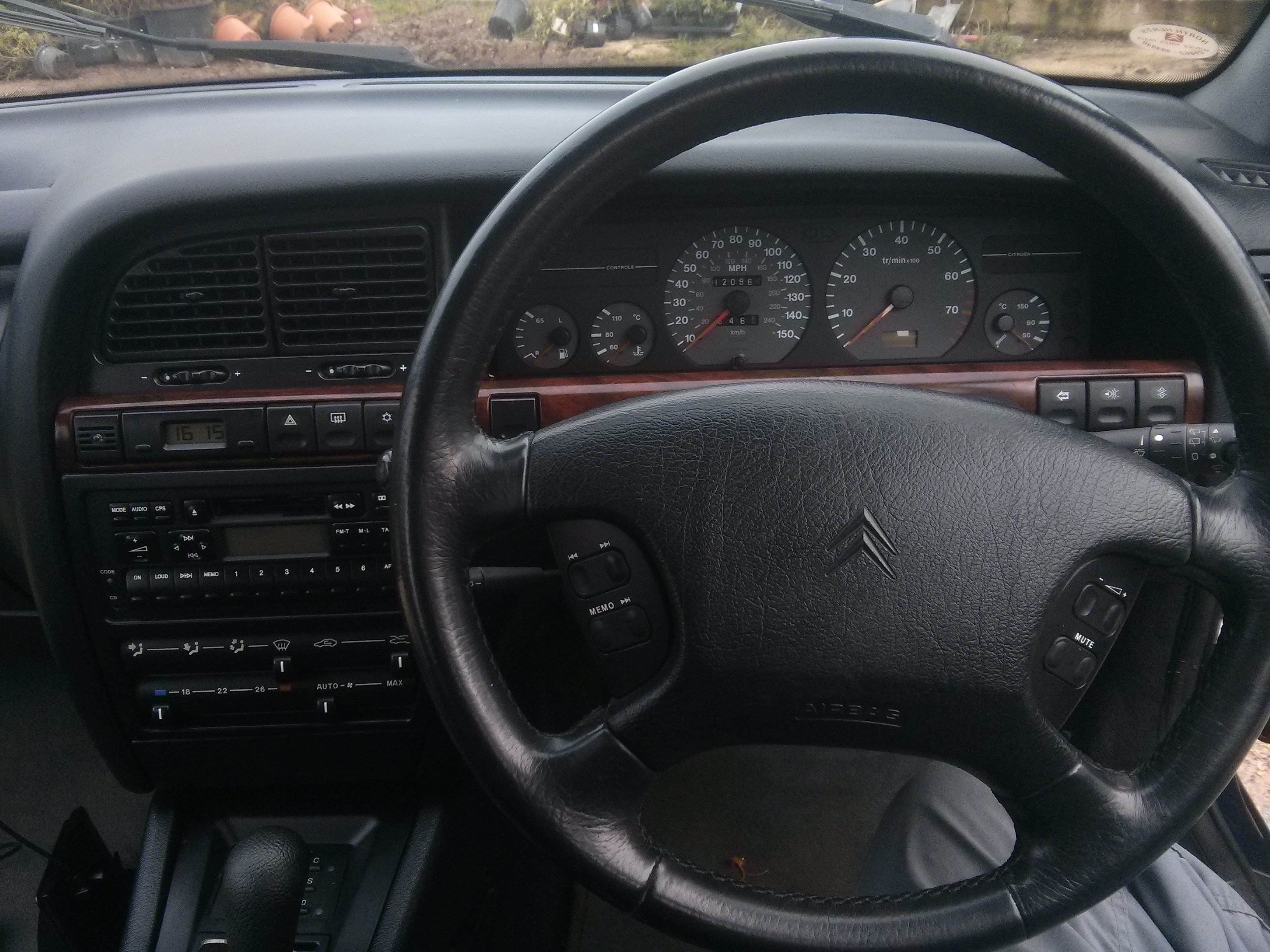

I just discovered the steering wheels on wonky as well it goes 1.5 turns and a bit to the right but only 1.5 turns minus a bit to the left. Annoying as I don't have the tools to remove the steering wheel here and I want to get the tracking done. Must think of a solution that doesn't involve buying a socket and bar that I already own.

You should first correct the steering wheel by adjusting the rack ends until there is equal travel in each direction. If you just move the wheel, you increase the risk of straining the air bag rotary connector (and they are not so easy to find now).

Is there a way of determining if the issue is down to someone putting the steering wheel back in the wrong place or a tracking issue? Everything that has been taken apart in the car near the steering wheel is broken or misassembled. My gut feeling says it's been removed and put back on incorrectly.

Drive along a straight road and mark the top of the steering wheel in the straight ahead position. Then with the car stationary, count the turns lock to lock from the marked position. If they are not equal, then the track ends need adjusting, which with care can be done without disturbing the geometry by moving each side an equal amount. Then remove and refit the steering wheel in the correct alignment.

Ok, thanks Mike. I'll mark the straight ahead position, which is noticeably to the right, and book the tracking.

To have the steering working to specification, the front wheels must be centred on the steering rack and the steering wheel must also be centred on the middle of the steering rack travel. It is possible (for correct position of the steering wheel) to compensate for misalignment of the steering arms by moving the steering wheel and vice versa.
BUT the air bag connector has only a limited angular travel before the tape inside binds up, and eventually fails. To protect the airbag connector it is vital that the steering wheel is centred on the middle of the rack travel, misalignment of the steering rods does not endanger the airbag connector. So it is important that the steering wheel is not moved on its splines if it was already in the right place. The right place for the steering wheel is where the lock to lock turns are equal from the steering wheel vertical position (which may not be straight ahead for the wheels).
I have met at least one wheel alignment operator who did not understand this.

So on my car the steering wheel travels more to the right than the left from the central position. Does this mean I do the tracking first as you recommended then assess the steering wheel again or does it mean that the steering wheel is on a spline out and should be adjusted to the left by one spline first?
If thats not clear the steering wheel is noticeably to the right when driving straight ahead but turns equally right and left from there although ends up in differing positions at full lock on either side.
