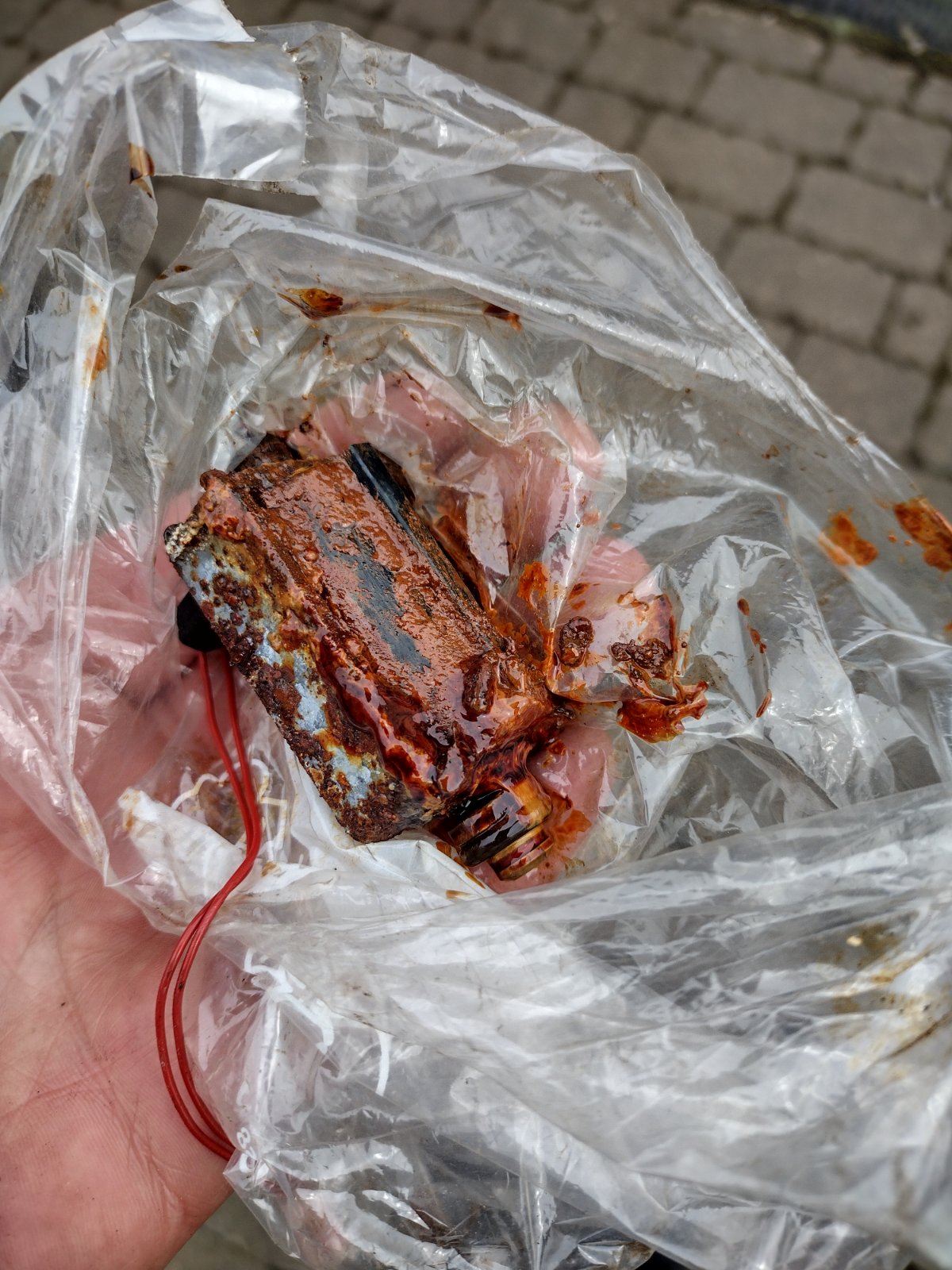

Eldest's driving test tomorrow, planning to use the 3008. We were down at Kendal at the weekend practicing (booked a test there as there was one available and my Parents live there, compared to Scotland where there none AT ALL available in the 6 month window when I checked - and that included out of the way places like Lewis, Orkney and Shetland!) and it was fine. Then Sunday went out, and Bing! Engine fault as soon as I set off. Hmm. Not allowed EML on for driving test.... Scanned it and had fault for DPF end of life, but also temp faults for the additive pump. Cleared them, reset the DPF, took it for a good thrash, and all OK. Monday morning, family set off to Glasgow in it; bing! Engine fault, and also limp mode. Damn! Bit of a read around and decided that pump was almost certainly goosed. Got a new one ordered up, and got the tank off Mon eve (only broke 2 out of 4 bolts, not bad :lol: ) found it completely empty, so guess that has cooked the pump. PITA to get out out as there is not enough room to slide it off the clip as the chassis rail is in the way. Thanks, PSA! New tank arrived yesterday (a Chinese copy.... :shock: ) got it filled and fitted - you can get it in if you drop the corner of the fuel tank, but there are also 2 push pins holding it in which are recessed and under the exhaust heat shield, and a complete git to get back in - had to file a bit off the tank to get it to line up properly. And then substitute some cable ties for the broken bolts :twisted: Back on Diagbox for the replacement and fill procedure which seemed easy - some vids show a prolonged period of pump operation to prime it, but it didn't seem to want that. Started up and no lights, filled up with diesel and took it for 15 mile drive (D test practice....!) and still no lights, so cautiously optimistic I have fixed it. Phew!

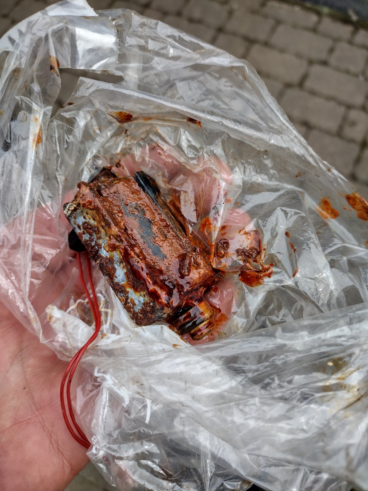

I took the end cover off the additive tank and pulled the pump out. Safe to say it was past its best and the diagnosis was correct 🤣
Looks like water has got in past the end seal and rotted the pump out as it sits at the bottom - in the puddle!

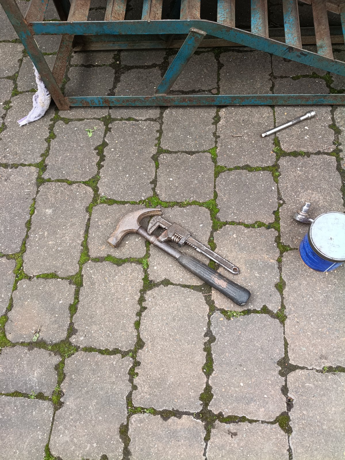

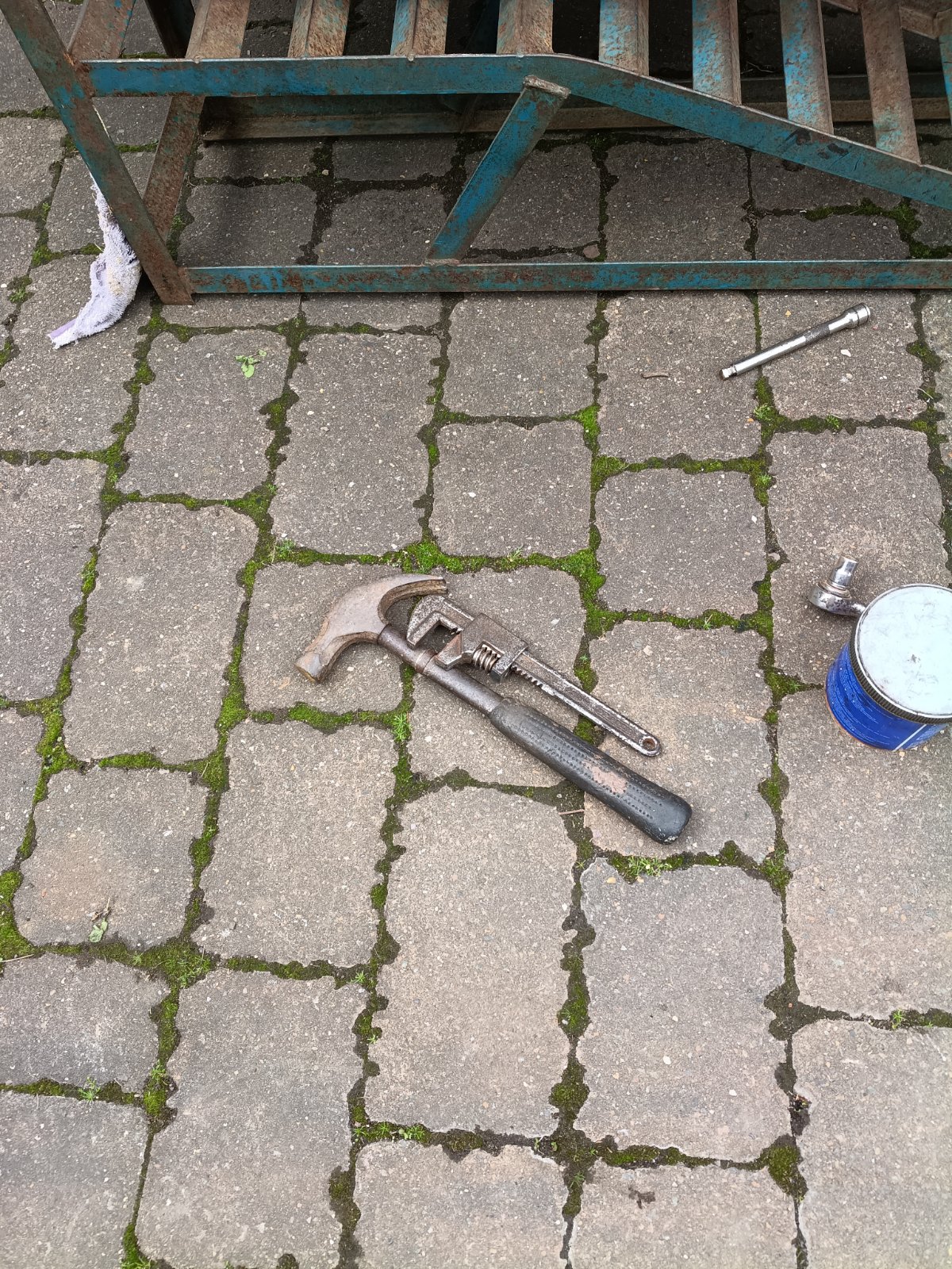

Today I was impressed again at just how competent these adjustables are
I've (ab)used this on the wheel bearing tool before with a 4ft pipe on it without slippage, today was a bit more tame! The Picasso has been throwing ad blue faults recently - it comes up with a non specific Comms fault, but internet suggests it's probably the NOX sensor. These are notoriously difficult to remove, but thought I would have a go just to see if on the off chance it might come out. Not just by pulling on the spanner, but a few 'light' taps with the hammer and it came loose. Not even a mark on the hex! It went a bit tight after a few flats, but back and forth suggests it's going to come out without pulling the thread :) Also got the 2 bolts out the bracket so good to go for a replacement.

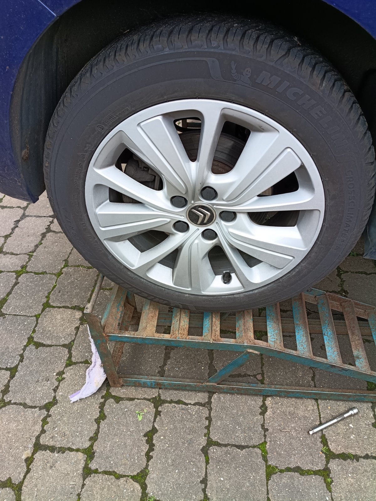

Then back to the front, up on the stands and fitted new pads and discs and changed the oil. Here we are going back on its wheels
Pads and discs were well spent, but they have been on for >60k so can't complain. Looks like we are not far off needing new bottom arms, and it also needs a new CV joint somewhere. Clip was off the NS one again, fitted another one, but I suspect it will ping off, and it will have to have a new stretchy boot to keep it on.
