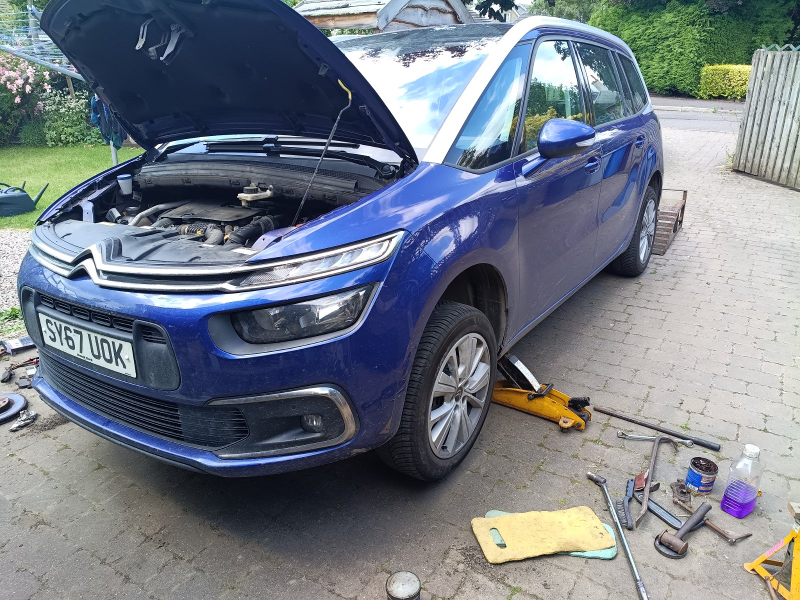

Today I was impressed again at just how competent these adjustables are I've (ab)used this on the wheel bearing tool before with a 4ft pipe on it without slippage, today was a bit more tame! The Picasso has been throwing ad blue faults recently - it comes up with a non specific Comms fault, but internet suggests it's probably the NOX sensor. These are notoriously difficult to remove, but thought I would have a go just to see if on the off chance it might come out. Not just by pulling on the spanner, but a few 'light' taps with the hammer and it came loose. Not even a mark on the hex! It went a bit tight after a few flats, but back and forth suggests it's going to come out without pulling the thread
Also got the 2 bolts out the bracket so good to go for a replacement.

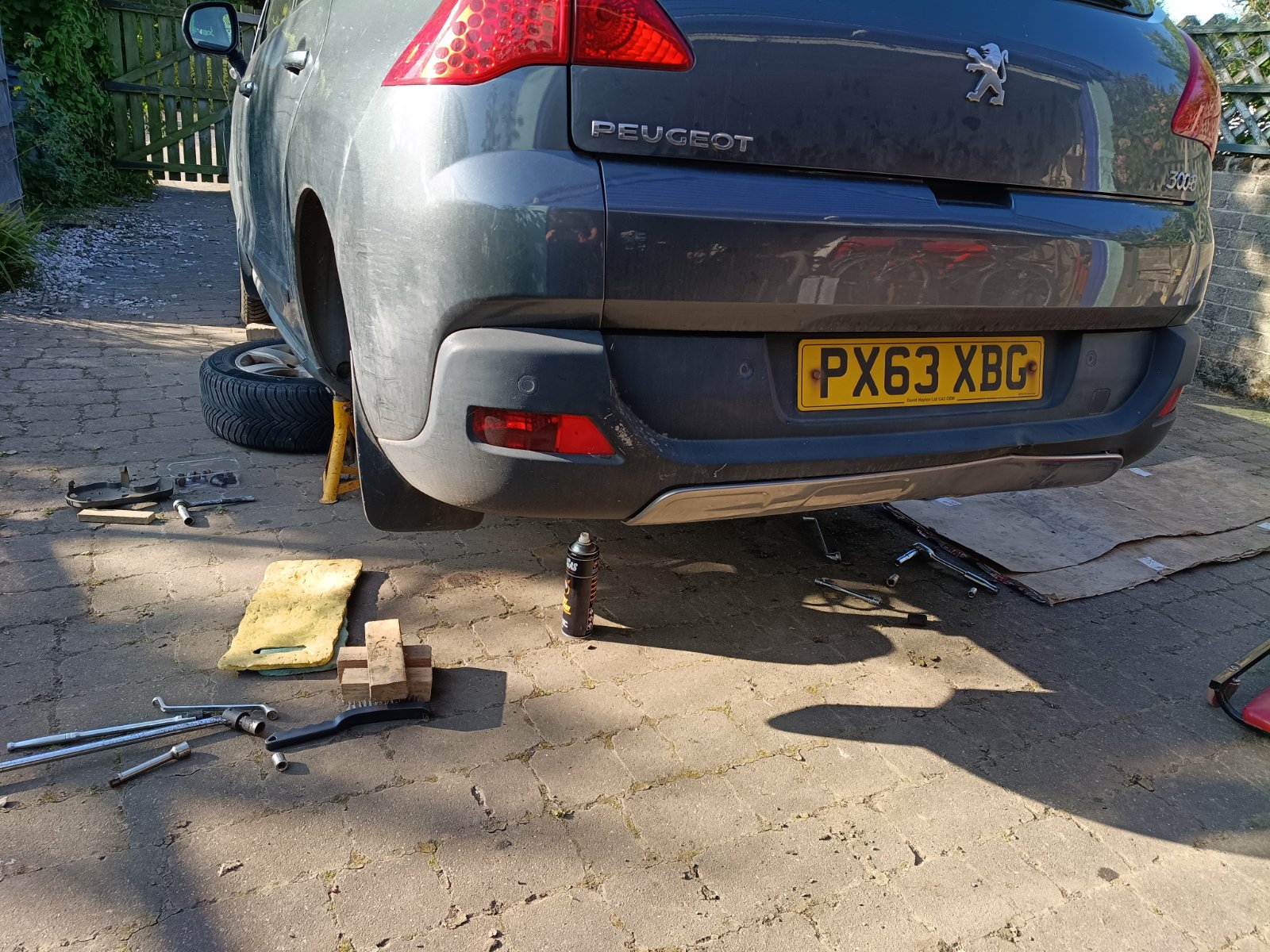

3008 has broken a rear spring - heard it go when we got in it last weekend (400 miles from home...) didn't seem to be an issue, and couldn't see anything on a quick look, so drove home anyway. Loaded it up today and it was complaining - a better look shows it's def gone at the bottom.

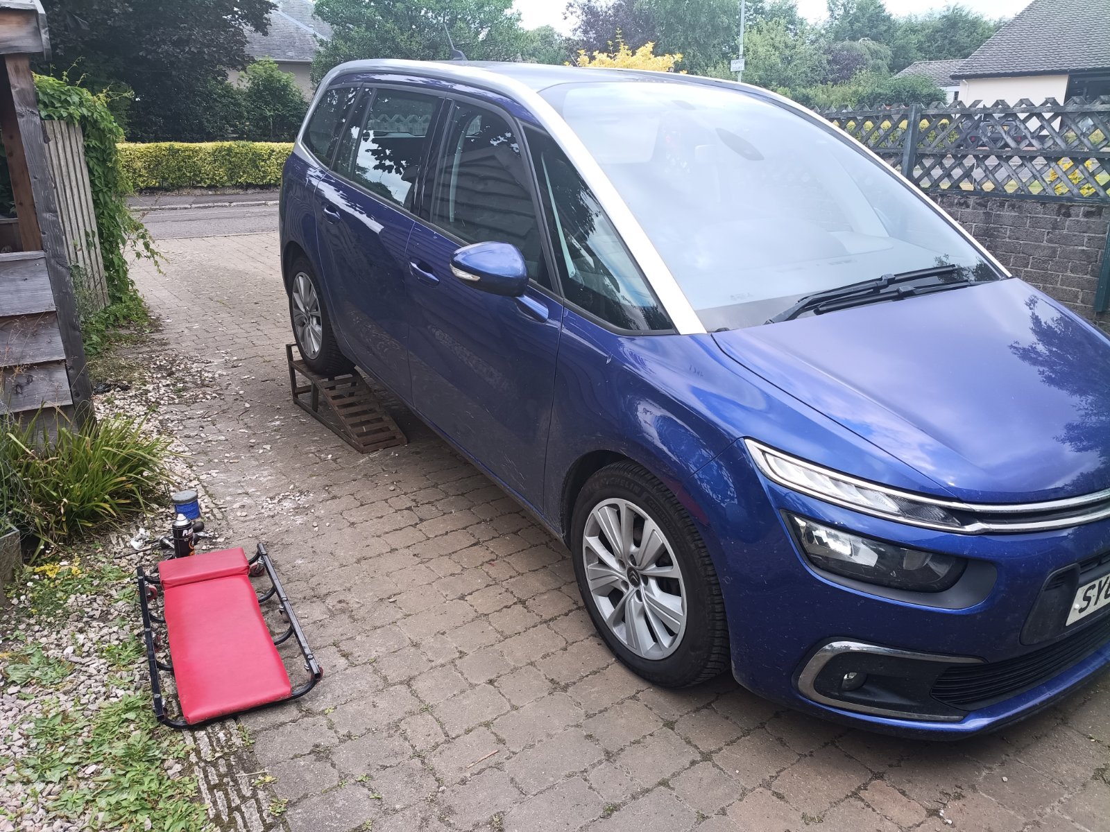

Up and down a lot today!
Front up on the ramps to get the undertray off for oil change and to get the stands under for front brake change.
Then rear in the air and fitted the new NOX sensor
Then back to the front, up on the stands and fitted new pads and discs and changed the oil. Here we are going back on its wheels
Pads and discs were well spent, but they have been on for >60k so can't complain. Looks like we are not far off needing new bottom arms, and it also needs a new CV joint somewhere. Clip was off the NS one again, fitted another one, but I suspect it will ping off, and it will have to have a new stretchy boot to keep it on.
Then back on the ramps to refit the undertray!
Dizzy....
Still got to change the air, diesel and pollen filters.
Next weekend rinse and repeat with the 3008 - front up for tray off and oil change. Then back up to do the rear springs.

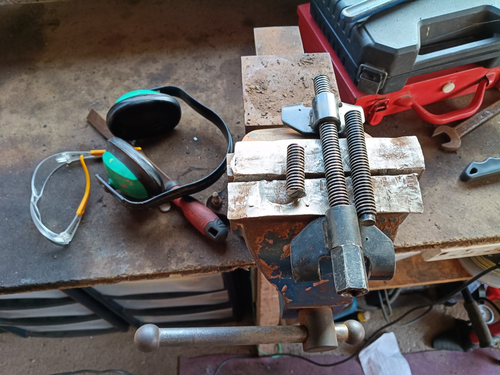

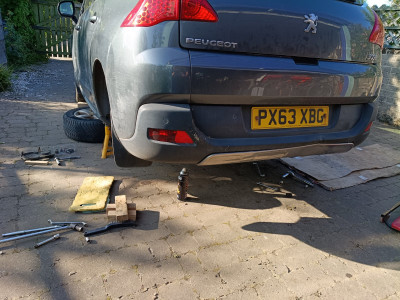

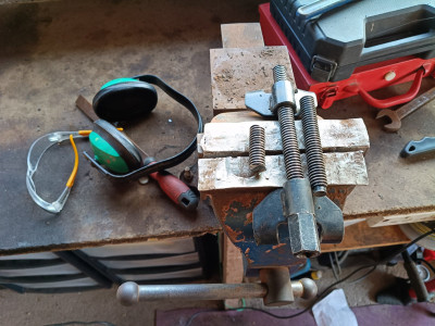

Rear springs. Not as easy as most vids suggest, with both dampers undone the springs were still tight and there was limited movement in the trailing arms. Had to get a spring compressor on it in the end. The offside is even more awkward as the fuel filler blocks getting the spring out, and the brake pipe blocks moving the damper out the way. Had to drop the caliper off then got the compressor jammed on the bottom cup. In the end going back decided that I needed to shorten the thread on the compressor. With this done it actually wasn't too bad.

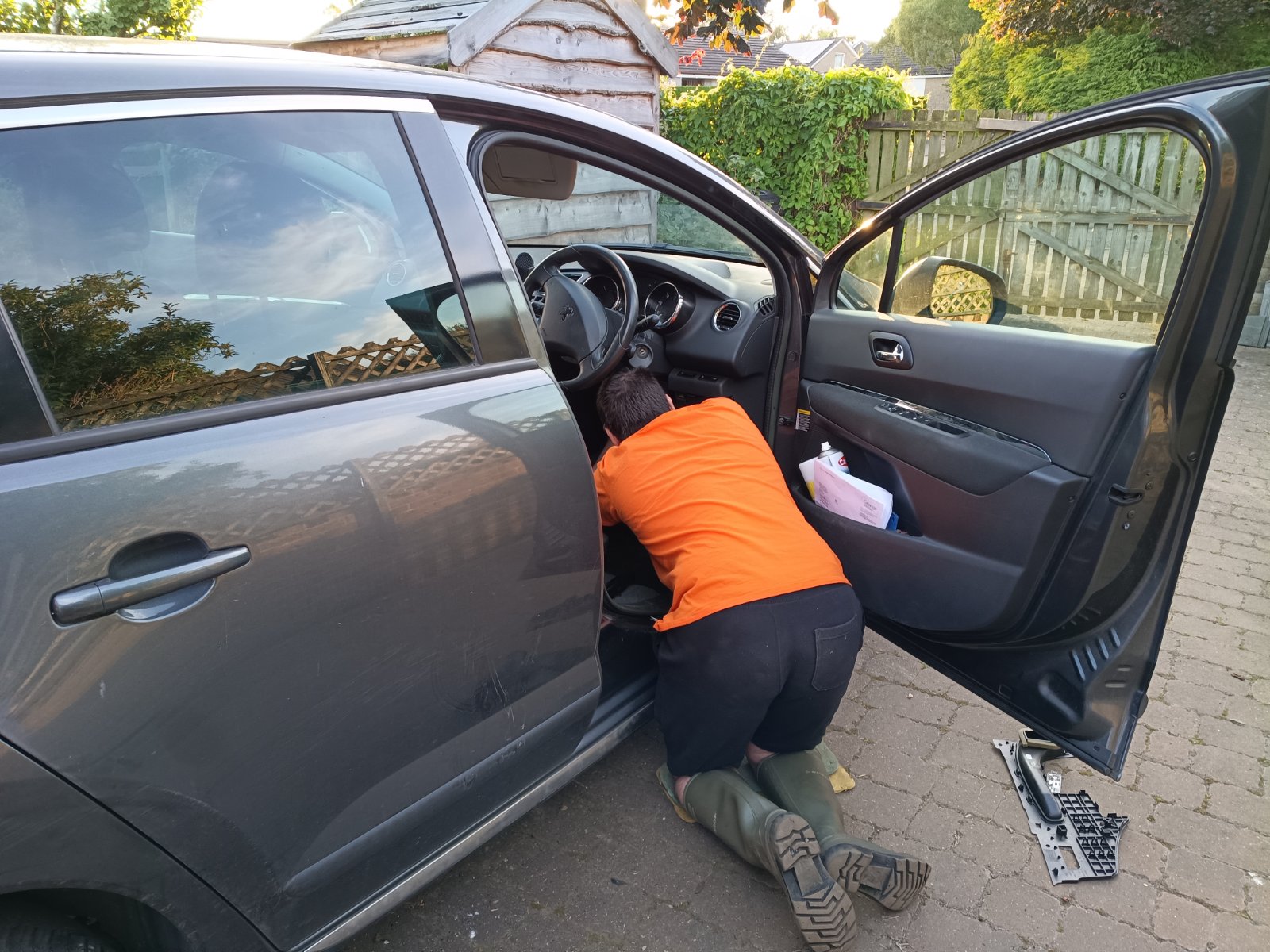

The No 1 son got acquainted with questioning the lineage of French designers whilst helping with the pollen filters

Re: Confessions of a Citroholic
The pollen filter on our 308 is also accessed in the driver's footwell. Whilst awkward, it does allow use of a garden sprayer lance to spray something like Dettol surface cleaner (non bleach) on the evaporator to remove mould and hence the wet dog smell when the air con is used. It is even easier though when the filter is under the bonnet.
