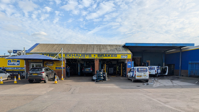

These guys!CitroJim wrote: 09 Oct 2024, 08:12 That truly is good all-round ZelI need to know what company this is
https://thegaragetyres.co.uk/
There are two bits to this business. The tyre/exhaust/brake place out front, and a more in depth garage that's hidden away around the side. I've nothing but praise for the former. The latter is solidly average. No particular complaints really, but it's very much a production line type environment. The tyre guys though are great. Always a good bit of banter, and it's nice to see folks who actually take care when jacking cars up without me even needing to prompt, and actively looking up torque specs for wheel bolts and such. Somehow James there always remembers all the cars I've had in and asks about them.
Plus they always manage to make me feel *welcome* there rather than just being an inconvenience they have to deal with, which is definitely the exception rather than the rule these days.

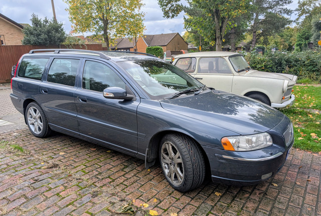

Thanks to their efforts, we've now got four wheels on our wagon again.
Of course I was immediately sent out into properly torrential rain this afternoon. Unsurprisingly these handle surface water rather better than the tyres that came off, especially given they were far more worn on the inner edges than I'd realised.

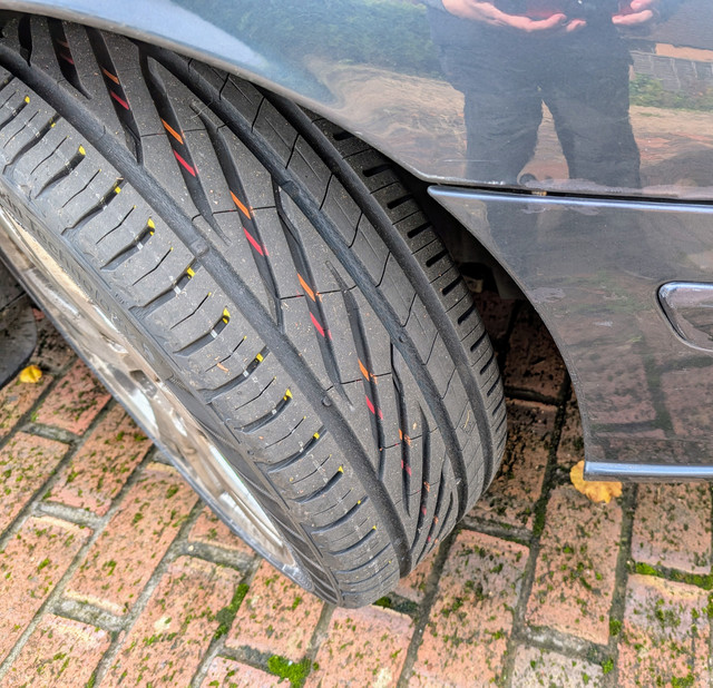

I do sometimes wonder whether the legal wear limit needs to be reconsidered given how wide tyres generally are these days. There's a hell of a lot more tyre to shift water from under on something like this compared to the skinny 140-160 profile stuff that was the norm in the 80s. It also means that it's way easier to end up with a tyre that's damned near through to the cords on one shoulder but technically is still legal given the measurement is over 75% of the tread surface.
I am glad to report that with four new tyres, correct wheel alignment and properly balanced wheels the vibration at speed has been *completely* eliminated. Cruising at motorway speeds is now positively serene. Going to have to be very careful now as there is very little to tell you you're actually going that fast, this is a car which you could end up very easily speeding quite substantially after a tiny squirt of throttle for an overtake on the motorway.

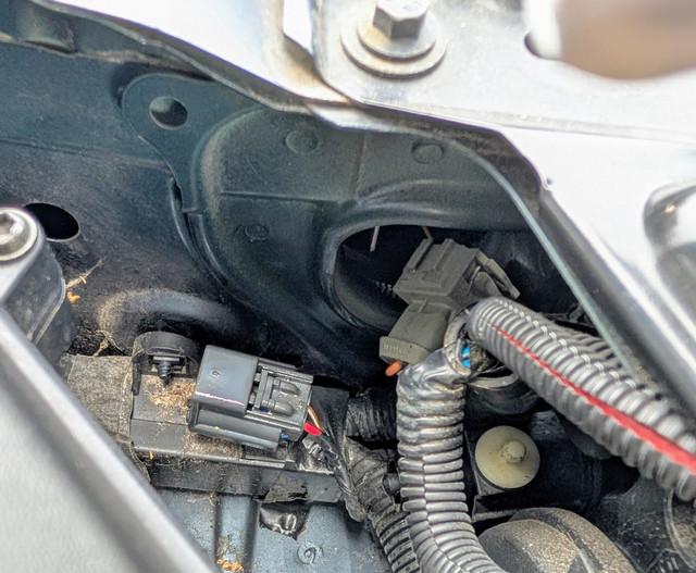

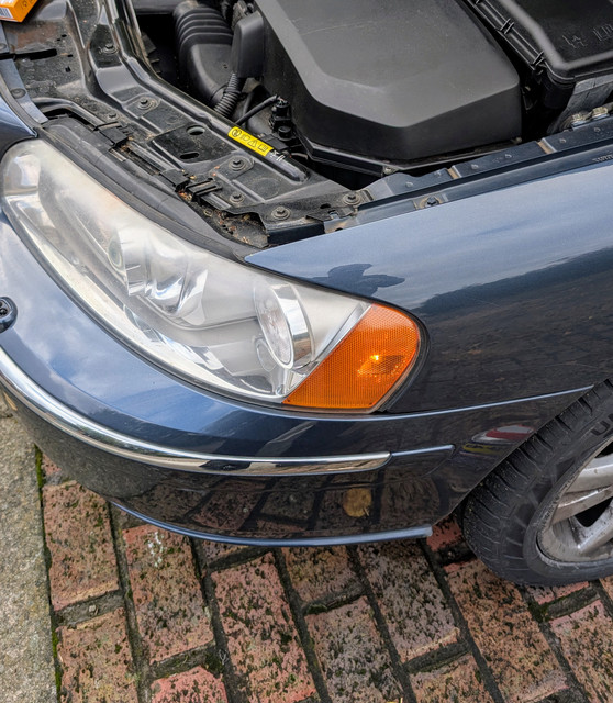

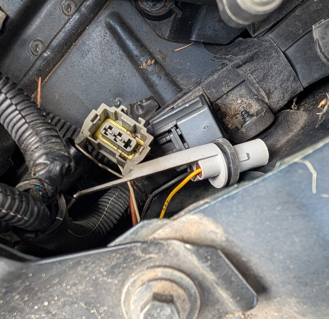

Also dealt with the position light I noticed was out yesterday. No thanks to Halfords where I had an absolute fight to get these.
As I've mentioned before, our store a couple of months ago was "improved" and one of the changes that came with this was basically all consumables aside from oil being moved to be behind the counter. So you have to get someone to go retrieve it for you rather than just picking it up and going to the till. Bulbs, wipers, batteries, filters, they're all back there now. At the best of the time this is an utter pain as it means that the one till that's ever open is having to deal with significantly more workload. Queuing times are at least doubled since the change. It's also a royal pain trying to explain to someone who has zero technical knowledge and zero interest in gaining any to find your slightly oddball bulb for you (the 10W festoon ones for the Trabant tail lights took some getting). I'd hoped this would be a two minute job...but no. The guy wouldn't just go and get the bulbs I asked for - he insisted on taking my reg and looking them up. W5Ws are so obscure aren't they? Then kept completely failing to understand the difference between the daytime running lights and the position lights. After what felt like an eternity of going back and forwards, and a queue of about ten people having built up behind me, I eventually left with the bulbs, my patience however was nowhere to be seen, having utterly evaporated by that point!

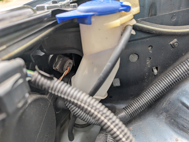

Changing it was actually really simple - thanks to Volvo being sensible.
The holder in question is actually buried deep in the wing, however they put a really long extension on the back of the lamp holder so you can reach it.
It's the vertical white bit of plastic just visible in the void just right of centre frame. Once you've popped off the connector for the indicator it's pretty easy to remove. Here's a photo of it out showing how long that extension piece is.
The only reason for including that bit of extra plastic was to make it easy to change the bulb without having to remove the headlight. Other makers could really take lessons from that.
Driver's side is a bit more fiddly as the washer bottle filler neck is in the way so I used a pair of pliers to grab it instead. Reckon I probably could have managed by hand, it just would have involved more swearing.
I think one screw removed let's you unclip the filler neck, but it was so easy to just grab with the pliers it didn't seem worth messing about with.
I changed both as I figured if one had blown the other probably wasn't far behind. It was very blackened, so I reckon I wasn't far off the mark. Job done on both sides in about 15 minutes.
Shudder to think how long that would have taken on quite a few cars of this age where I'd have ended up having to dismantle half the front of the car.

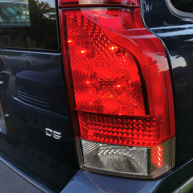

Rear ones we don't need to worry about as they're LED based so shouldn't need any maintenance (or rather will write the whole cluster off when they fail).
To be fair I've never heard of them failing in these clusters, and I do admit that I think that little strip that forms the rear position lights does look smart. I don't think they're even obligatory lights in the UK anyway - they're over and above the actual daytime running lights that Volvo have had since the dawn of time.

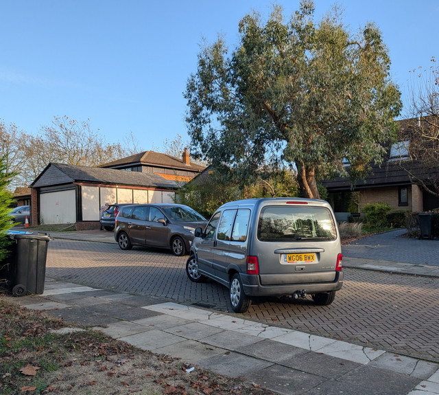

After a surprisingly long period sitting for sale, the Partner went off to a new home yesterday. Just the wrong time of year to be selling a car. It is what it is though, and with me not being able to park it on my property it needed to go.
It's definitely a car I'll miss. Such a useful thing and surprisingly pleasant to drive - though that did surprise me a little less once I discovered how much DNA it actually shares with the Pug 306 under the skin, which was surely one of the best driving cars of the 90s in any of its variants.
If you've been on the fence, considering a Berlingo/Partner and have been wondering if they're really as good all rounders as the hype would have you believe, I'm just going to say a solid yes in my view. Having owned one now I'd confidently say that one will be the only car that 99.9% of drivers will ever need. Despite the boxy looks they've got a chassis which allows them to be more fun on a twisty road than you'd think too. The French seem to be really good at that, making cars which handle far better than you'd think, and also ride comfortably.

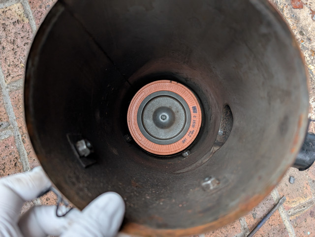

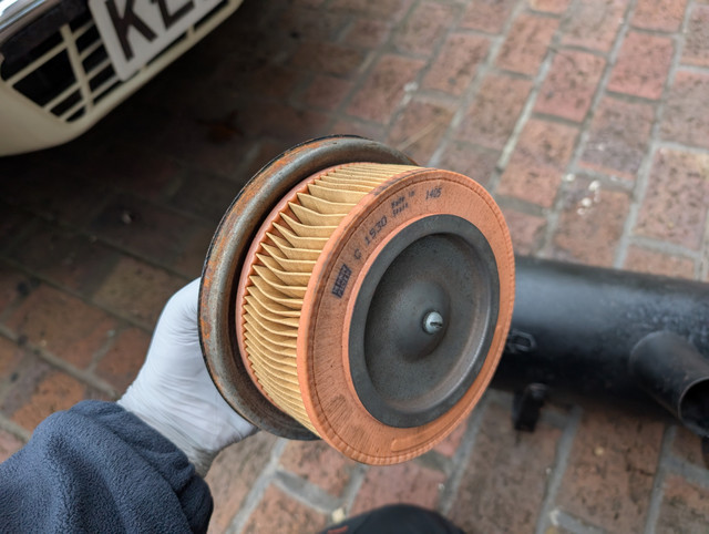

Something I'd never actually checked on this car was the condition of the air filter elements.
Looks like they were changed when most of the work was done to the car, so nothing wrong with those. Not the biggest filters for 3.5 litres of engine to breathe through though (even though there are two) - especially not when you see how little clearance there is inside the filter housing.
There's not enough room around the filters to fit a finger in, so I'm sure this does restrict breathing quite a bit. Rover obvious deemed it to be fine, but it doesn't surprise me that I've seen alternative arrangements in place on a lot of examples people have modified for more grunt. Not that it feels like the car needs any, with the torque available it feels *plenty* perky. I do wonder if the original filter elements might have been more conical in shape which would have clearly helped with breathing?

That air filter looks shocking. And especially after I've been doing a bit of recent study of engine performance tuning...
BL never were very good at engines really... The Rover V8 was OK as they bought it from someone else...
