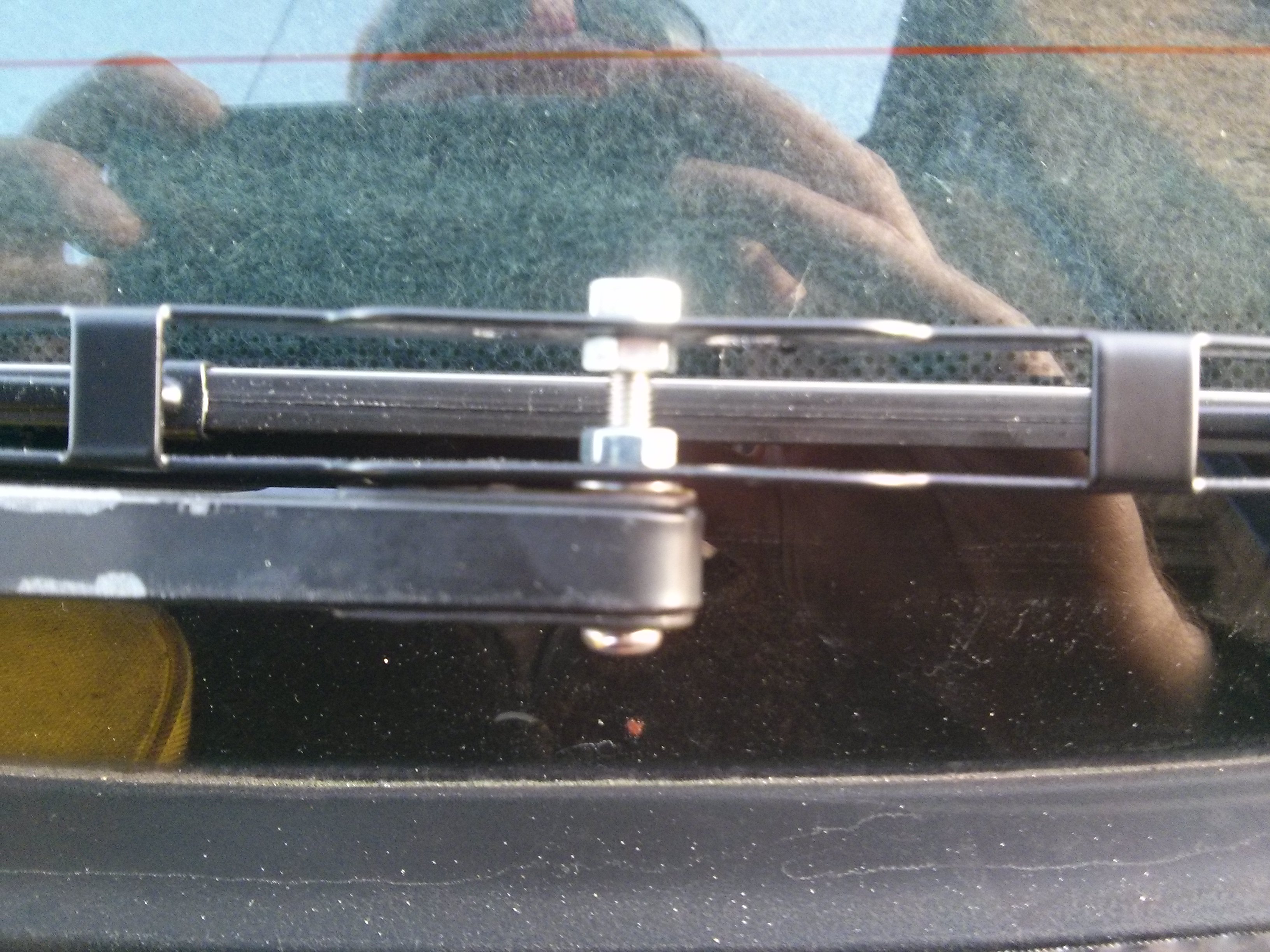

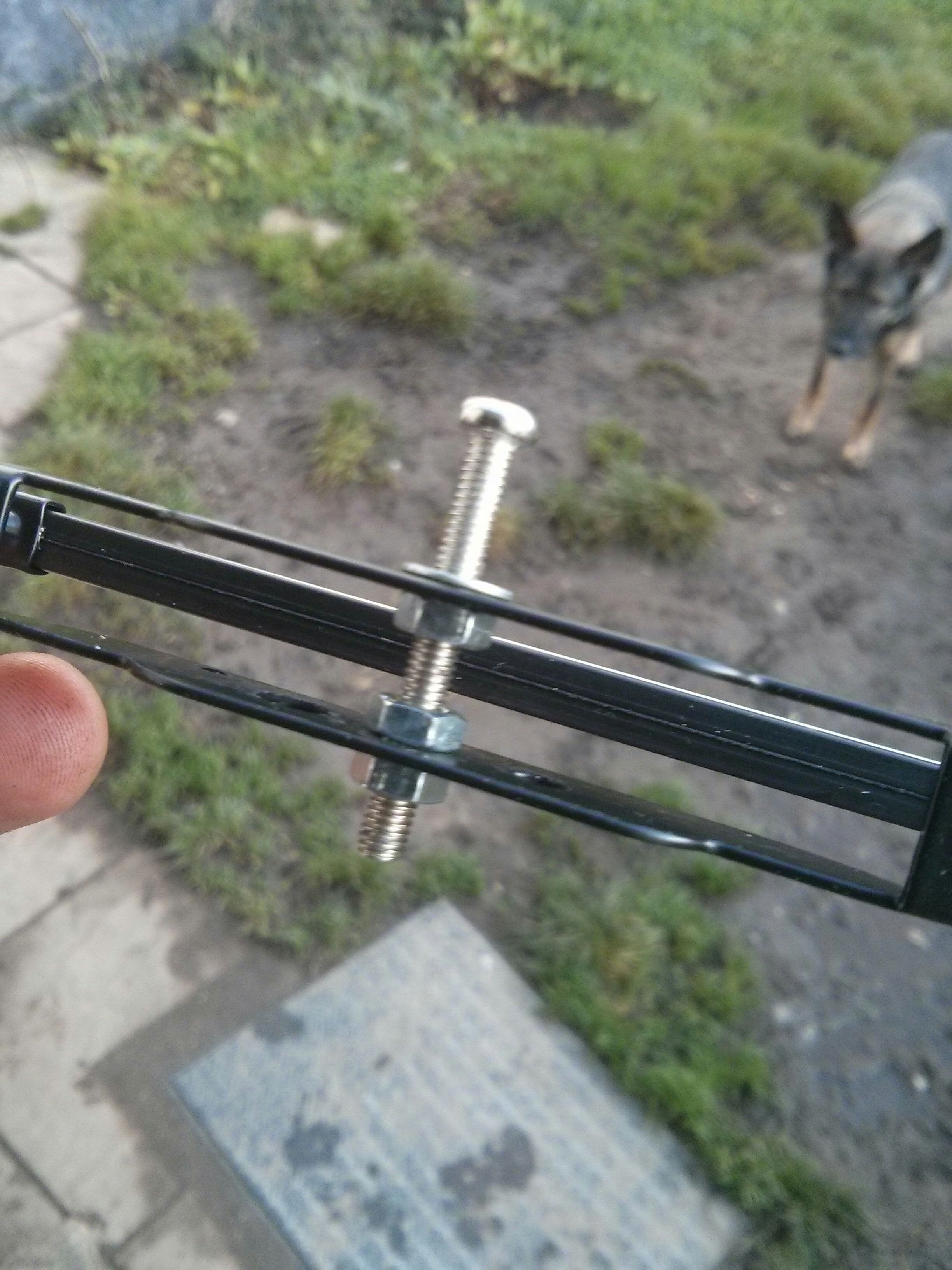

I meant to share this with everyone as well, it's easy to modify a standard wiper to fit the rear of a Xantia and not block the rear washer.
Just need to drill out the rivet and replace with an M3 (I think it was M3) bolt and a few nuts.
Mines started to rust but given that it was successful I'll replace it with a stainless or a blackened one.
One more nut than I used would be better as well but thats all I had in the toolbox at the time.

James, that’s an excellent method of making a rear wiper
I must confess I rebuild mine with new rubbers from any old blade that will donate them...

I was lacking a correct old blade so this method had to suffice. I used a pound shop wiper in case it didn't work but have actually found it to be as good and long lasting as the Bosch ones I put on the front!
