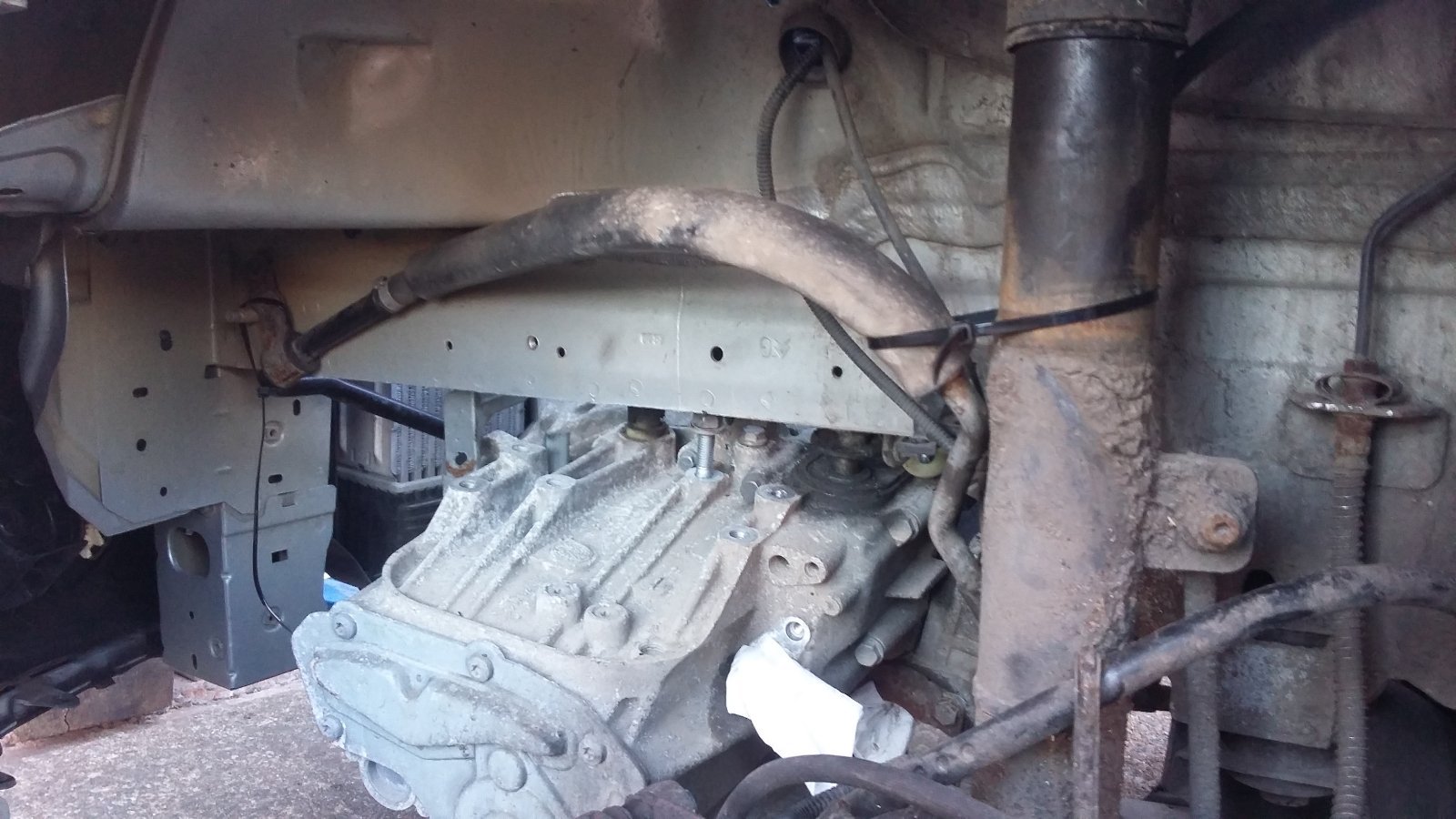

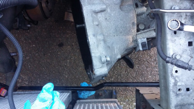

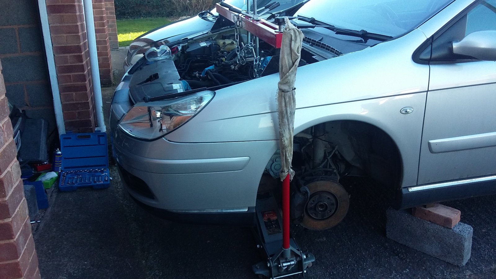

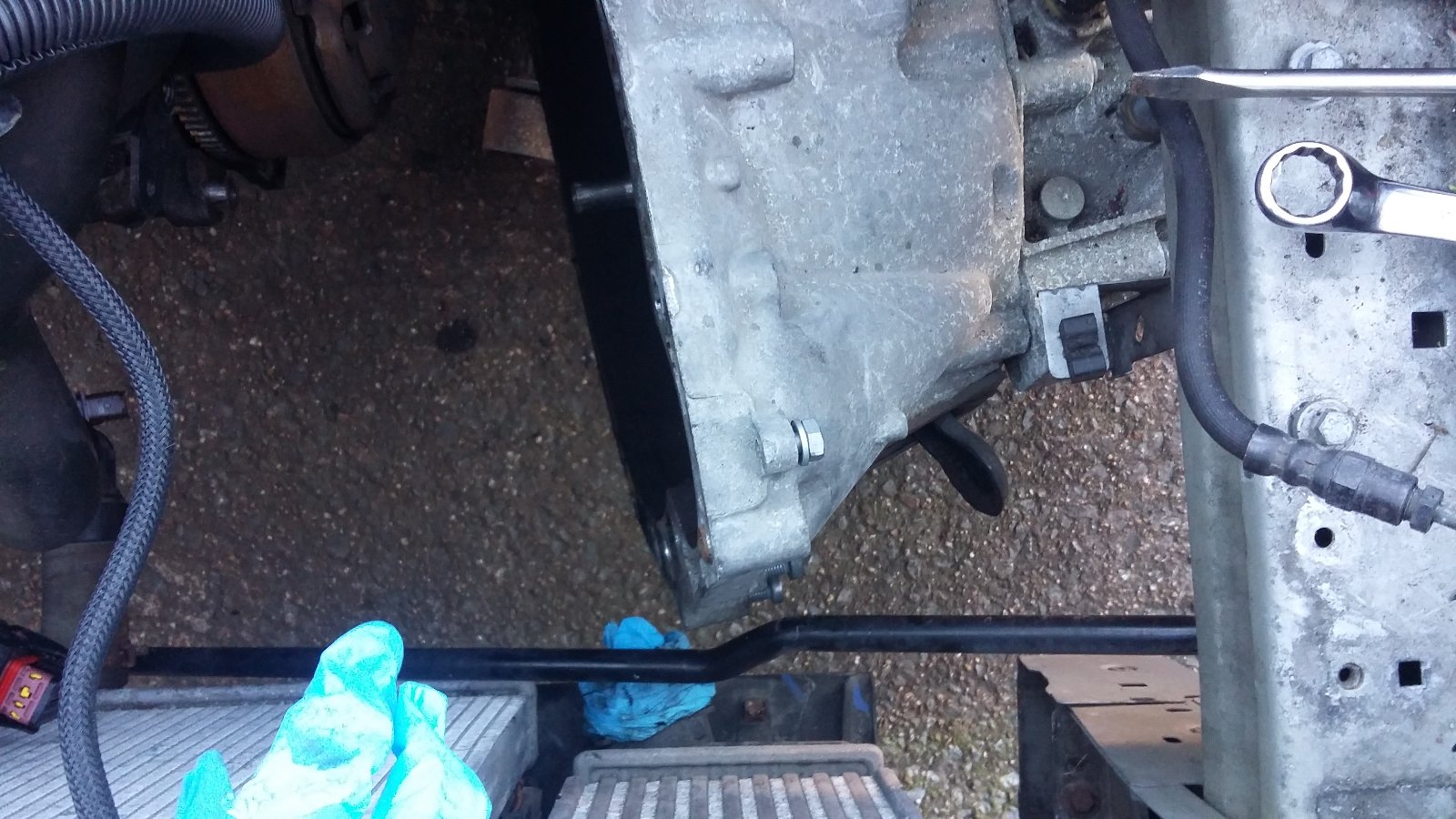

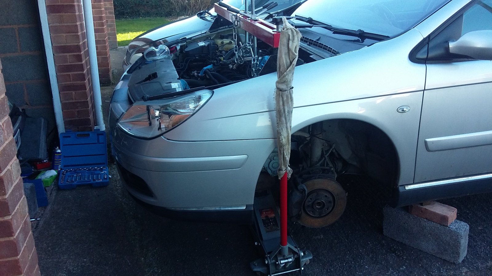

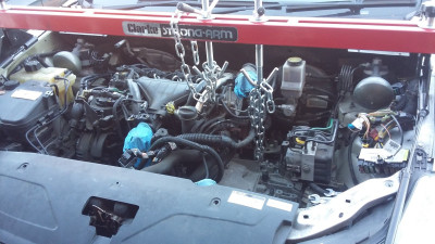

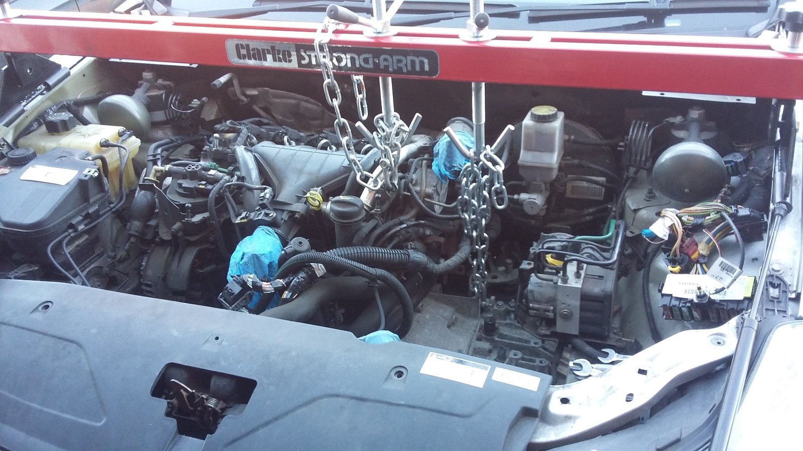

The belts and everything that side of the engine is done, now I'm working on the other end. Mine is a 2.0 HDI 16v 138 with 6 speed box.
Although there is a bit more to take off, it almost feels like someone has sat down and thought about how the flywheel and clutch can be done with the engine in the car. There are a couple of bolts that would have been pretty awkward if they hadn't designed in slots so you only have to loosen them. The intermediate driveshaft bearing has a half circle retaining collar, both (non hockey stick bolts!) loosened, retaining collar knocked out the way with the end of a screwdriver as it has a slot in the top and leave it to hang while your knocking the driveshaft out.
There's also a retaining bracket at the back covering both the box and engine which needs to be removed. One of the bolts is obscured but a rubber air pipe is just undone giving you access. There's then another bolt which looks like it needs to be accessed from above but other bits of engine are in the way, however you can get to it using a spanner from underneath, loosen it a turn and again the bracket is slotted so it just slips out easily.
I read about RichardW having trouble getting his gearbox out because of the power steering pipe so I decided to unclip the pipe all along the front of the car and the sides giving me enough flex to cable tie it out the way (see photo). You've then got a large space to bring the gearbox out. I had no problems with the gearbox fouling the subframe like some others seem to have had on the web, I found there was plenty of space, maybe I removed more bits than others.
I need to replace the crankshaft seal on the box side as it seems to be weeping a touch. I've also got replacement diff seals, forks and guide tube.

Good work Kev, especially given the prevailing weather
I've thought that on many occasions with a variety of PSA vehicles... The V6 Xantia is a very good case in point... Great and intelligent thought was given...
In all cases I've found that if a component looks impossible to remove it'll turn out it is just possible even if the clearances are just shy of a gnat's cock to allow it... The ML5T 'box fitted in the big-engined Xantias are a good case in point...
red_dwarfers wrote: 07 Jan 2018, 21:40 Although there is a bit more to take off, it almost feels like someone has sat down and thought about how the flywheel and clutch can be done with the engine in the car.

All back together now aside from the wheel arch liners and under tray. I will finish that off next weekend and take it out for a test drive!
