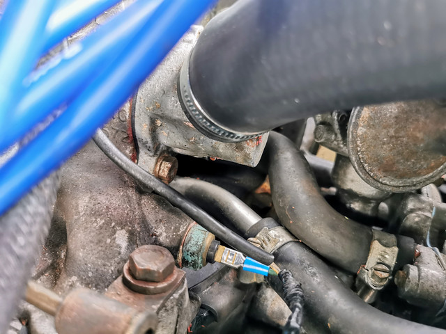

Looks like I might have found where that water that's sitting on the valley cover on the Rover's engine has been coming from.
Tiny little drip sitting on the bottom of the thermostat housing after sitting overnight. The hose clip it turned out wasn't all that tight, so I'm hoping that it's just a case of new hoses having compressed a bit since they were fitted and that it will now seal properly. I'll keep an eye on it. I'd like that to be the solution as it's by far the easiest to get to of all the possible locations for it to be coming from.

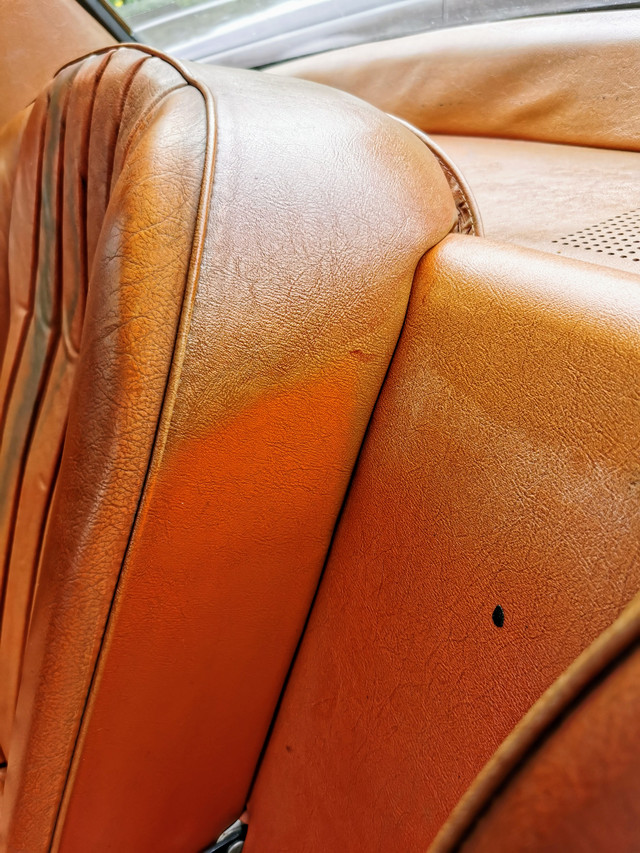

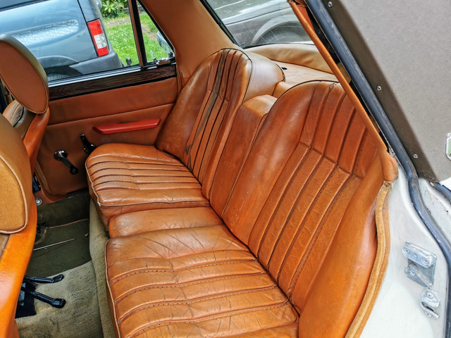

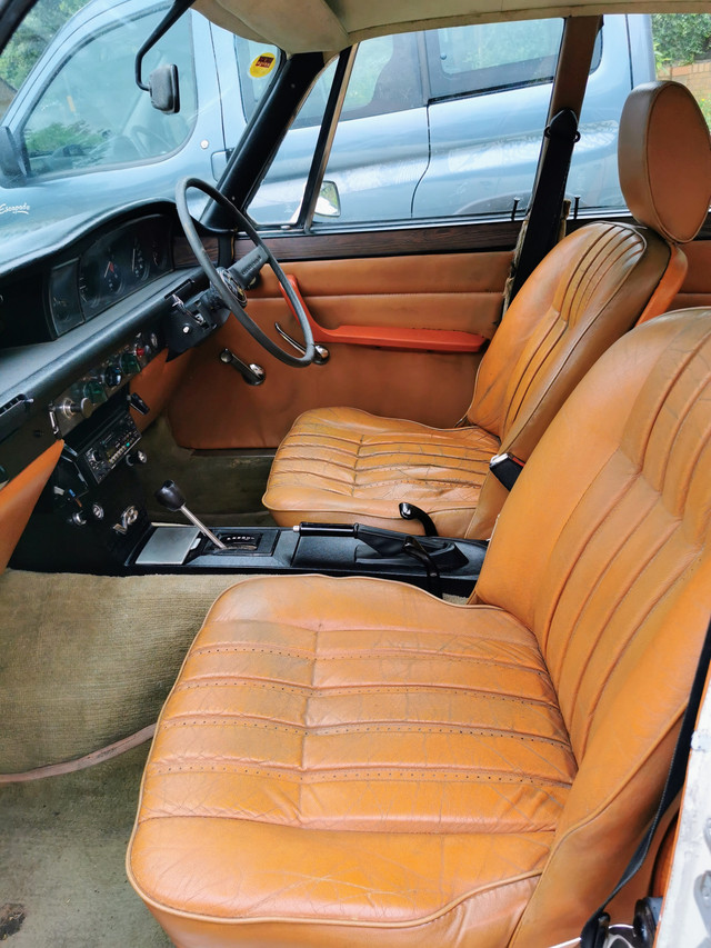

I've lost track of how many applications have been made now, but the leather is definitely improving compared to the cardboard like texture it had when the car arrived here.
Would be good to get some dye on it at some point to bring back out the original colour. If the above was already too much orange for you, look away now.
Definitely not an interior colour choice for everyone this. However I'm rather partial to bright colours in cars so suits me just fine.
I mean subtlety isn't really what this car is about is it?

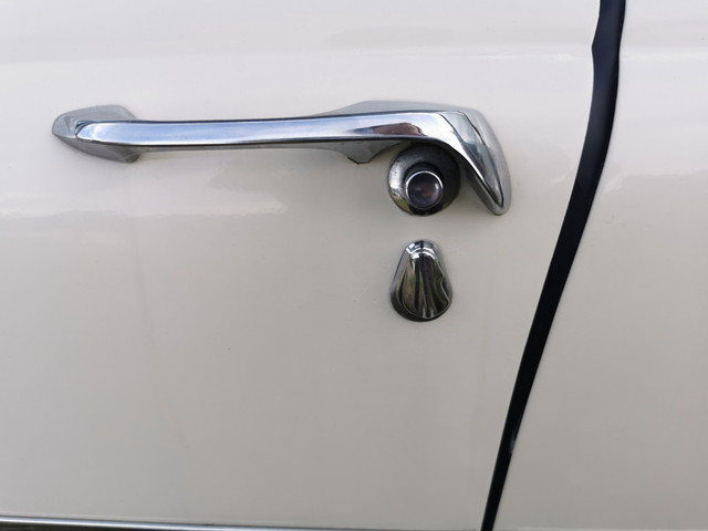

The little swinging covers over the keyhole on both front doors were being actively held away from sitting where they should be by their springs. Things are now lined up properly I think so the covers sit where they should do.
Really like the door handles on this car. They have that really satisfying design that is a perfect balance between being very deliberately designed, but not OVER designed. Feel really nice to use as well. I do need to adjust the hinges on the remaining three doors a little though as they catch slightly when opening. Driver's door was the same but that one got adjusted as unsurprisingly it's the one I use the most.

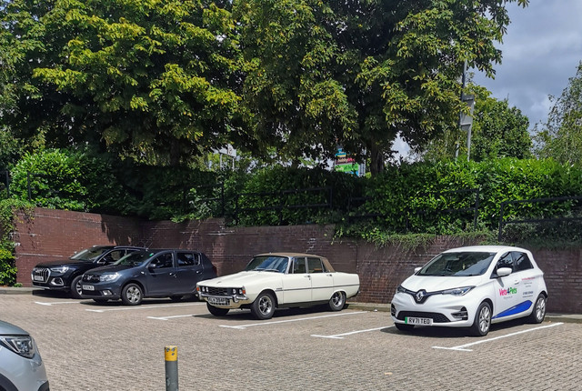

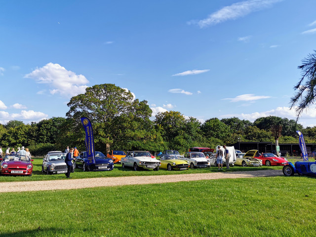

Took the Rover over to the Motors at the Museum get together this evening. Plus side of having an actually photogenic car is I'm more likely to remember to photograph it being there.
Most of my photos are actually on film today, though did snap a few on my phone.

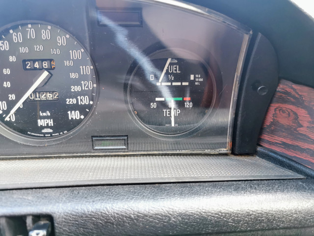

On the way there the Rover got distinctly warmer than I would like. Not sure if this was just the stat being a little slow opening which I'd seen before. However I checked while I was there and the level was a little low. Topped it up, and sure enough stayed rock steady (the whole three or four miles) home.
Don't think it was low enough to make that big a difference, but hard to say. Definitely need to start properly trying to track down a new radiator I think.
