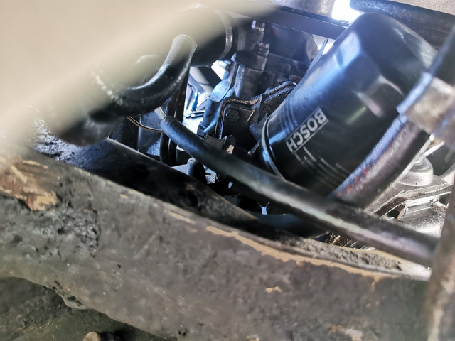

Yesterday I made myself some unnecessary work and swore a lot.

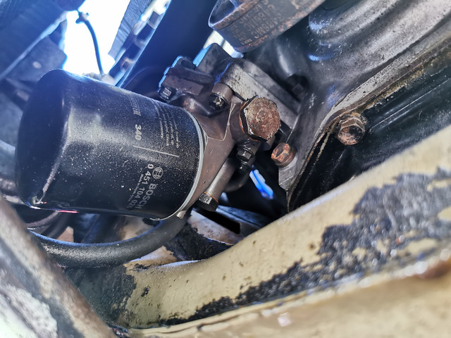

Yesterday I went to have a look into seeing if we could do something about the oil leak on the Rover. It's kind of hard to tell exactly where it's coming from but all evidence suggests the join between the oil pump body and filter housing. The vast majority of the oil seeming to run down and drip off the bottom of the filter itself and the cap over the pressure relief valve. Or it might be the filter bypass valve looking at the location...It's clearly a piston/spring type pressure regulating valve of some description.
This would be a lot less of a pain to deal with if Rover hadn't put this...thing...right in front of the oil filter.
Yes. That gets in the way *exactly* as much when you're trying to change the oil filter as it looks like. I've threatened it with the angle grinder more than once.

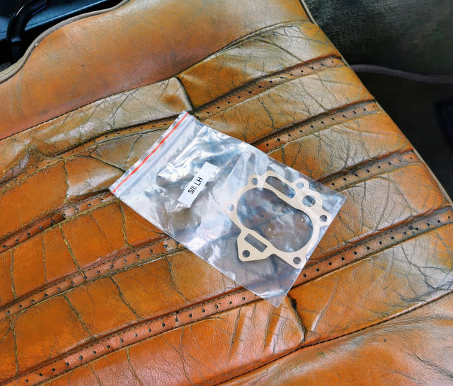

Hard to see in the photo, but the bolt layout can be seen from the replacement gasket.
I eventually figured out that a 3/8" wrench was a perfect fit on those bolts - after spending a good 20 minutes digging through toolboxes while cursing the fact that Rover hadn't discovered the joys of the metric system in the early 70s. Unfortunately that's about where the good news ended. I cannot for the life of me figure out how to get a wrench on the "back" two bolts. On in particular I can barely even touch between the amount of structural metalwork in the way and the oil pressure switch boss being in about the most unhelpful place imaginable in terms of trying to remove this assembly.
It doesn't look like removing the filter will actually help the bolts that it looks like it interferes with in the photos are actually accessible - and the filter itself actually gives me something to hold on to while I'm trying to remove the thing from the car.
I did notice though that - even using a pretty stubby wrench as I was - that at least four of the bolts were not all that tight at all. So nipped those up a little and ran the car for a while to see if it helped. After 20 minutes or so (however long it took me to go over the seats with leather conditioner again), evidence suggested that it maybe had helped...We definitely didn't seem to have the regular drip or two every second off the bottom of the filter anyway. We did still have a drip every ten seconds still coming off the bottom of the oil pressure relief valve housing. Which when spraying the area down with brake clean (which was then immediately blown in my face courtesy of the cooling fan), looked like it might be seeping out around the cap over the valve - the copper washer there looking a bit mangled where I could see it. So I figured I'd pull that and swap the copper washer and see if that improved things.

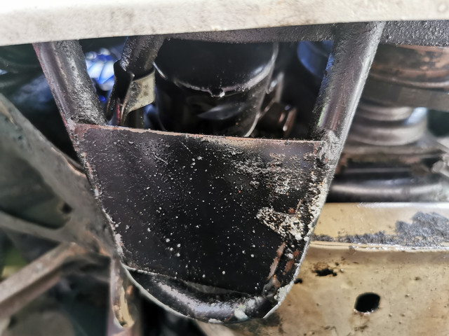

Rookie mistake.
Of course if you look at those photos you can see that said valve is basically the lowest point in the housing. So yes, as soon as the piston was removed all of the oil that was in the oil pump immediately exited the oil pump (and ran straight up my right arm).
While annoying for me, I immediately realised I had made a mistake there. Something the Rover V8s are renowned for is that the oil pumps can be an absolute git to get to prime themselves if they are drained. Especially if they've got a few miles on, where they can completely refuse to prime unless you physically dismantle the pump and pack it full of petroleum jelly. Which given that I haven't figured out how to remove said pump yet isn't great.
If I'd been smart I would have checked beforehand that I had a suitable washer to replace the one I was looking at. If I was smart. I'm not. I didn't. It's also captive on the cap (not sure if by design or if it's just become somewhat oval) so I couldn't just pull it off to anneal it. Nevertheless I did clean it up a bit before putting it back together.
Which took well over an hour of swearing. The spring is really strong, everything is covered in oil, the cap has a tapered seat, a really fine thread, and you're working at a really odd angle, one handed while blind. I managed to launch the thing into my face at least half a dozen times.
I just had to walk away at that point yesterday.

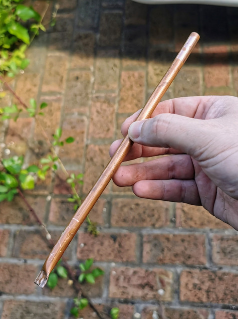

Fast forward to today and I made myself an oil pump priming tool.
It's just a rod with a flattened end which engages with the drive dog on the top of the oil pump (like a really big slotted head screw). This is accessed simply by unbolting and pulling the distributor out.
Said rod is then used to drive the oil pump (clockwise) using a drill. I'm glad I decided to be cautious and do this rather than just starting the engine and crossing my fingers. I must have had the drill running at high speed for well over a minute before the pump finally drew prime and started generating pressure. That would have definitely taken an extremely uncomfortably long time with the engine running, and likely would have taken way more than the battery would have had to give to do it just cranking.

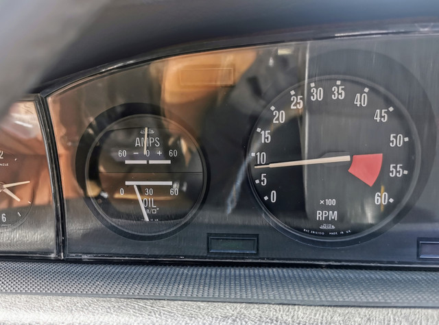

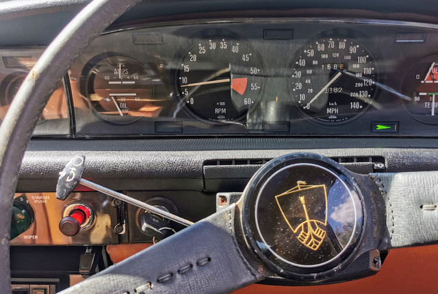

Of course it wouldn't be this car without *something* breaking during the test drive.
Outside:
Inside:
Left hand indicator light on the dash has failed. Percussive maintenance failed to resolve this, so looks like I'll need to pull the panel apart to either sort the contact or change the lamp. I have been wanting to investigate the totally non functional ammeter for a while now as well so not maybe the worst thing if I can do both of those things at the same time.

Having looked at things a bit more closely, I think we're going to be looking at a complete replacement engine - whether that be second hand or a rebuild from Trabantwelt remains to be seen. The big issue preventing me from just chucking some new bits into this one is the damage to the faces of the rotary valve port faces. They really have been pretty well chewed up and there really is no easy way to repair this, so the crankcase is basically scrap. Which leaves me with...well basically just the external components that are suitable for reuse. Most likely we'll be looking at a "new" one.
Rookie mistake.

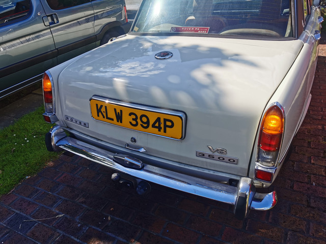

Feels a bit strange this...feels like I'm actually bringing a bit of class to the car parks of the area using the Rover rather than dragging the tone down as often seems to be the case with my fleet!
While it's still there the oil leak is a thousand times better. Like one or sometimes two small drips a minute. Still needs sorting, but at least the car is driveable now. I'll see if I can get it booked in somewhere soon. Had another look at it today and I just can't see how you'd get to it. Maybe if you jack the engine up a bit or maybe pull the radiator and grill and go in from the front? Nah, someone with better tools and a proper lift can have the fun of this one.
Really do need to address the issue of the square tyres as well as they currently pretty much preclude exceeding about 50mph due to the amount of wobble that then starts happening. That may have to wait until after we've sorted the Trabant's current engine issues though.
