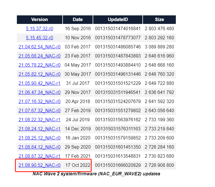

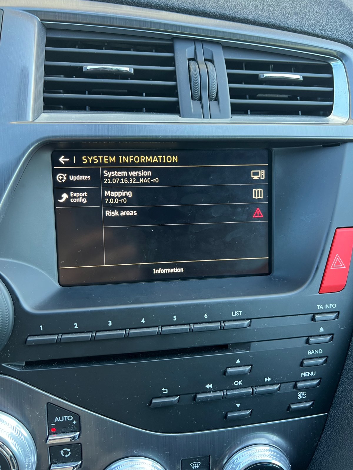

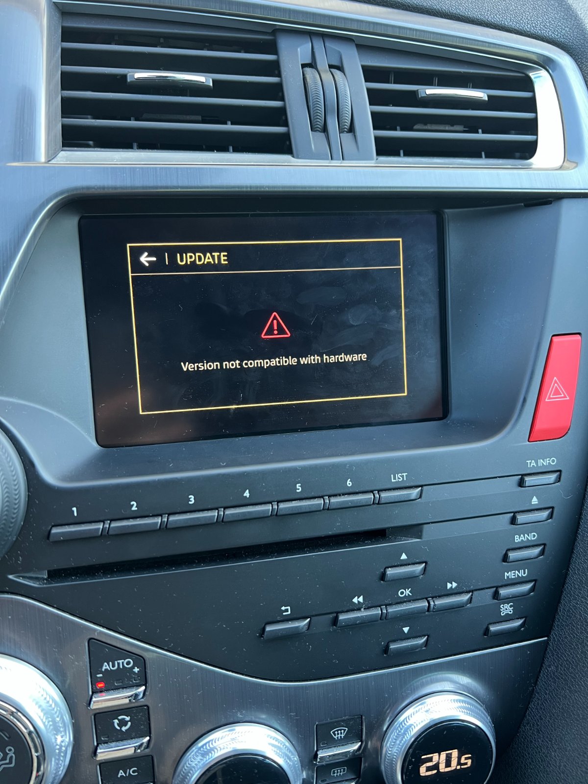

I have a DS 5 2013, which was equipped radio of RD45.
I bought an NAC wave 2 with coding to my VIN and installed in this car.
But these days I checked the NAV version was:21.07.16.32_NAC_r0(published on 20Apr 2018)
And I found the latest version is 21.08.90.52_NAC_r0(published on 17Oct 2022)
I downloaded this firmware and decompress to USB sticker(FAT32 file system,formated, in the root directory)
Then when I insert this USB sticker to the port in the glove box, the NAC informed that [version not compatible with the hardware]
I checked the relative post and seems like I need a license( I didnt see the wifi connection in my NAC, that means no OTA).
My VIN number is VF7**************[VIN obfuscated, can be read by forum staff]
That would be greatful if somebody can help offer the license.
I know the AC panel was not suitable for this NAC, but it doesnt matter because I only use CarPlay.(Now I know actually I only need RCC than NAC, if I dont need the map inside of the radio)
x 6945
Re: PSA NAC RCC Updates
Let me be clear on this as there have been several of you that have made requests for NAC Updates in vehicles that did NOT have NAC units factory-fitted.
I do not support vehicles that did not have NAC or RCC units fitted at the factory!
You should of known that upgrading to a NAC or RCC on a vehicle that never had this fitted as standard can mean you are stuck on the firmware the unit has at the time of the upgrade.
Firmware is authorised on a VIN / vehicle basis, so if you have had your NAC unit VIN-coded to your vehicle's VIN, in order for it to work correctly, you cannot expect Firmware updates. Firmware updates are licenced to the VIN of authorised vehicles (that originally had these factory-fitted). So the system I use will NOT generate a licence for a vehicle that never had a NAC fitted as standard. Even if I use the VIN from the donor vehicle, the licence file will not authorise the firmware update (as you are seeing in your screenshots) as it is tied to the original VIN and not the VIN that you have programmed into the NAC.
So please don't ask me for updates in this situation, I only support vehicles that had RCC / NAC units factory-fitted.
